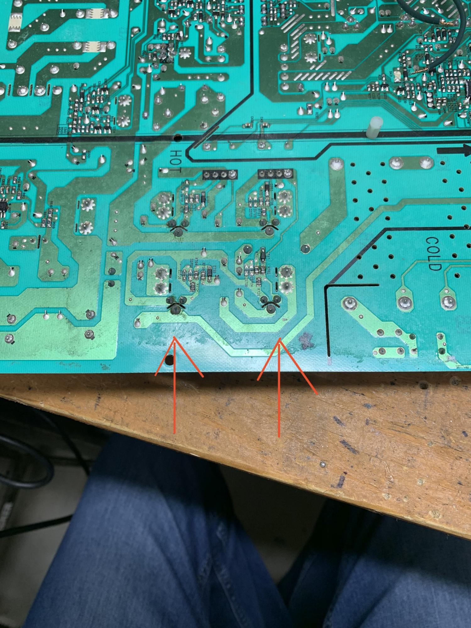

    In the attached picture these two MOSFETS, voltages seems weird, is it normal that when I measure in DC VOLTS at the drain, voltage starts out as high as 27 volts and lowers down to 9 volts?

      Re: Vizio TV E470VL SMPS Flucuation Output Voltage
      Are you using the neg. side of bridge rectifier or neg. leg of main filter cap for ground? either is ok when checking voltages in the hot side, use caution HIGH voltage on hot side.
        Negative side of big cap
          Not sure what we've covered, you do have around 160v on the big caps when in standby? powered up it should go up to around 390v.

                    #149
                    167 volts on the filter caps

                        #151
                        Any ideas why there is changing voltages on these mosfets? The mosfets just above them are steady and stable at 167 volts

                          #152
                          not sure, maybe test Q101 and 131, and test every resistor in that area, the values should all be marked see the tiny writing, make sure the ohms reading is close to the value marked on the resistor.
                          How do test Q101 and 131 in circuit with a multimeter?

                            #153
                            yeah, i guess, see if its short, i believe you test drain to gate and drain to source, might be middle leg to each outer leg if continued beep or close to 000 in diode mode its probably shorted. Dont get it confused with both outer legs because they can show continuity and be ok. Prolly best practice is get the datasheet of the component to be sure of the pinouts.

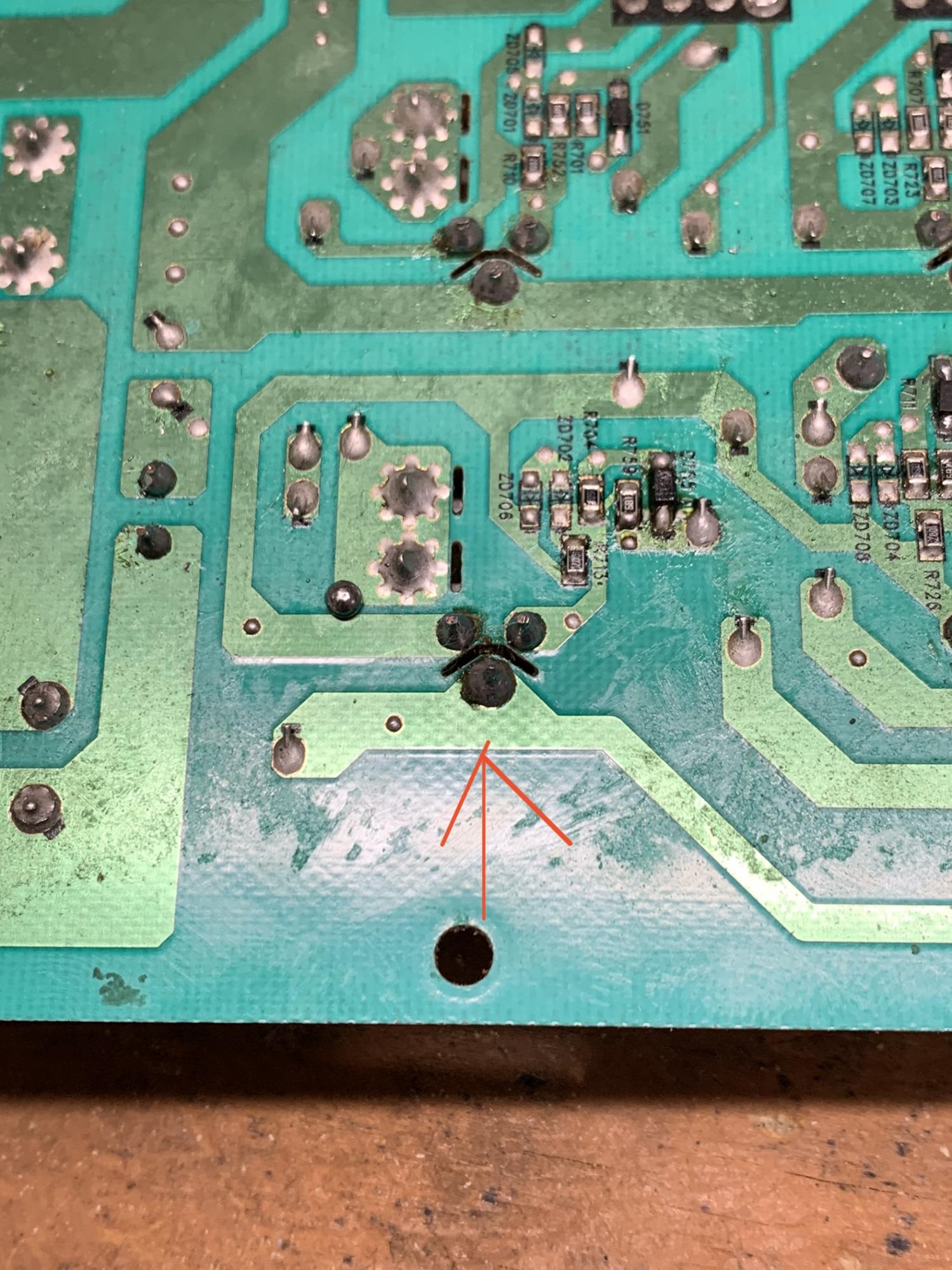

                              #154
                              There is only 1 volt at Q707 at the drain. Picture attached. For orientation it is right next to big filter cap, cap farthest away from input power. Any suggestions?

                                #155
                                make sure resistor R704 is ok, it looks beat up from the picture.
