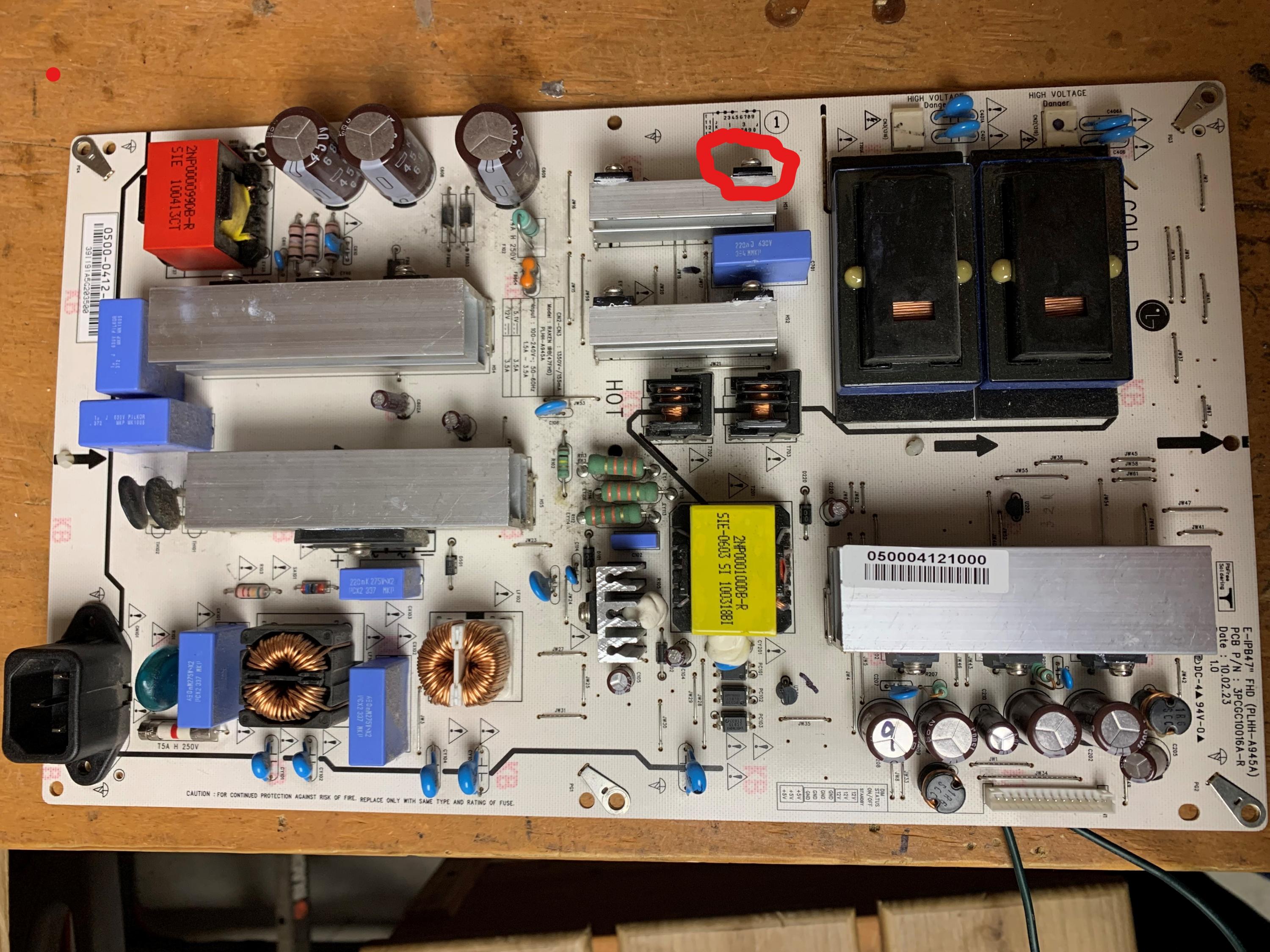

        I replaced the IC. No output voltage. Her are the voltages of the IC
        1. drain 167
        2. Ground 0
        3. Vcc 0
        4. FB 0.59
        5. Sync
        6. Vstr 77.2
        Any suggestions?

              #86
              Re: Vizio TV E470VL SMPS Flucuation Output Voltage
              Any suggestions why no output voltage and no voltage at Vcc.
              Q709 Mosfet (pictured attached circled in red) has very low voltage; around 2 to 3 volts and is unstable
              • dskall
                • Oct 2016
                • 2905
                • usa
                #87
                You said you damaged traces. Did you measure on the trace and pin to confirm you have continuity between pin and trace?
                I would pull ZD103 a C109 off the board and check them. I would also then check to see if there is any voltage on vcc with them disconnected. Start up voltage is supplied to pin 4 from pin 6.

                    #89
                    I have checked the traces and all 6 ic pins and they are good.
                    I checked ZD103 with another Voltmeter, it shows 0.579v one way and OL the other. My guess is this voltmeter uses less volts for testing compared to the other VM that showed voltage each way. ZD103 and C109 share the same traces for each of side of their leads which might account for why there is voltage each way on ZD103 with the VM that has a higher voltage. I'm not real good in installing or removing SMD so I would prefer to wait on doing that until all other troubleshooting options are exhausted.
                    You mentioned that start up voltage is supplied to pin 4 from pin 6, can you help me better understand how it works; Is Pin 4 Feed back and Pin 6 Voltage Start up? Pin 6 has 77.2 volts when the power supply is plugged in. This has been about 2 and 1/2 month project and it gets discouraging at times. I appreciate your help.

                      #90
                      hold on... yours OP Photo what are this jumper you did ??? for what?? if its for simulated power on then its wrong.
                      • nomoresonys

                        #91
