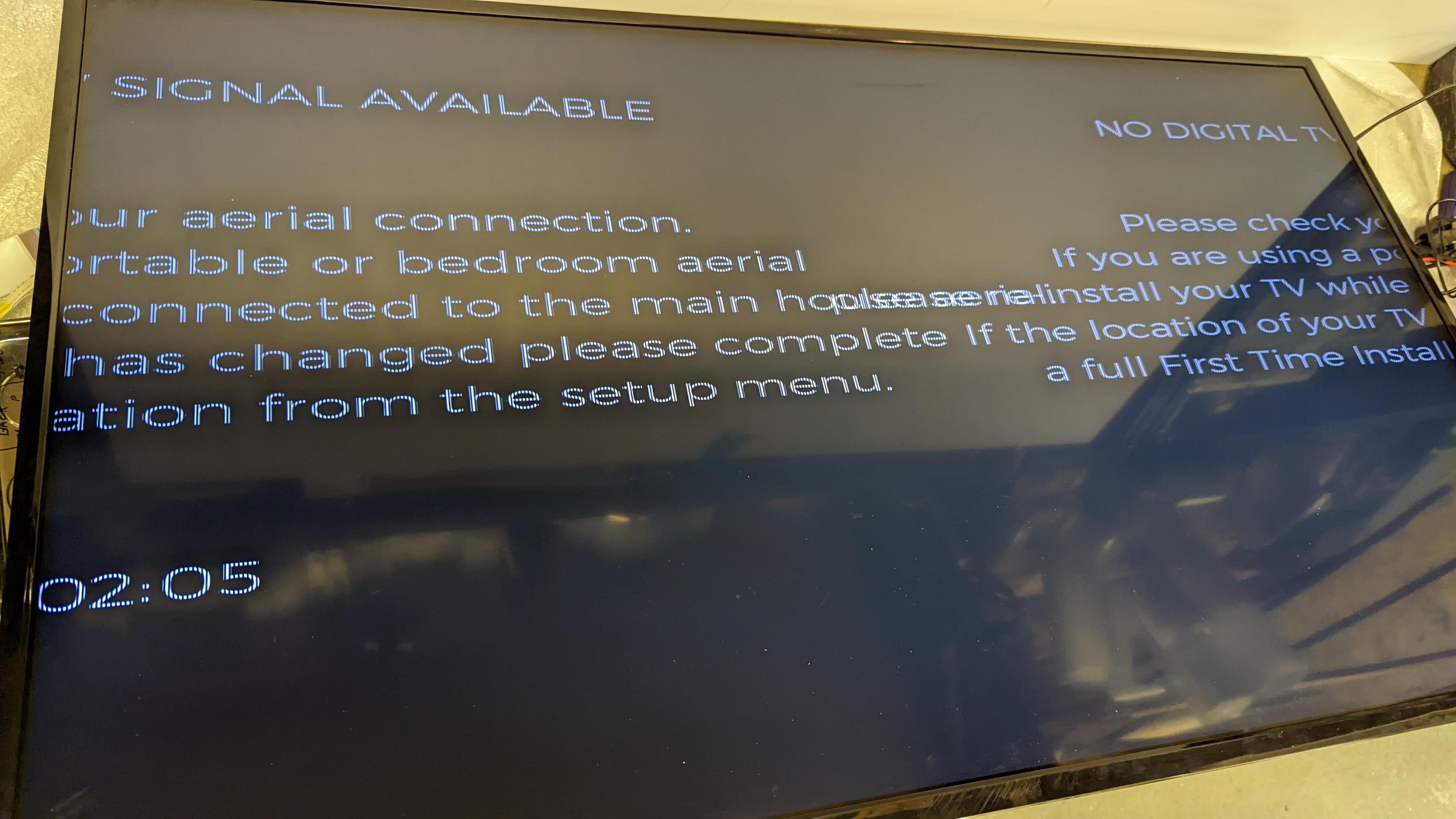

    I've replaced the above mB with a near identical one (best I can find). 17MB130S 23665848, was quoted as being from same model 50".
    Picture is out of sync.
    Could it need reconfiguring to this particular panel? Or is this a tcon/cable fault?
    note: this is the second replacement board i have tried, first one was also same model but slightly different serial. same picture out of sync.
    update : unplugging the tcon > panel cables result in only half the screen with same symptoms - on bothsides - im thinking it tcon or firmware. ..?

    Yes does seems like a tcon issue.

      Maybe timing issues. Might try blocking clk traces on one side.

        I tried removing each of the ribbon cables to the panel, the problem exists which ever cable is plugged in. So points to tcon issue .. have ordered a replacement.

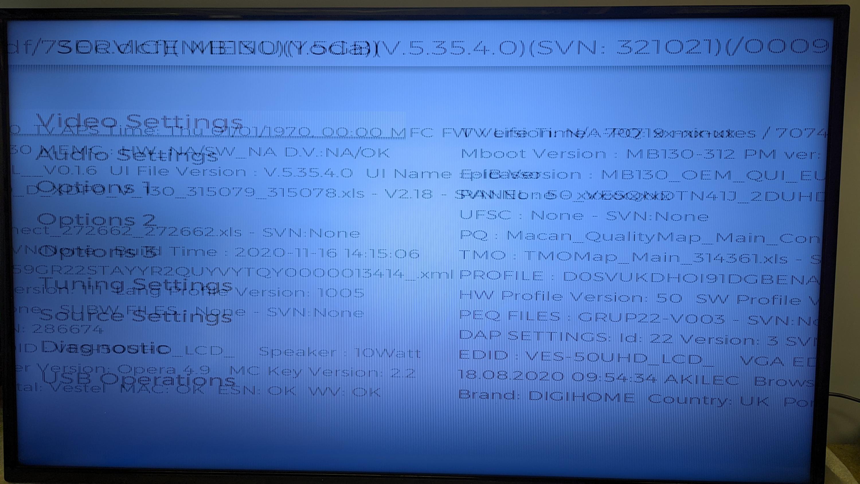

                    You will need the panel profile. I have for N11 not N41. It deserves a try. Do you know the installation procedure?
                    L.E. Type on the MENU 4725 remote control and see which panel the motherboard worked with.

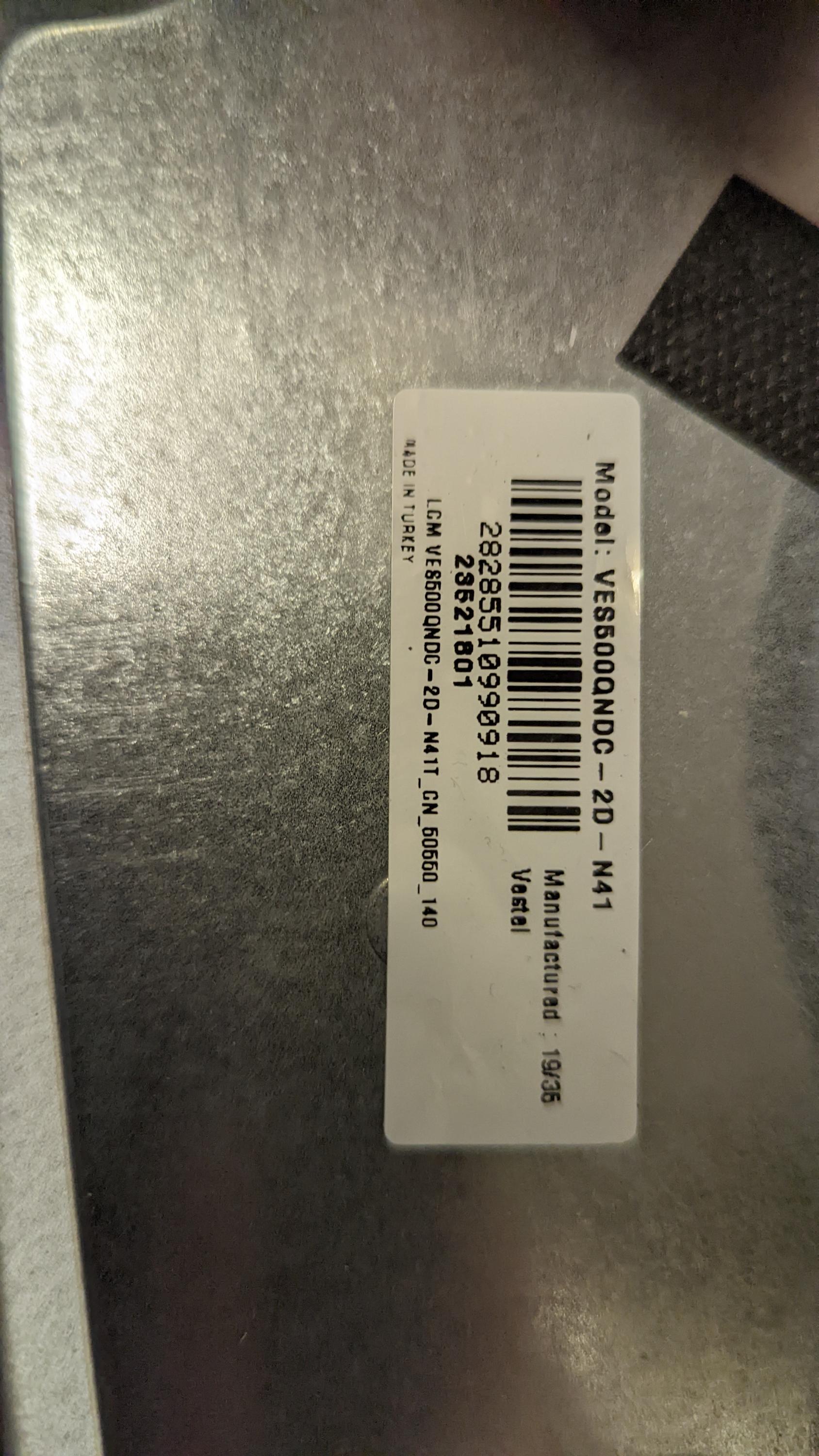

                          connected only 1 of the panel connection to TCON and still get the same image, and same if i swap over to the other connector. so would imply the signal going to both sides of the screen -independantly is distorted. that would imply that the screen is ok wouldnt it ? as i say, tcon and MNb have been swapped. which leads me down the panel profile route.
                          attached a photo of the service menu and screen product label - its hard to read the menu due to the distortion.
                          panel is VES500QNDC-2D-N41
                          i can make out ....TN41J_2DUHD
                          anyone figure out if these are matching or if it needs an update ?
                          where can i find the panel profile for my N41 model ?

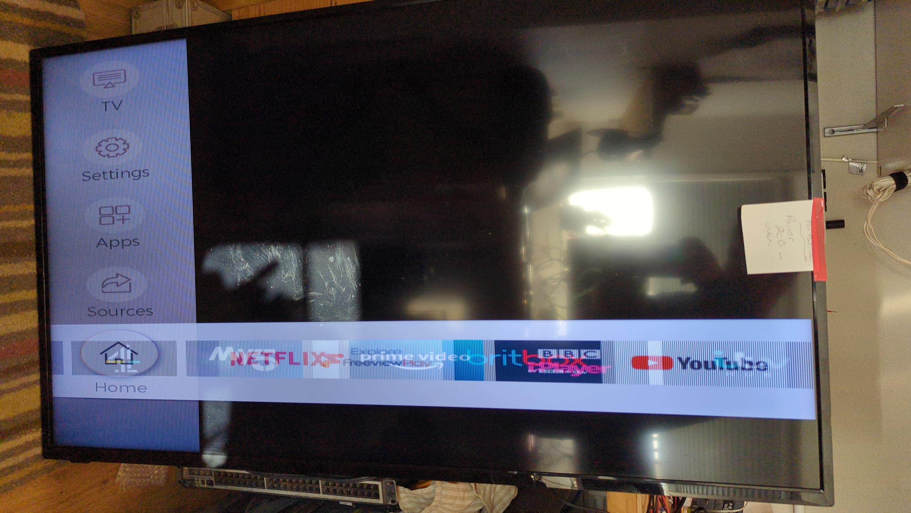

                                Re: Digihome 50551UHDS display sync (FIXED)

                                its fixed! your a star. ..thanks so much.
                                was trying with those files on the root and in a profiles folder. never knew about the PQ folder.
                                is there some secret list of what folders and files are needed to update various settings ?

                                      fixed it... used the timing file from your download for the 50" and the panel file from the backup i took before i started...
                                      now its working retested onthe same youtube vidoes - all looking good now.
                                      attached the ones im using if this helps anyone in the future.
