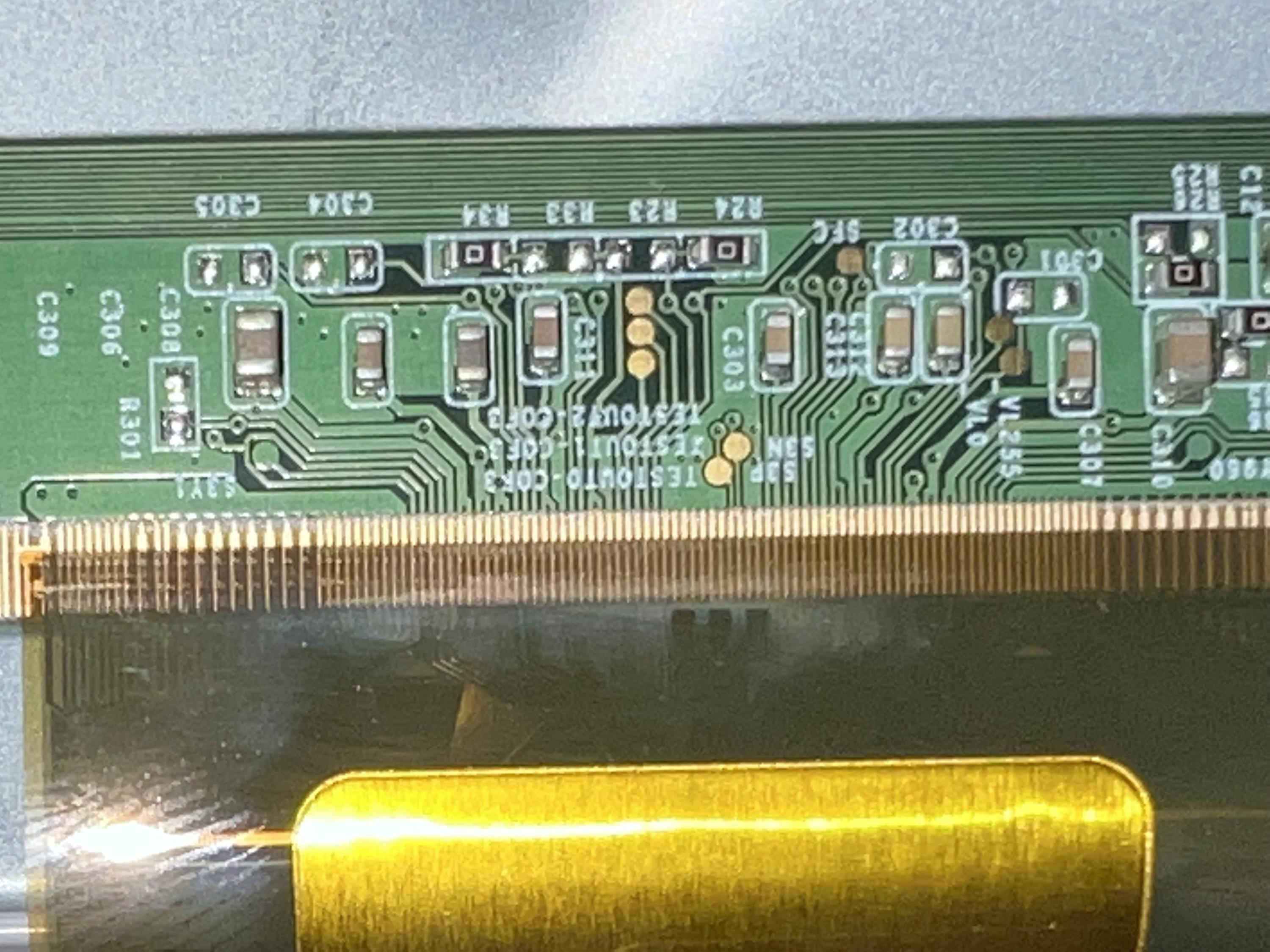

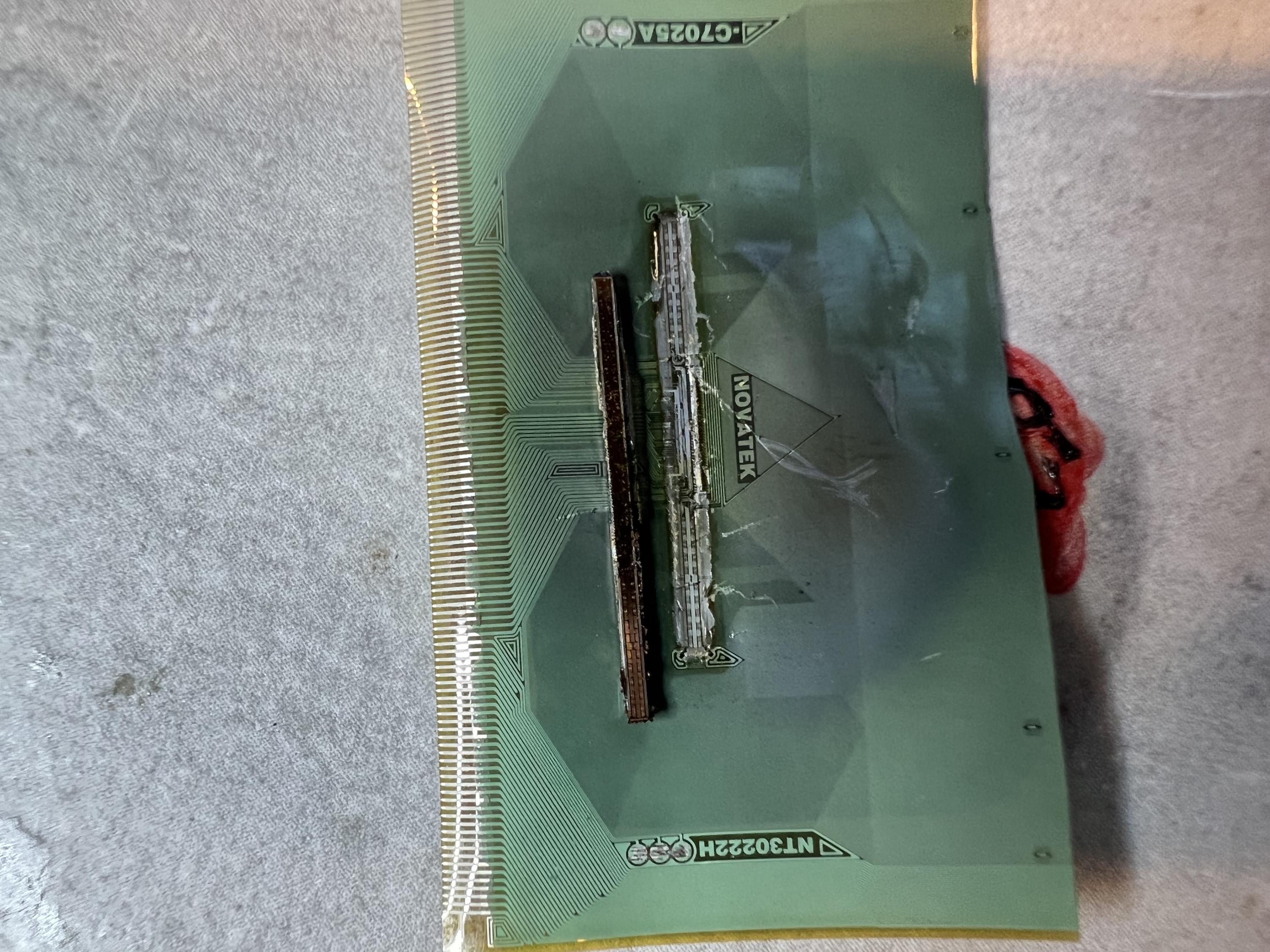

                            Well well, it seems a bit tricky to replace a such chip, definately a no-go. But are the chips really at fault ?
                            I noticed, on this one here these seems to be 5 test points, which i scratched (novatek nt30222h)

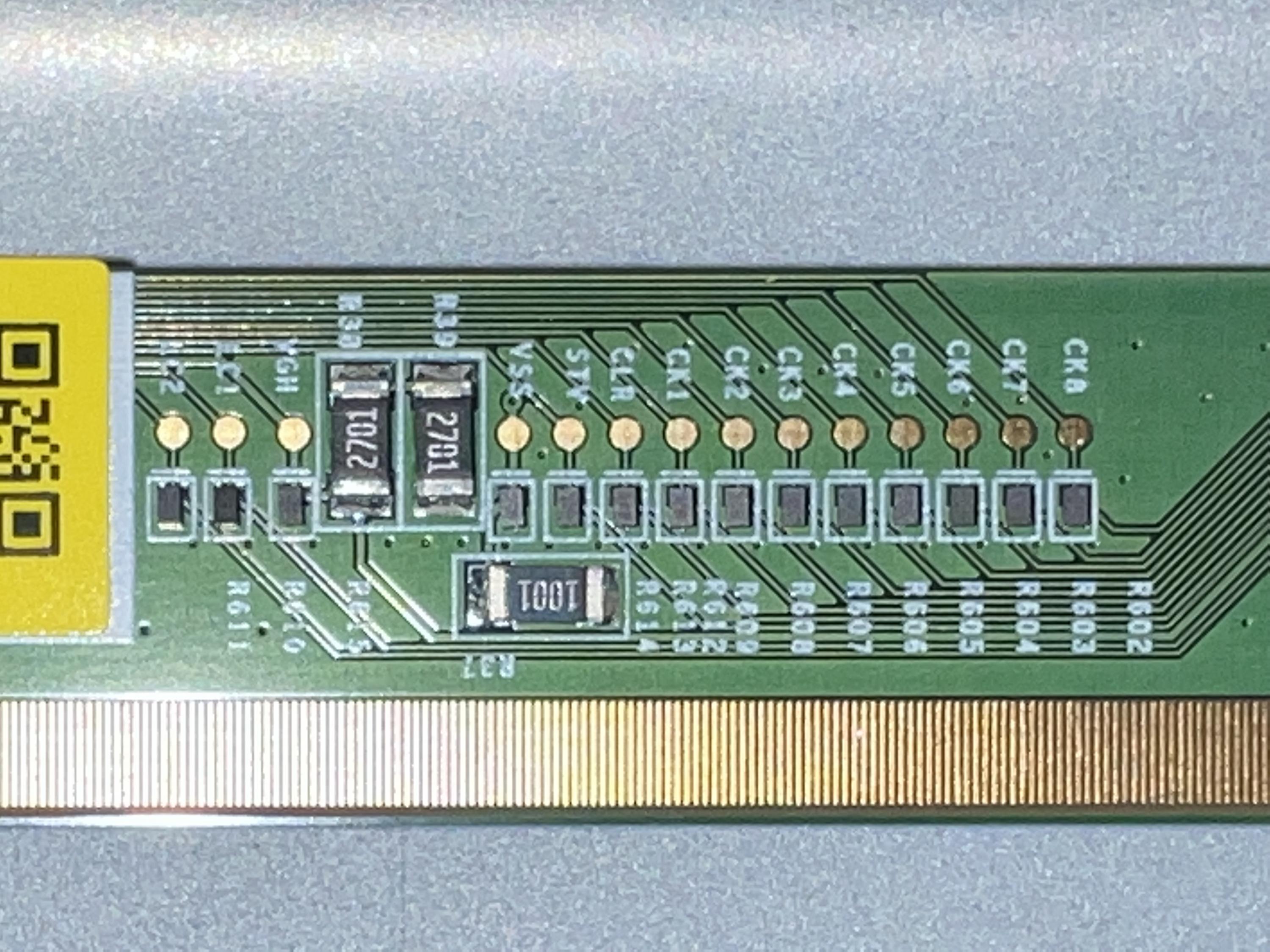

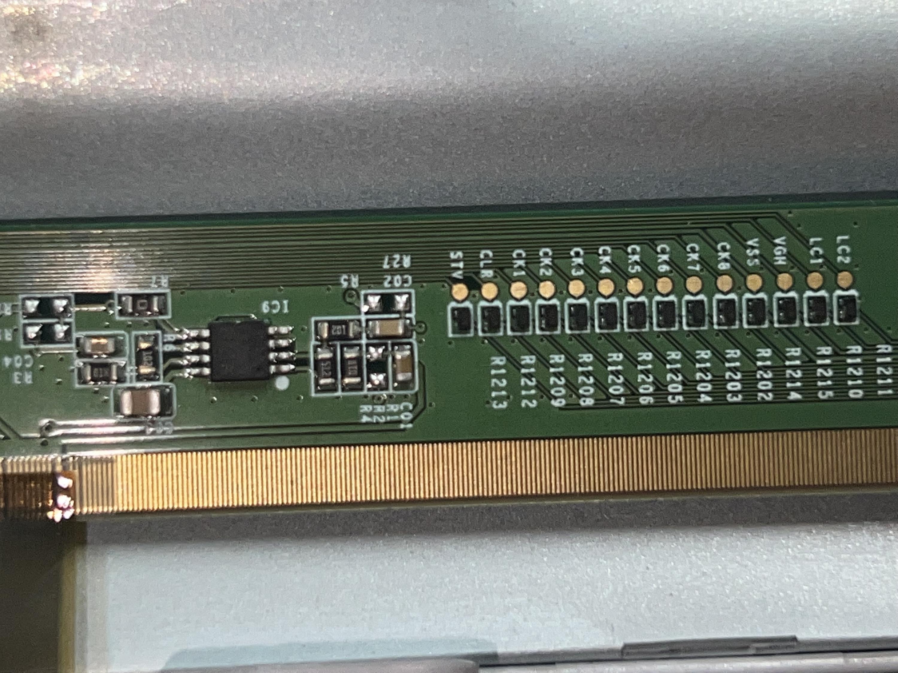

                                  Yeah, i tought about this, check for burnt areas or heat, but since the panel doesn't stay on, my thermal camera doesn't show anything on the cofs.
                                  Here are additional pictures on this model, there are these test points, but idk how to use them

                                    Re: Samsung un58tu7000fxza - Power cycles with no picture, only backlight
                                    i see there testout-cof1,2,3 and lc1 lc2 vgh vss, ck1-8, clr, stv.. anyone has a clue how to check stuff on there ?
