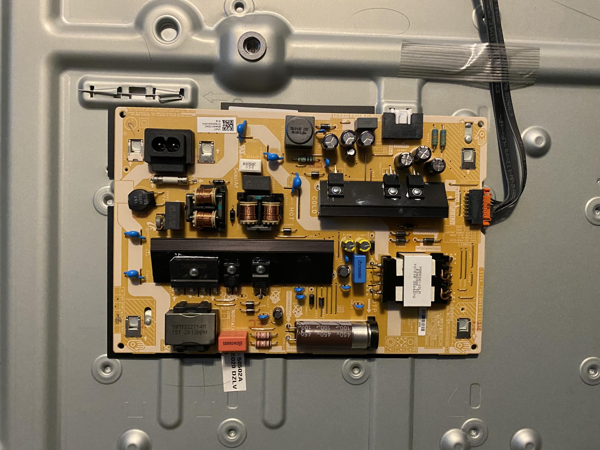

    I have a Samsung un58tu7000fxza that powers on (no image, only backlight) but keeps restarting. When it starts up, the backlights seem to be full brightness for 1 sec., off for 1 sec., on again with much lower brightness for 4 sec., full brightness 1 sec., off 6 sec., then repeats. I noticed when the backlights are off, I don’t see the red optical audio port lit, meaning the main board is power cycling. The T-Con must be integrated in this model, because there’s not a separate board. There’s a power board, main board, and driver boards (if that’s what these are called) that are connected directly to the screen ribbon cables down across the bottom. On my main board, there is only one ribbon cable that feeds these driver boards. If I disconnect it, the the TV stays on with backlights at full brightness. I read these models often suffer from bad screens. I did the tape trick to block off some pins in the ribbon and also was able to get the TV to stay powered up without restarting and even heard the start up audio, as well as audio when I used the remote to select menu, etc..). I never could get an image up, but only different line patterns of different colors depending on what pins I had masked off with the tape. I’m trying to isolate the issue to to determine if I have a faulty main board or bad panel. Sounds more like a panel issue since the main board stays powered on with the ribbon disconnected going to the driver boards, but the tape trick never made anything appear on the screen (startup logo, menu text, etc..). Any ideas or suggestions on where to go from here?
    Here are the voltage measurements.
    TV on with ribbon cable from main board disconnected:
    1-GND (0)
    3-A13V (12.93 VDC)
    5-A13V (12.93)
    7-A13V (12.93)
    9-A13V (12.93)
    11-GND (0)
    2-ANA-DIM (3.36 VDC)
    4- N.C (0)
    6- BLU_PWM (2.88)
    8- POWER ON/OFF (3.30)
    10- GND (0)
    12- GND (0)
    Main board disconnected - nothing connected except LEDs (connector snaps directly into power board when installed)
    1-GND (0)
    3-A13V (12.93 VDC)
    5-A13V (12.93)
    7-A13V (12.93)
    9-A13V (12.93)
    11-GND (0)
    2-ANA-DIM (3.13 VDC)
    4- N.C (0)
    6- BLU_PWM (3.30)
    8- POWER ON/OFF (4.54)
    10- GND (0)
    12- GND (0)

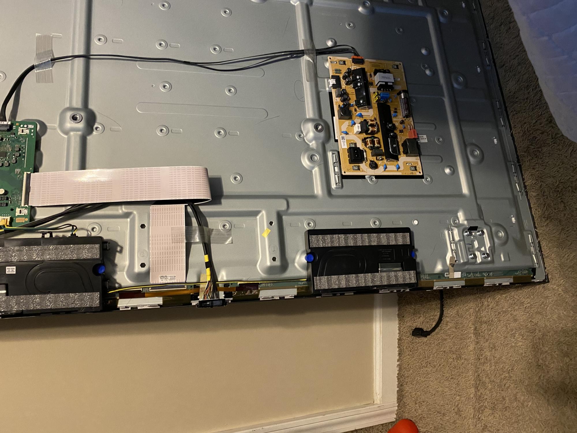

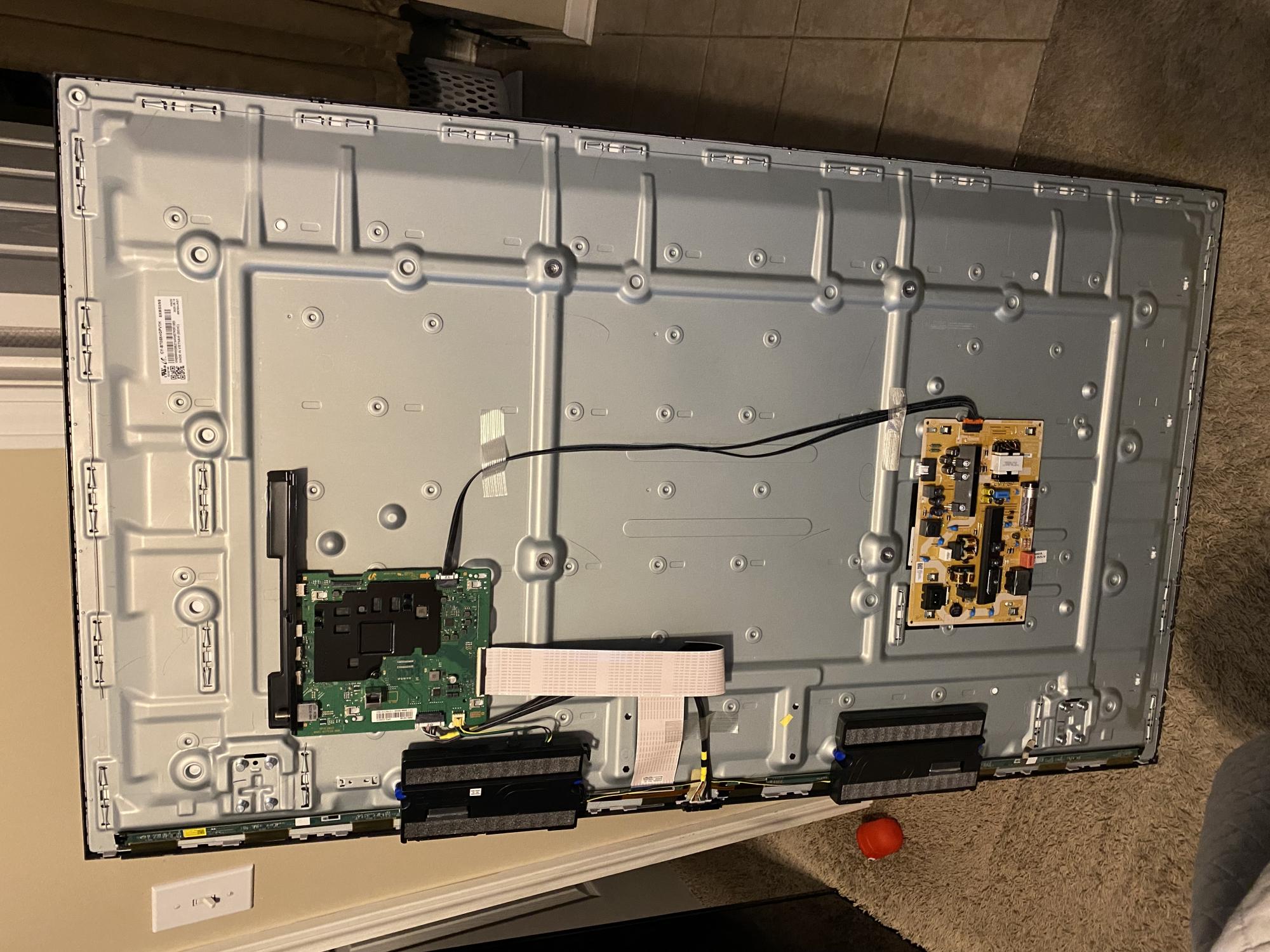

      Re: Samsung un58tu7000fxza - Power cycles with no picture, only backlight

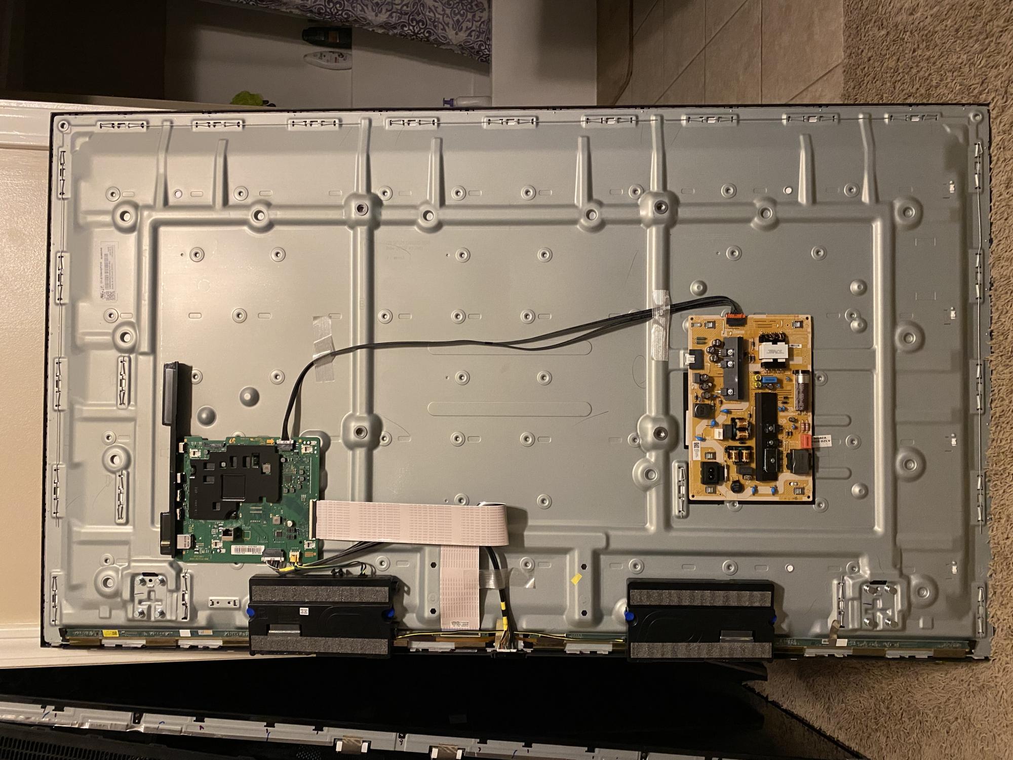

      Can you get some good pictures of board along the bottom?

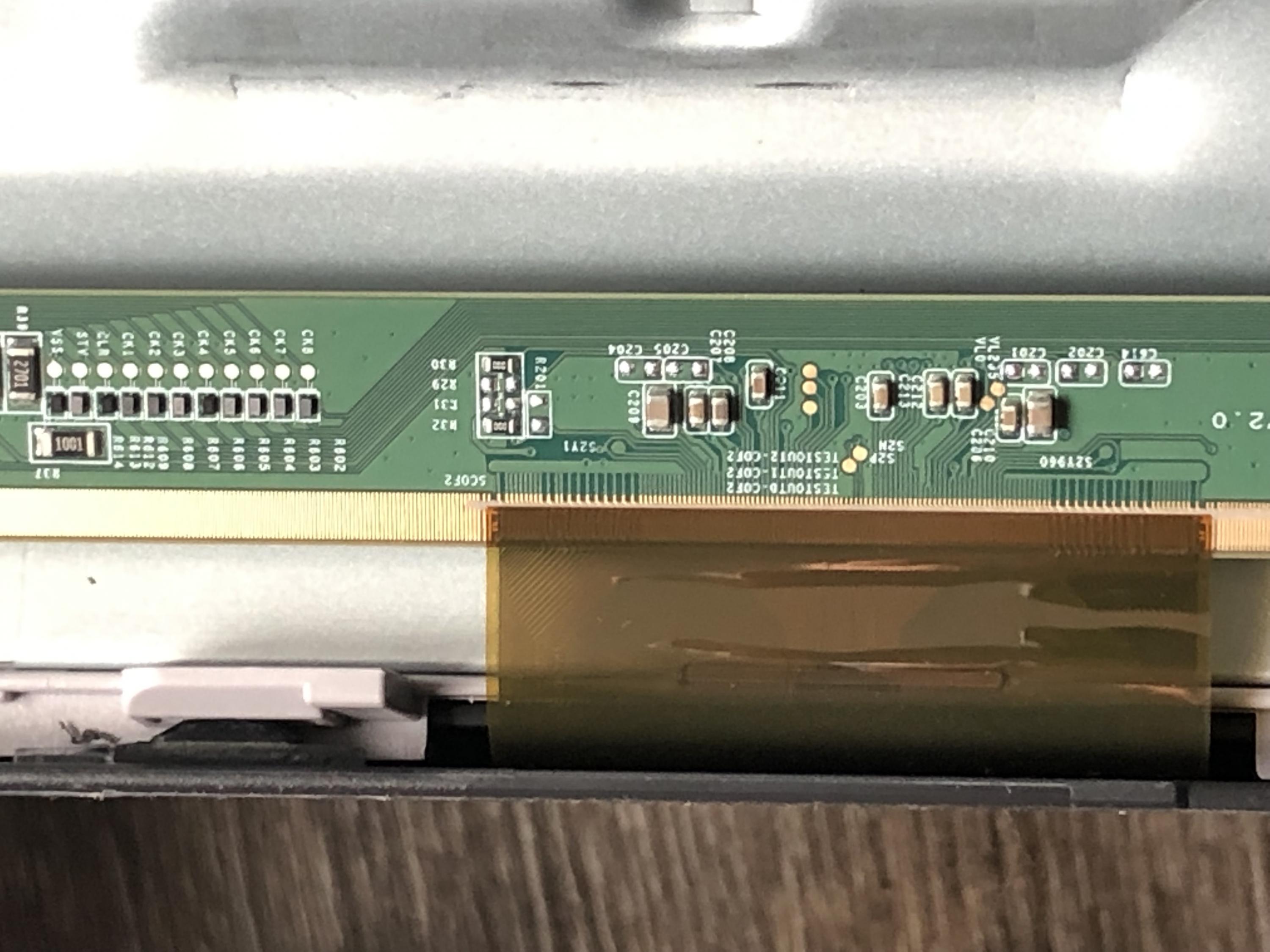

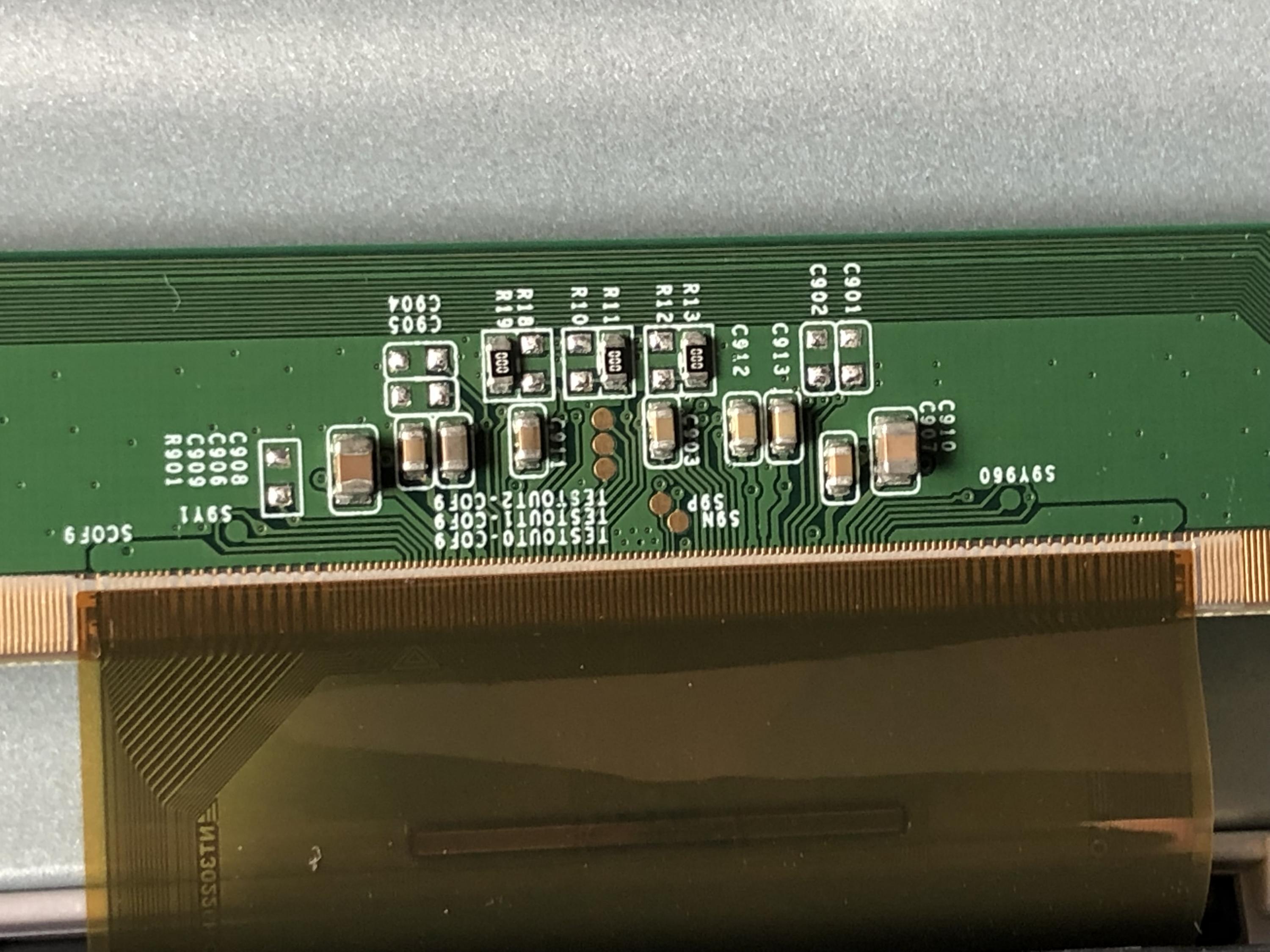

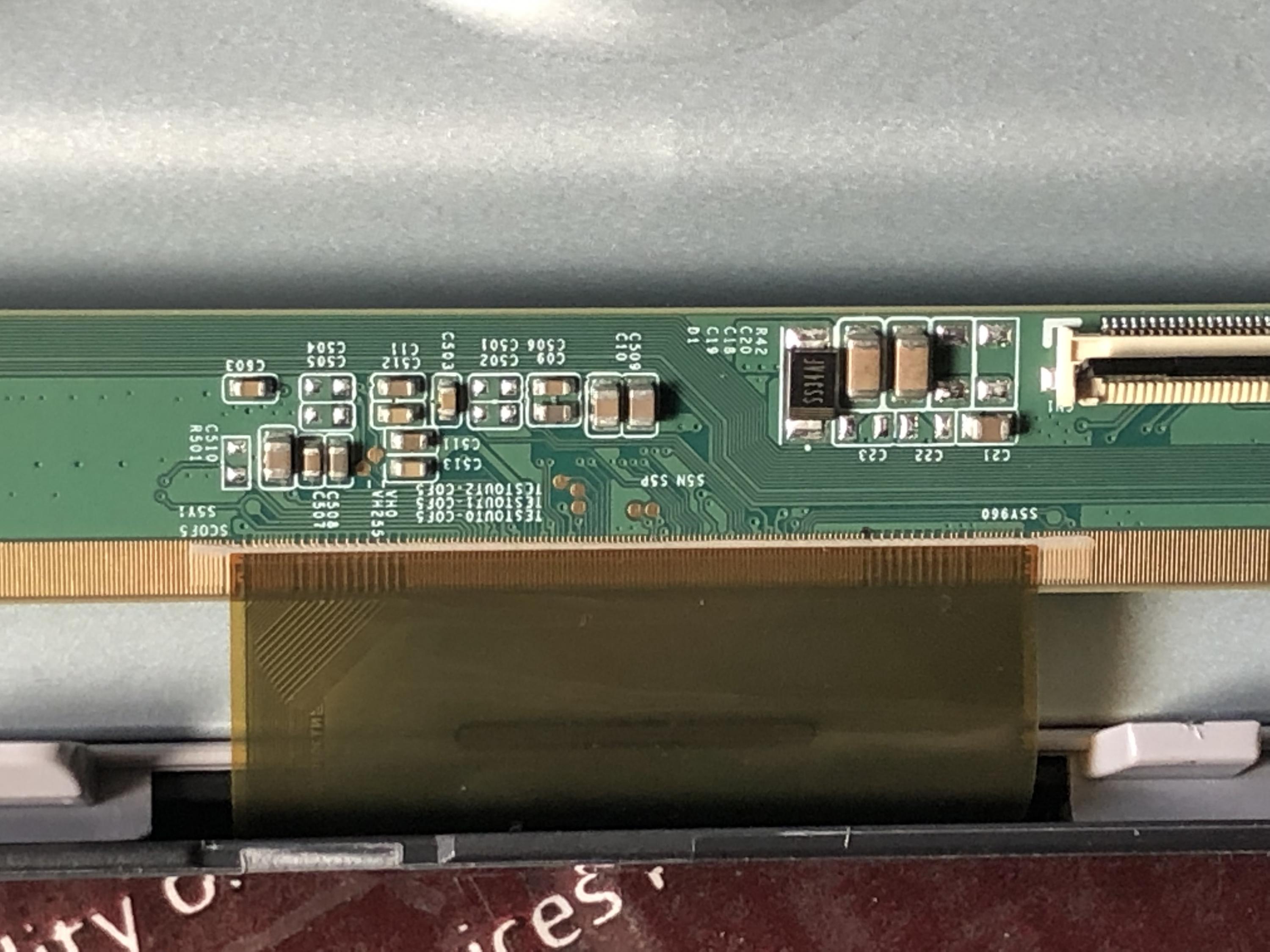

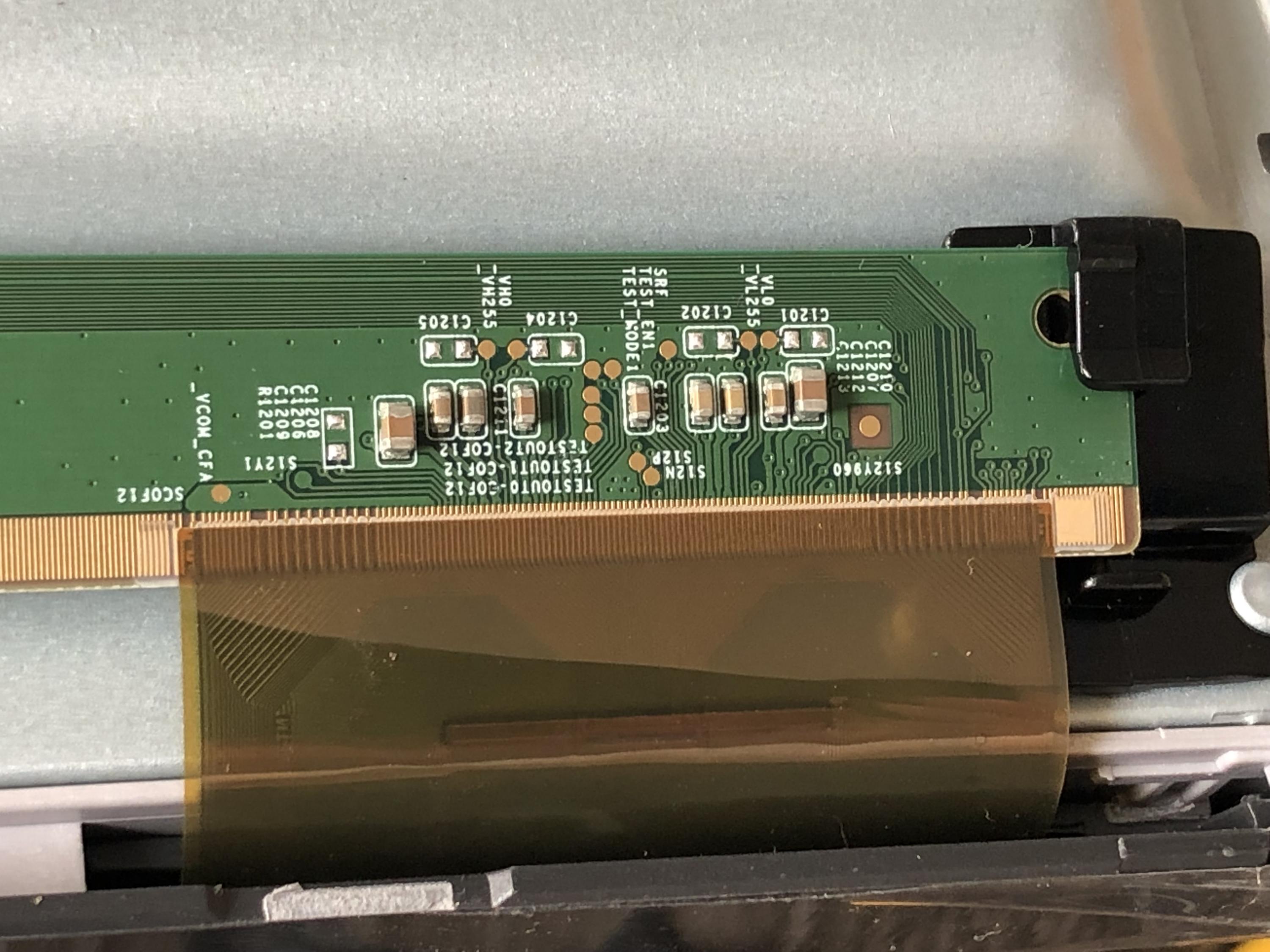

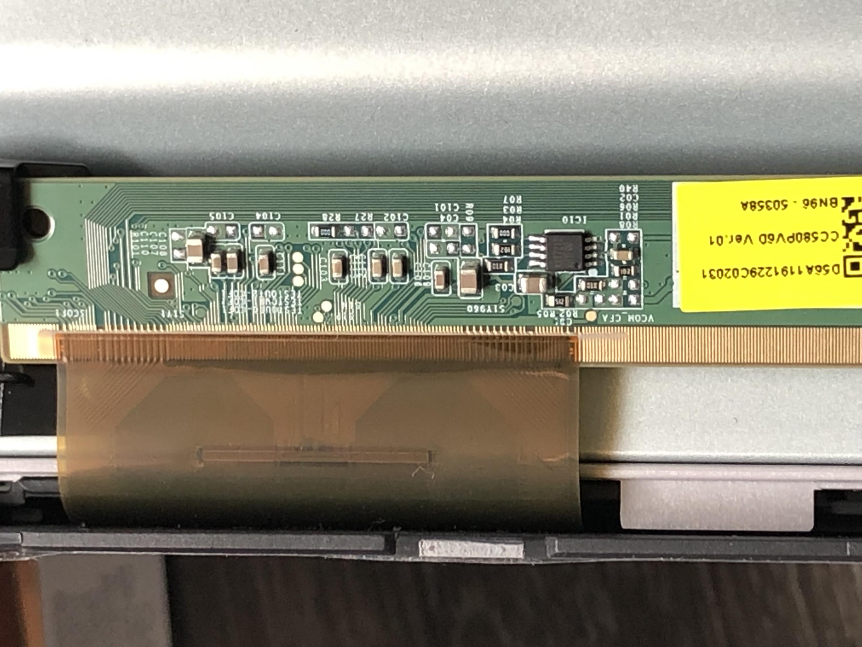

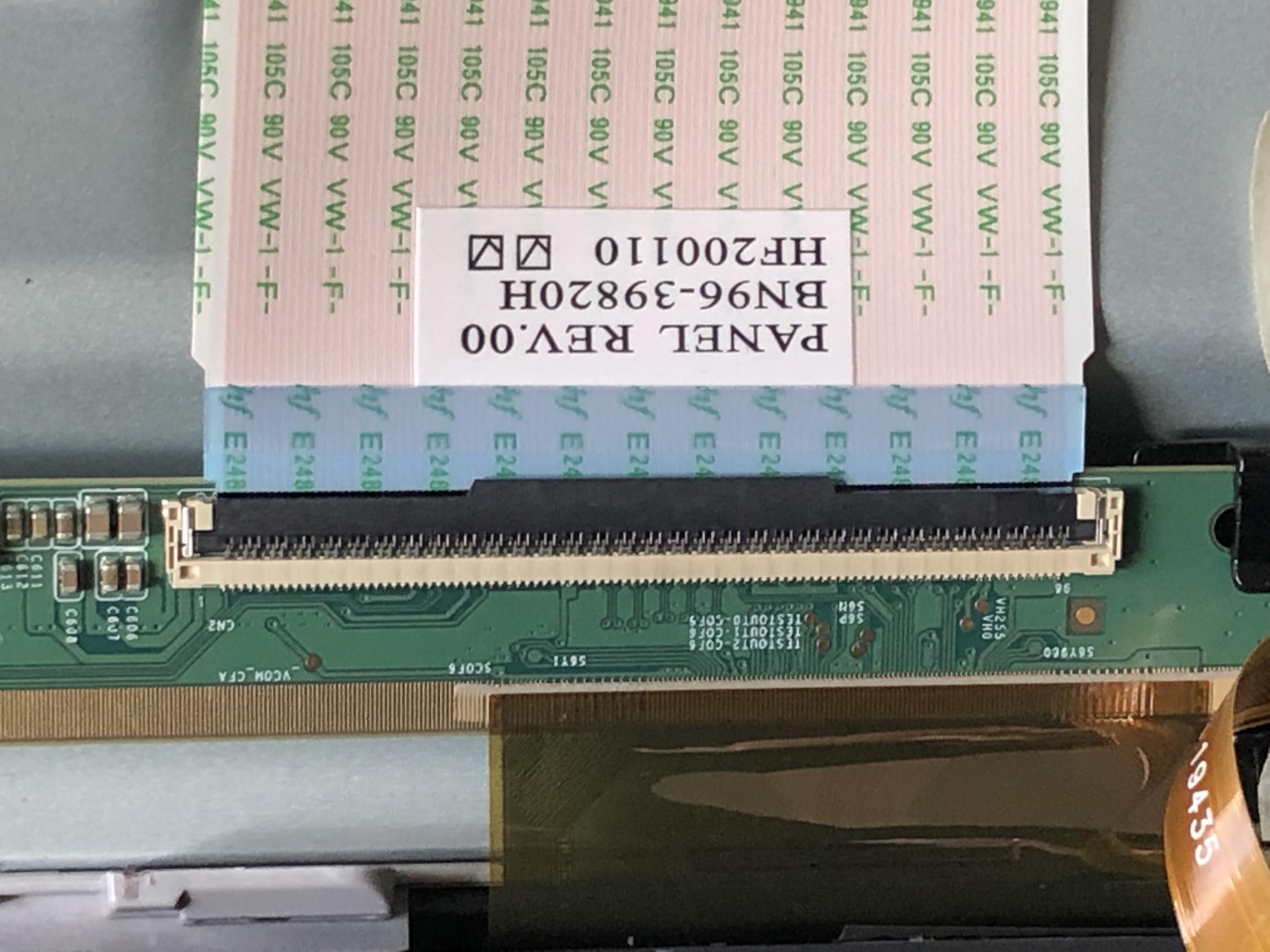

        • alfatv
          • Sep 2020
          • 353

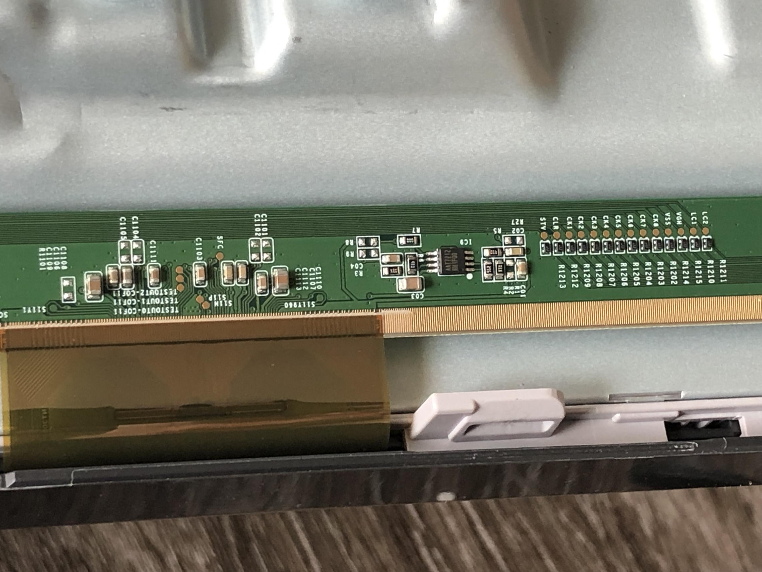

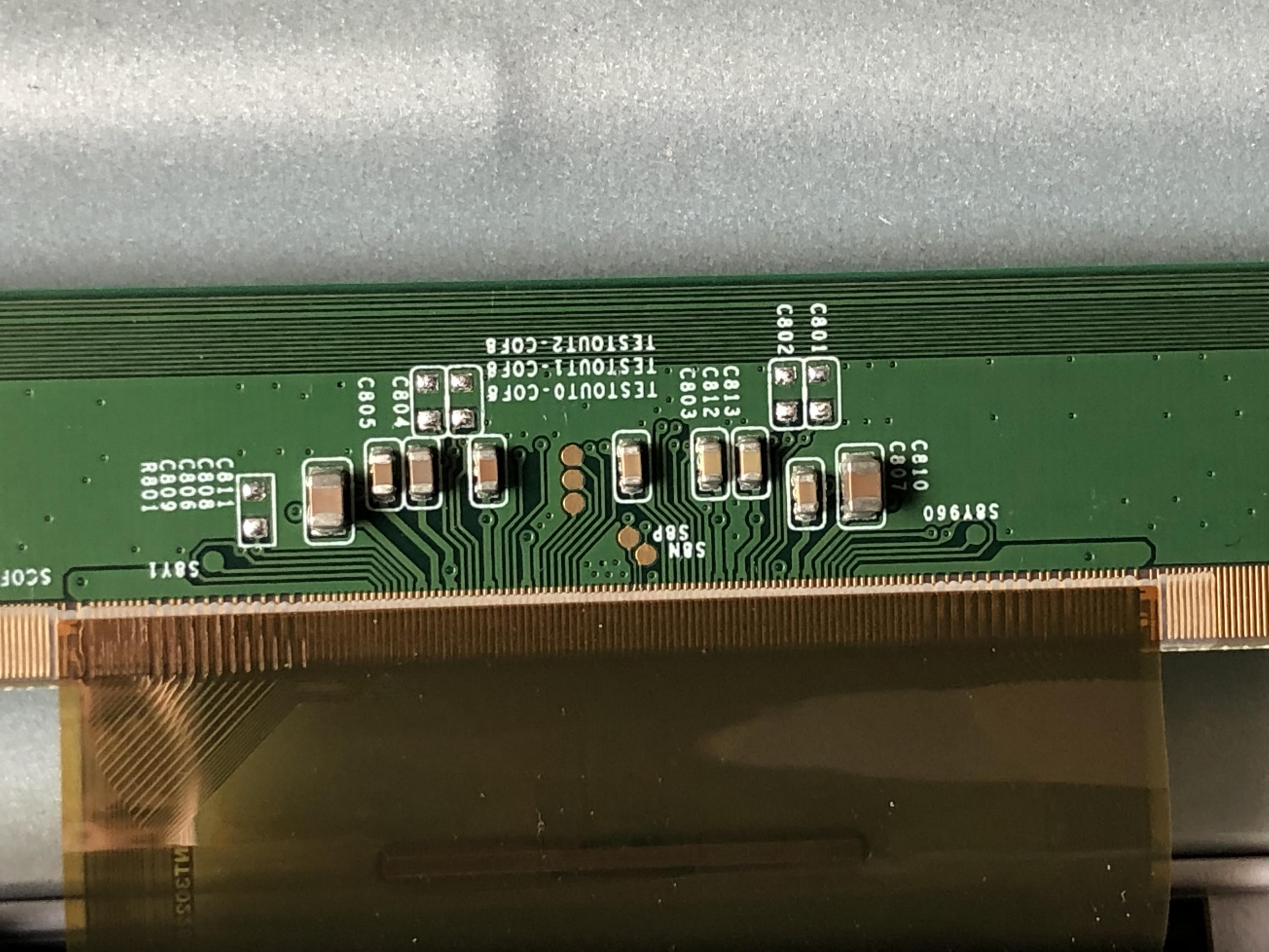

          Left side (looking from the back)

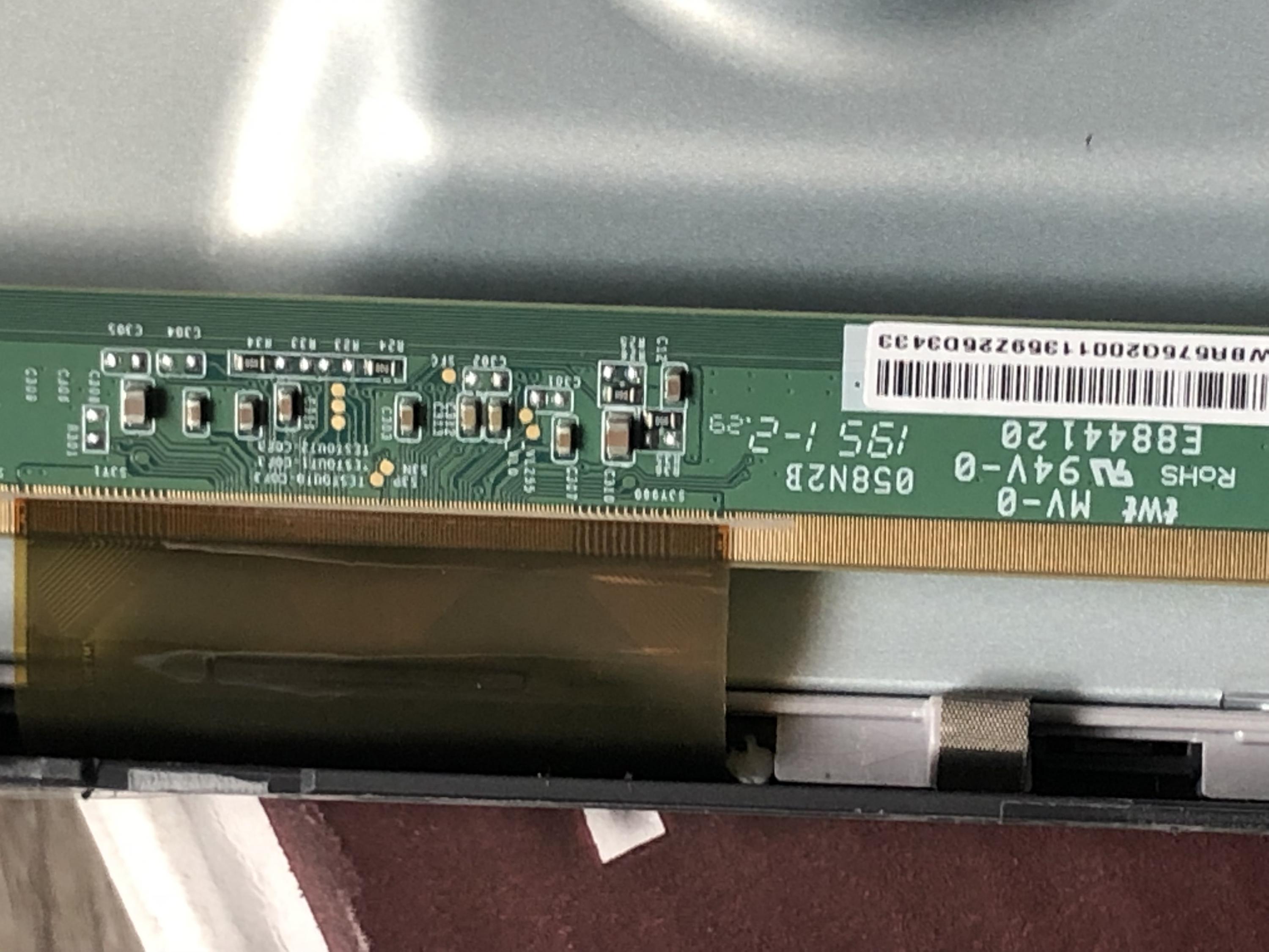

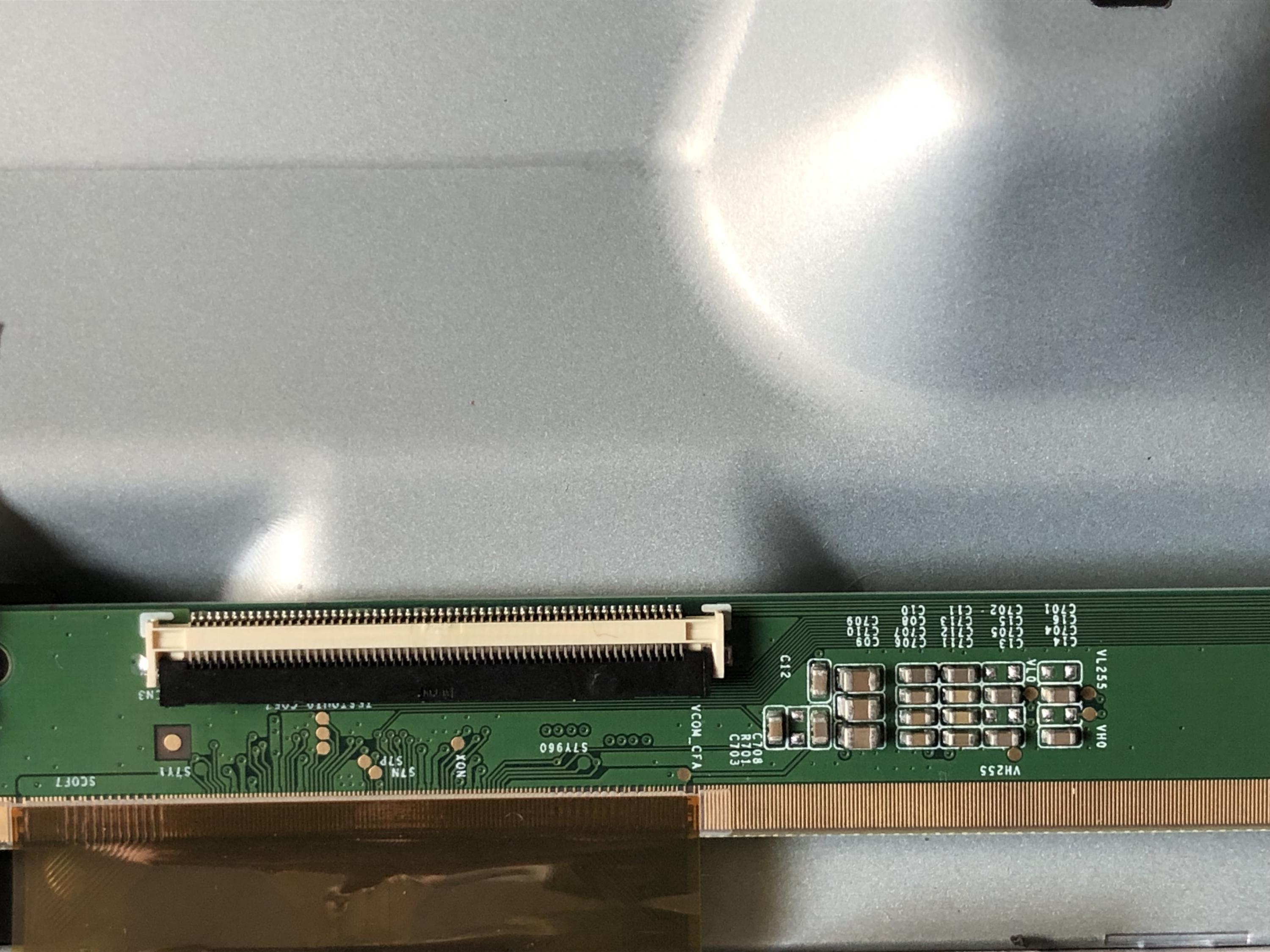

          • alfatv
            • Sep 2020
            • 353

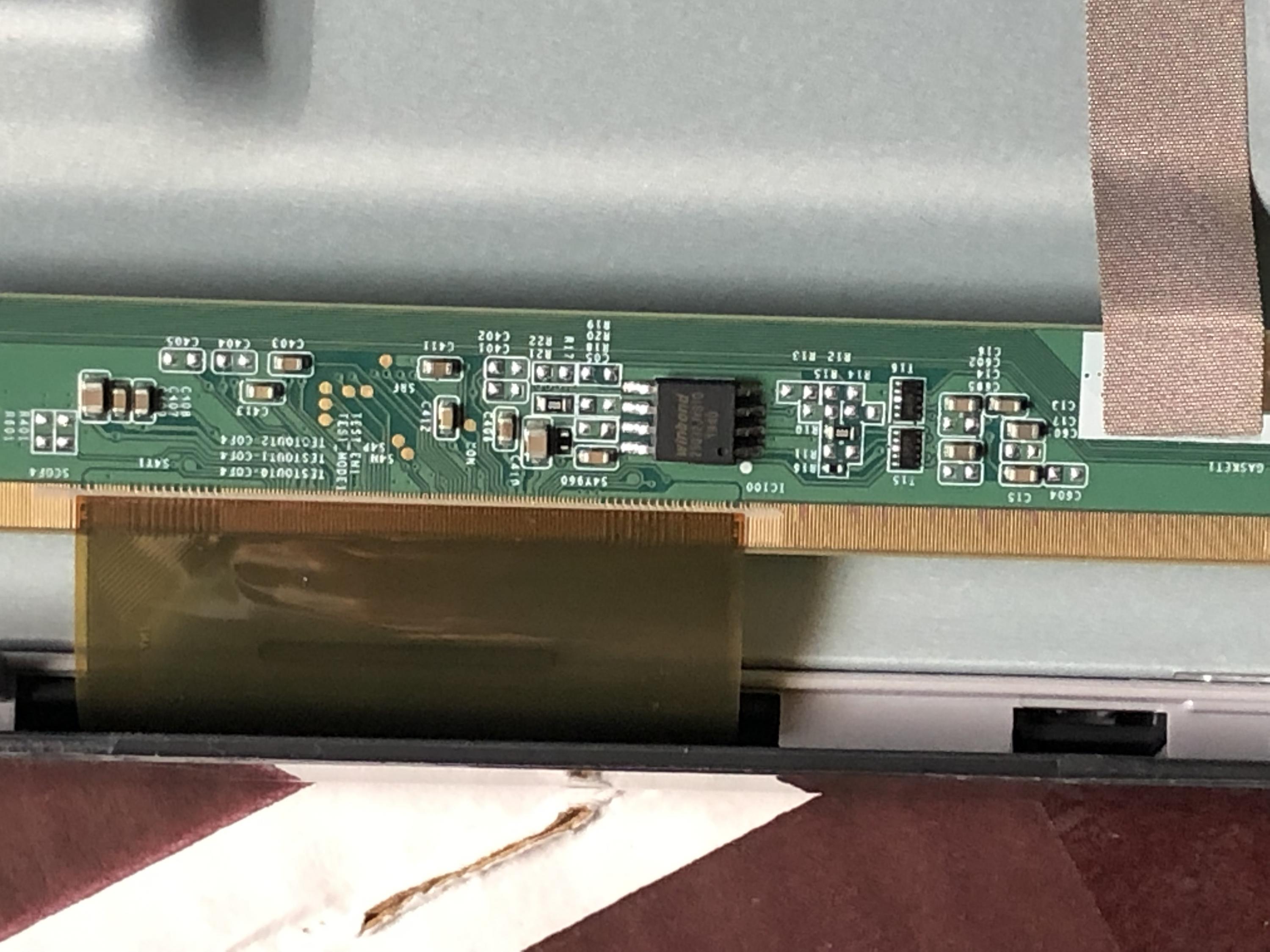

            Right side (looking from the back).
            TV boots up with this side disconnected, there is backlight, but no image

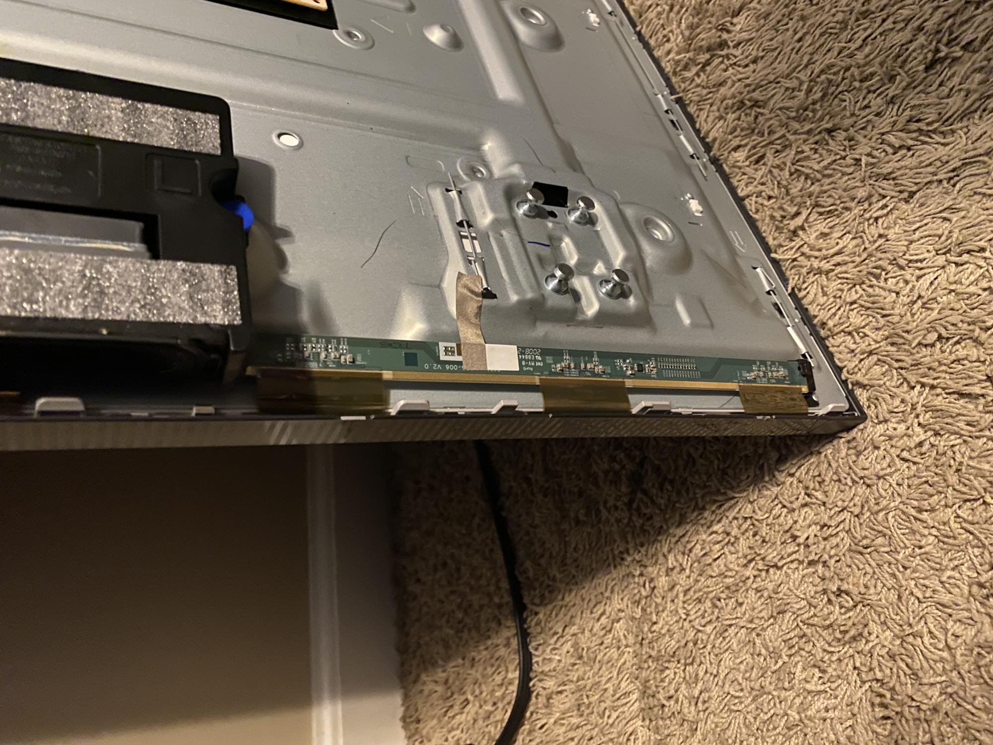

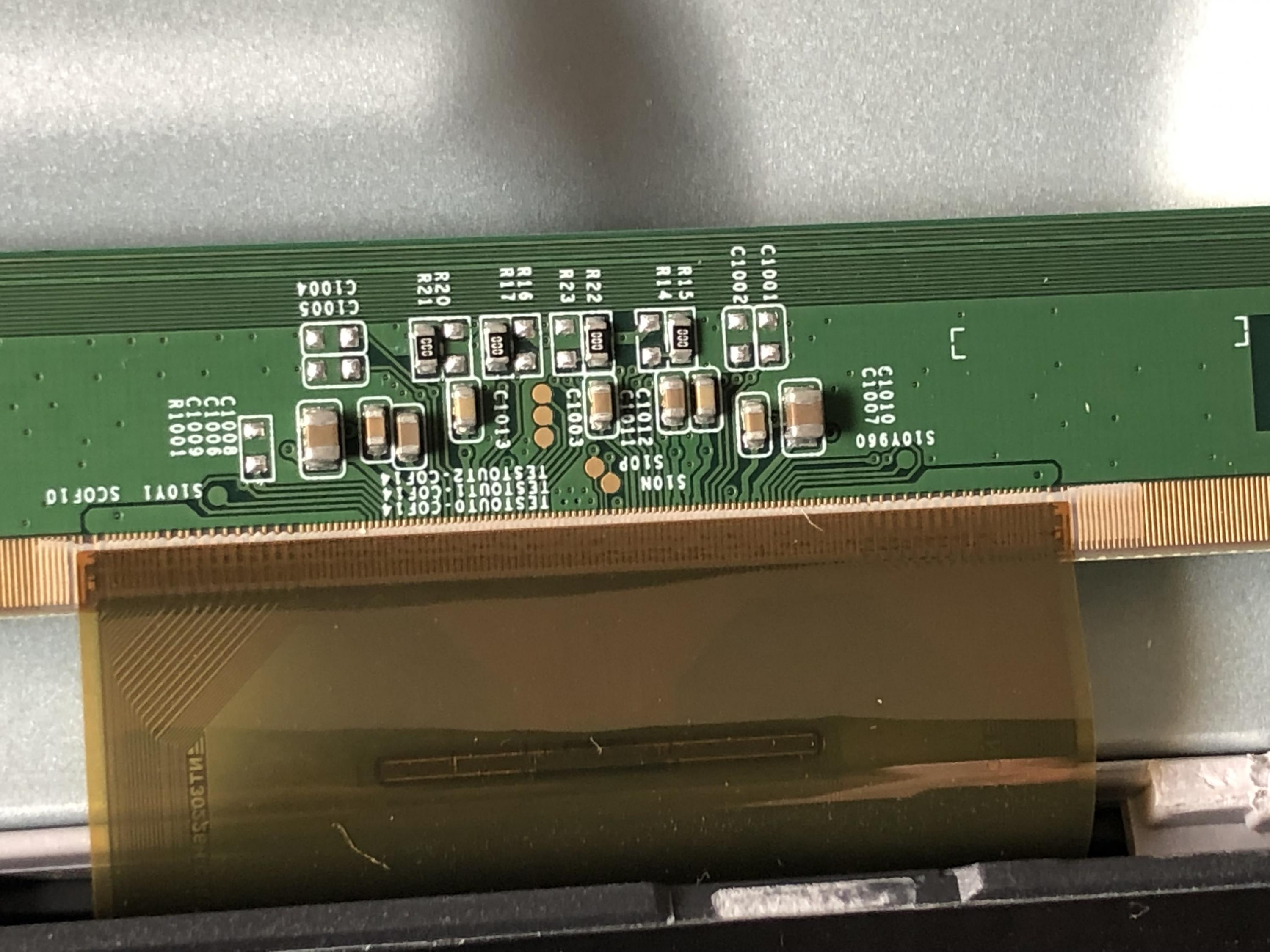

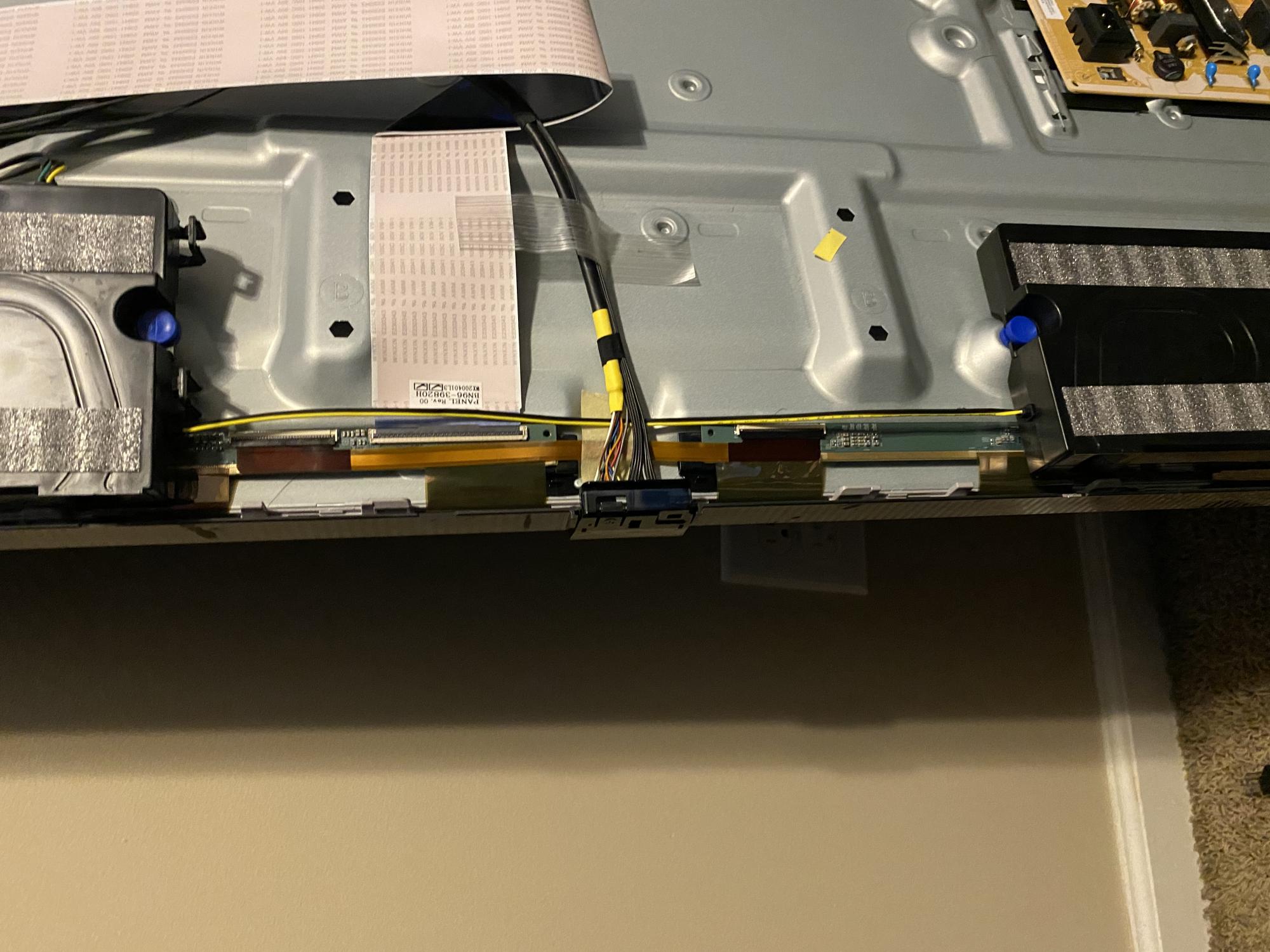

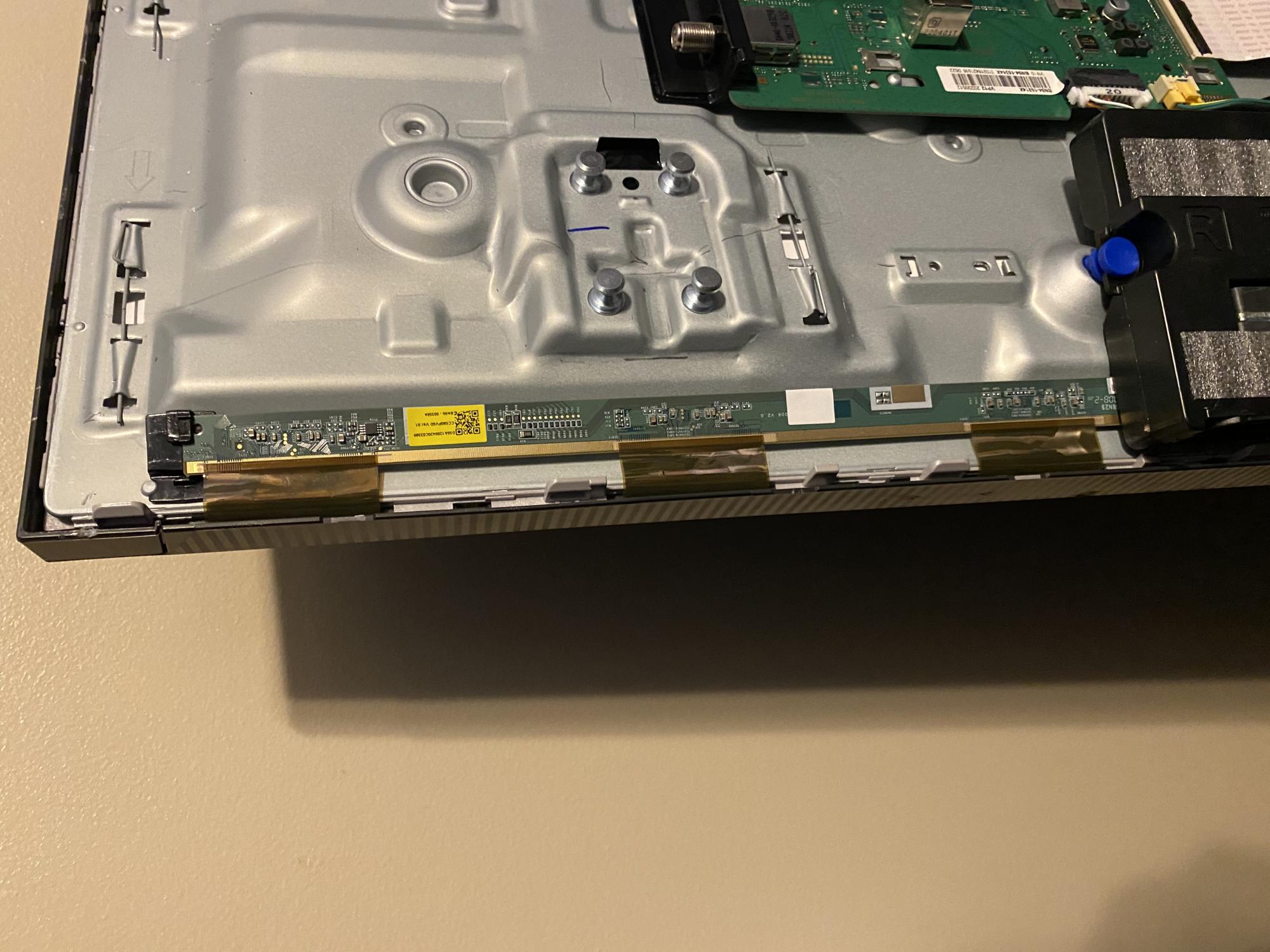

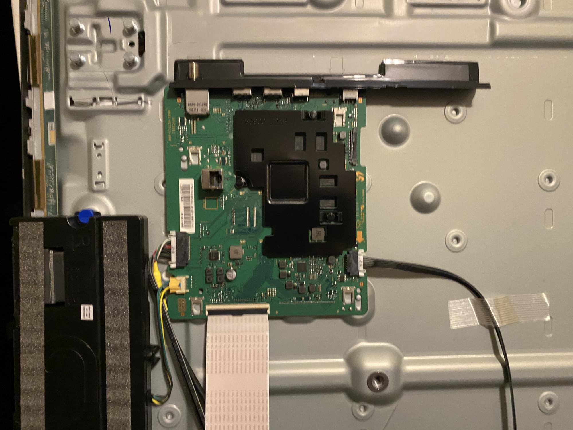

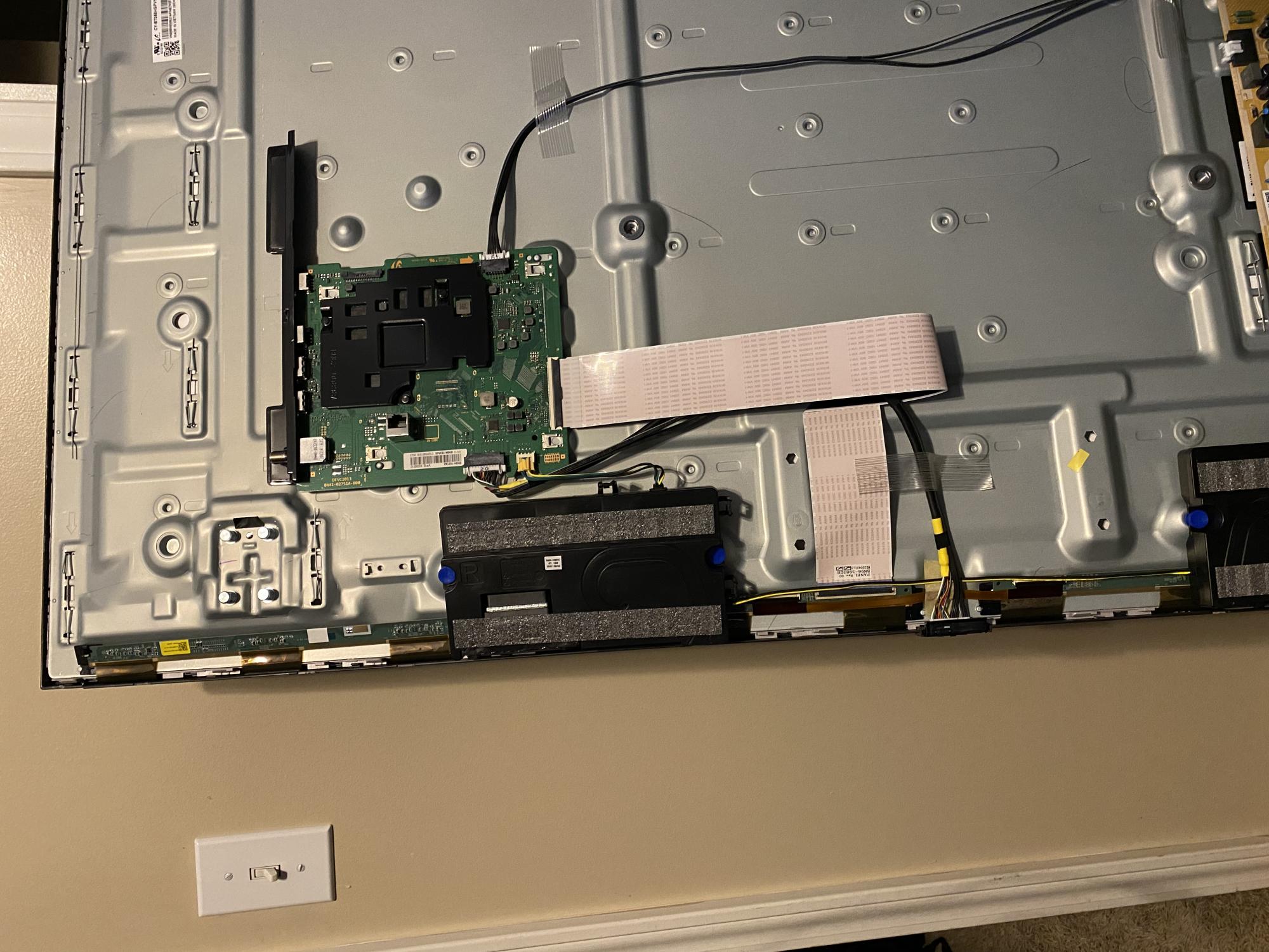

              Sorry for the delay. I usually get notifications on comments / replies, but I didn't receive any for this post (unless it happened to go to my spam folder).
              Here are some pictures of the TV. Let me know if you need more up close pictures. Thanks for your help!
                  If you disconnect the cable between panel boards, does TV stay on?
                      So did you check for shorts on bottom boards? Voltages?
                            No picture with cable between sides disconnected, but TV stays on.
                            Anyways I got image to show up with scotch tape, however the brightness on bad side goes up and down every second or so.
                            Also found this discussion, looks like similar issue:
                            https://www.reddit.com/r/TVRepair/co...000f_bootloop/
