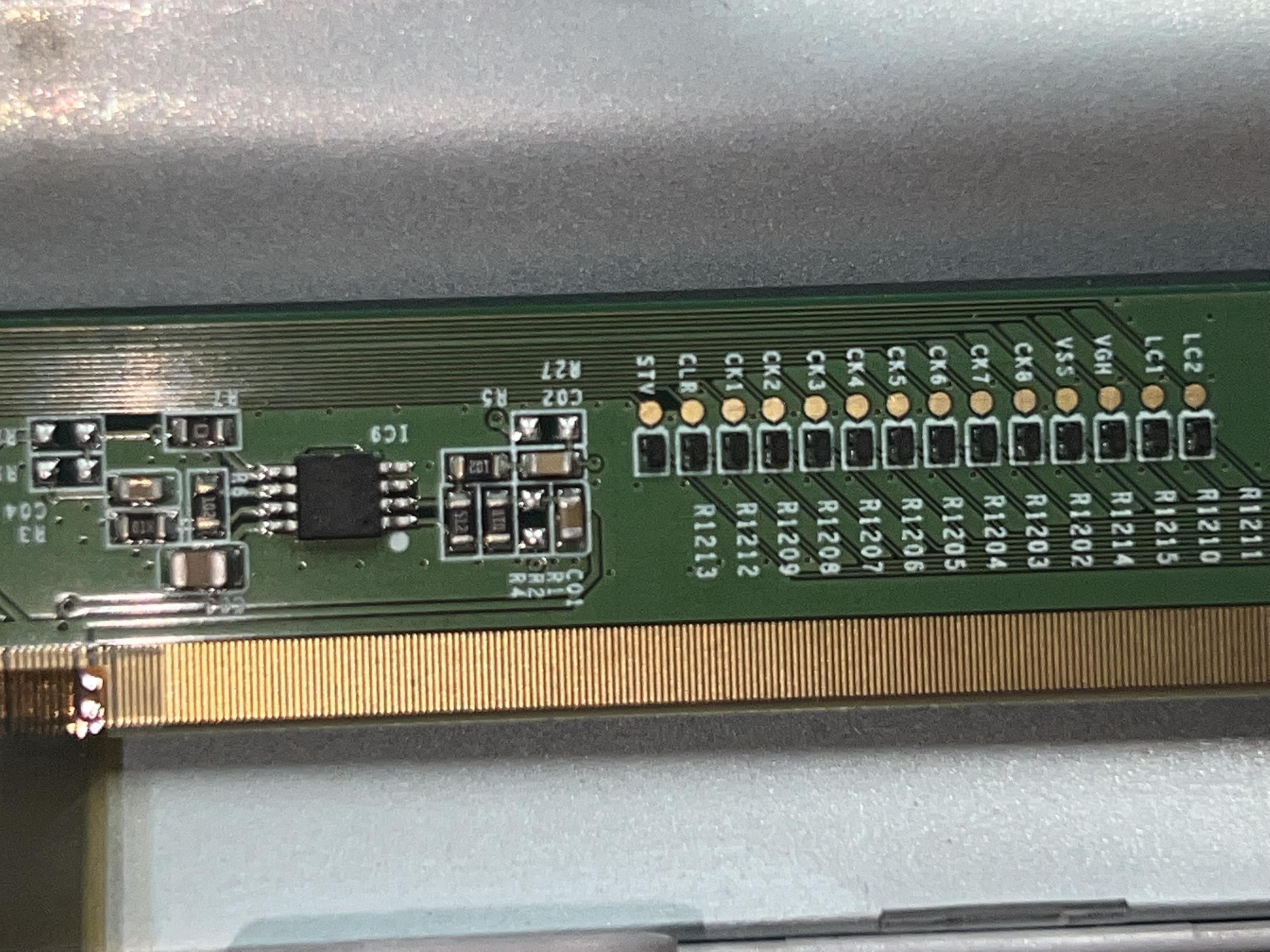

          Yes. But on this set, these ic's don't exist, instead i have very small ic's which i can't identify without the microscope, very tiny.
          See picture again, beside each line there's small ic's there. I tried measuring, but didn't go far. Very tiny stuff, waiting for headband microscope to arrive..

                wonder if IC9 is ok, can you see the numbers to bring up a datasheet?

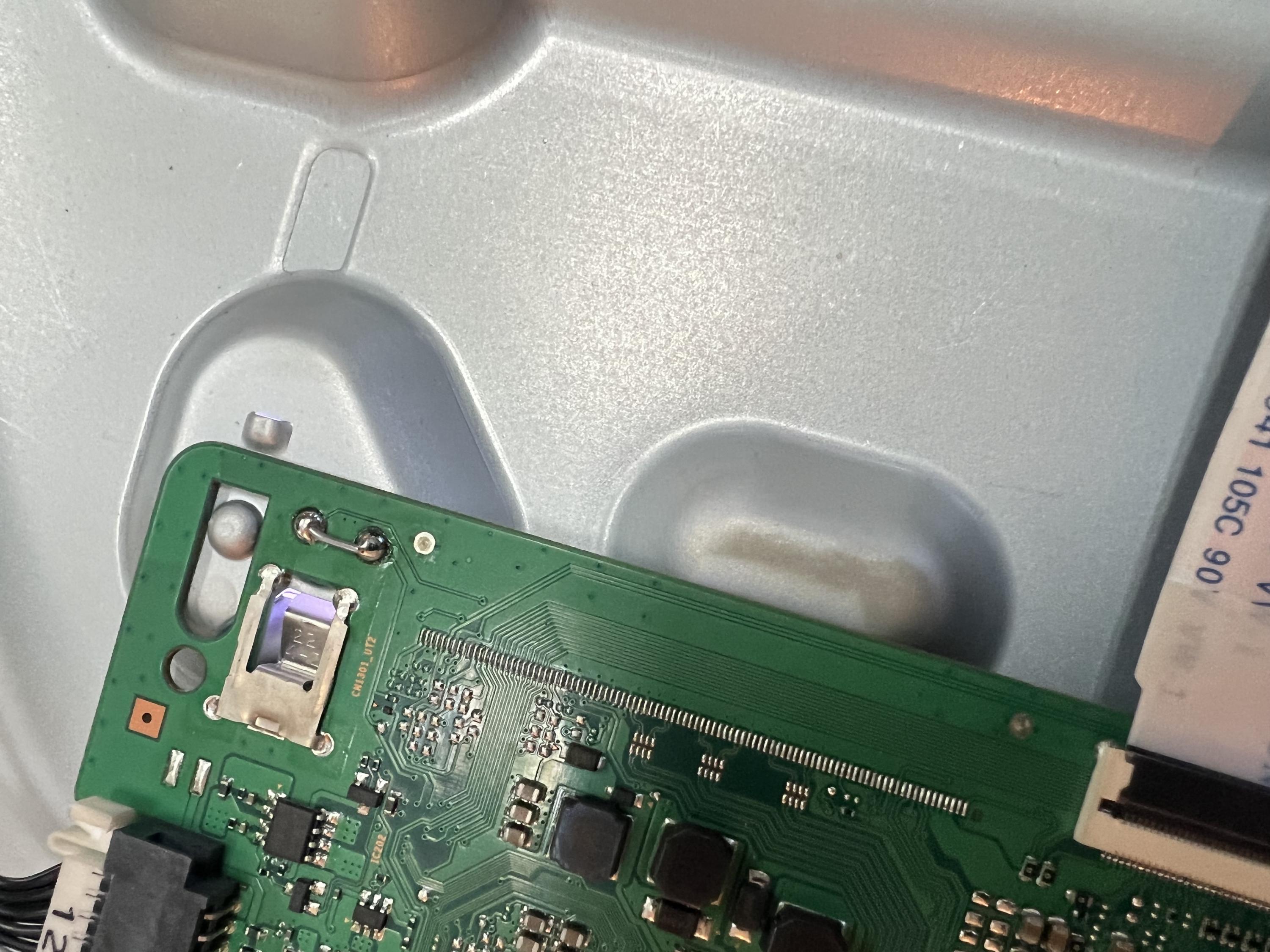

                      Ok, so i got the schematics for the panel on this one, it's a panda CC580PV6D.
                      Here it is. I'm trying to find out, the taping method, it some of the clock lines that they are blocking ?

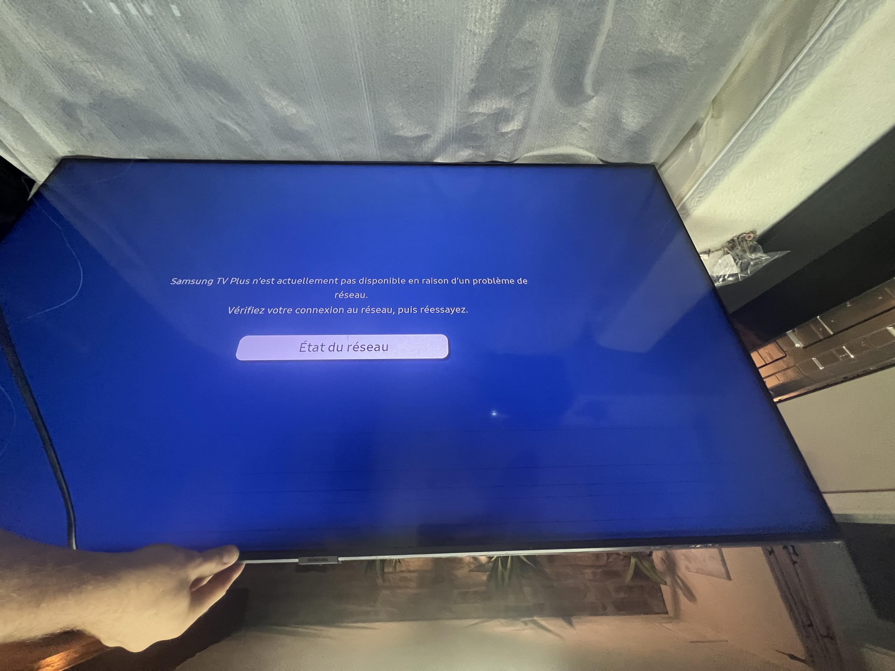

                            Ok, so after leaving the set on for a while it powers on without an issue, having everything put back to stock, with the jumper removed.
                            Is it because the set is hot that it struggles less ?
                            Anyhow, here's a picture of what it looks like. I don't understand, removing the small U bridge from the left side of the tv was having it not shut down, but the problem seems to be on the right side of the tv, this is where the main flex arrives from the mainboard. I'm confused.
                            I'm really confused now.

                              its usually only one side, do you have a picture of the u bridge, so we can be sure it's the same thing.
                                #75
                                Re: Samsung un58tu7000fxza - Power cycles with no picture, only backlight
                                Yes, it's shown here : https://www.badcaps.net/forum/attach...1&d=1639633179

                                    Ok, so from the service menu it seems clear that the problem lies on the right side of the pcb, being the left side of the screen.
                                    OP, here's some good videos that show how to fix it, if you want to take the time to do so;
                                    https://www.youtube.com/watch?v=cwxSK4JGMg4
                                    https://www.youtube.com/watch?v=5PPPeFjplIU
                                    Basically, isolating the CK1-8 lines that are problematic

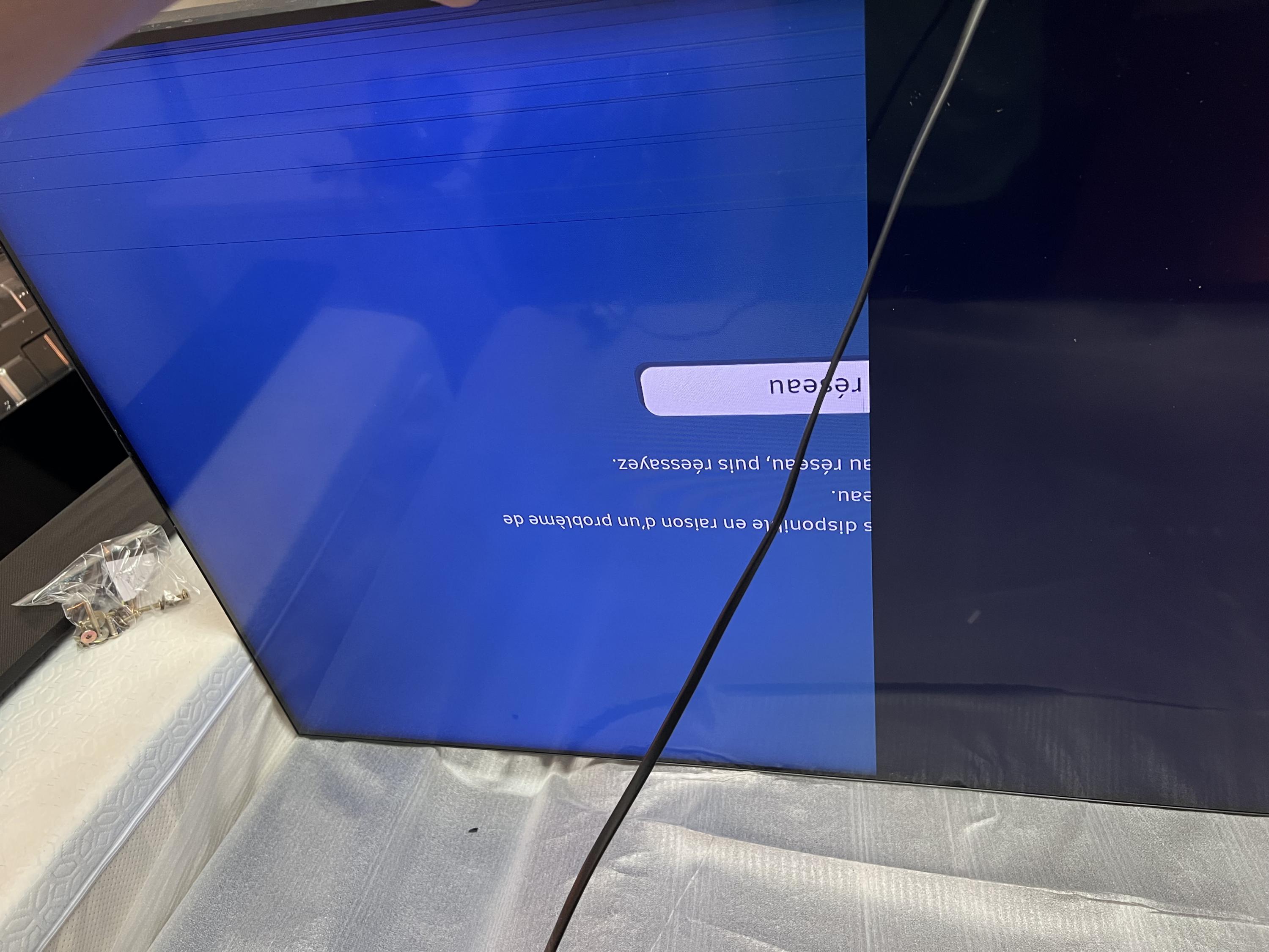

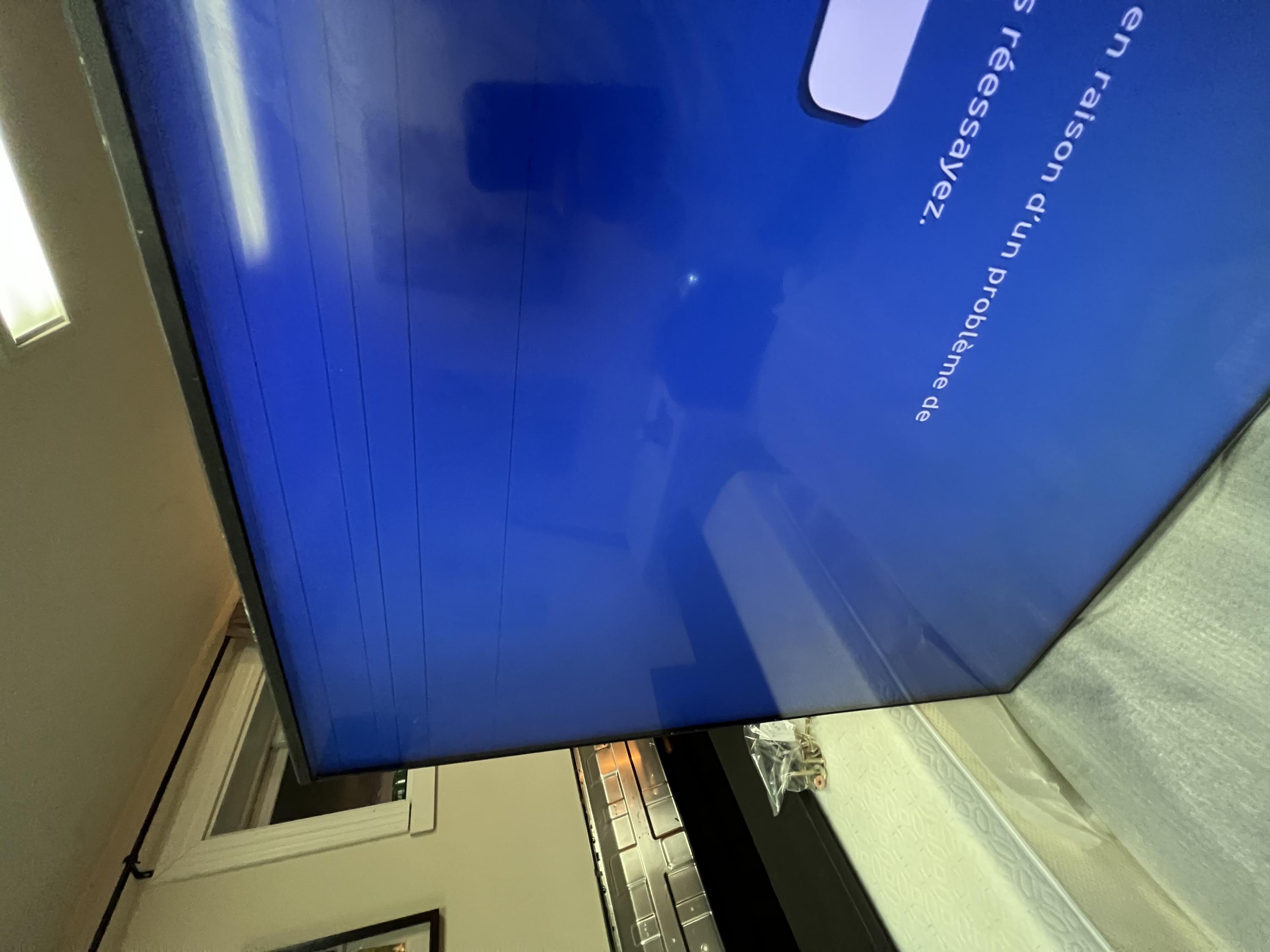

                                      Here is what mine does now, idk why it came back to life after messing a lot with it.
                                      Would removing the faulty CKx line off the pcb remove these lines, are they caused by a short in the panel itself ?
                                      I can't tell myself from the current screen.

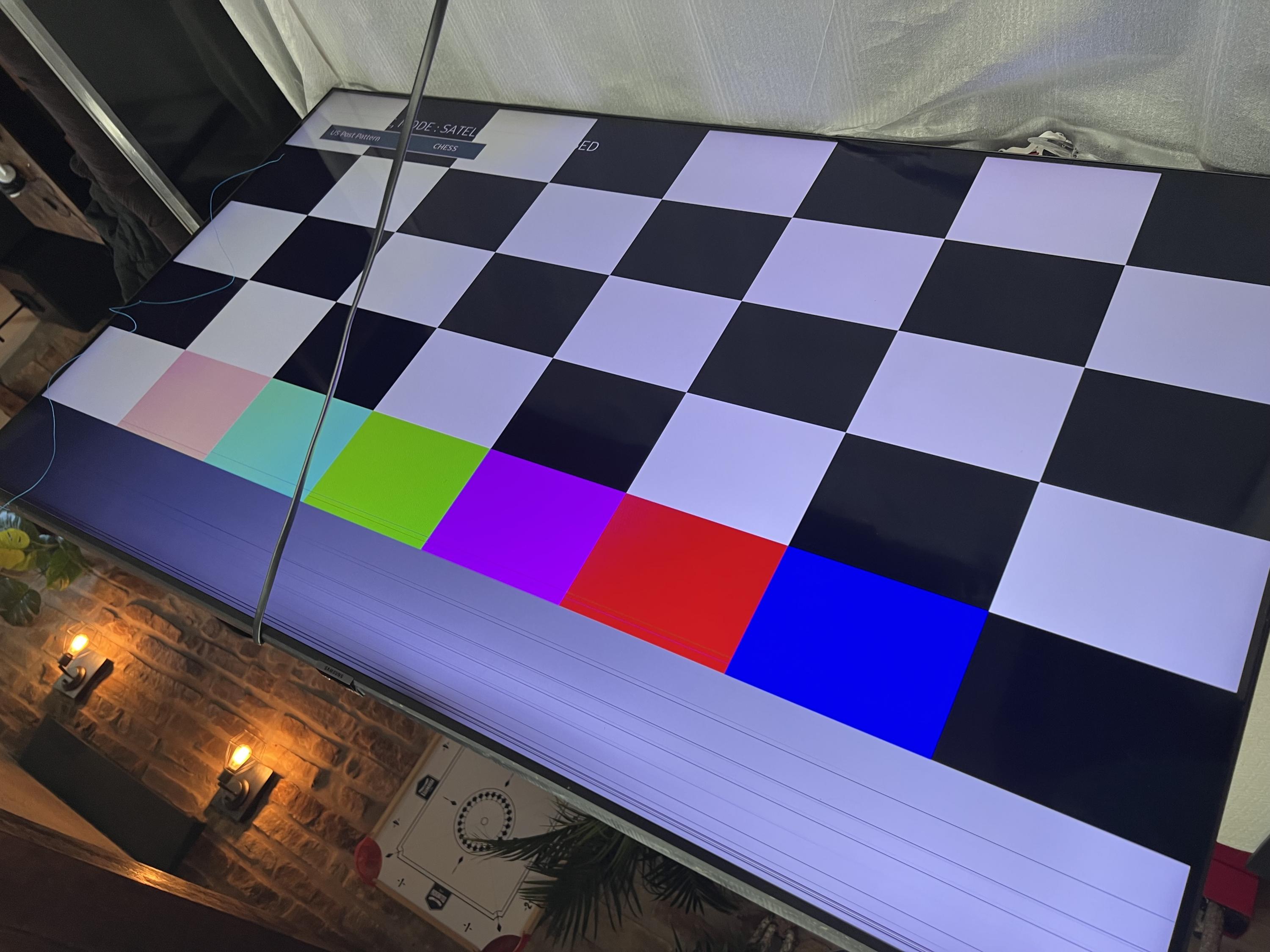

                                        Ok, it doesn't make sense to me.
                                        I found there a way to enable the video with that jumper (shown on pic) on half of the screen even with the U connector to the panel removed.
                                        I still get these lines on the screen, even with the left side of the screen turned off.
                                        So, it means these lines actually come from this side and this is where the issue is ? Im really confused, with all the screen on with the test patterns, i was under the impression that the other side was the culprit.
