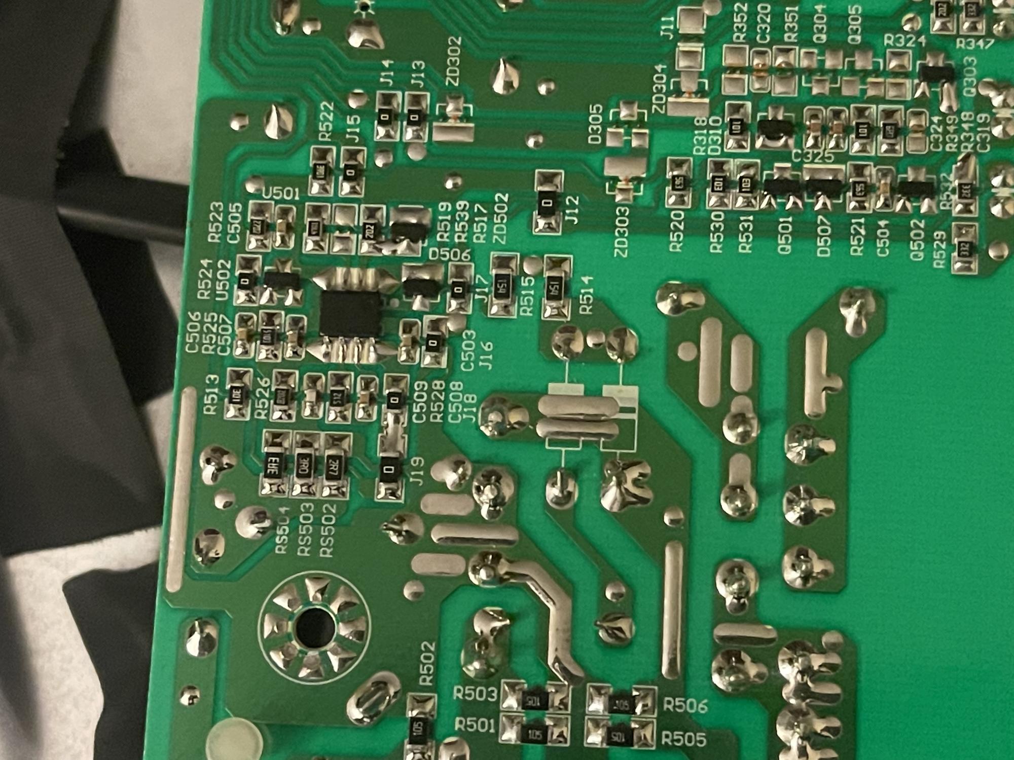

    RCA RLED6090 backlight goes affter 10 minutes
    I have this rled 6090 led tv which has this backlight issue, When I change it to energy saving mode and tv works fine , All the other mods has this issue. I have entered the service menu by pressing input + 2580 and reduced the backlight to 50% . But as soon as I exit from that service menu it goes back to higher levels. (Since there is no options to save it) . There is a small ic near led drive section a dual opamp , as358m . Is it serves as a controller for backlight? How do I reduce the backlight level using an increased current sense resistance or something like that? The psb is ER991D
    Checked both the led strip end and both works with same 170v .
    Thanks in advance

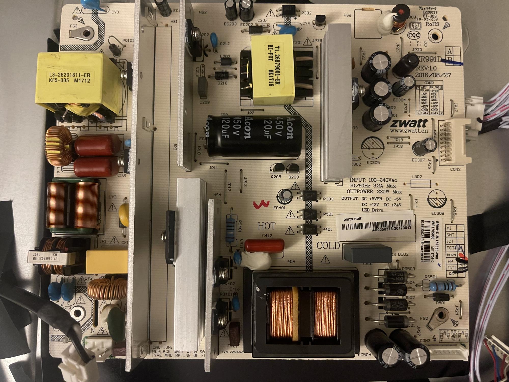

                You have 2 possibilities here:
                1. Proper repair
                2. Band aid
                For #1 you need a good LED tester with high current. Check each strip separately, the bad one should have at least higher voltage drop or maybe even go open. Then with this method you can find that single LED.
                For #2 you can just use eco mode. If you reduce current, the effect will be almost the same.
                If you really want to lower the current, I think R5501 is current sensing resistor.

                  Thank you so much, I will try to modify the current sensing resistor. So do I need to increase its value? (It is a 0.8 Ohm resistor so how much do I need to change its value? )The customer is happy to repair it cheap but he need a bit more brightness than eco.

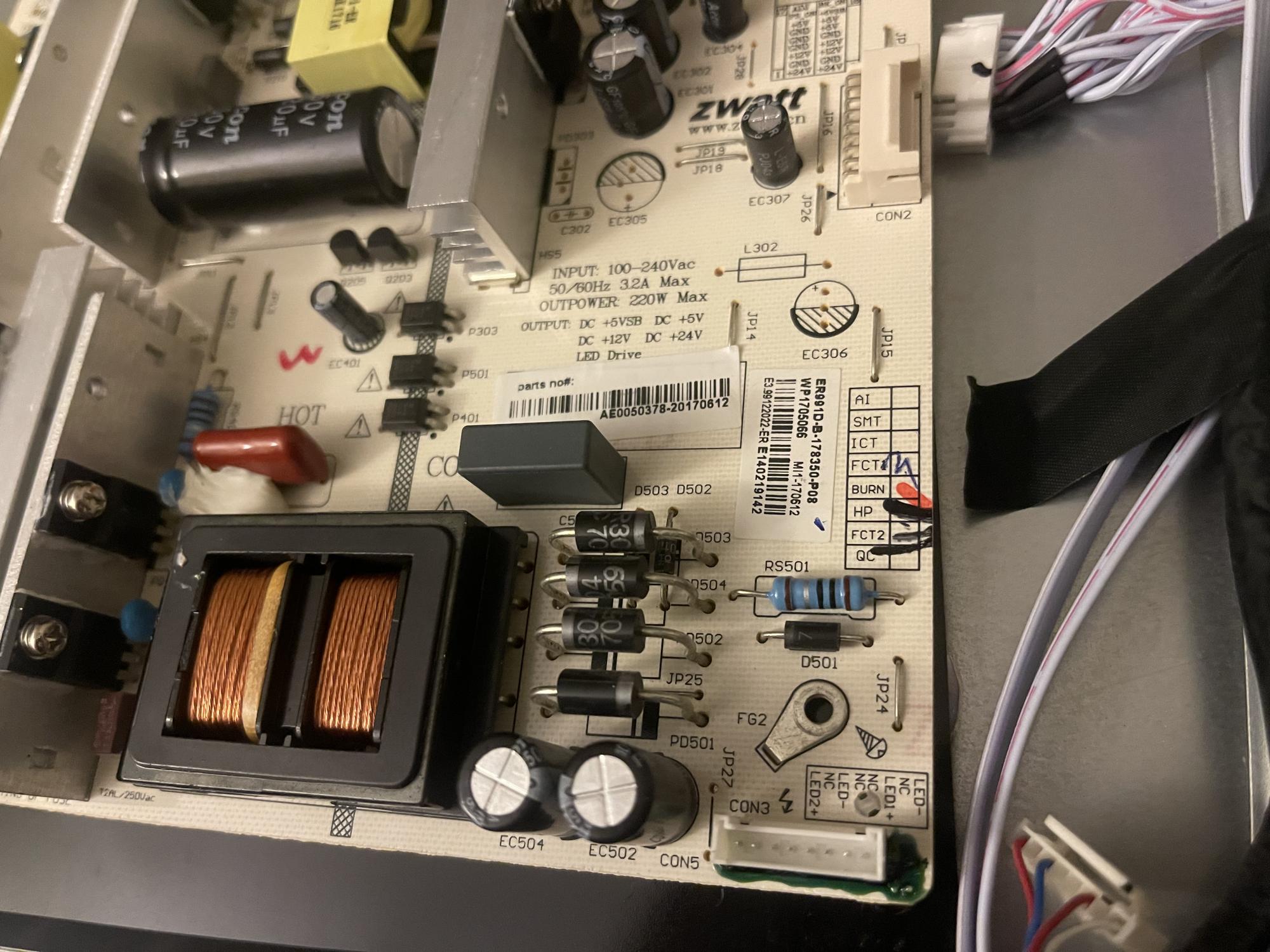

                      For those who have similar issues here is the fix, I have added 3x 0.6 ohm 2 watt resistors (I didn’t have any 2ohm single ones) in series with R5501 and It works great. Your human eye will never notice any difference at all , and its brightness setting is still in the middle and sufficient for my happy client . I did increase the brightness to 80% and it still worked without any issues.

                                Did this finally stop the backlight from going off? My RCA RTU6549 (Canadian model 4K likely from Walmart) also goes off but not at the same times.
                                Is heating up causing a separate problem or? Also, where the voltages to the mail board are marked 24v on this board but the output is actually 12v on both pins. The TV works fine but then shuts off the screen and the sound stays on. I cannot see a faint image at all.
                                I replace the resistor(2 in series) in question to 2.3 ohms. In the circuit the value it measures is only 0.3 ohm. The diode is good.
