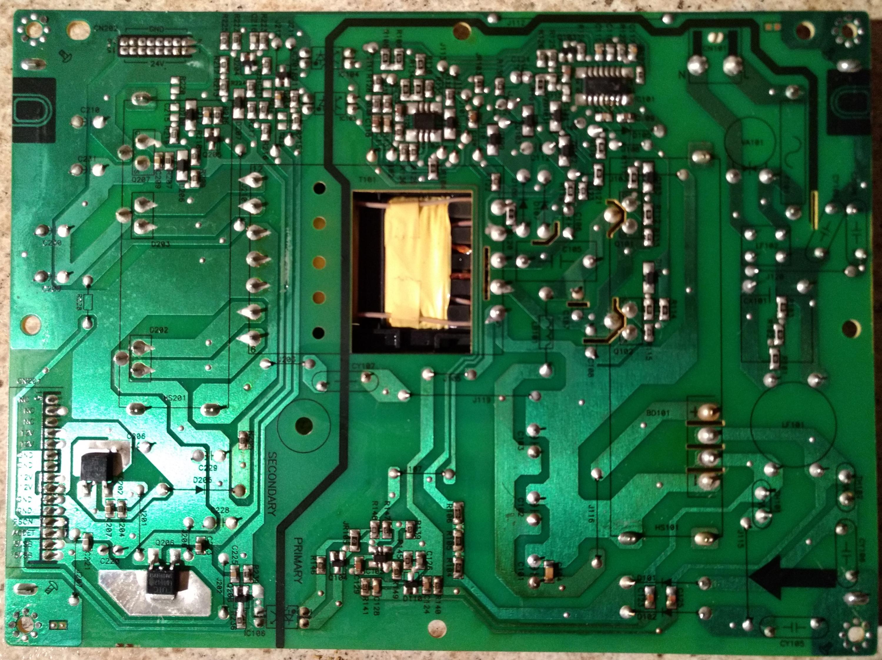

    I picked up this Vizio E400i-B2 with no stand-by light and diagnosed it with missing stand-by voltage. I found a Power Supply at ShopJimmy, installed it but it didn't work properly. SJ refunded the transaction and did not ask me to send the board back.
    So I took some voltage readings upon the original board. Here's what I found:
    Main caps have 169.9v
    AC detect voltage is 1.3v
    None of the MOSFETS appear to be short.
    The opto (IC106) that appears to have something to do with stand-by voltage has 3.0 volts on terminal 1 and 1.0 volts on terminal 2 on the hot side of the PS. No voltage is present on the cold side of IC106. Terminal 4 of IC106 traces to Q206 which traces to both stand-by terminals via the center pin. I'm not sure if this has anything to do with the problem.
    I'd like some help diagnosing the problem please.

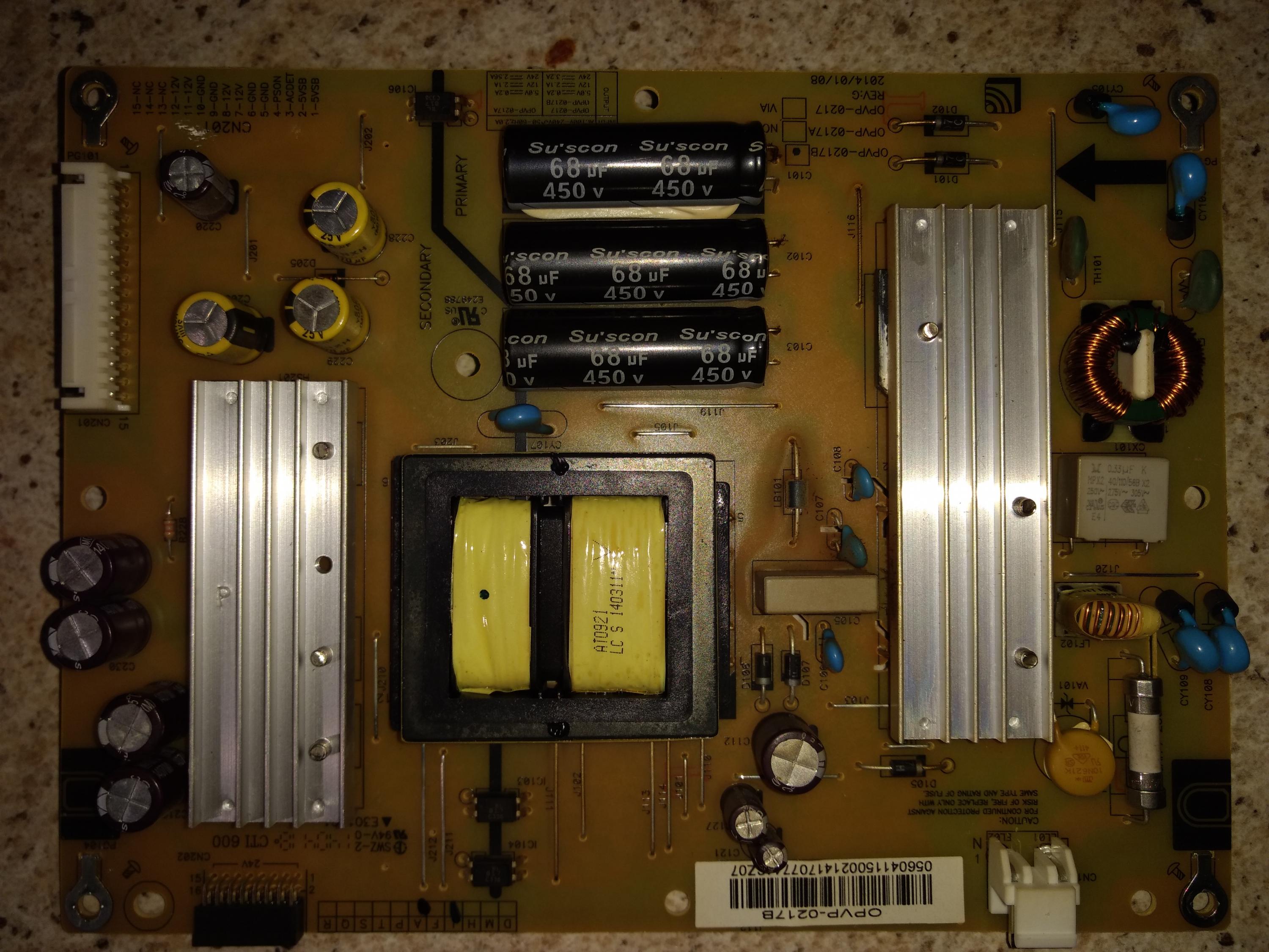

          Re: Vizio E400i-B2 missing stand-by voltage
          With the psu plugged in, do you get 5VSB on the psu (your 2nd pic, very top left connector)? If not unplug the main board and see if it is there now.
          • DXseekerMO
            • Feb 2018
            • 1119
            • US
            Thanks for the reply, I have the PSU out of the TV and only plugged in to the wall. There is no stand-by voltage.
              Then that psu is bad if it’s plugged in with the main board disconnected. Now follow the trace of the 5vsb from the connector backwards to the diode then over to the hot side of the psu all the way back to the bridge rectifier.
              Your picture isn’t sharp enough for me, but I could follow it back past the transformer.

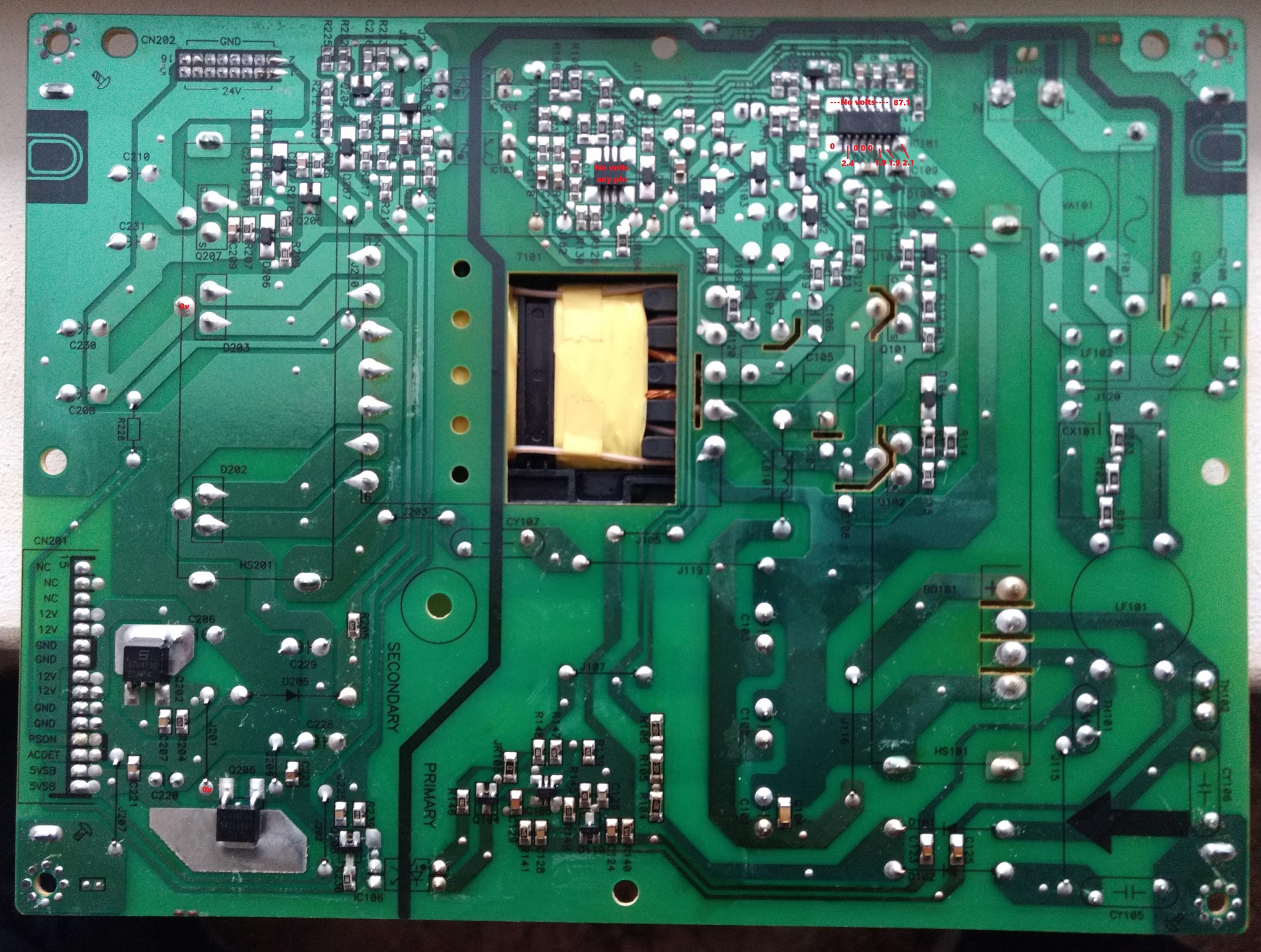

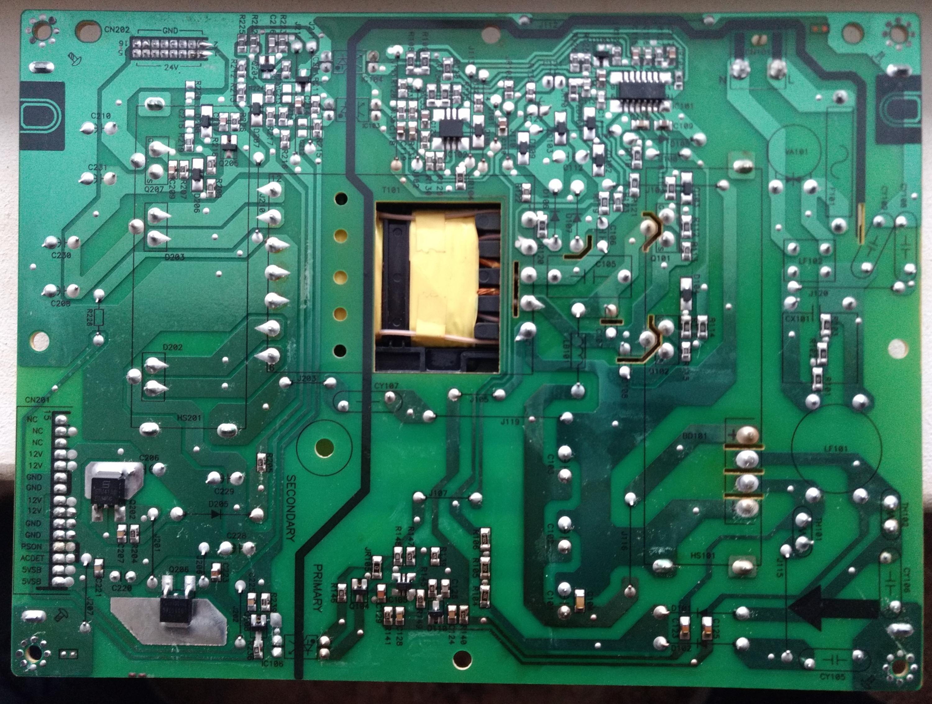

                    Originally posted by R_J
                    This is an always on power supply, when plugged in you should have voltage on J201 (likely around 15~18v) And also voltage (around 30v)on D203 cathode (center pin)
                    If there is no secondary voltages, the problem is likely on the primary side so post the numbers of the two ic's (8 pin & 16 pin) and even the 6 pin ac_det ic if possible.
                    Please see attached image. Enlarge it to see voltages found.
                    They call me......."threadkiller"
                    • R_J
                      • Jun 2012
                      • 9624
                      The voltages mean nothing I you don't post what the ic's are
                      You are using HOT ground for these voltages correct?

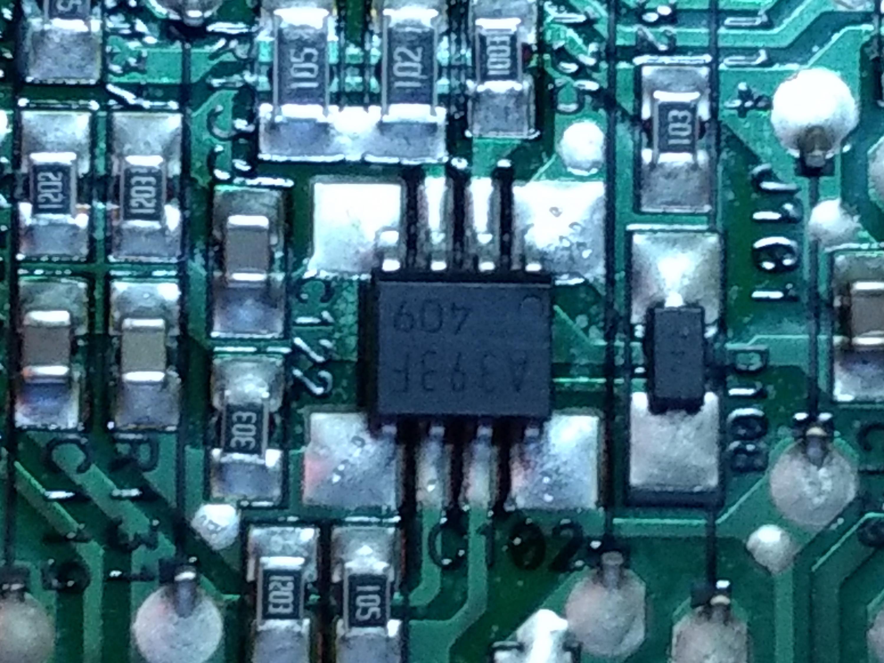

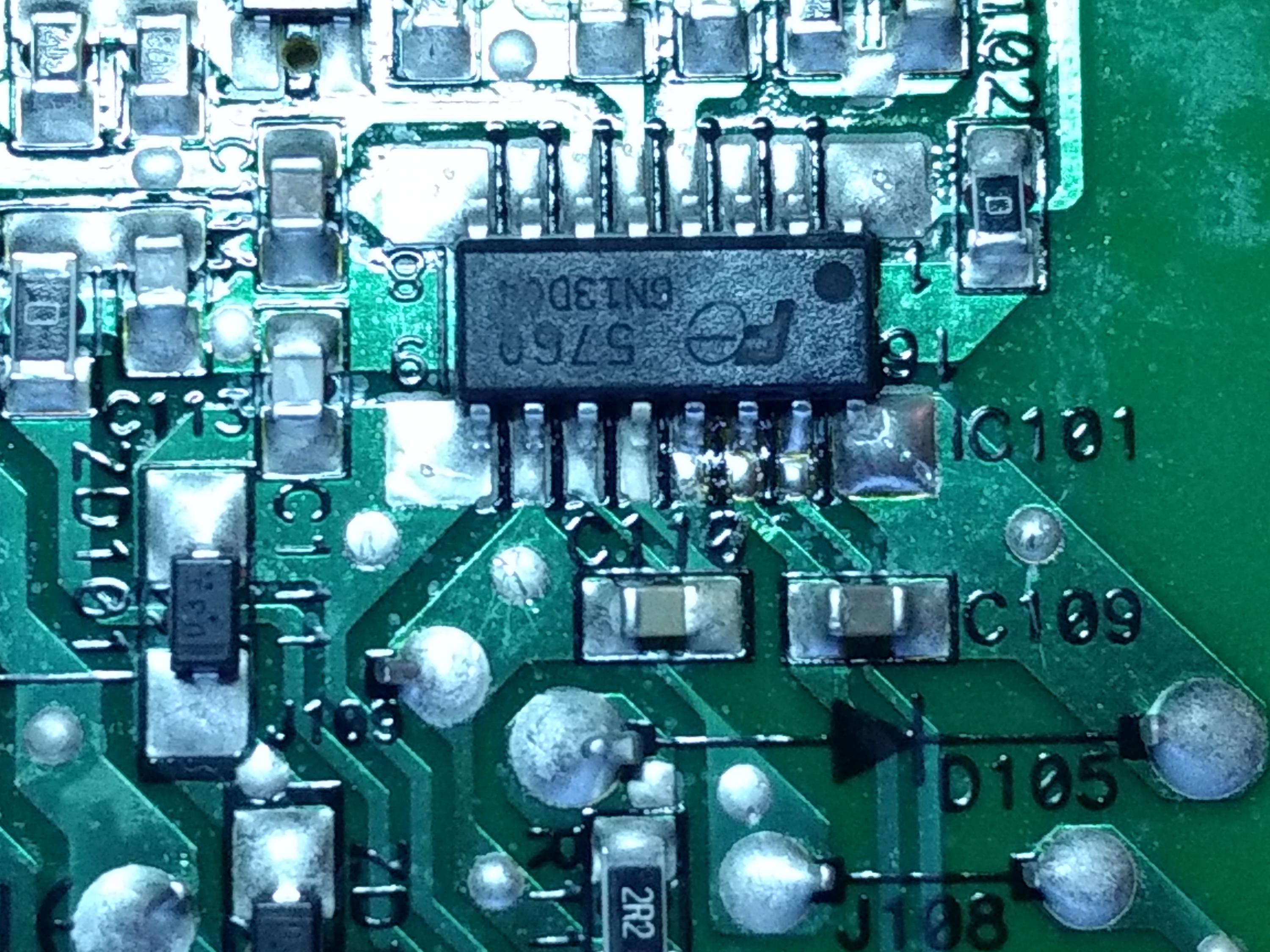

                        Sorry about that. Is this what you're looking for? The 8 pin is IC102 and the 16 pin is IC101. I don't know why these uploaded upside down, I flipped them the other way before I uploaded them.
                          on ic101, pin1 is the VH input voltage, inside the ic is a startup cell that should provide a vcc voltage on pin 10 of around 13v, 2.4v is too low, try replacing C127.
                          • DXseekerMO
                            • Feb 2018
                            • 1119
                            • US
                            C127 replaced, problem still exists
