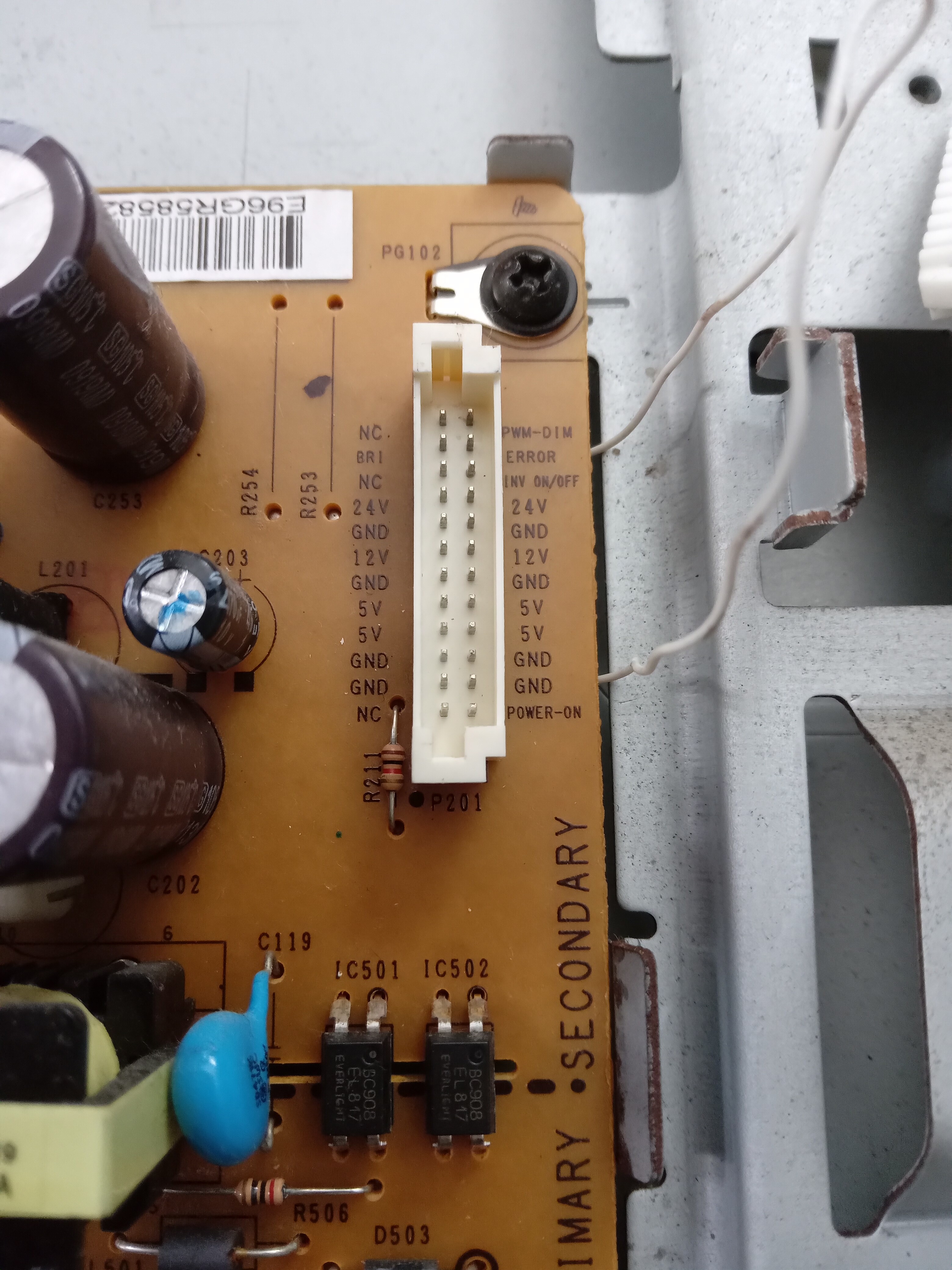

    The CCFLs are not lighting up at any moment, when the fault occoured the lamps shut down and only sound still played, there's image on the screen, with a flashlight I tried turning energy saving off, no change, PWM_DIM signal is 0.2V, I isolated the pin and soldered a 3.3V regulator at it but it still does not work.
    All the main voltages 24V/5V/12V are ok, the mainboard is not sending enough PWM_DIM signal voltage.
    1~5 - 24V - 25.01V
    6~10 - GND
    11 - BRI - 1.54V
    12 - INV_ON/OFF - 5V
    13 - PWM_DIM - 3.3V (with an AZ1084 3.3V regulator)
    14 - ERROR - 0.04V
    The only signal left to manipulate would be BRI, but I do not know what voltage it's supposed to be.
    Disconnecting the ERROR pin does nothing.
    That floating IC next to the inverter cable is the 3.3V reg, currently disabled(no Vin).

    Re: LG 32LH20R No backlights
    I had a similar problem. After confirming the CCFLs are good and inverter board is working. I changed the T-con board and TV displayed a picture.
    Check the training manual.

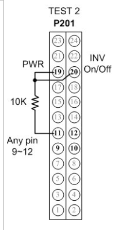

        From your readings pin 12 INV on/off(P203) is 0v, hence the back light is OFF.
        it should be HIGH to switch the inverter circuit. The signal to turn inverter ON comes from the main board. When you were performing the test, the main board is not active since no power is being supplied.
        Try to do this:
        Disconnect power cable from power supply board to the main board since we want to check power supply and inverter circuit only.
        On connector P201 (on power supply board), Connect jumper 10k from pin 11 to pin 19 (PWR) AND pin 20 (INV ON/OFF). This will turn the power supply ON and also the inverter circuit ON.
        See attached picture.

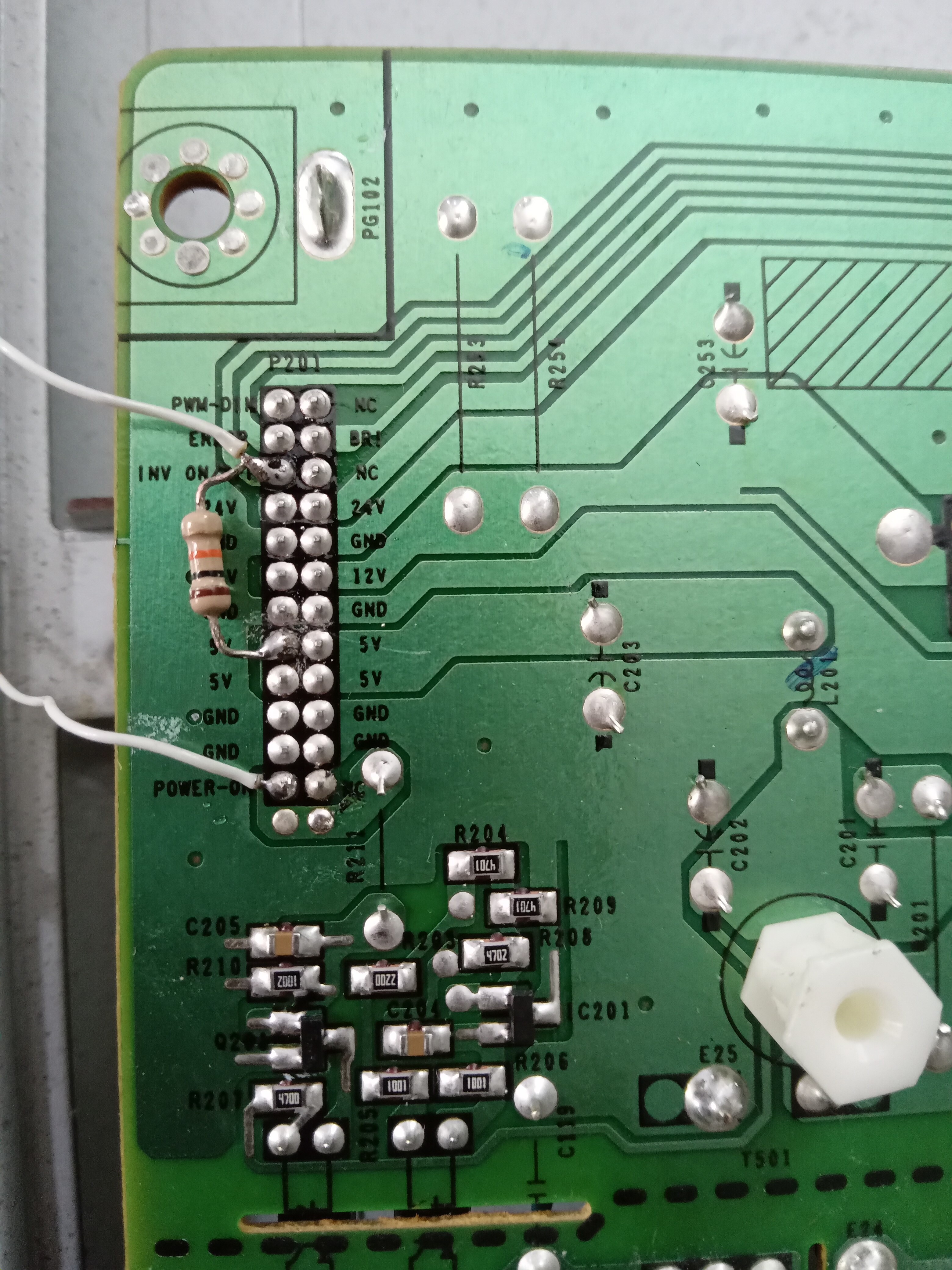

          Yes the PSU does not produce any signals to the inverter, all the traces are straight from the main board to inverter and the PSU just acts as a bridge.
          With an 1k resistor INV ON/OFF gets 5V, still nothing happens.
          I have already inspected the board and tested the fuse, the four switching mosfets and transformer windings, they are fine.
          There's a 56 OHM resistance between the lamps output and ground, is that normal? Never messed with an inverter board before.

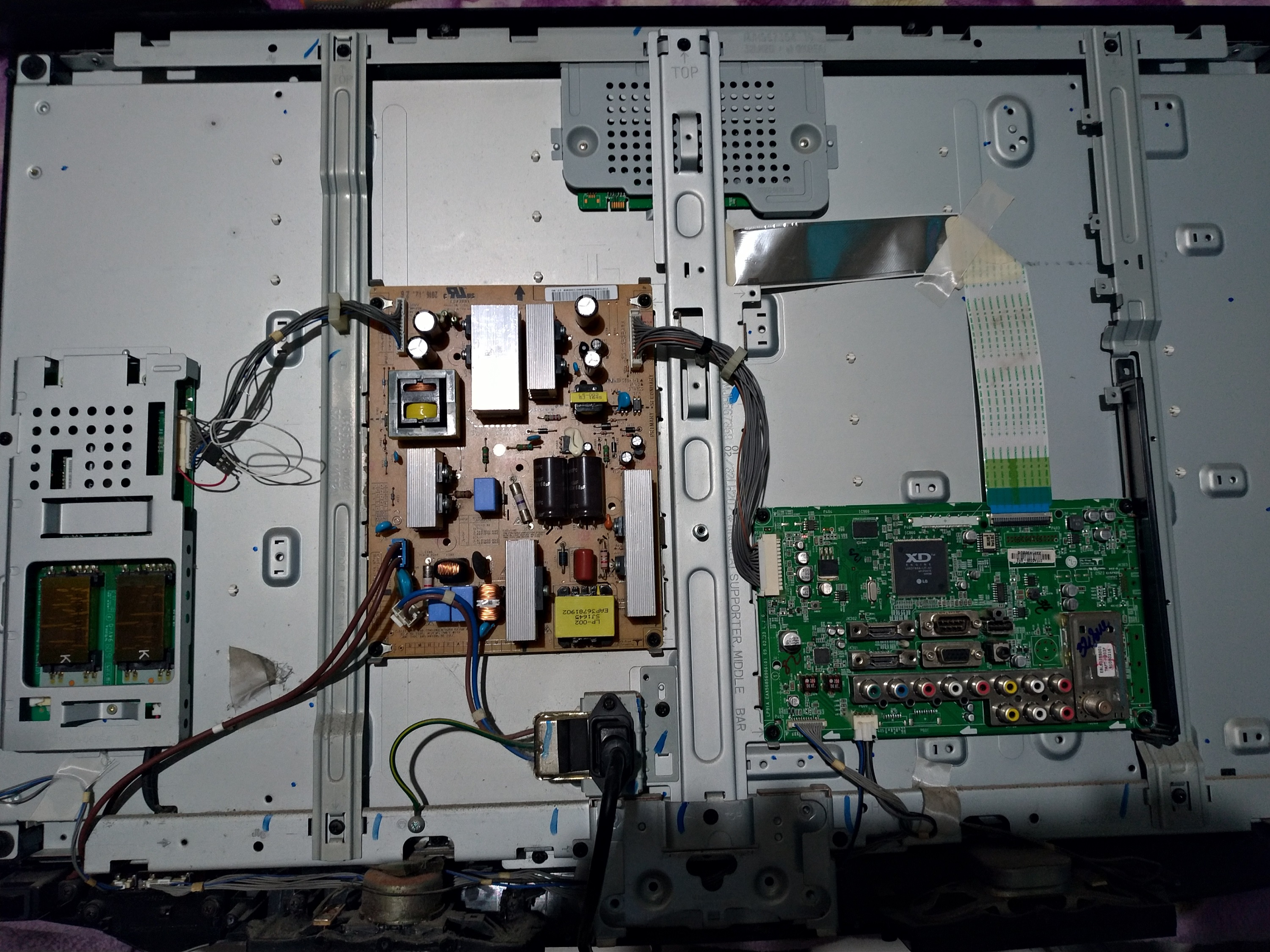

              I did the dreaded thing and opened up the TV to check on the lamps, they are fine and no sign of bad soldering, it looks perfect, unfortunately the only other 32" LCD TV I have uses "U" shaped lamps, so no way I can test them.
              The inverter transformer does not output anything, it has one pulse at the startup and nothing else, like the controller detects an short or something, there's that low resistance to ground on the lamps output pins, is it part of the design of the board?
                          Fixed, just replaced the inverter board, it was very cheap and effective.
                          When the TV powers on the LED lights up bright blue, unmistakable if you know it should be lit during startup.
