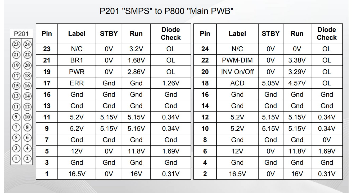

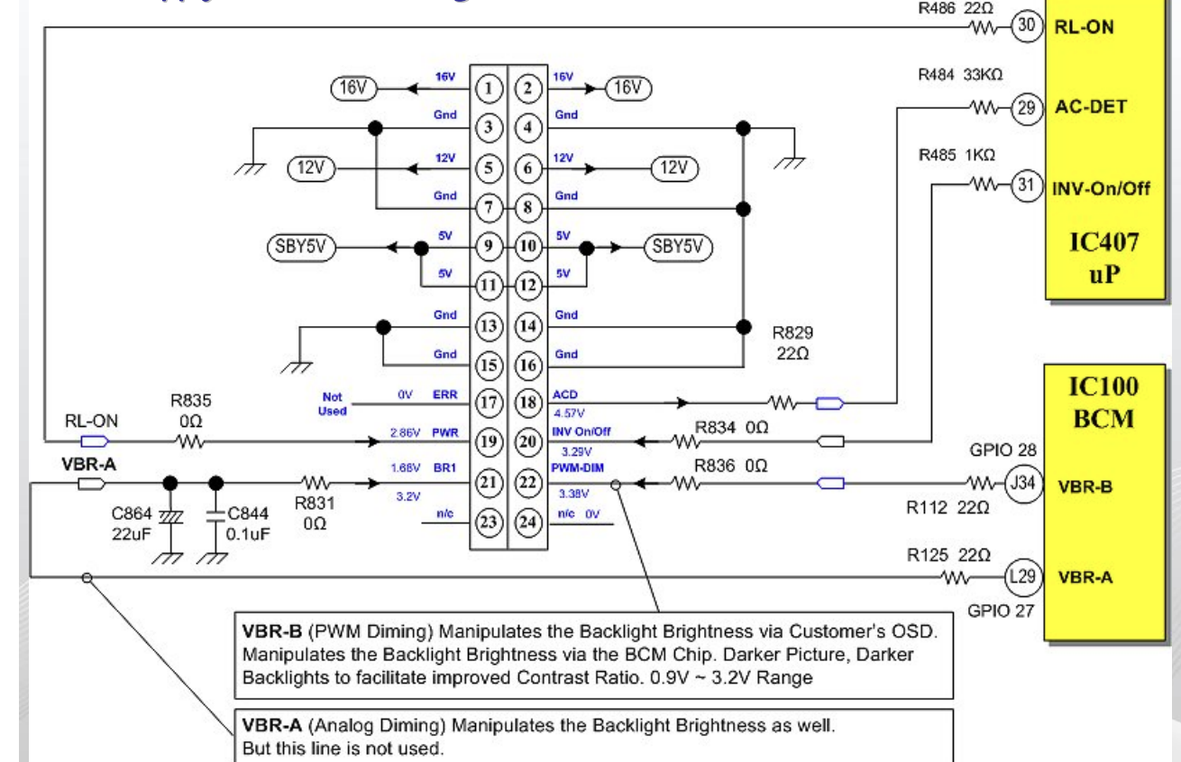

LG 32LH20R No backlights
  • nomoresonys
    • Jan 2013
    • 12276
    • U.S.
    You have a simple one to replace, here's a video, you can see the board without the cover. you can also check the two capacitors and those other components looks like there's 3 or 4 : https://www.youtube.com/watch?v=-4TMdKEV-uc
    • TVAddict
      • Jan 2022
      • 76
      • Caribbean
      Originally posted by lotas
      There are also PWR_DIM and BRI (brightness) commands.
      Thank you, so i have to jump the resistor across those pins as well? the test procedure didn't say anything?
      • TVAddict
        • Jan 2022
        • 76
        • Caribbean
        Wow, thanks for finding this video, it shows exactly everything i'm going through with mine, i did test the fuse and mosfets with my multimeter, they checked good, also caps tested fine, i didn't try that trick with the neon lamp shown in the video, but i think my problem will follow the same path, i think i'll try to find that inverterboard and replace, or maybe if i can find that pwm ic as suggested in the video is most likely the bad culprit.
        • lotas
          • Jan 2016
          • 4753
          • Russia
          Look...
          • TVAddict
            • Jan 2022
            • 76
            • Caribbean
            Look...
            Thank You, i will do more testing..
