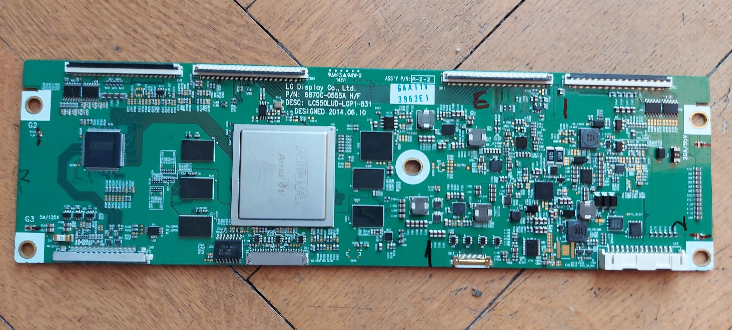

    Make one or two very sharp photos of the tcon possibly at sun light with readable serigraphs.

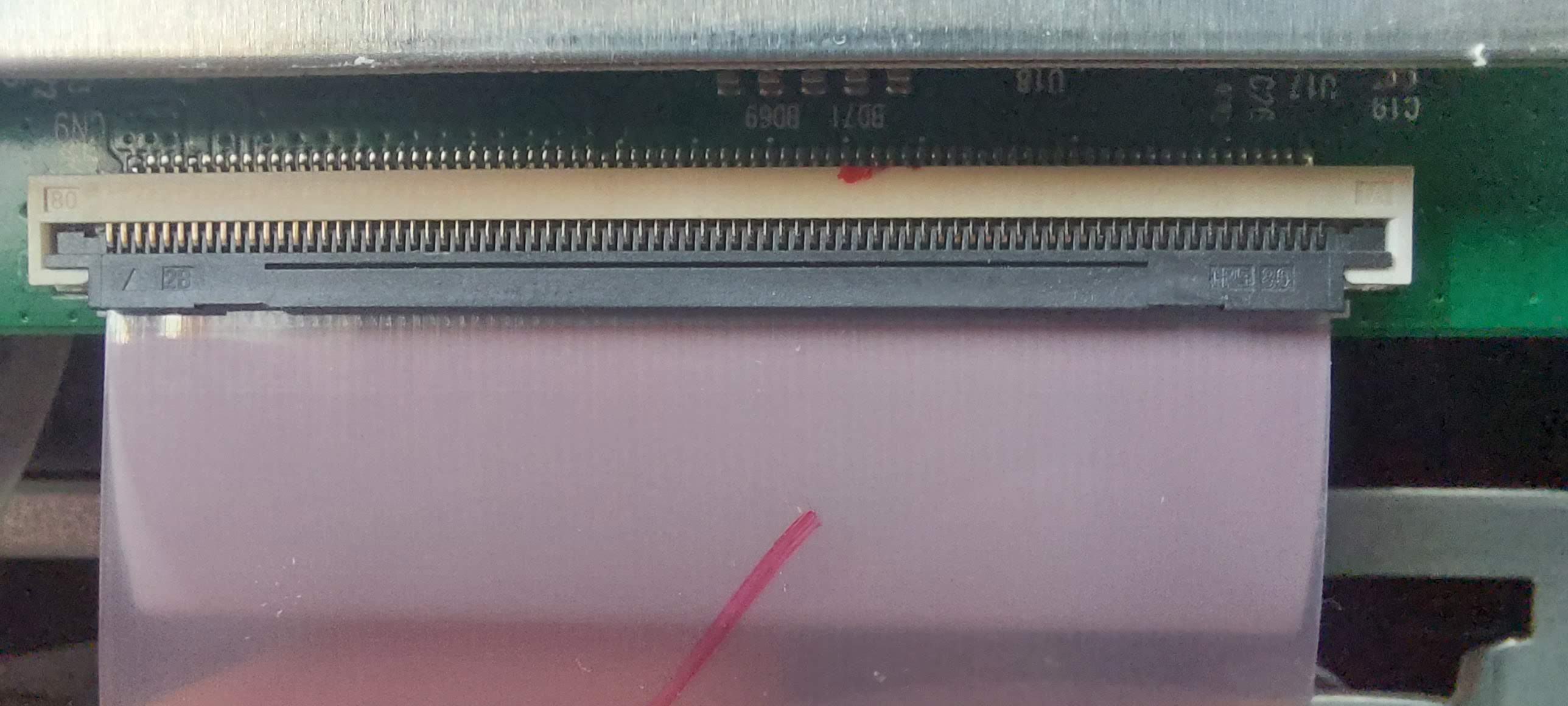

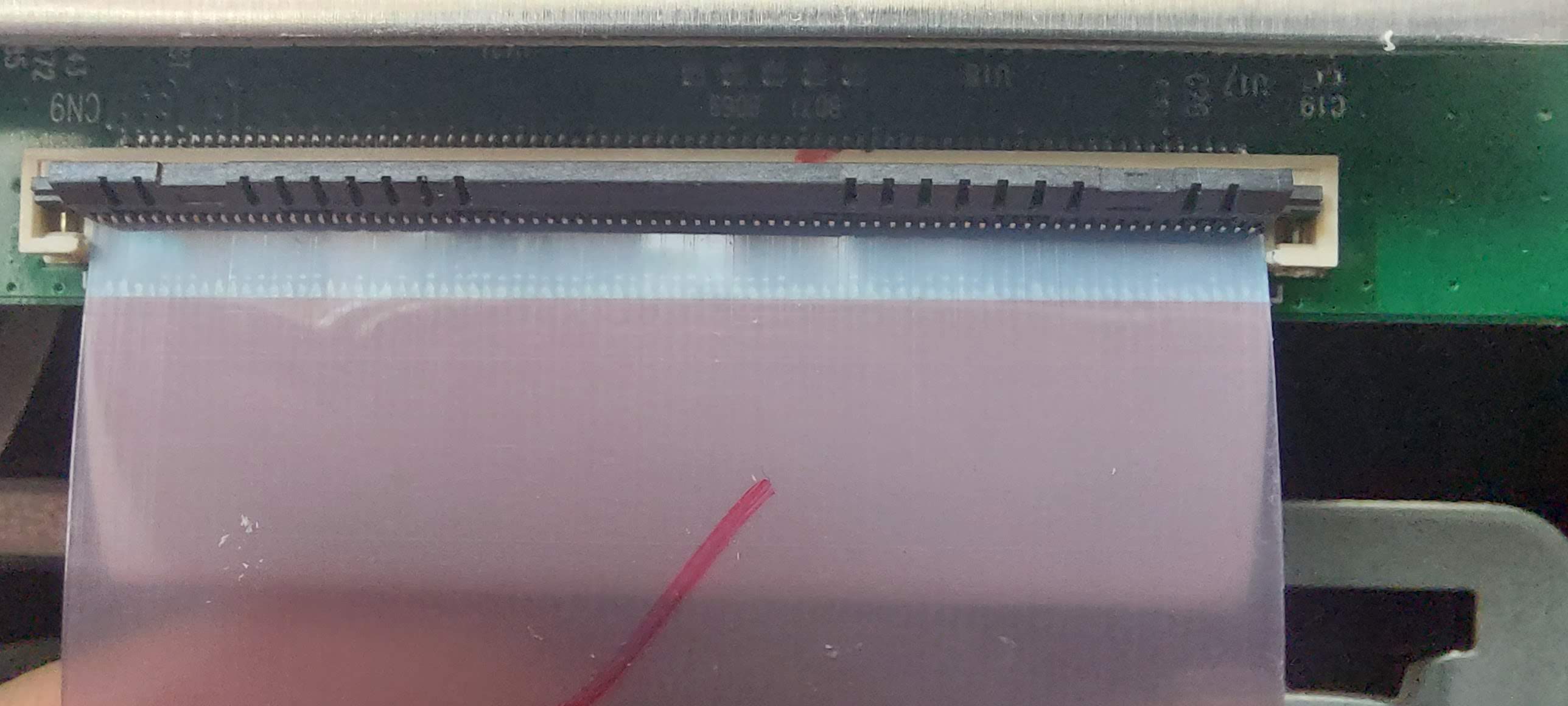

                  >have you ruined the flat cables?
                  Hopefully no, I tried to be very gentle with them... (Btw, this is just my curiosity: there are four flat cables from the t-con to the panel. Does it mean that the panel is divided into four independent sections?")

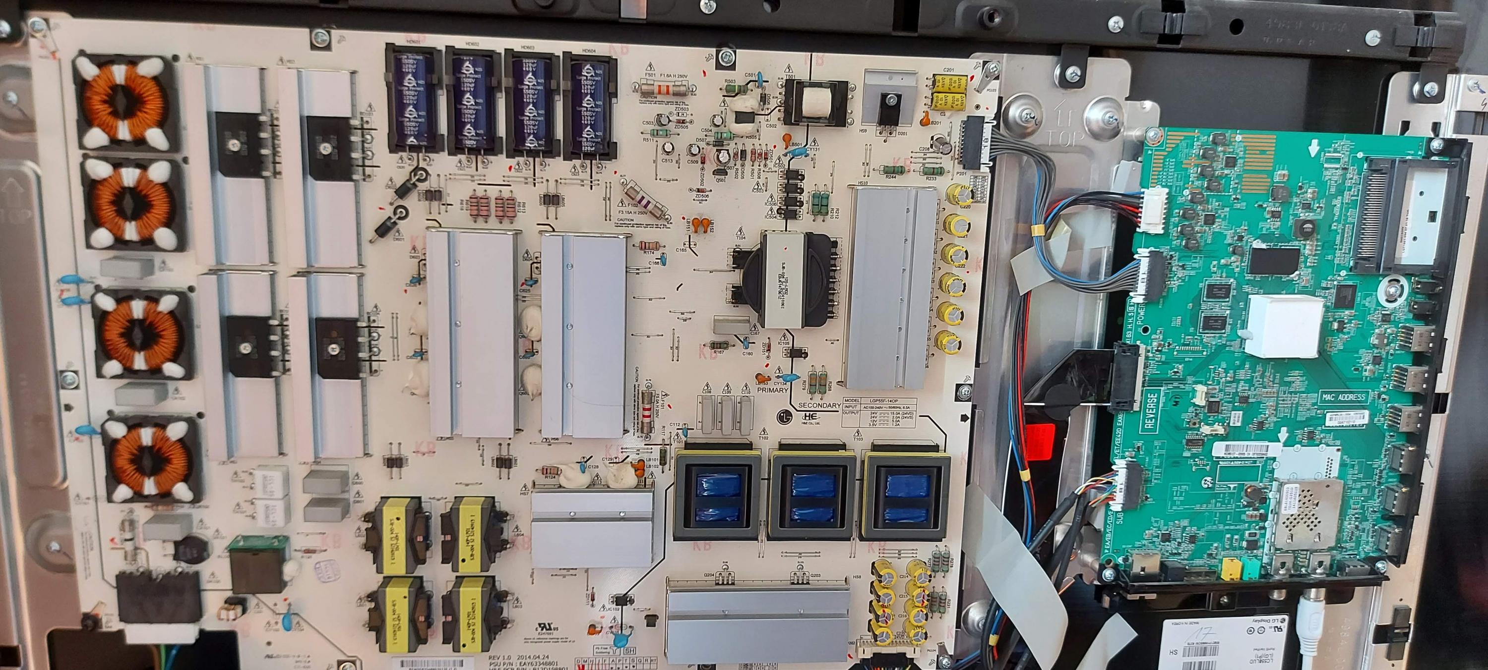

                  I attached some pics of the power supply board and the t-con board
                  >are you able to repair at component level?
                  I have good soldering skills, but I have no clue about what to replace... By visual inspection, I was not able to see anything damaged.
                  The only thing that I'm wondering about is one of the two large vertical heatsinks in the exact center of the power supply board. The one on the right is ~50degrees, while the one on the left is at room temperature (observed with a borrowed thermal camera). Anyway, the 24v lamp seems to turn on correctly, so I don't think I have a power supply issue...
                  >Are there too the 24v?
                  Yes, there are. I found here in the forum a link describing a test with a small car lamp. I did it, attaching the lamp to the power supply and putting a jumper on the 24v enable pin, and I can confirm that the car lamp turns on.
                  About the voltages for the logic... I have no idea about which voltages should I check. Do you have any info on that?

                    Just a silly question, since I have never seen this type of flat cables. Can you confirm that the closed position is correct? I just placed the cable in position and closed the slot, without trying to force the cable inside any further.

                      i have asked only tcon photo with READABLE serigraps... only component side.
                      • randaz81
                        • Oct 2021
                        • 9
                        • Italy
                        Re: problems with LG OLED 55EC930V, t-con board LC550LUD-LGP1

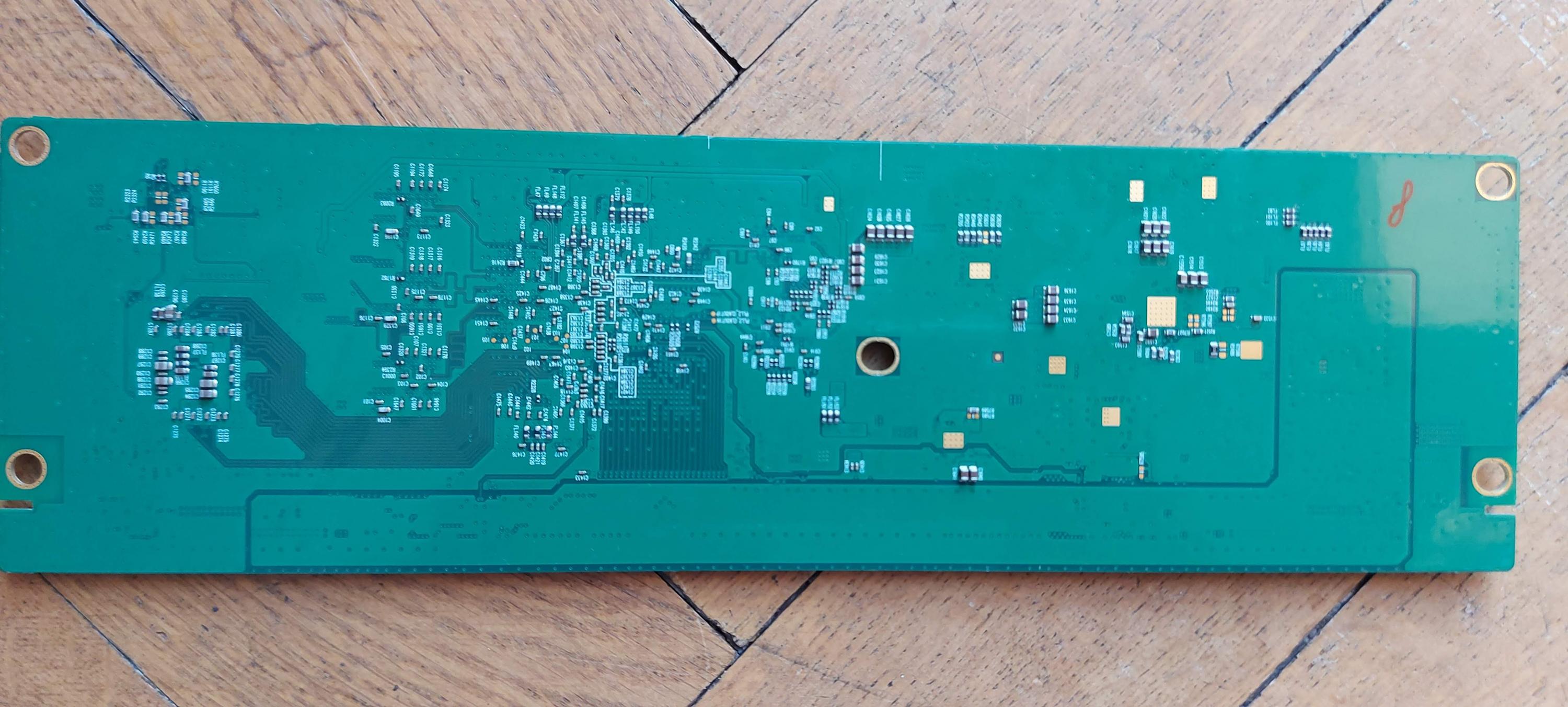

                        ok, sorry... I'm having bad times trying to make a clear single photo of the whole board with my phone.
                        So I did several pics, from left to right. Please tell me if it is ok... I can eventually try to use photoshop to assemble all the pics together but I'm not very familiar with it and it will take a while...
                        Thank you a lot
                          Next time= horizontal board> Horizontal cellular...
                          test in volt these points respect to GND: 2.5v, 1.15v, 1.8v burk, Vpred, L8, VDD, C1528, C1554, F3 (both terminals), C1516, VGH, D44...
                          The questions:
                          1) I think No.. from what i see, each half of tcon: 1 conn. for video data , sync, etc... 1 conn. for power supply, gamma lines or clock lines, i don't see..
                          2) the flat cables and connectors seem right in place..
