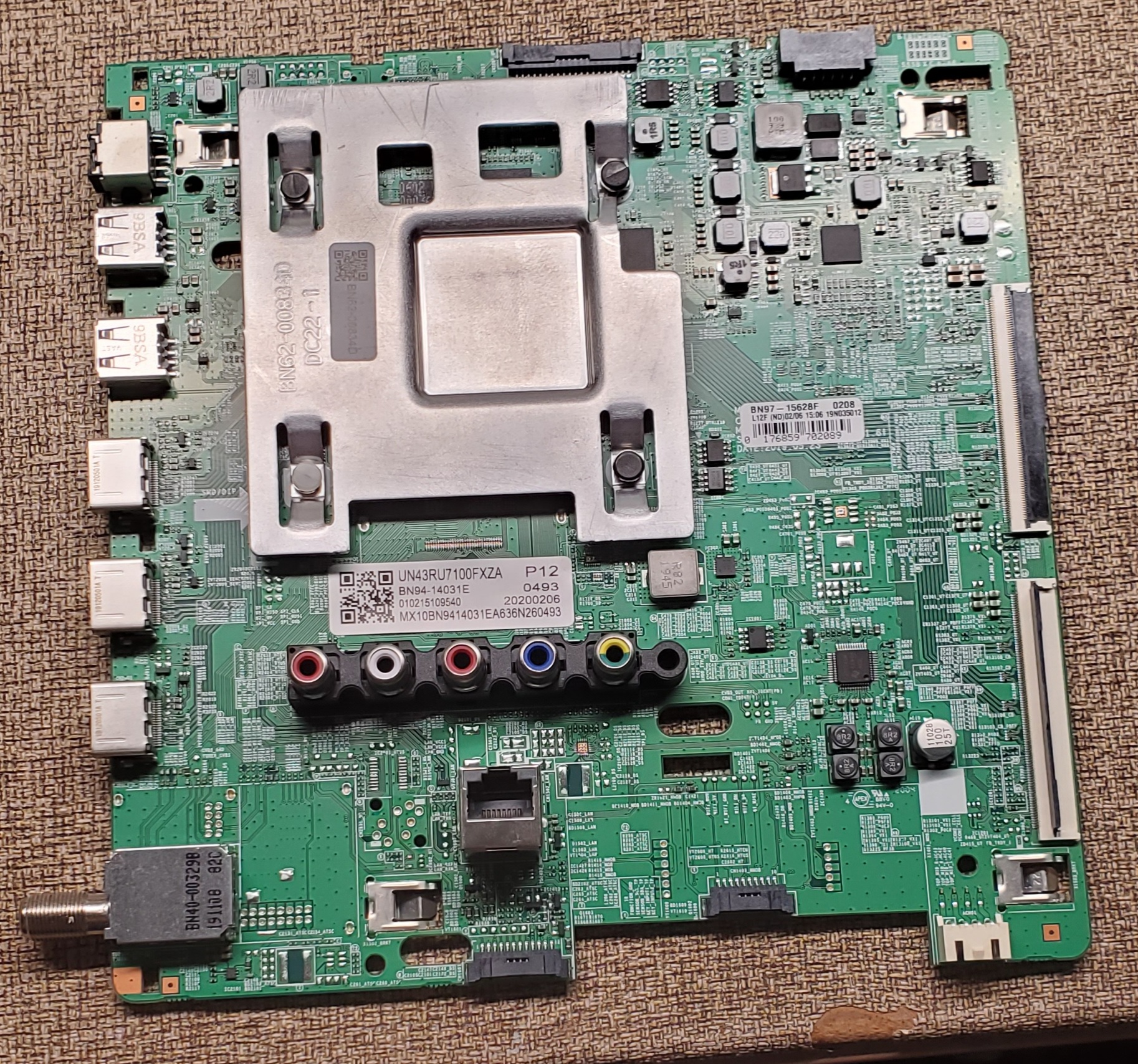

                  Re: Samsung un43ru7100f no picture, flashing backlight
                  Oh great! Yes i would rather find the fault. Here is a pic of the main board. Could you show me where the common fault area is?
                    Ok on the boards with the flex ribbon going to the panel.....i see...will check

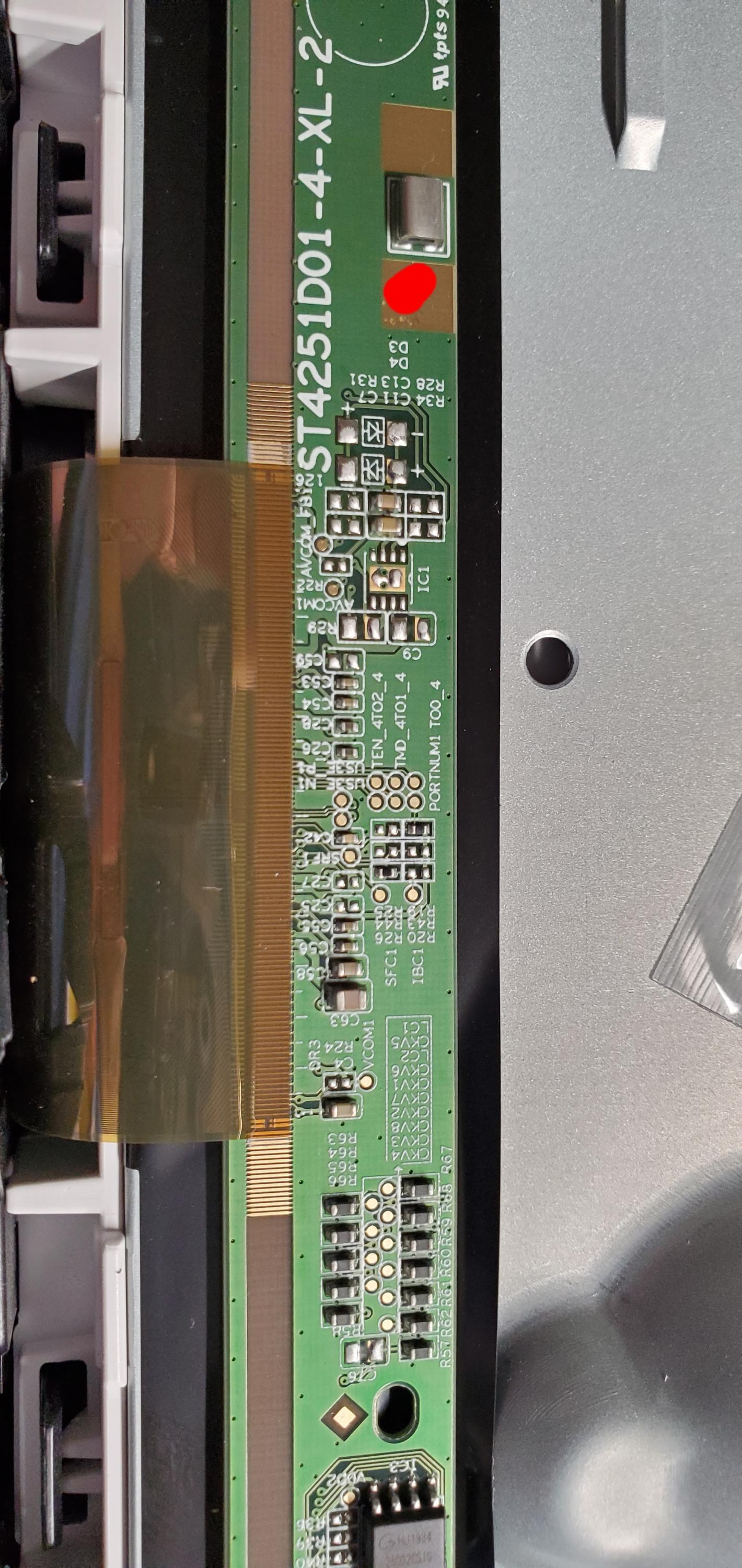

                        What temp would you recommend for hot air? And thats pretty close to the ribbon cable....will that come loose if it gets hot? Also i checked all of them for short using the area in my pic marked red for ground. Is this not good enough to test? Or do i have to remove them and check there value? What should they be rated at?
                          Pic
                            I don't have a professional hot air station, only a portable one that i've used few times, so i don't know, if i remember rohs tin melts at around 230 degrees european measure, for the ribbon you can mask it with aluminum foil, the area for gnd is ok but remember that not always shorts are revealed by a 3v lowcurrent tester, so you must remove them mandatory, the caps are 25v minimum, much probably them are those connected in parallel to Avdd tension of tcon so start with them, that are the biggest ones. Aftet each removing do a test of tv.
