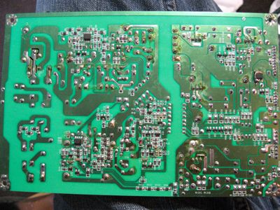

    I received a 27" Akai tv with built in dvd player Model Number LCT2701TD.
    When I plug the unit in and flip on the main power switch (not the "ON" button), the tv automatically kicks on and the screen comes up for about 2-5 seconds, then it kicks off, then it repeats. Pressing the power on button does nothing to the cycle. I assumed power supply, or stuck button.
    The tv does the same thing whether or not the control buttons are connected or not, so that's out. As for the power supply, there are no signs of damage. (no bulged capacitors, no burn marks, no loose components, etc).

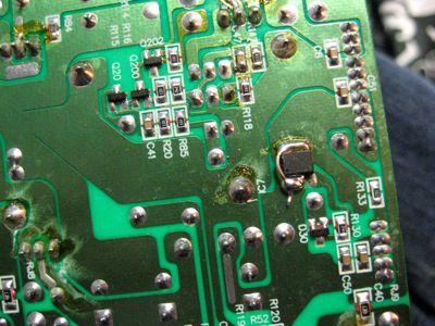

    I'm stuck as to why this would happen anyway. On the back of the power supply, there is an IC that has a jumper wire soldered on (the IC appears to be labeled 4407P 355D9 and I have read other reports of people finding this same repair on the identical model, so it must have been on purpose by factory or such)
    Any thoughts?

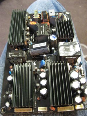

    lots of small lytics baked dry under the heatsinks on those megmeet psu's.replace all the lytics anyway.
    i have a 37" here that would just randomly restart.+5 was going low and high intermittantly.a recap fixed it.
    these units run too hot.

      Alright, I'll give it a shot. They just all look good. It's gonna be a chore getting the few that are under the heatsinks.

        Ok, I re capped the power supply board, and nada. No change at all. What could possibly be making it turn on by itself when plugged in and then power cycling over and over? I'm at a complete loss. Anyone had similar?

          I can't get a good enough look at the picture of the power supply to be able to offer any specific pointers, but I would suggest you probe the power supply voltages while the TV is turning on and off. Try to see if the voltages are stable and accurate while they are on.

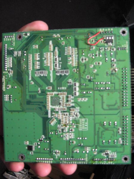

            alright I finally had time to mess with this again. I don't believe this is a power supply issue anymore. I kinda did what aliasdck suggested except not all the outputs are labeled... so i instead did this:
            I hooked the main board power-in connectors to an external power supply with the correct voltages (these ones I know). Nothing unnecessary is hooked up to the main board. Only power-in, and the tiny board that has the power on light (so i know if it's working or not. This results in the same actions. It keeps powering on then to standby (off) then to on and so on... It must be something on the main board. I'll work on getting a picture of the main board soon. Any ideas of what it may be that would make this happen?

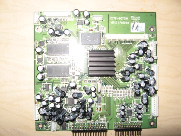

              This is the main board I am talking about.

                                    Capxrf -I'm working on the same model tv except that it has many bulged caps on power supply board. The service manual is available online for free and it is very detailed (100 pages in pdf). I have a copy of it and PM me if you want a copy.

                                        I had Akai lcd3201td tv did same like you TV
                                        Check volt at power supply is ok like service manual
                                        find 2 1000uF/16V cap bad at main board replace still same problem (my main board look like main board on Akai LCT2701TD)
                                        Please tell me what transistor you replace & where at main boar?
                                        can't find the replace
                                        HY634-27PCBL-DST / Ver 1.2 Pn# 0510A / LCDTV32 05-387/1021A on the mainboard
                                        Akai MAIN PCB ASSY parts# 771EL32AD02-01 find on the some website but is out stock
