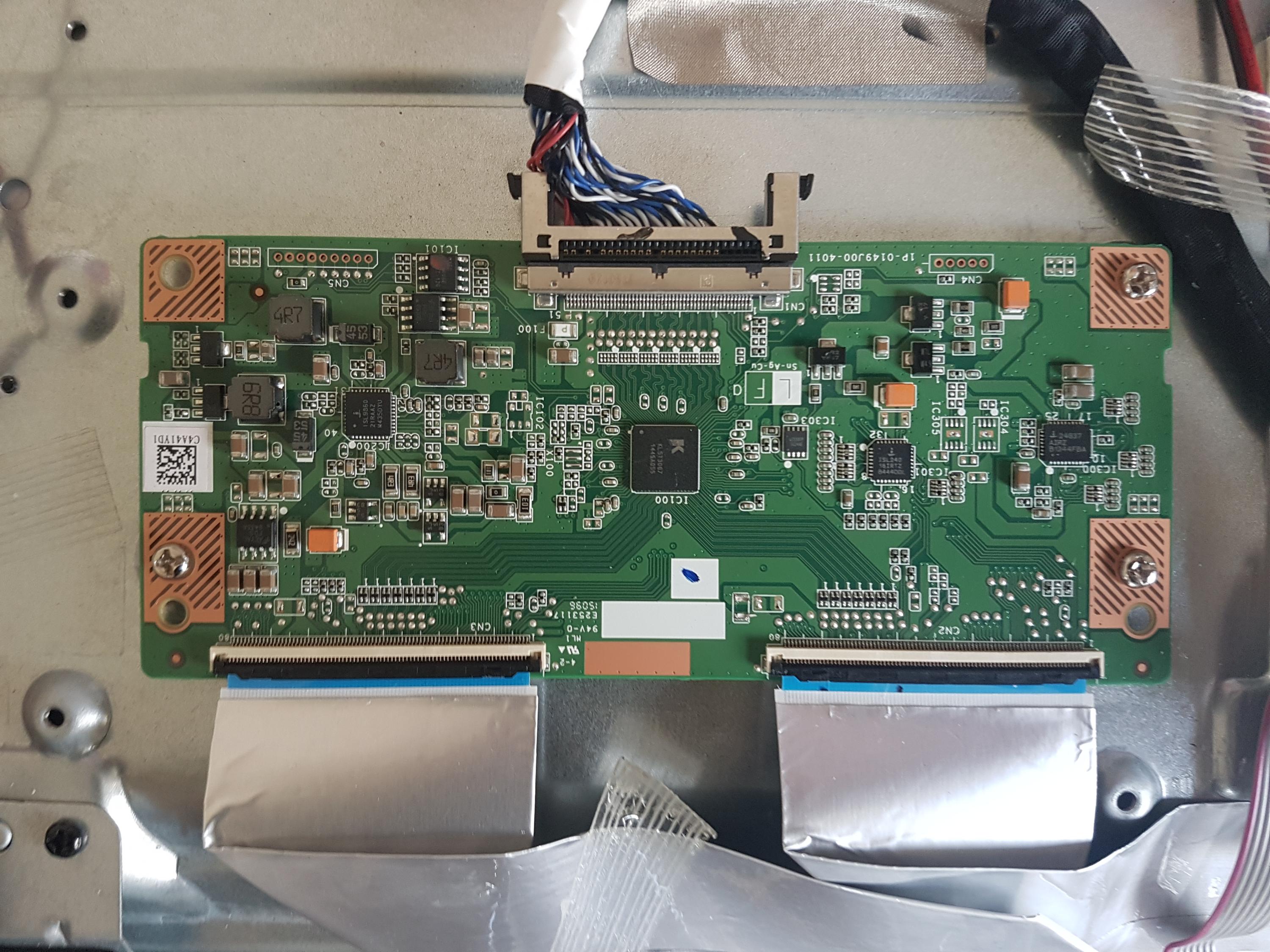

Westinghouse WD40FW2610 replaced tcon now screen is upside down.
  • MikeRWK
    • Jun 2017
    • 121
    I can't find anything in the service menu that allows me to flip the screen. I've included a picture of the tcon incase theres a jumper or something.

    Re: Westinghouse WD40FW2610 replaced tcon now screen is upside down.
    upload photo for the original T-CON, try to located the SPI on it and compare it with replacement one.. could be the t-con for different model.
    i think this TV had mainboards All in One. if you can find firmware to downgrade or upgrade could help too
      The spi flash? I had a mishap that left it inoperable.
        I managed to dump the eeprom from the new tcon, I don't know how to change anything though.
          again... dump the original T-con and compare it with the new via HEX editor, or you can flash the old on the new one.
            I already said I dont have the original anymore.
