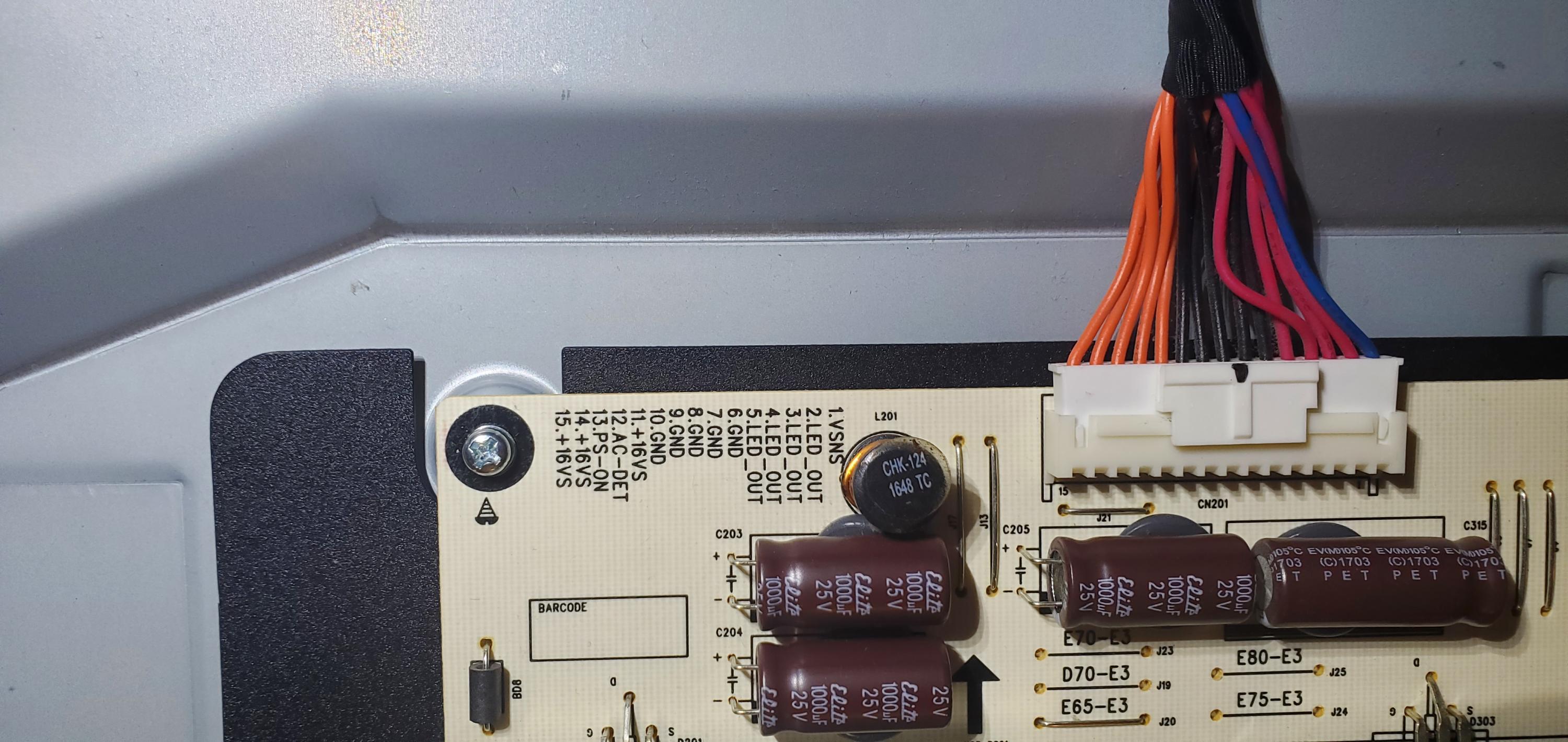

    SSooooo i picked up a 65inch vizio that someone was throwing away so i figured i would try and fix. seemed simply enough but after i got it back together it is not turning on. i have power coming from the power supply to the main board but nothing going into the tcon. i had the tv on a bed while i was working on it...could i have fried it from static maybe?? Thanks in advance!!

    Test the voltages at the connector on the powerboard with EVERYTHING hooked up, it's the connector that the cable from powerboard to mainboard hooks into, most times there's a legend/map nearby that gives the expected voltages, you measure them with your mutimeter, set meter to 20 vdc then report them, put neg probe on chassis metal ground, pos probe on pin of connector, measure in standby take note, leave probes where they are then power on tv and again take note of voltages, report them here, example pin 1-ps-on-0 volts standby-power on-3.3 volts.

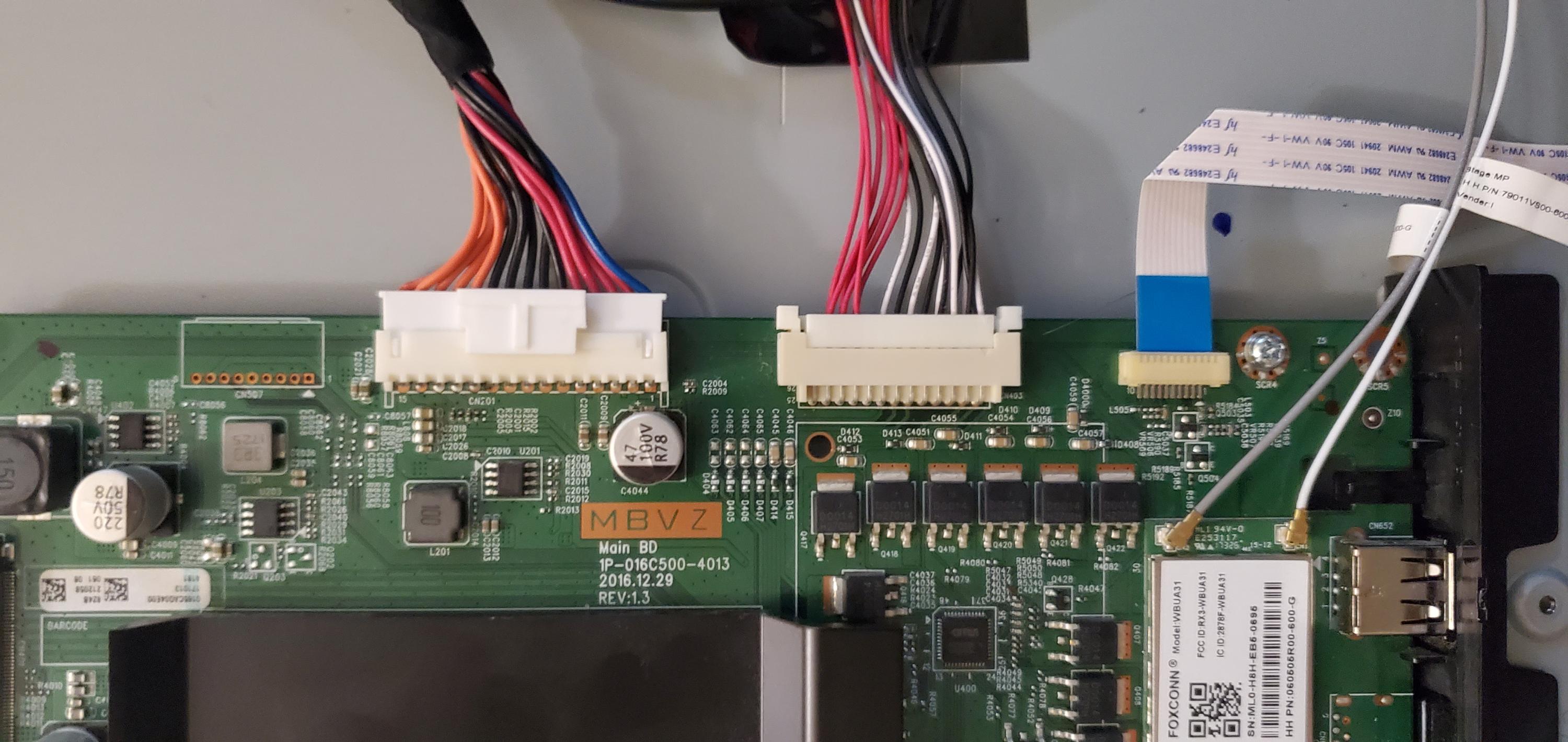

                I pulled the connector from the main board and fired each strip. They are all pulling the same 32.4 volts so they are all working. Any more ideas?

                  Could be bad solder joints at main board BGA. Remove heatsink and blow some hot air when TV is off. Wait until it cools down and turn it on. This is not a fix, just troubleshooting technique.

                      Tested at the connector on main board going to leds.. pins 1 - 14..voltages fluctuate before settling around -.030.
                      Pins 17-24 all just drop to -.007 in a few seconds after power on.
                      I have a hot air station ariving in the mail today and will try the bga suggestion.

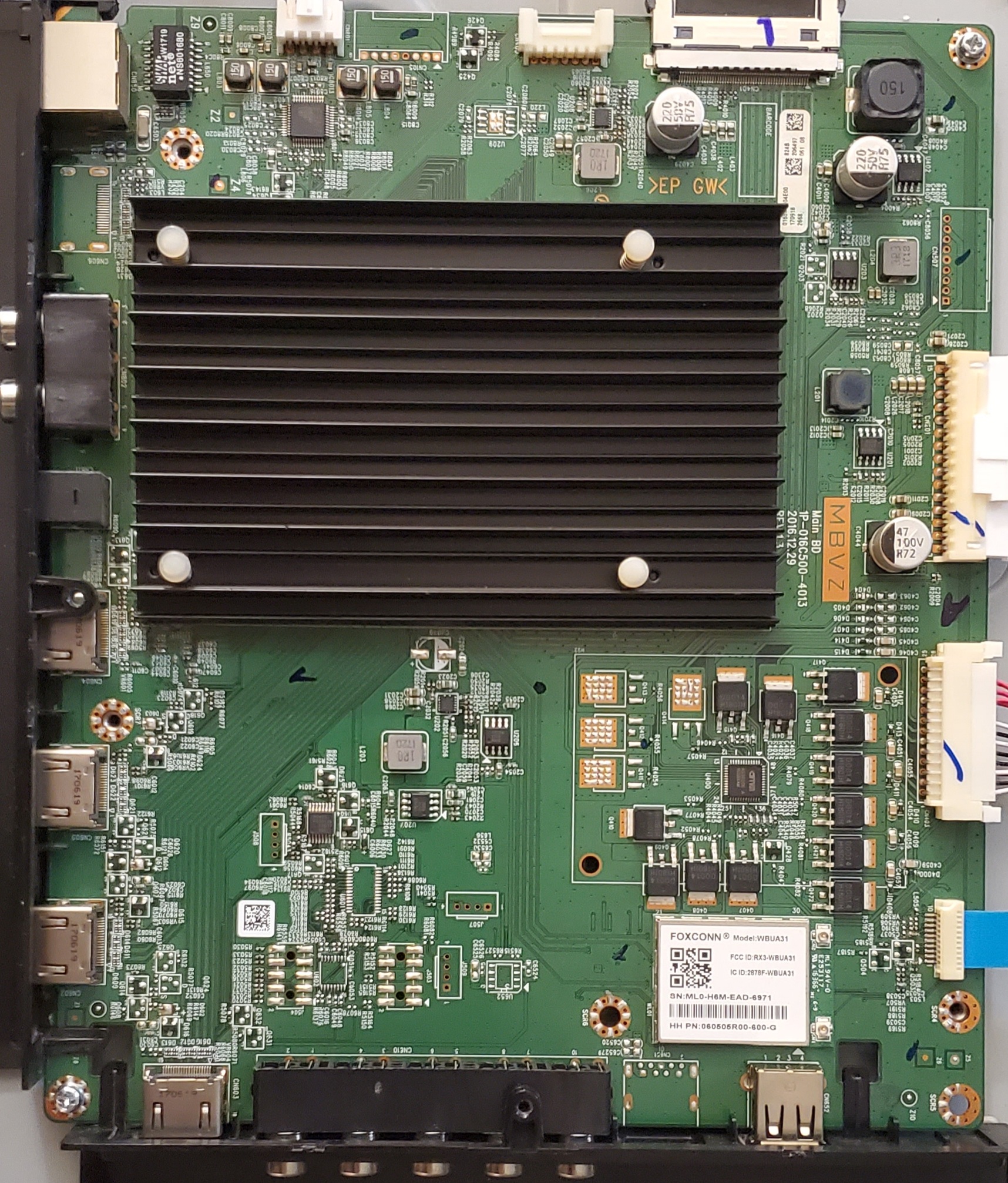

                        Update.....tried hot air on main board bga...no difference. replaced main board and am still getting nothing... what should i try next?

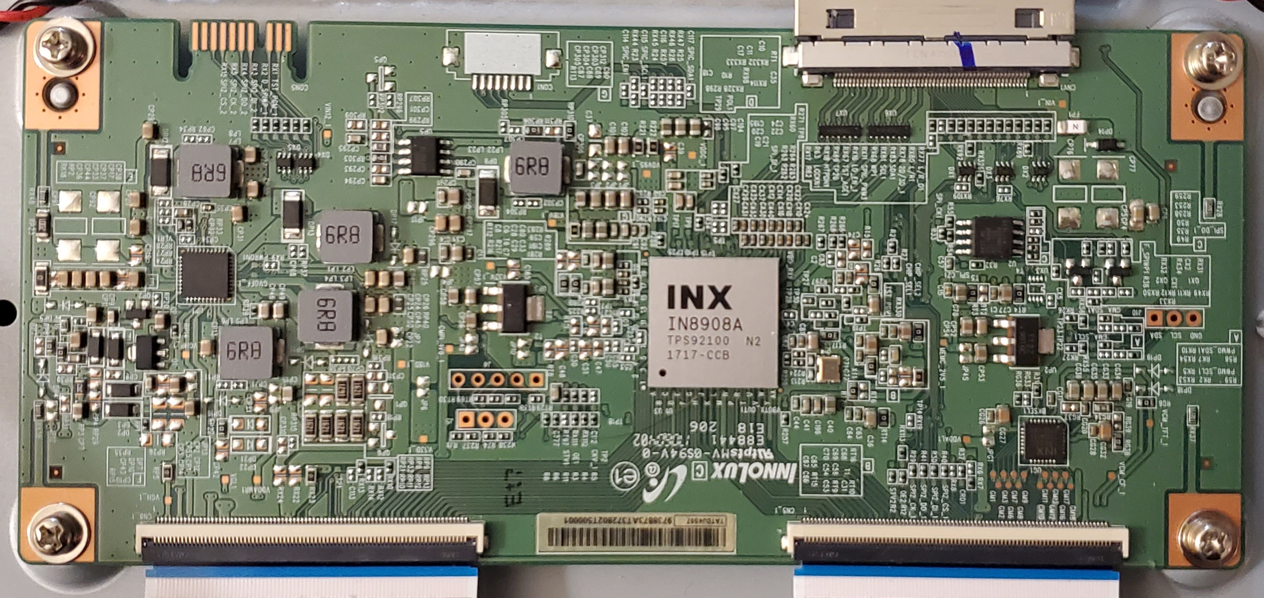

                          Pics

                            Does it attempt to turn on? Try connecting only one side at a time between the tcon and panel and see if the TV turns on with half a screen.
                            • a460guy
                              • Oct 2013
                              • 59
                              • it's
                              Re: Vizio E65-E3 Dead after backlight replacement
                              I put a flashlight to the screen and turns out there is image! So now i just need to figure out why the new led s are not coming on.
