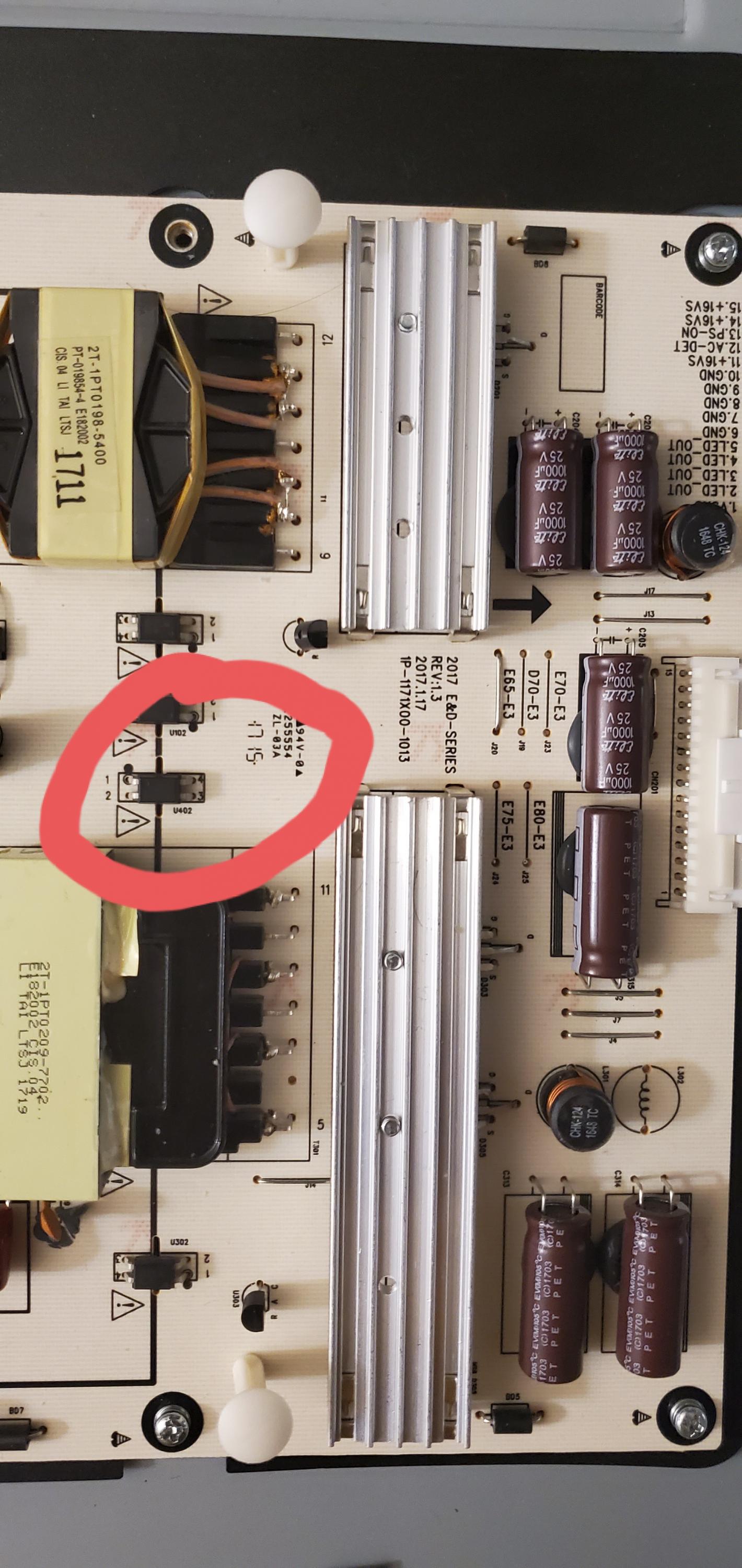

                      OK, so I think the VSNS signal on the Power Supply is tied to the FB1 / FB2 Power Supply Feedback on the AS3820 LED controller on the Main CCA. Per the AS3820 datasheet this pin is an analog output used to dynamically control the output of the Power Supply.
                      I disconnected that wire at the input to my Power Supply on the E60-E3 and the backlights operated normally, and the voltage at the VSNS was still 2.4 volts in that open state, so it read the same with or without the wire??
                      The best I could do to support this is to look at prints for the E60-C3, which uses the same LED controller. The E60-C3 also has a power supply schematic, but unfortunately a very blurry version.

                          OK, so I tested the Power Supply as a stand alone unit. It is a bit more difficult since the standby voltage is 16 volts.
                          I created a resistor divider from standby 16 volts to gnd so that the center would be near 5 volts and could be used to simulate the PS-ON signal. I used a 1K and 2.7K resistor, but a variety of values could be used keeping the objective of a 5 volt PS-ON signal - up in value would be better if you don't have these values.
                          With PS-ON active at near 5 volts the PFC voltage rises to the 360 volts expected value and the LED voltage is activated, in my case it is 16.2 volts. So this verifies that externally only the PS-ON signal is needed to activate the LED supply.
                          So, since your PS-ON signal is behaving you should have PFC boost voltage and LED voltage. The only other thought which I can't really test (I am a bit reluctant to short the supply) is if the LED voltage output is driving a short, such as a pinched wire or such to chassis ground.
                          You could do the test with the resistors to check the stand alone power supply.
                          Or, before doing that check the LED power pins out of the Power Supply for a short to chassis.
                          And, one other thought if you don't want to do the resistor check you could remove the 4 LED power wires from the Power Supply connector while leaving everything else connected - maybe the VSNS wire too just to leave no doubt. Turn the TV on and check the voltage at the LED pins on the Power Supply, and also check PFC boost voltage.

                                          That is normal as that pin ties to DC rtn. However, with the four wires removed and you verified 5V PS-ON was there at near 5V then I can't see how it can be anything but a defective Power Supply. The test I did (hopefully the 60 inch is the same) as a stand alone supply confirmed that to get PFC boost and LED voltage all that is needed is PS-ON high - no LED's need to be connected.
                                          You can add in your case of testing the AC-Det also needs to be valid as the Main needs to send the PS-ON command.
                                          Did you also disconnect the VSNS pin with the other four just to be sure?
