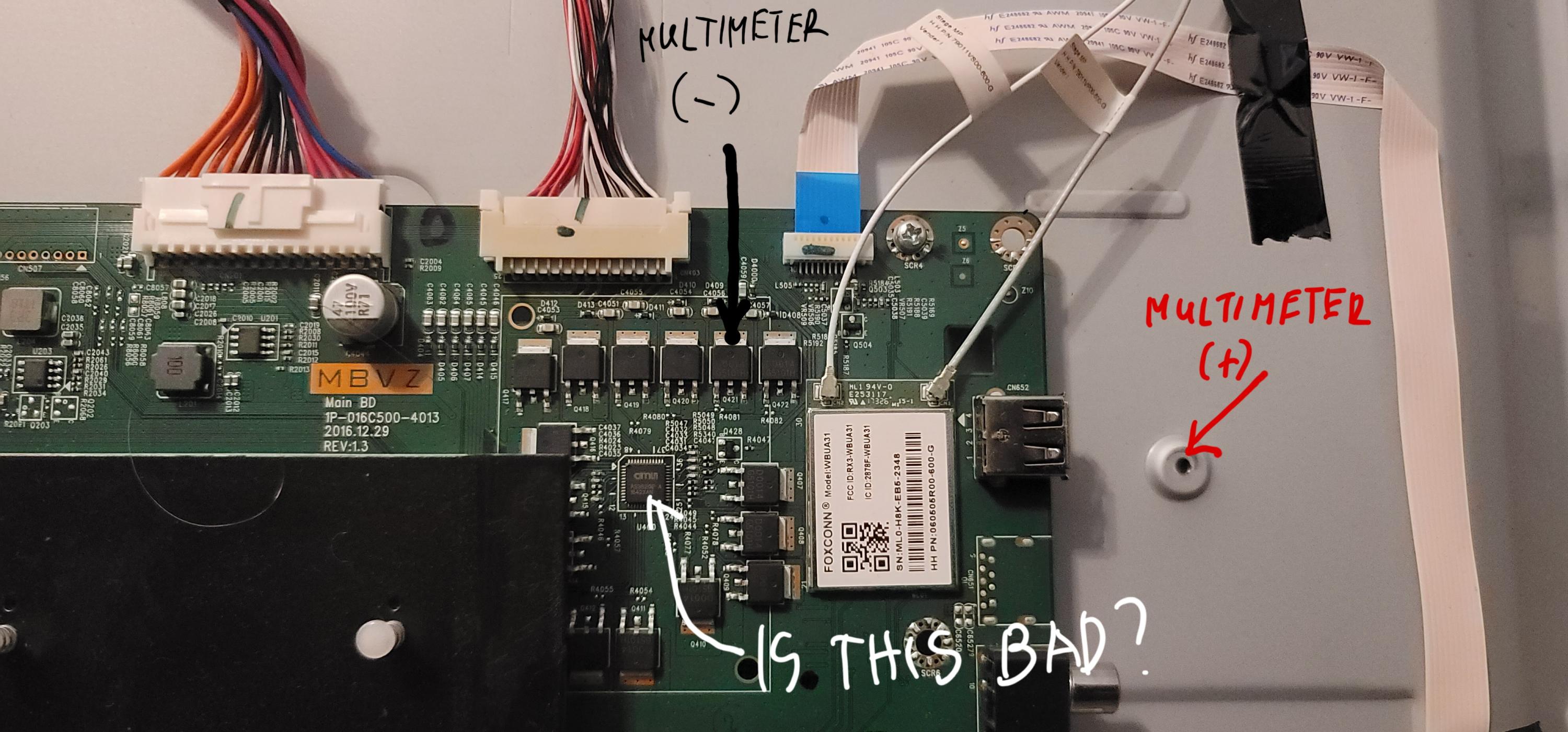

                #107
                Re: Vizio E65-E3 Dead after backlight replacement
                Originally posted by a460guy
                ok so after replacing the backlights on this E65-E3 vizio, the tv would turn on but there was no voltage going to the led strips. after pulling off every cap, mosfet, and diode on the powerboard i could not find the fault. im sure i missed something as i have not been classically schooled in electronic diagnosis. i ordered a powerboard from a e70-e3 (because they were going for 1/4 the price of the 65). once installed the backlights would shut off every so often (due to them being over juiced from the higher output powerboard. So i removed a capicator at C1, swapped transformer at T301 and swapped resistors at r317 and r318. also removed r319 that made both boards identical.
                There was also a pretty heated discussion about zener diodes in this thread. Thanks to all who contributed!!
                so I did all what mentioned above and still did not turned on the LEDs however I did try to put an E80-E3 main board and it starts right up and LEDs on
                (the picture is shifted and stuff like that but I guess its because the E80 is programmed for a T-CON with 4 output)
                anyway the red wires from the mother board to the LEDs is all having the right output voltage but no GND (I assume its a low side switch circuit) while I was testing the LED switch transistors for GND continuity I placed the multimeter's (+) on the frame and the (-) on the transistor and the controlled strip by that specific transistor is came on.
                My question is that I have a bad LED controller chip on the board ?
                If yes how can I test that?
                If no, anybody out there which way to go from here because I feel like I'm close to a fix here??
                (Also there is picture and sound just no background LED,, LED strips tested good with external LED tester, Power supply needed to be replaced, set did not came on at all previously)
