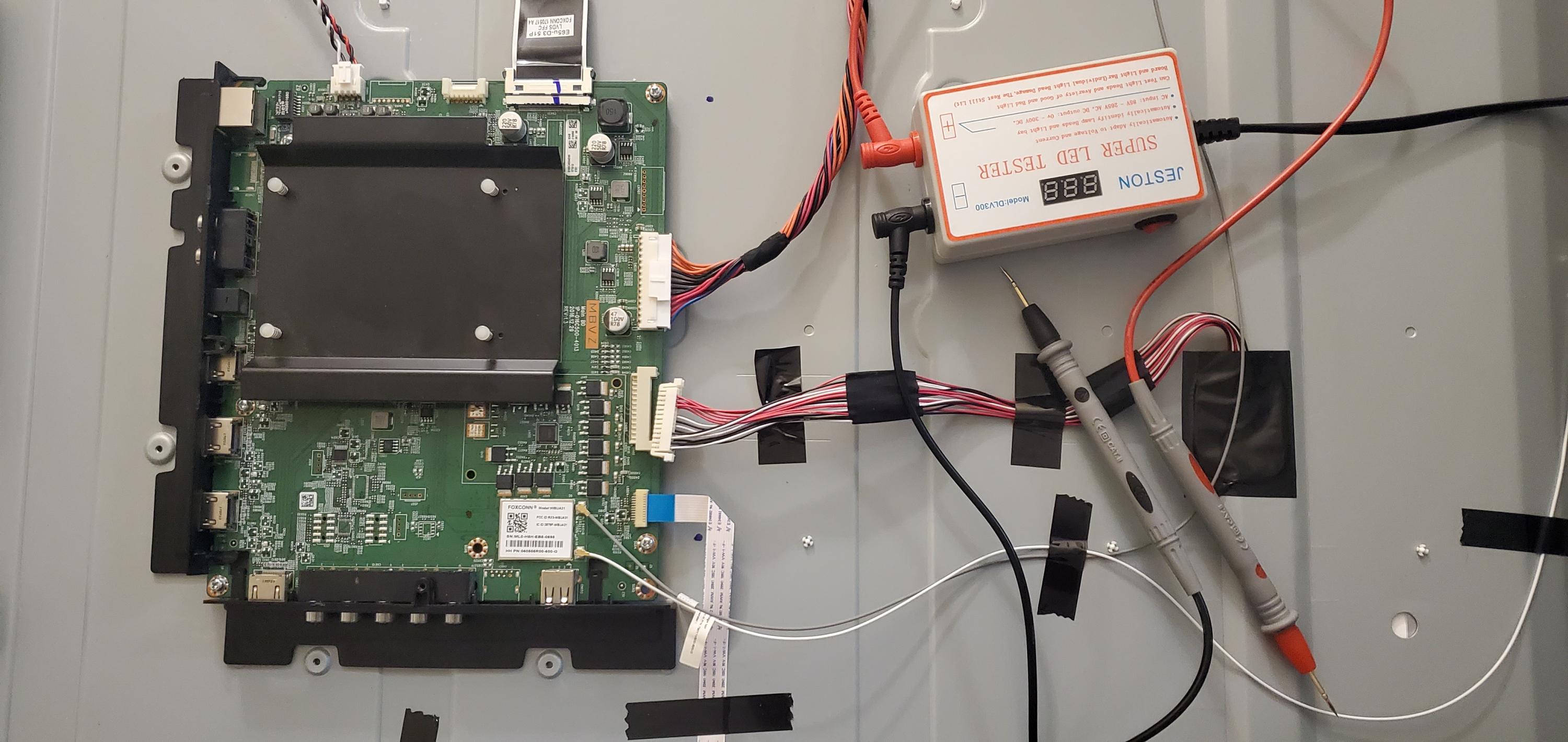

    SSooooo i picked up a 65inch vizio that someone was throwing away so i figured i would try and fix. seemed simply enough but after i got it back together it is not turning on. i have power coming from the power supply to the main board but nothing going into the tcon. i had the tv on a bed while i was working on it...could i have fried it from static maybe?? Thanks in advance!!

            When i picked it up, one side of the display was dim...like the leds were bad. after i opened it up and tested them, 1 out of every led strip (there are 12) had a bad led. so i ordered a new set, tested those to make sure they all work, and installed them.

                I pulled the connector from the main board and fired each strip. They are all pulling the same 32.4 volts so they are all working. Any more ideas?

                      Tested at the connector on main board going to leds.. pins 1 - 14..voltages fluctuate before settling around -.030.
                      Pins 17-24 all just drop to -.007 in a few seconds after power on.
                      I have a hot air station ariving in the mail today and will try the bga suggestion.

                            Does it attempt to turn on? Try connecting only one side at a time between the tcon and panel and see if the TV turns on with half a screen.
                              Re: Vizio E65-E3 Dead after backlight replacement
                              I put a flashlight to the screen and turns out there is image! So now i just need to figure out why the new led s are not coming on.

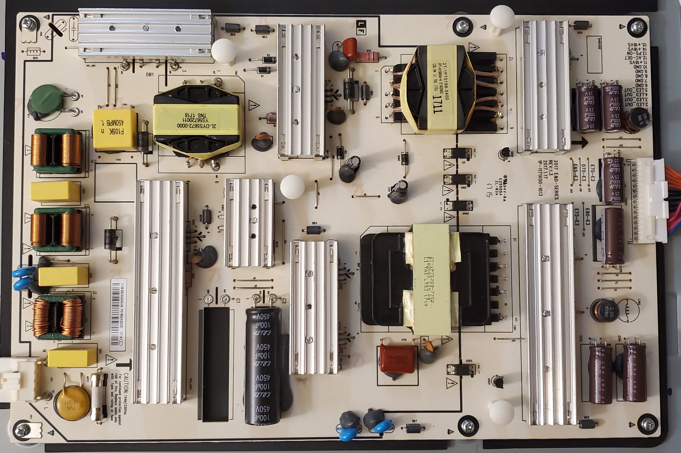

                                  Very carefully check the voltage of C2, meter set to 600 vdc, careful what you touch this is the /HOT/DEADLY side of the powerboard, with a probe on each leg what voltage do you get? Check it in standby which is powered off and when powered on, when powered on should prolly be around 400 volts if this checks ok, next I would take powerboard out and inspect the solder joints real closely and re-flow any that look suspect, google images is your friend for how bad joints look if needed.
                                    19.5v during stand by and 19v at power on at c2
                                      No sorry....... its 170vdc on stand by and 164vdc at power on
                                        Looks like youre not getting the boosted pfc, check all diodes on powerboard and don't forget to check those solder joints.
