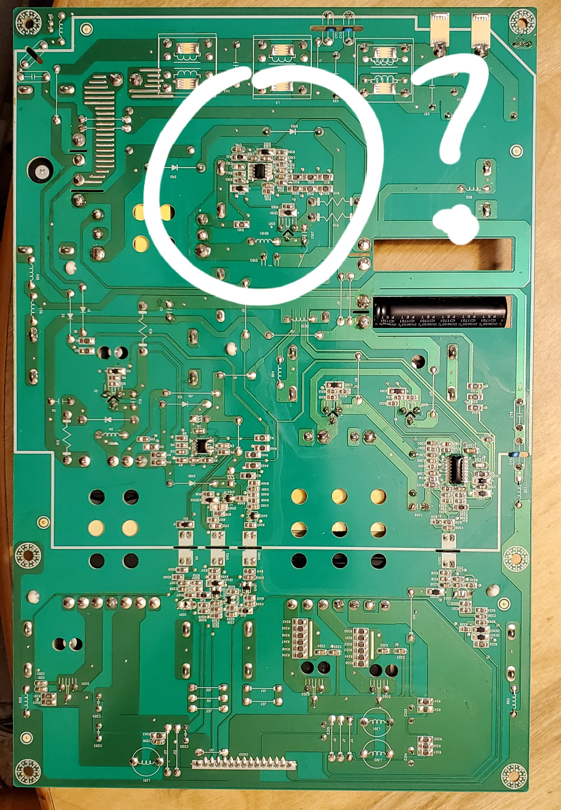

                    #49
                    Re: Vizio E65-E3 Dead after backlight replacement
                    Post #3 you say
                    Pin 1 Stby = 0V, Out of standby = 0.001V
                    which is odd since normally the standby voltage goes from 0V to 3V or 3V to 0V
                    Post #11
                    Shows no voltages on the led connector pins.
                    Post #17
                    C2 voltage at standby = 170V and out of standby 164V
                    The voltage should increase I believe to around 380V and not drop
                    I think you are missing the led driver supply and may well be linked to the C2 low voltage.
                    What is the led driver IC part number. A photo of the underside of your power supply could prove usefull.
                    Is this the led driver ic? If so it is FAN7930BG..

                        #51
                        "Is this the led driver ic? If so it is FAN7930BG.."
                        That's on the hot side of the power supply and it is the PFC controller

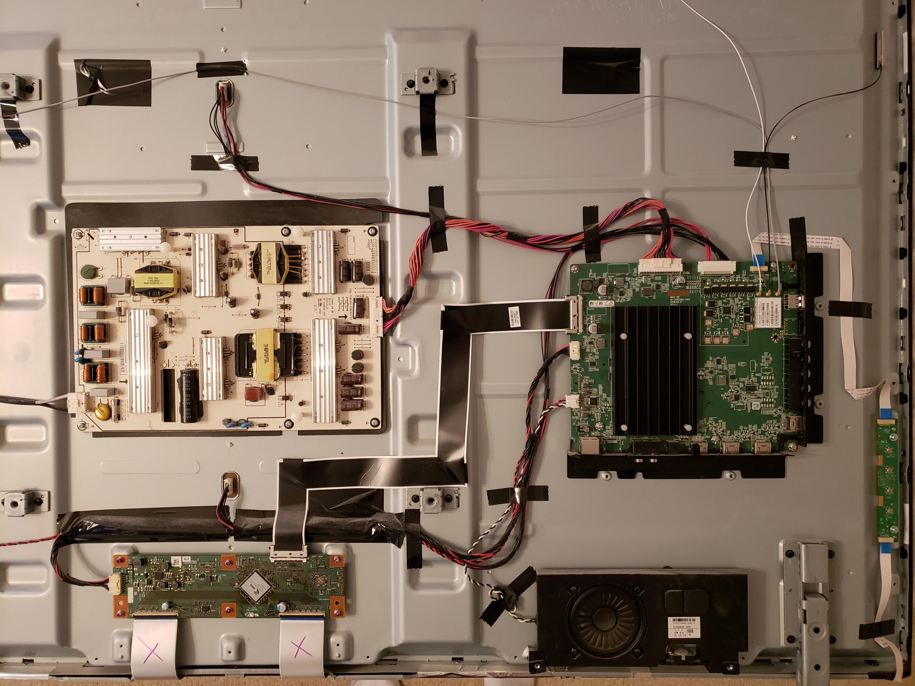

                              #54
                              Well this 60 inch set is different but close. There are 5 LED's (X2 per row) per string with a total of 10 strings with 5 rows - at 3 volts per LED that makes LED + approximately 16 volts per string - a bit high but the low side (10 Mosfets) will control current for each string and consequently voltage drop.
                              I am thinking / guessing your set has 6 LED's (x2 per row) per string with a total of 12 strings with 6 rows. That means your LED voltage will be closer to 22 volts, and that you have 12 Mosfets to control the drive.
                              I attached a picture of the E60-E3 back for reference. I have not pulled the panel yet and will not do so for another week awaiting LED's to arrive. You can see the LED connectors above and below the Power Supply with each having 5 black wires which should be the low side control lines.
                              So, with all that said, you probably should be focused on why you don't have PFC boost voltage. A lot of this is new to me and schematics are rare, but most likely you will never make LED voltage unless PFC boost is working. I got some nice help from dick_barton and R_J on a different set but it also used the FAN7930 PFC controller. My issue turned out to be a bad capacitor, but your board is newer and I can only speculate it is an issue with control - as in VCC for the FAN7930C not only has to be made, but it needs to be switched to activate the PFC boost controller.
                              This is the thread where I got the help:
                              https://www.badcaps.net/forum/showthread.php?t=94738
                              I will try to check a bit closer to see just what can be measured and what is the control logic for enabling PFC, or maybe one of the experts will chime in.
