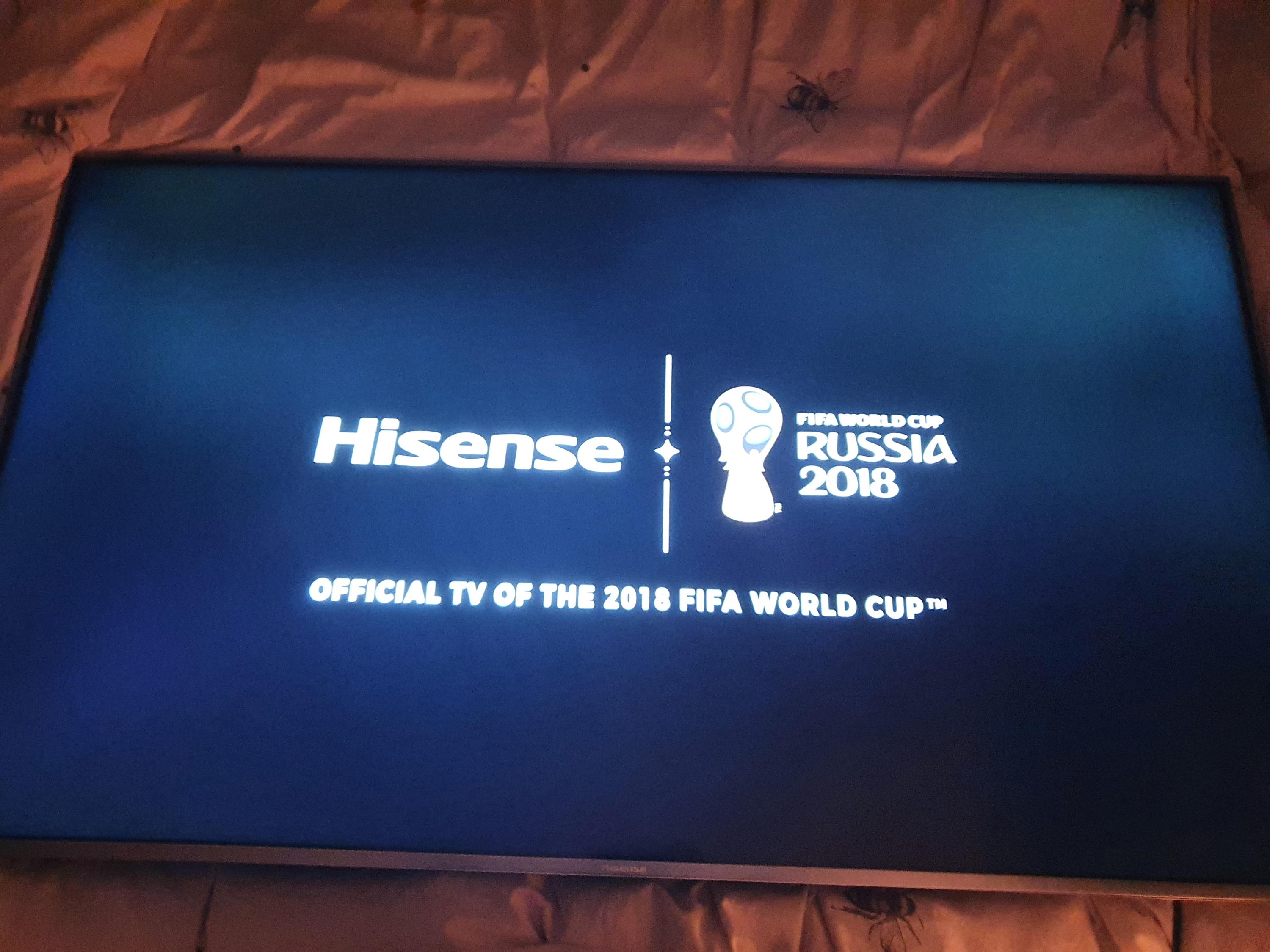

    show us photo on the first screen logo startup
    • A1rebirth
      • Mar 2021
      • 7
      • United Kingdom
      Re: Hisense H55A6500UK logo loading then black screen
      Sorry if its a little dark.

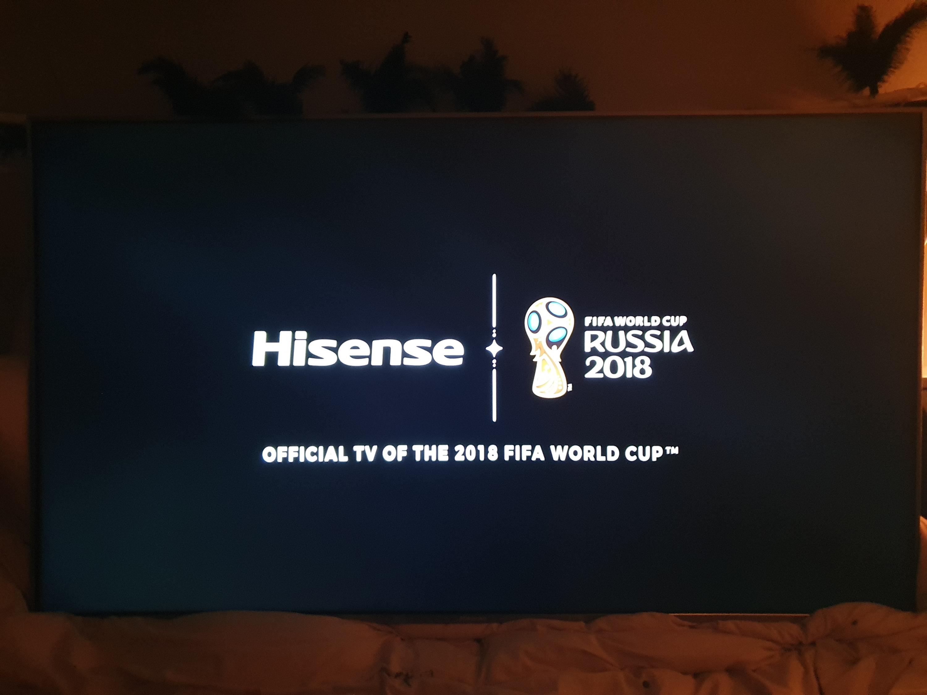

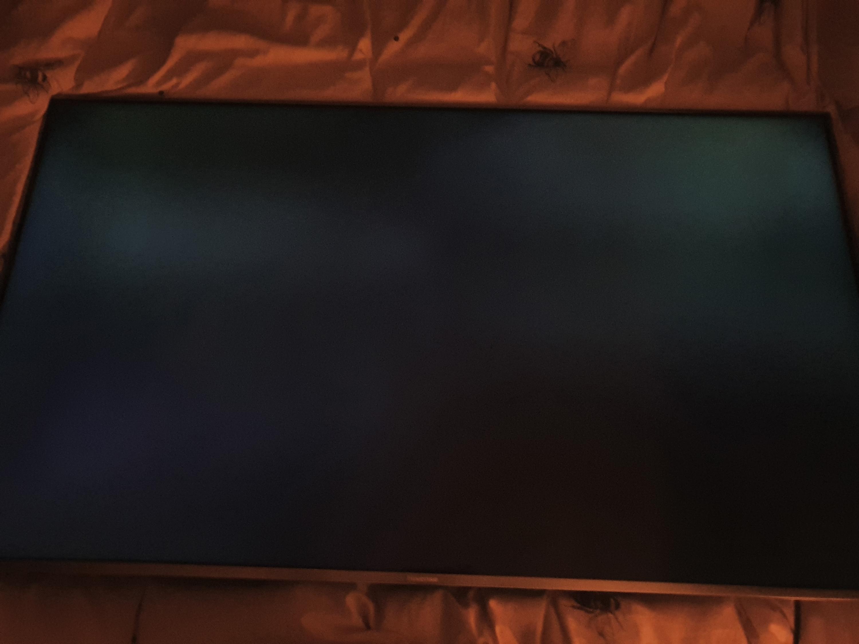

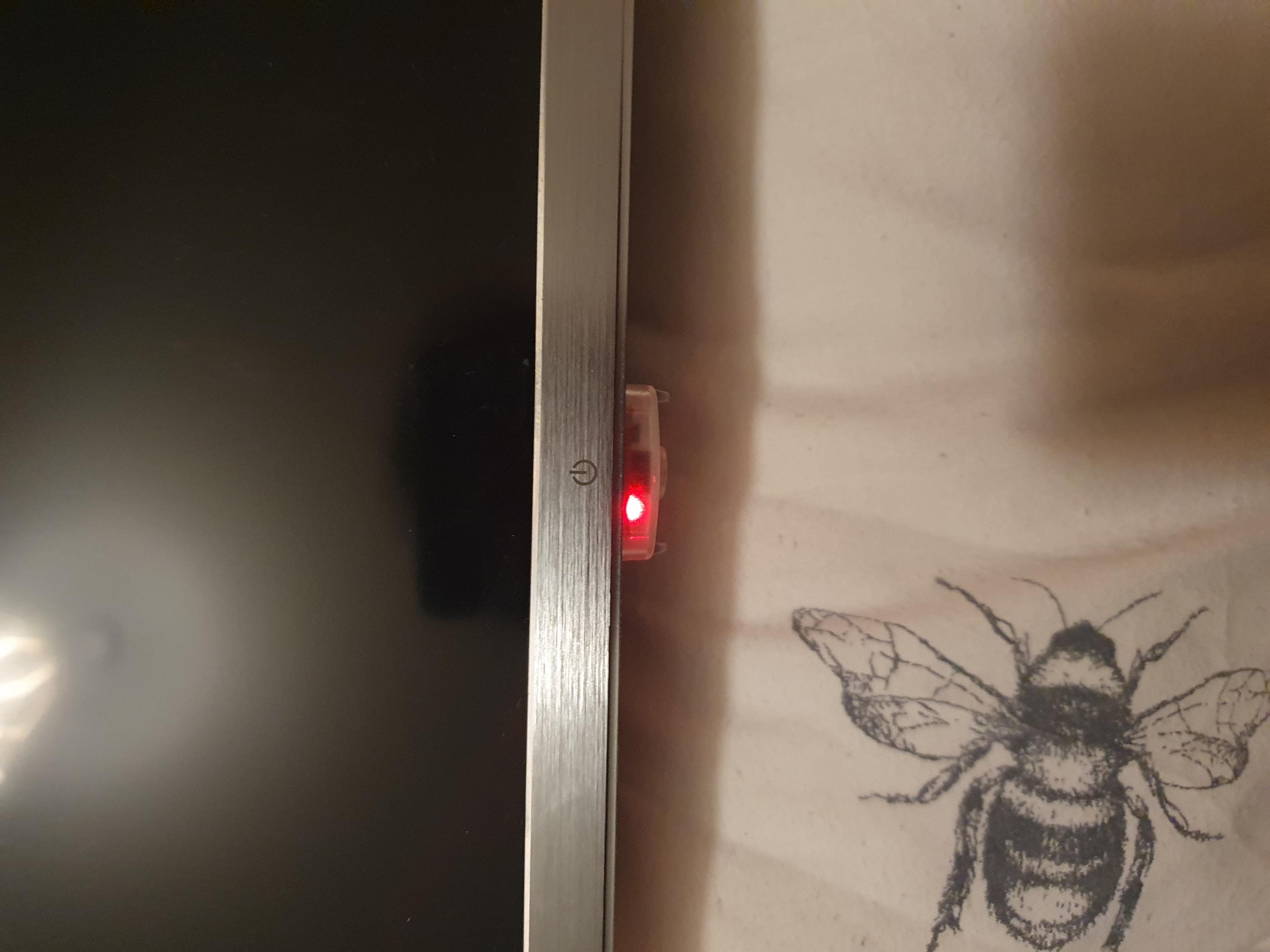

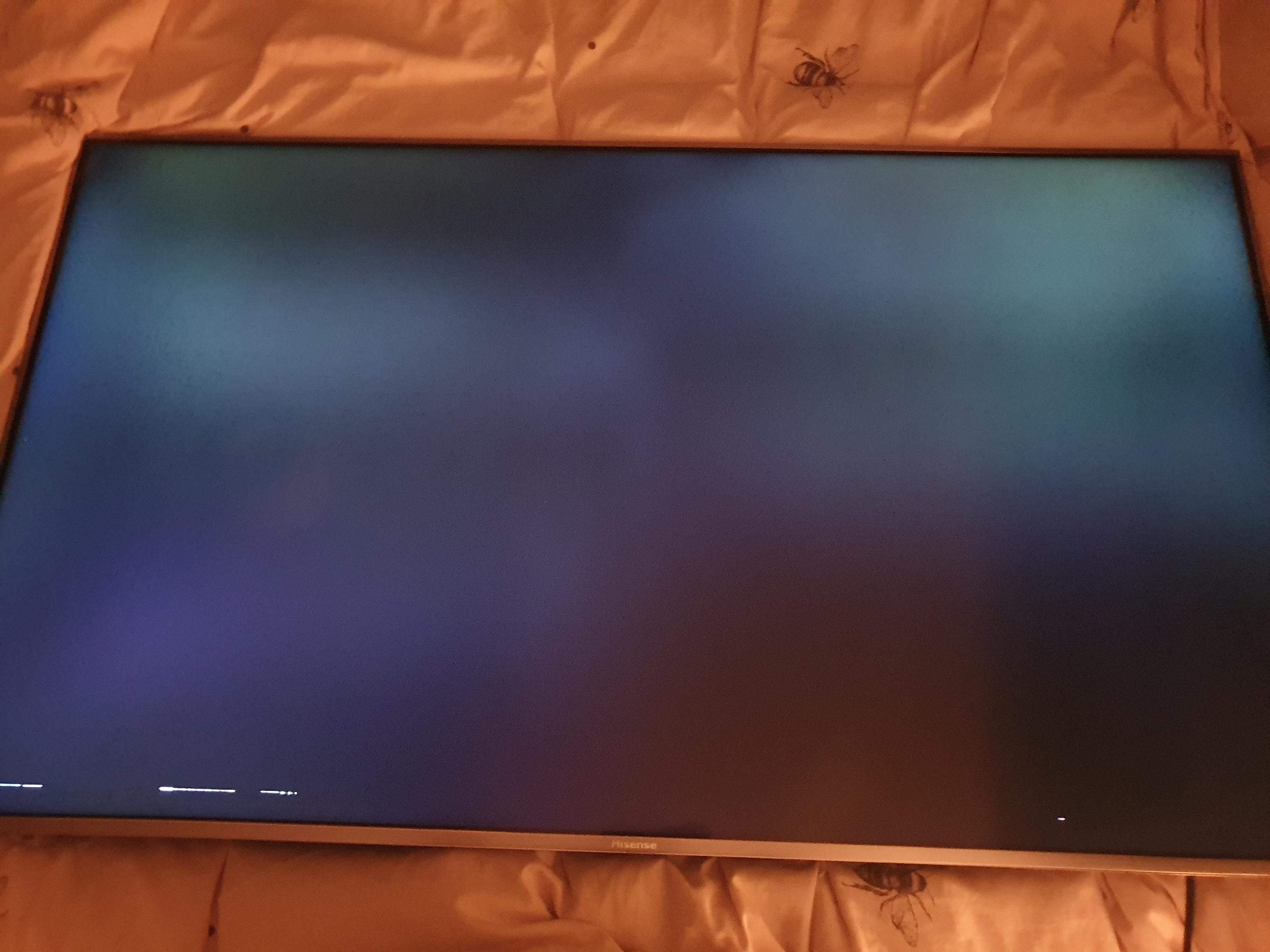

                        Everything has been removed from the tv when i have been trying.
                        Just the power cable. First photo is the led when plugged into the wall and nothing on screen.
                        Second picture is the logo appearing when i press the power button on remote.
                        Third picture is when the screen goes black after the logo.
                        Fourth is a picture of the lines that appear after, they move in flashes sometimes none sometimes tiny sometimes longer ect
                        Thank you for your time.
                          first picture mean your TV last state Standby... i send you PM answer me there

                                Just to clear the result on this issue, which i didn't saw before.
                                following with him on other source contact , it come out he had flickering LED backlight. which they drop the 12V to main.
                                the owner didn't have any voltmeter or parts to use in order doing test.
                                with simple method, the BL are tow groups Only, each with LED+ & LED-
                                with test by unplug the LED- from sockets resulted one group was Open.
                                so what we can use.. and he didn't have either Resistor to test with and to avoid taking the panel apart as its 55 and could cracked under his hand ???
                                used Normal table lamp with filament lamp connected in series between LED- Open Group and the pins on the socket... TV started and can downgrade or update firmware.. but it remain reboot at normal screen starting... as i think the 12V remain not stable, but by upgrade and downgrade it show the process.
                                any repair shop owner in UK near to his place if they can offer repair the open LED to him.

                                  I just fixed one of them mine had the pulsing backlights flickering screen with the oldd white horizontal line appearing randomly, and on measuring voltages they seemed to pulse too.
                                  I thought it was the mainboard as once the logo came and went and backlights were pulsing I couldn’t turn off by the remote, it was like blocked out.
                                  It still did it, so I replaced psu and yes it still did it.
                                  Yes I was stupid not to test the backlights, one channel was o/c replaced one led and its now ok
