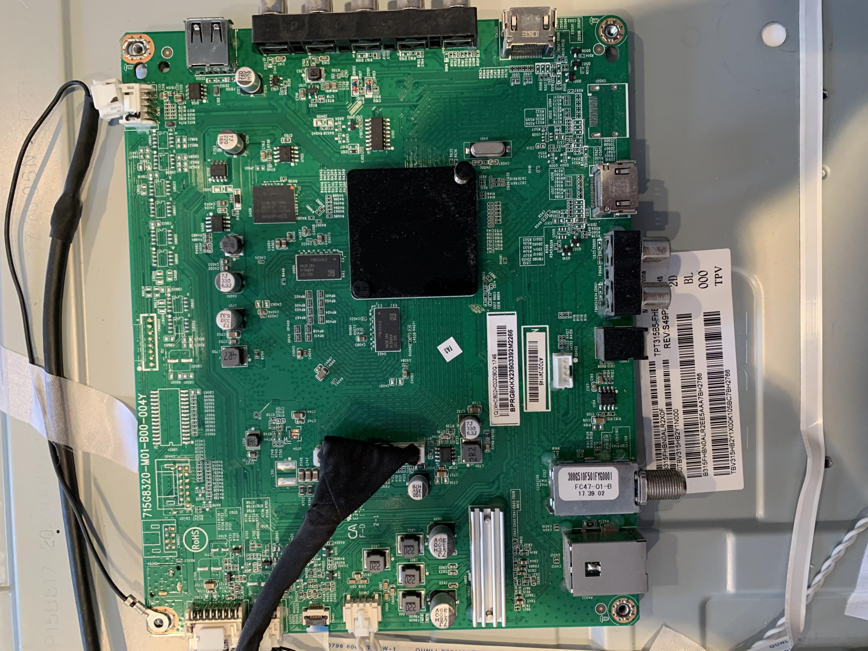

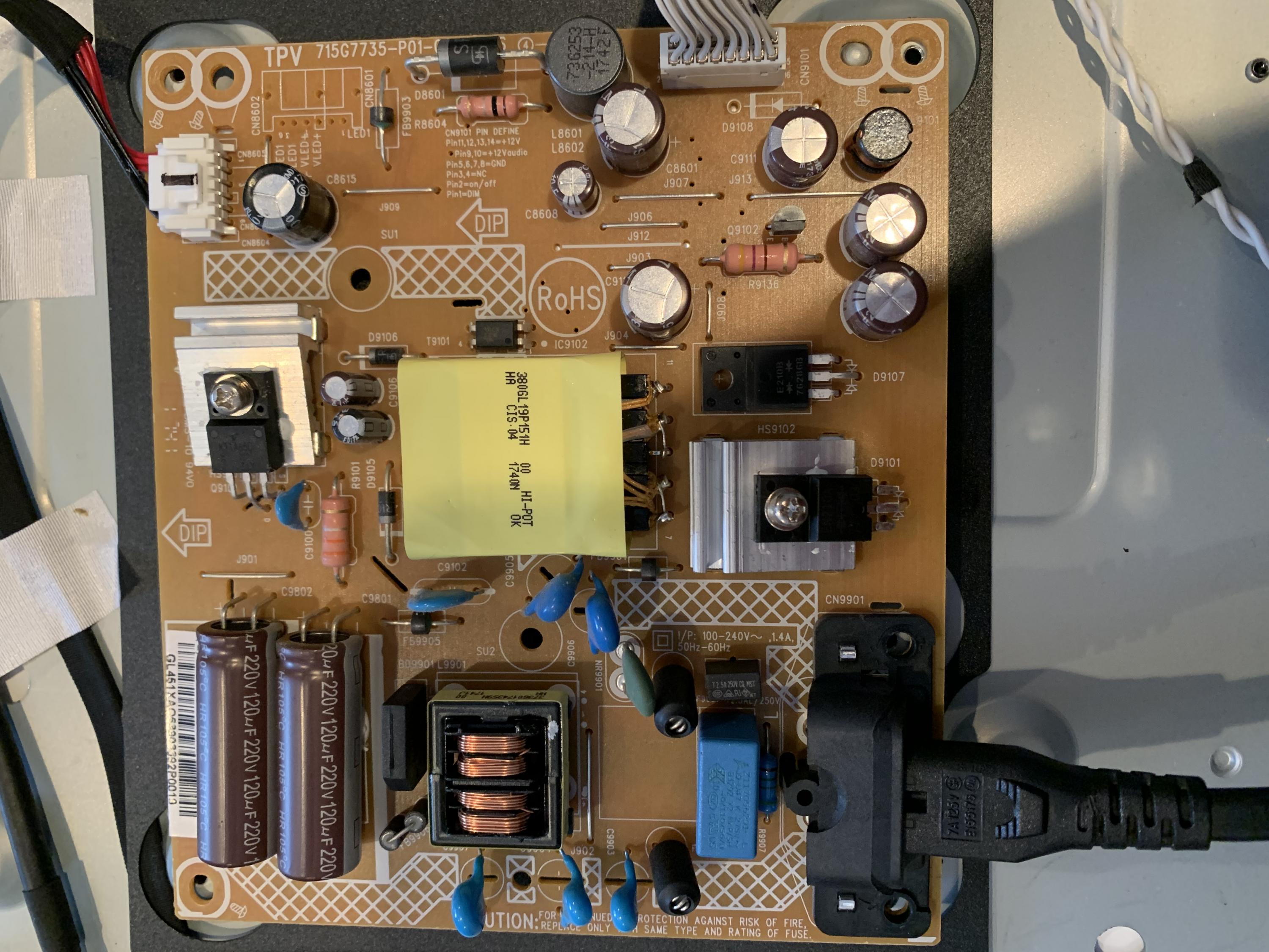

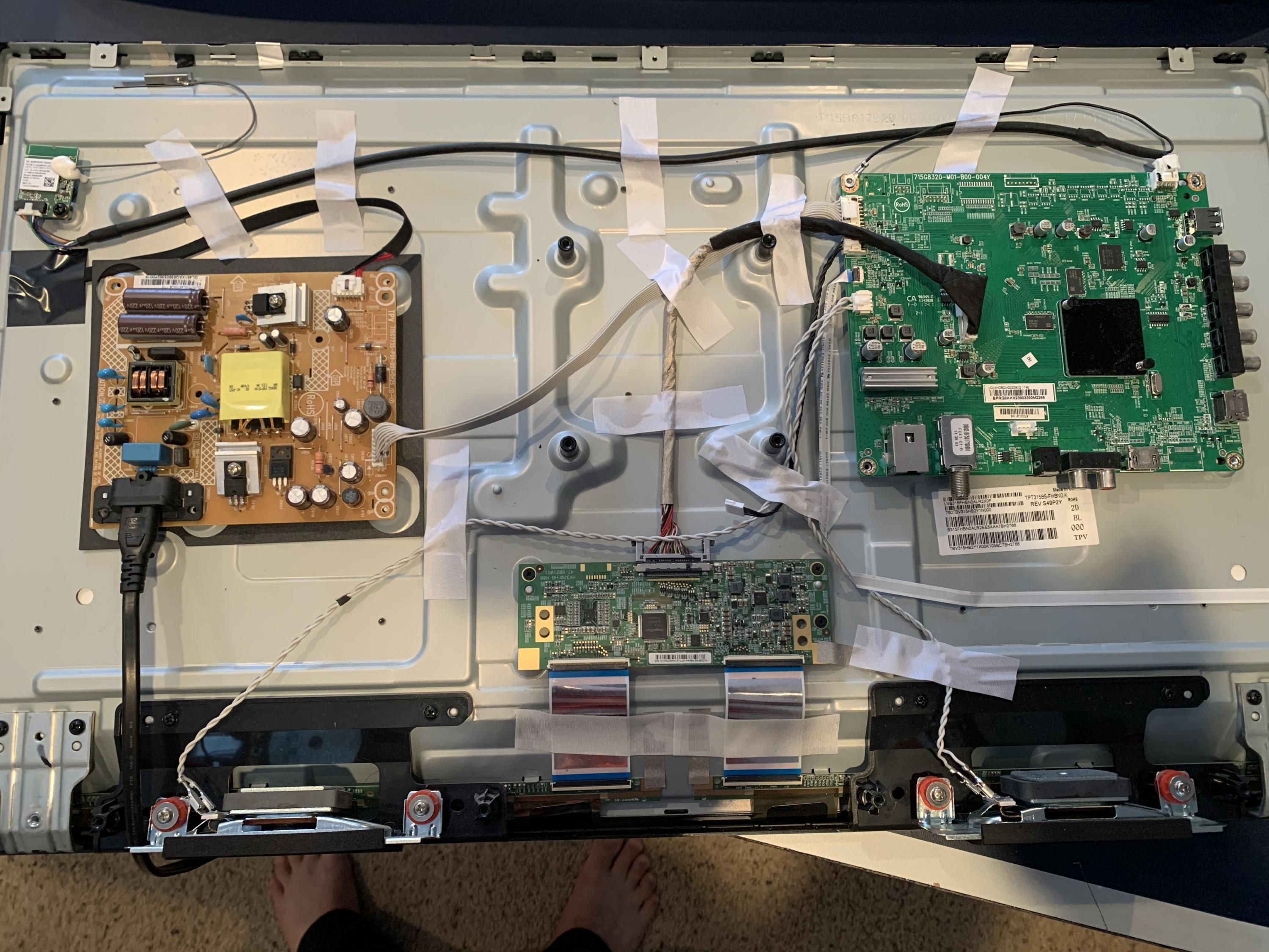

      Please attach good clear pictures of the whole backside of the TV showing all the boards, and good clear straight shot of the whole power supply board so we can see what we are dealing with.

          Pictures attached.

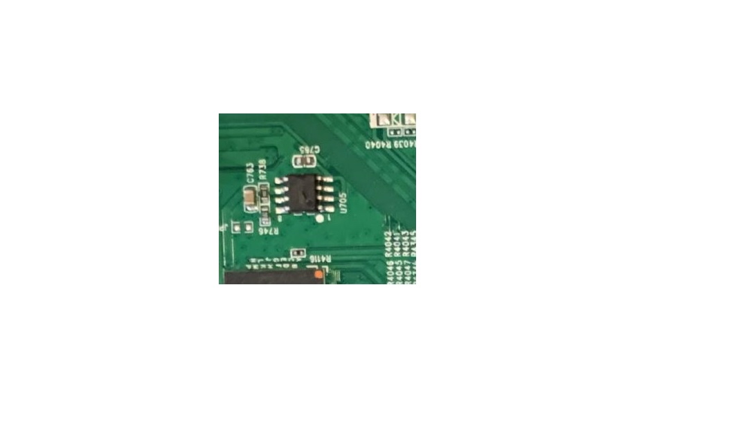

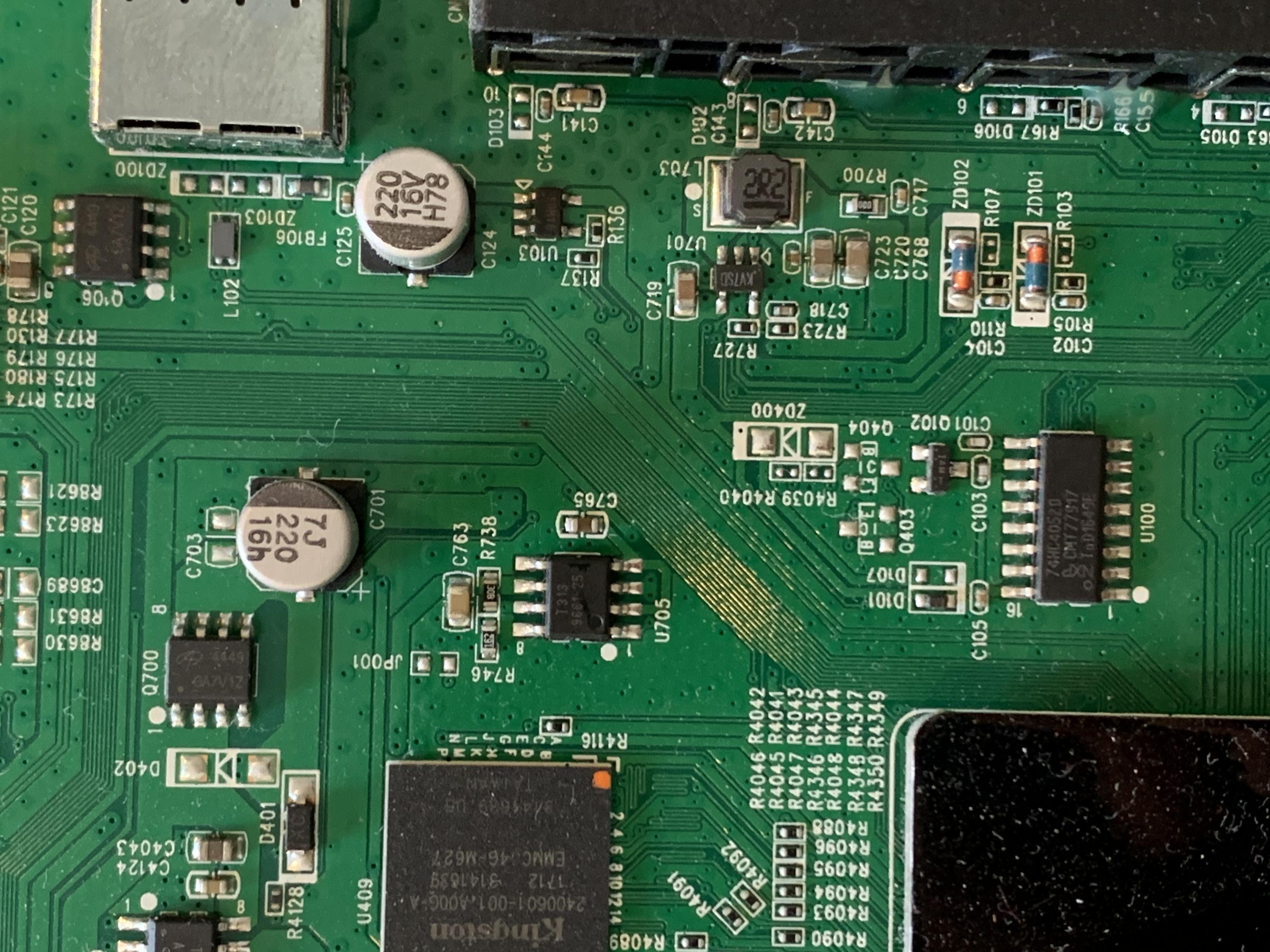

              Take a closer look at U705 on the main board, it looks like it is bad or is it just something on the ic?

                There is something on the surface of the chip, but I think U705 is OK. I was hoping to only buy one board, hence the query on this forum. Any best guess as to the problem board?

                  Shopjimmy has the main board by itself for $19.95 U705 is a 2.5v regulator, check if it has 2.5v on pin 6.

                          Thanks for the Shopjimmy tip! I checked pin 6 on U705, and it read 1.79V when plugged in. Does that mean mainboard is ok?

                            No it means you have 1.8v out of a 2.5v regulator ic
