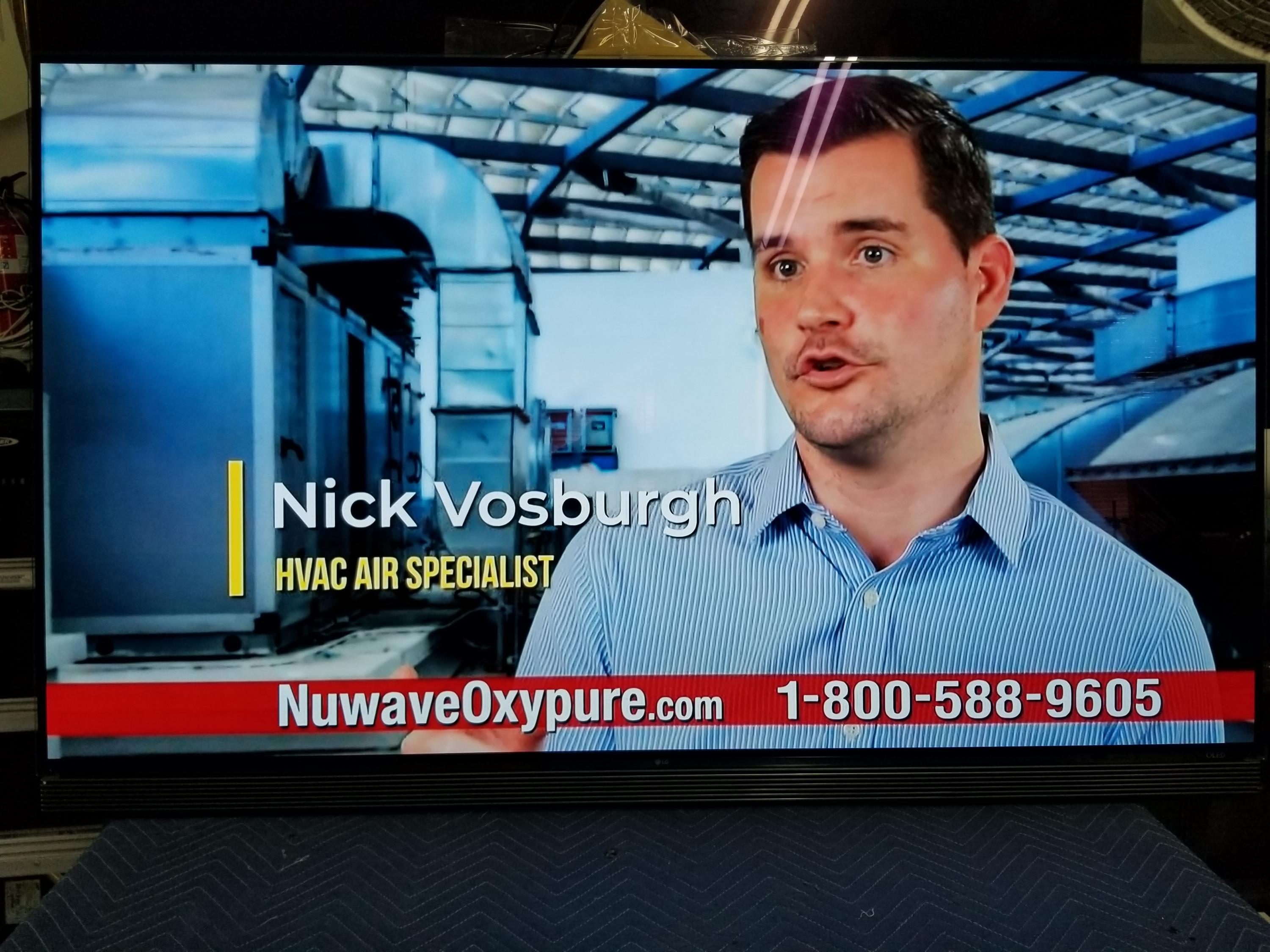

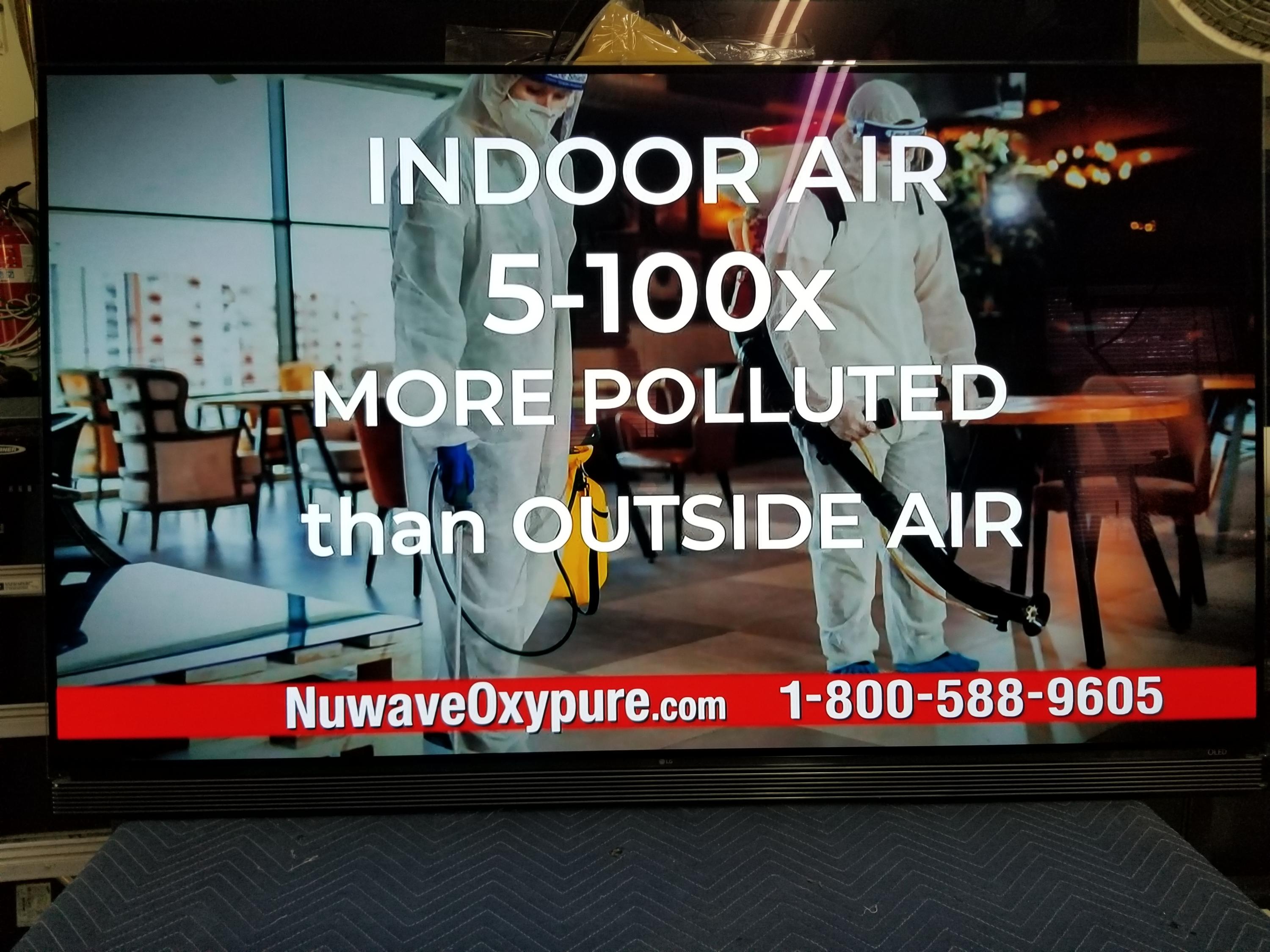

                              After much trouble shooting and with the help of Diah, we finally got TV working. It ended up being the main board. See attached photos.
