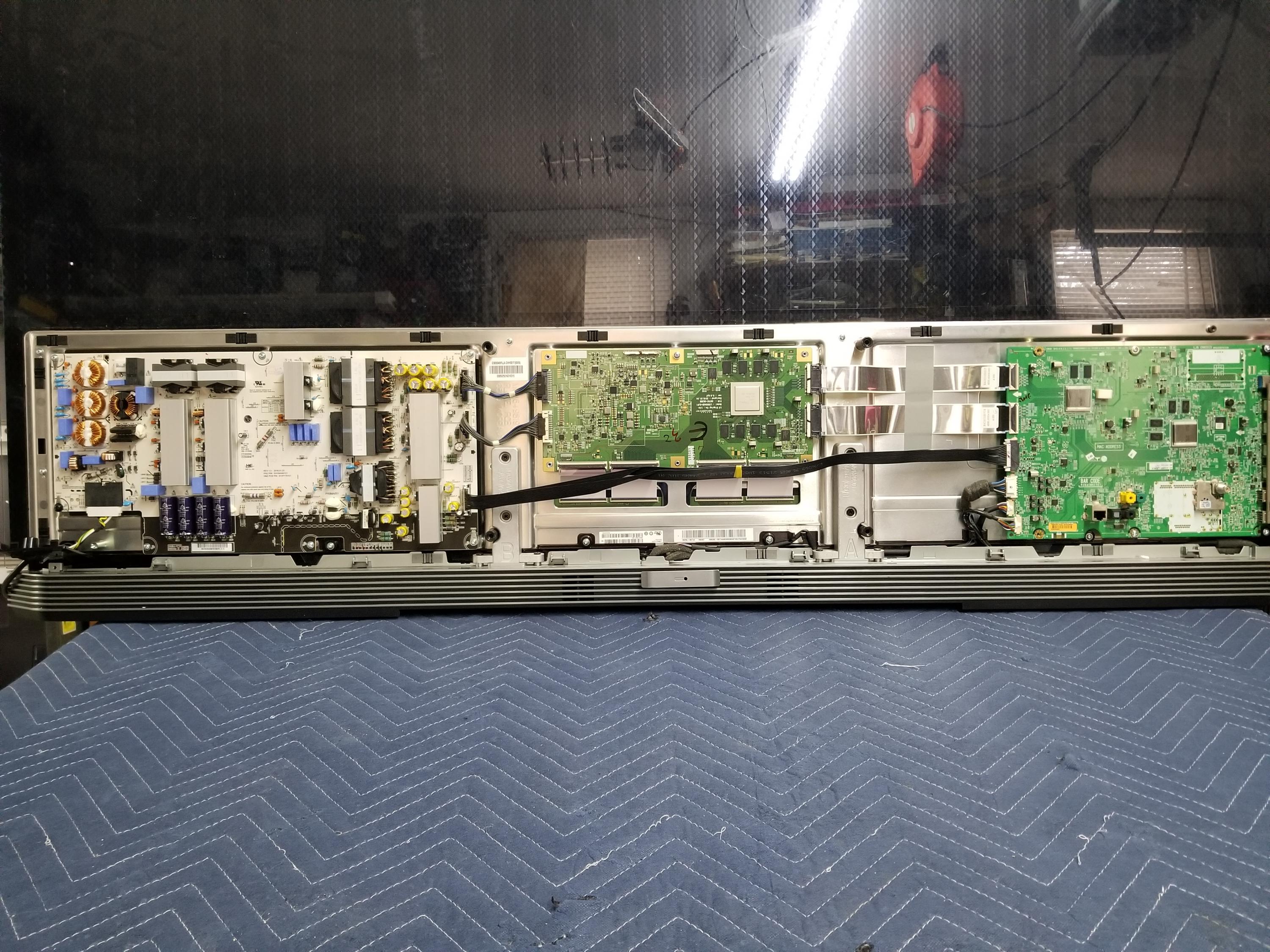

        Got TV back on the bench and done some testing. Only voltage I have is the 3.5 volts on the power board. Push the power switch on TV and also on the remote and the TV will not turn on. It sounds as thought the main board is not telling the power board to power up. I haven't seen F1 but did find F100, 101 and 102 on the power board and they are all fine. All boards and connectors are connected properly. Not sure where to go next. I have found replacement power board and main board but not T-Con. Just don't want to throw boards at it if possible. Have any ideas where to go now? Thanks, Randy

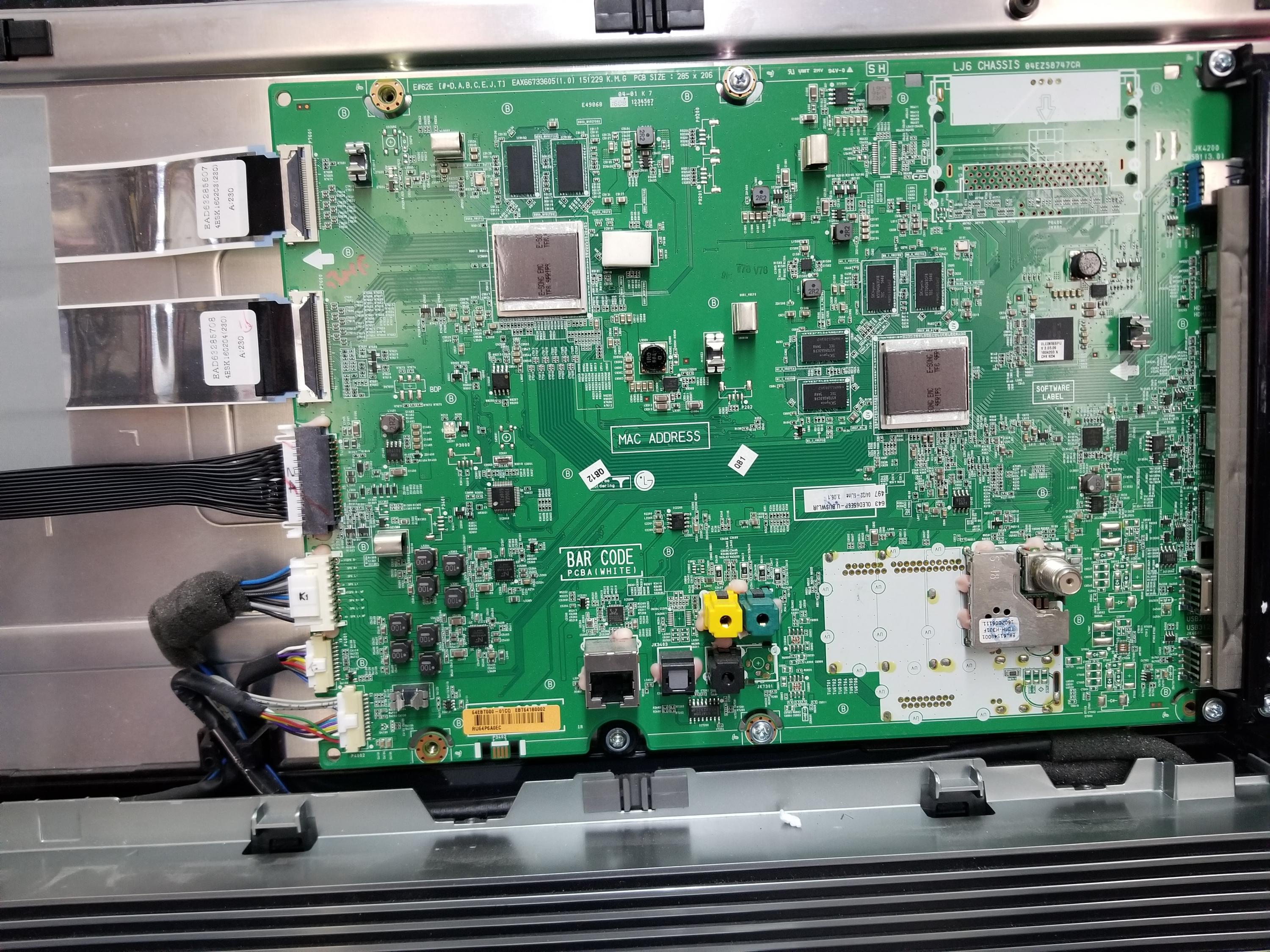

          please upload focused high resolution photos on whole the backs and others for power board and the T-con
            Re: Lg oled65e6p-u.buswljr
            Just added the photos. Thanks

              however i cant read the labels on the power boards sockets, but you should have one sockets go from power boards to T-CON which it feeds only 24V .. this socket disconnect it from T-con side... turn on the tv. give time to let it boot... just keep your eyes on the audio optical out put socket if the led indicator turn red and remain red ( this mean the tv working )

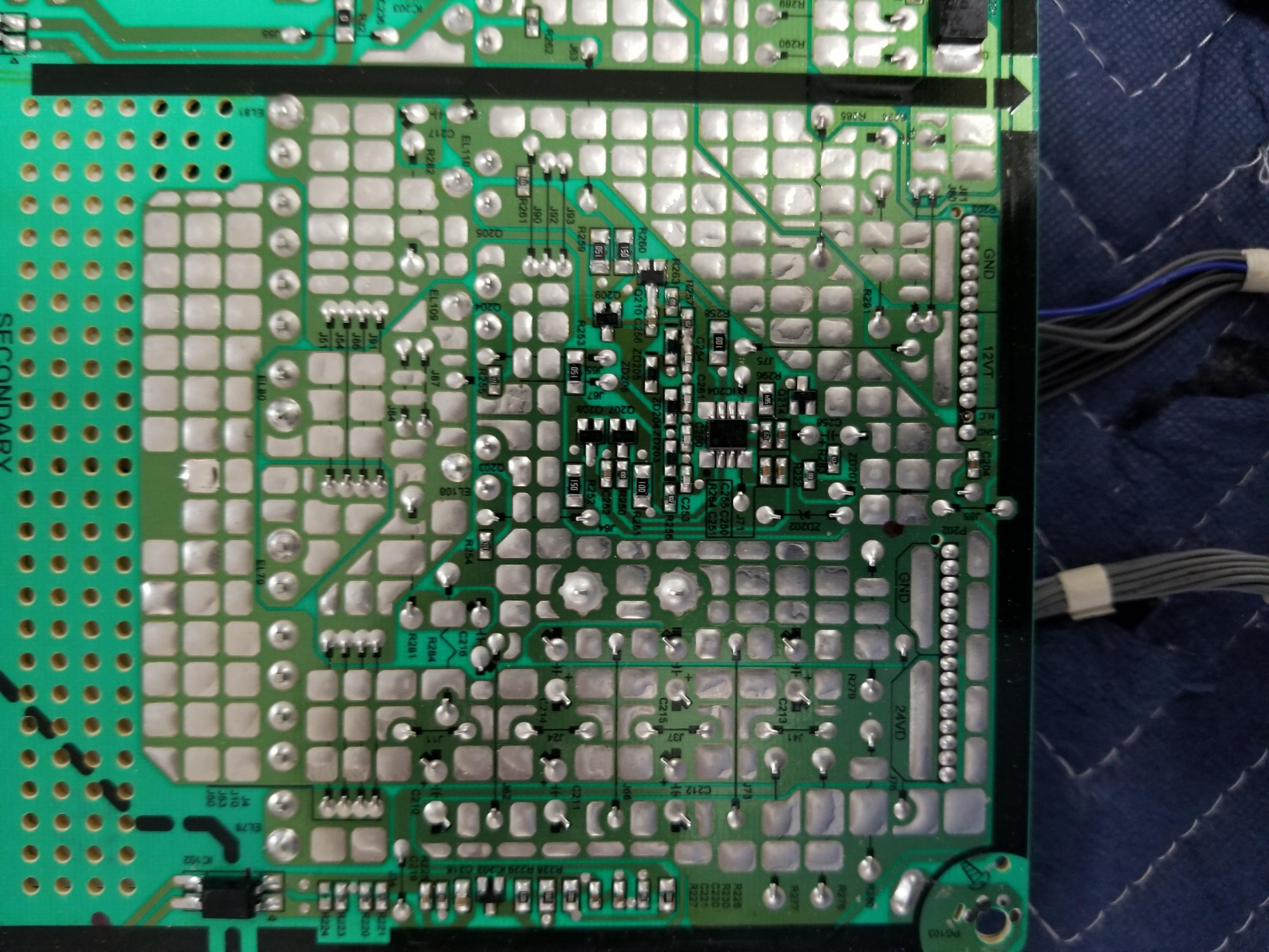

                                      follow the line back on the 12V T-con socket until the SMPS . need to test then if they are OPEN
                                      post please close photo on the socket 12V from down side and the top
                                        Attached are closeup photos. Not getting any voltages to socket
