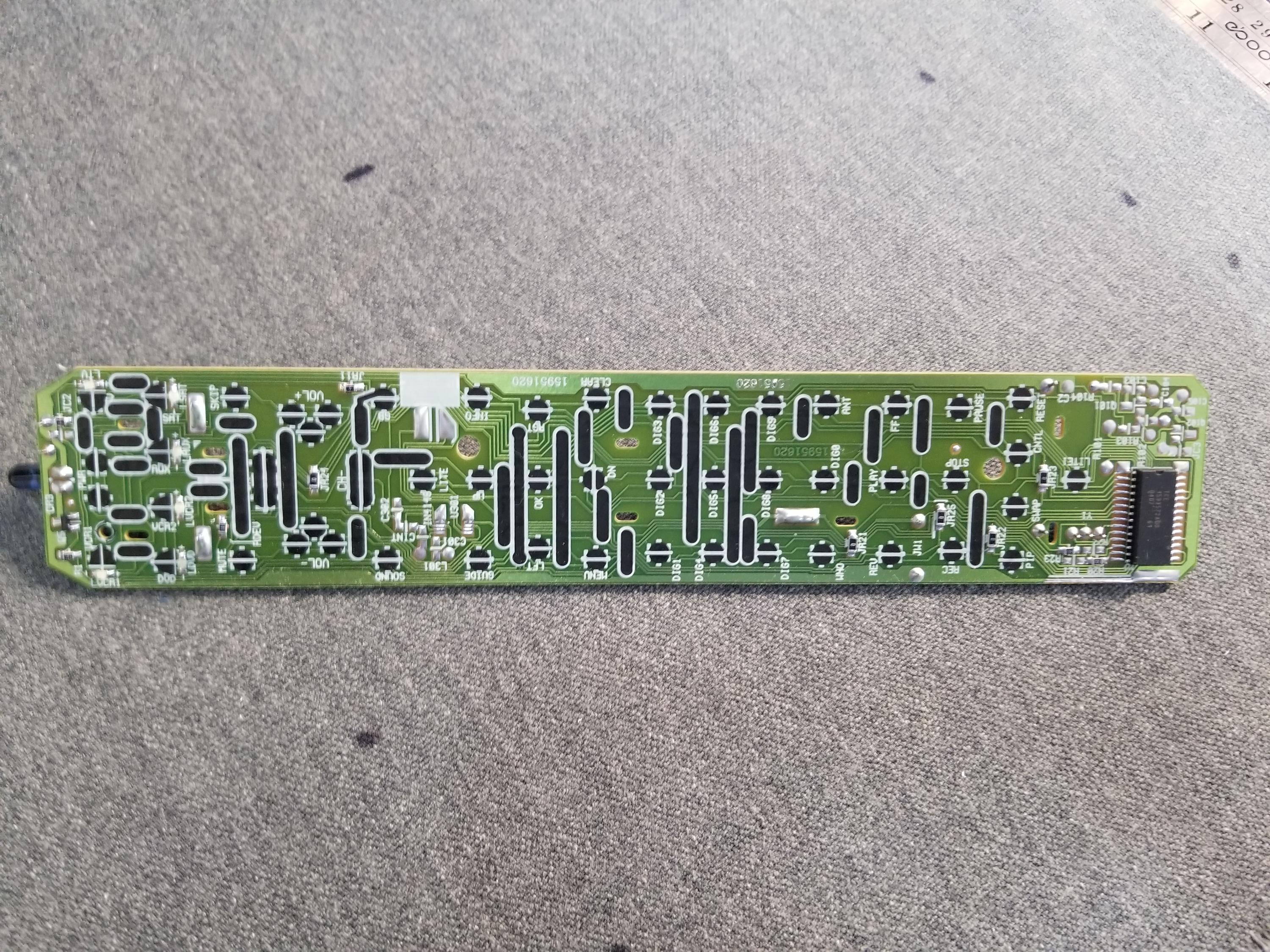

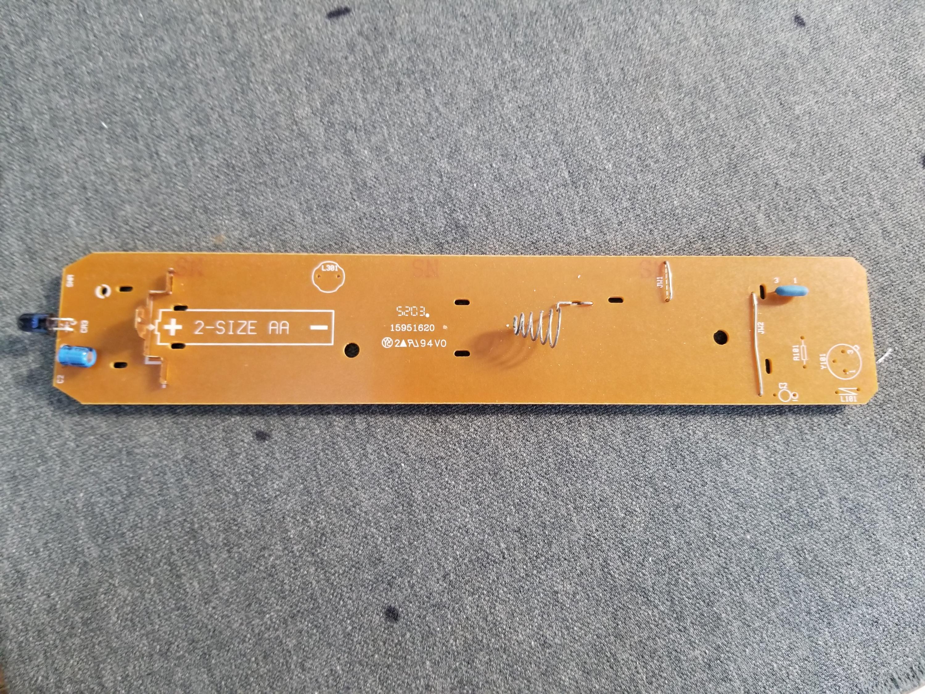

                        Never done the remote IR before. I've taken the IR circuit board out of remote. So I need to get a stereo headphone plug with wires attached to the ground of the post and one connected to the center of the post. Where on the IR board do I connect these 2 wires? Would it be the positive and negative battery connects? Also, how long should this wav file play? The one I've got here only last a second.
                        • Diah
                          • Feb 2013
                          • 6438
                          #72
                          Re: Lg oled65e6p-u.buswljr
                          no battery should be at yours RC, the cable connect them direct to the IR sender pins.
                          play wave once. test your work with your mobile camera until you can see the IR blinking once red or more.. then play it to the tv
                          you may need to try all the jack cable until you see with camera the blink of IR

                                  you dont need the board at all or to power it.. lol , we use only IR sender Diode..
                                  ask friend if any had android with IR blaster to install on it RCoid app or the one i gave you... or you need to buy LG service remote control

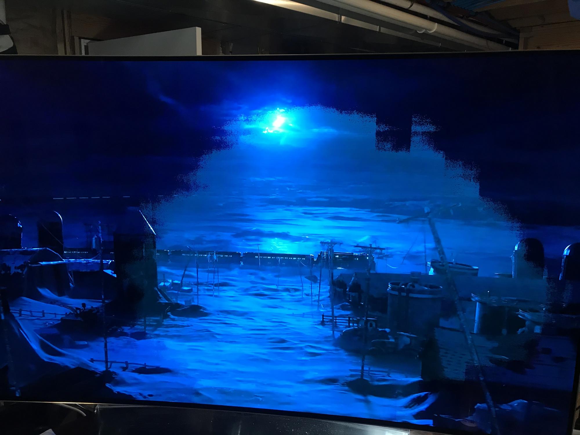

                                    • Hink85
                                      • May 2019
                                      • 22
                                      #78

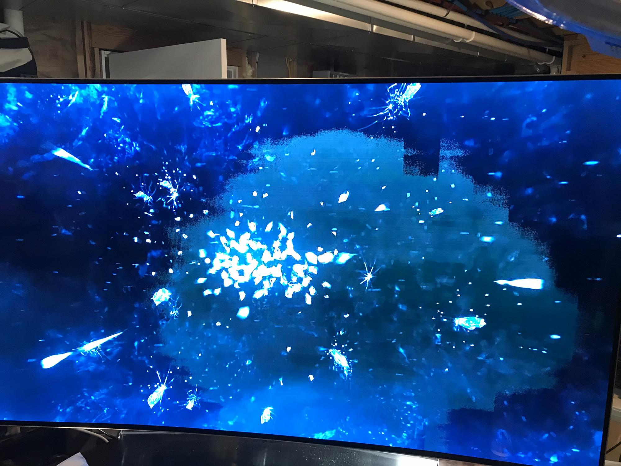

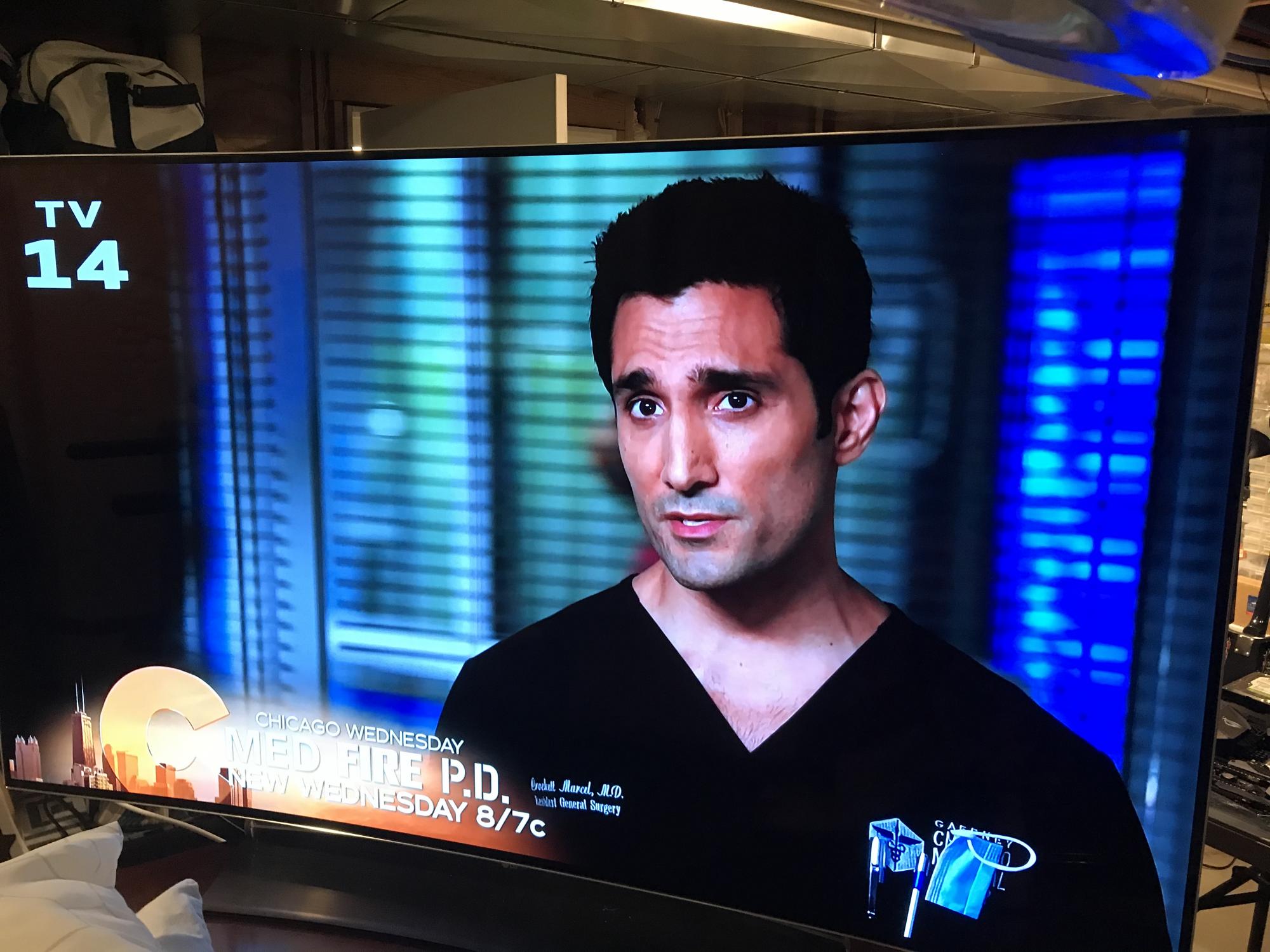

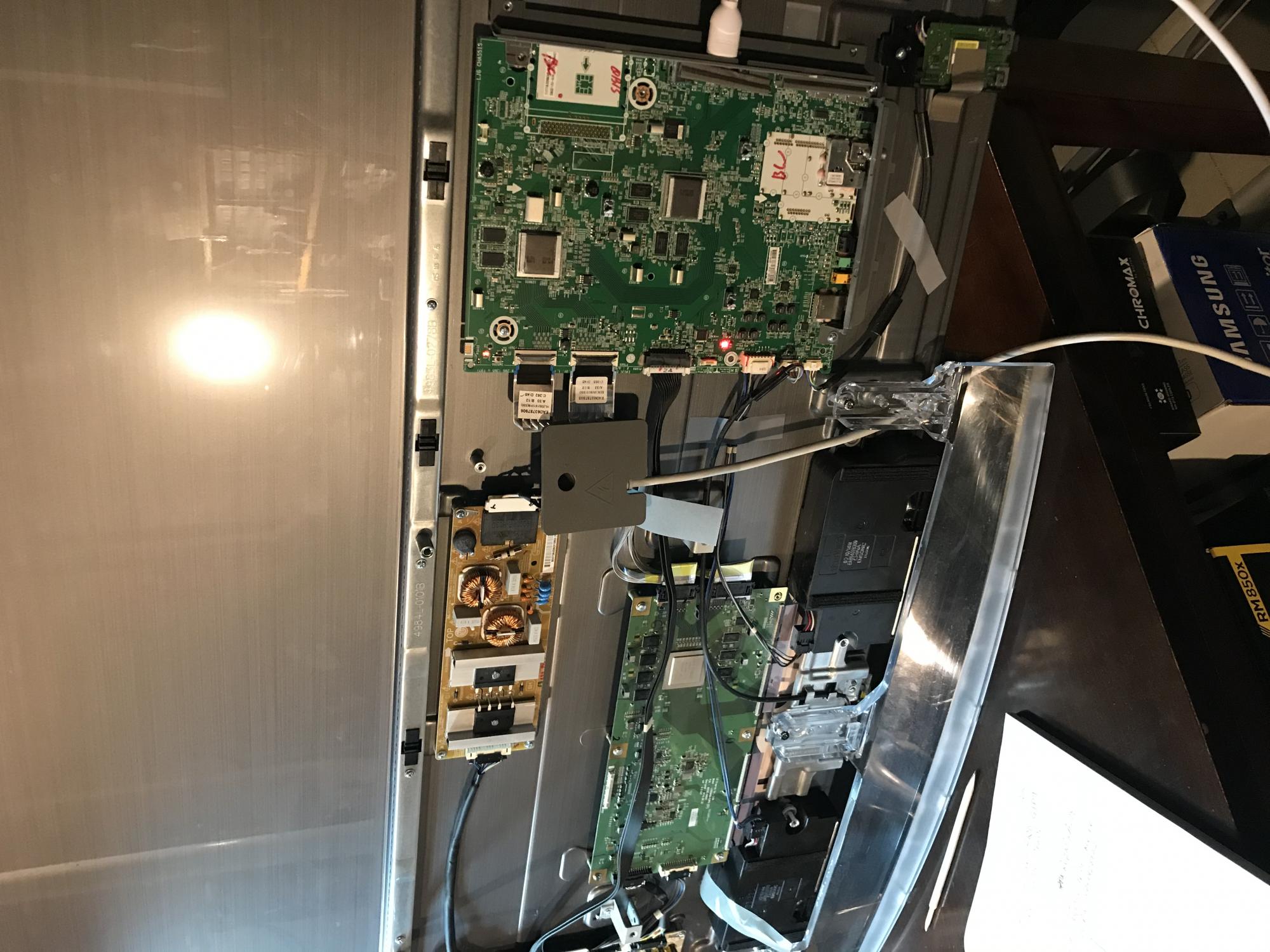

                                      I just went through a 55" LG OLED55C6P-U and it is very similar to your tv. I was measuring 3.5V on the 12VT_ON, and I wasn't sure if that was correct or not, but the t.v. had all the 12, 24, and 3.5 voltages. The T-Con board didn't have any bad fuses and had the 12 and 24 voltages. I ordered a replacement T-Con board (from the same site Diah recommended) thinking that was suspect, but it didn't fix the tv. I then went ahead and ordered the Main board, and the tv has worked since (I did have a section of picture that was blurry). I ended up putting the original T-Con board back in and the picture appeared to be resolved. I'm not up to par on these newer tvs and how protections work, but I do know I had the majority of the voltages coming off the power supply and the screen would occasionally give me a full screen of different colored squares when I attempted to turn the tv on. The main board was the culprit on mine though. I will try to throw up some pics.
                                      • Hink85
                                        • May 2019
                                        • 22
                                        #79

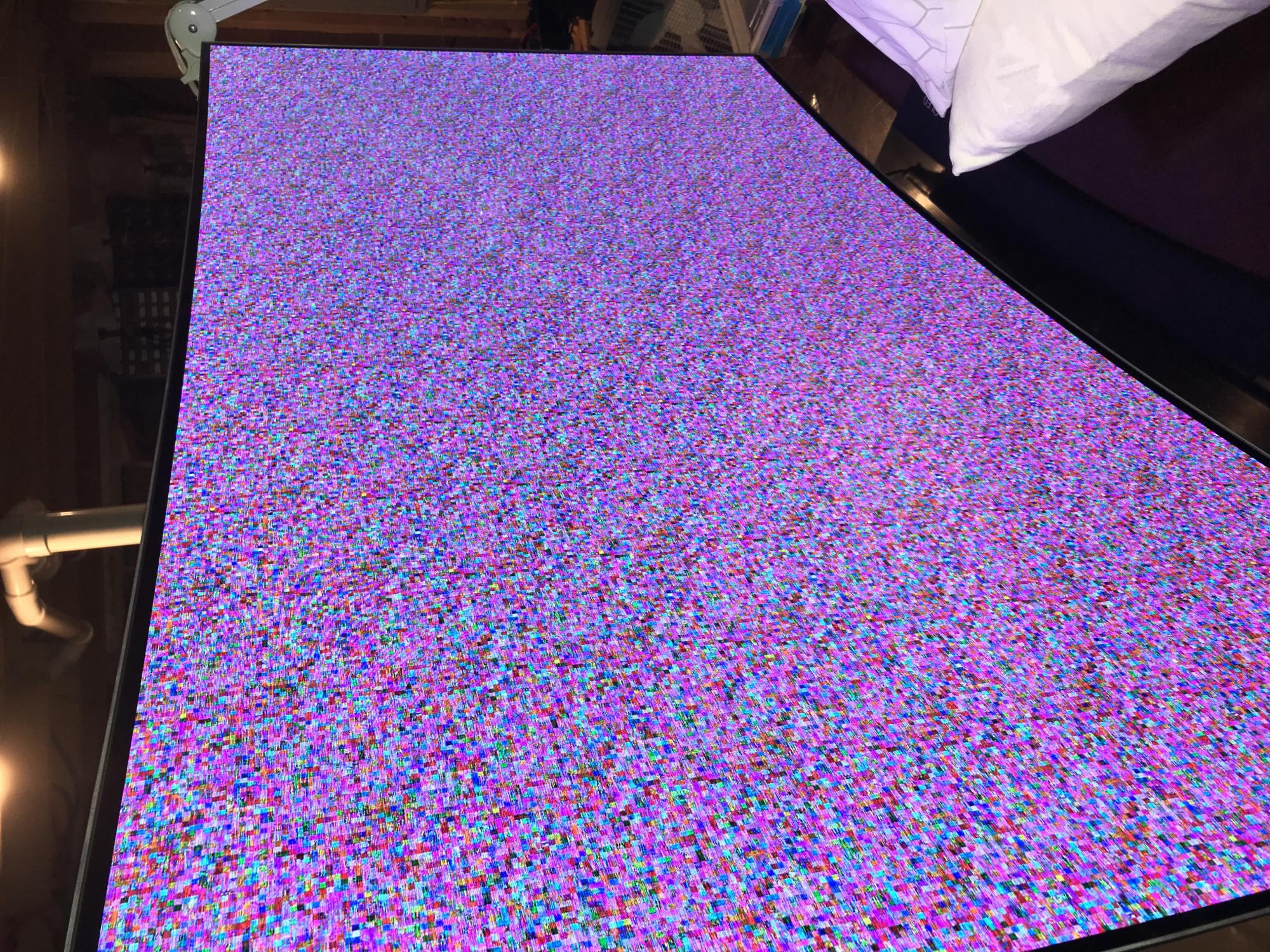

                                        My first attachment was a pixelated screen that I randomly got after disconnecting the main board. That made be believe the screen was fine. I just thought the main board was kicking the screen out. The second and third pic were after I replaced the main board, it had the section of screen that was showing a rounded image in the middle of the screen but you could see vertical lines as well. I put the original T-Con in after I saw that, thinking it wouldn't resolve it, but it did and the final picture was the end result.
                                        I would love to know if anyone could have any explanation on what may have caused that pattern on the middle of the screen. Could it have been a ribbon cable not perfectly seated or possibly a bad T-Con board that I ordered. I was actually planning to write up a separate post for that, if I didn't resolve it.
                                        • Diah
                                          • Feb 2013
                                          • 6438
                                          #80
                                          its issue of firmware version lag between replacement T-CON and the main firmware at the main boards.(the answer downgrade and update the firmware and use In_STOP )
                                          read this threat
                                          and the solution start at post #26
