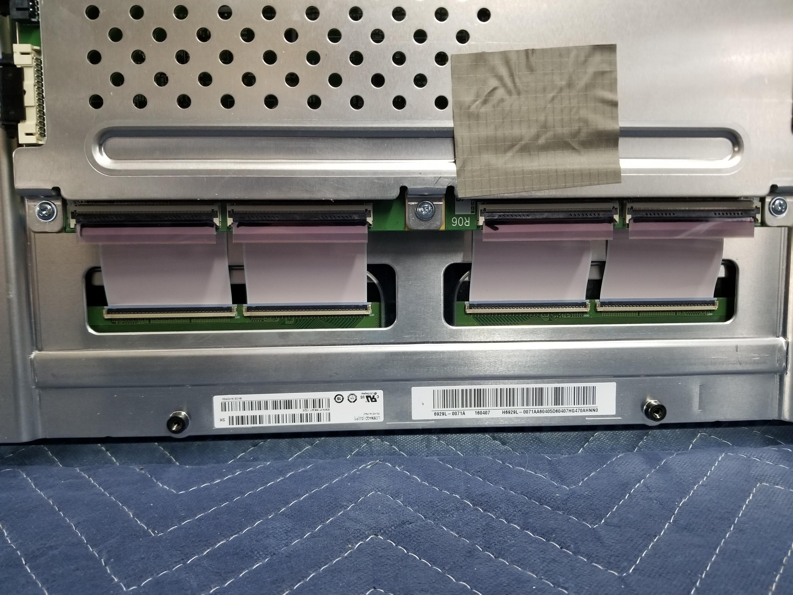

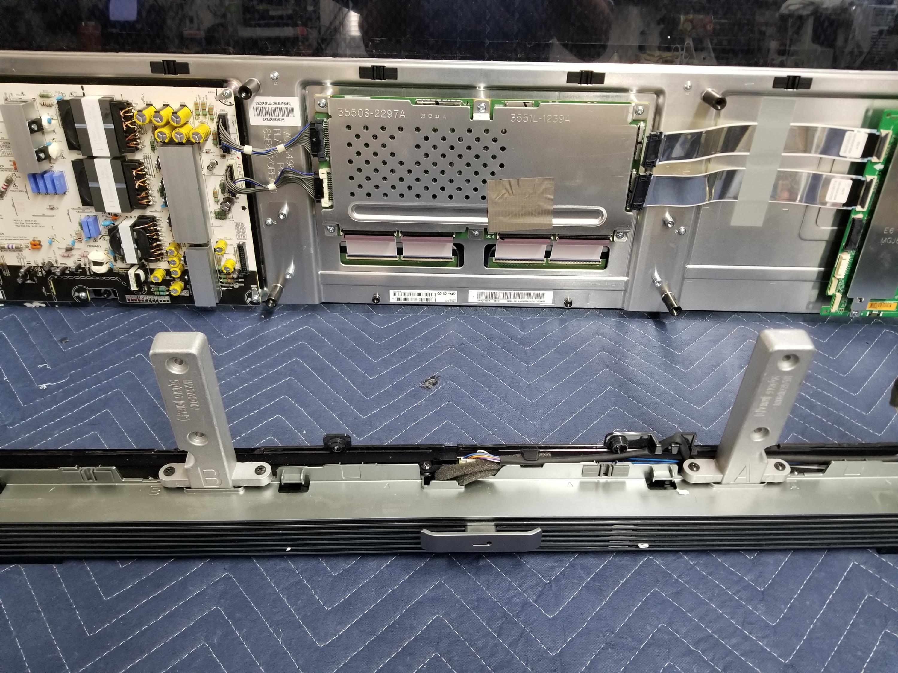

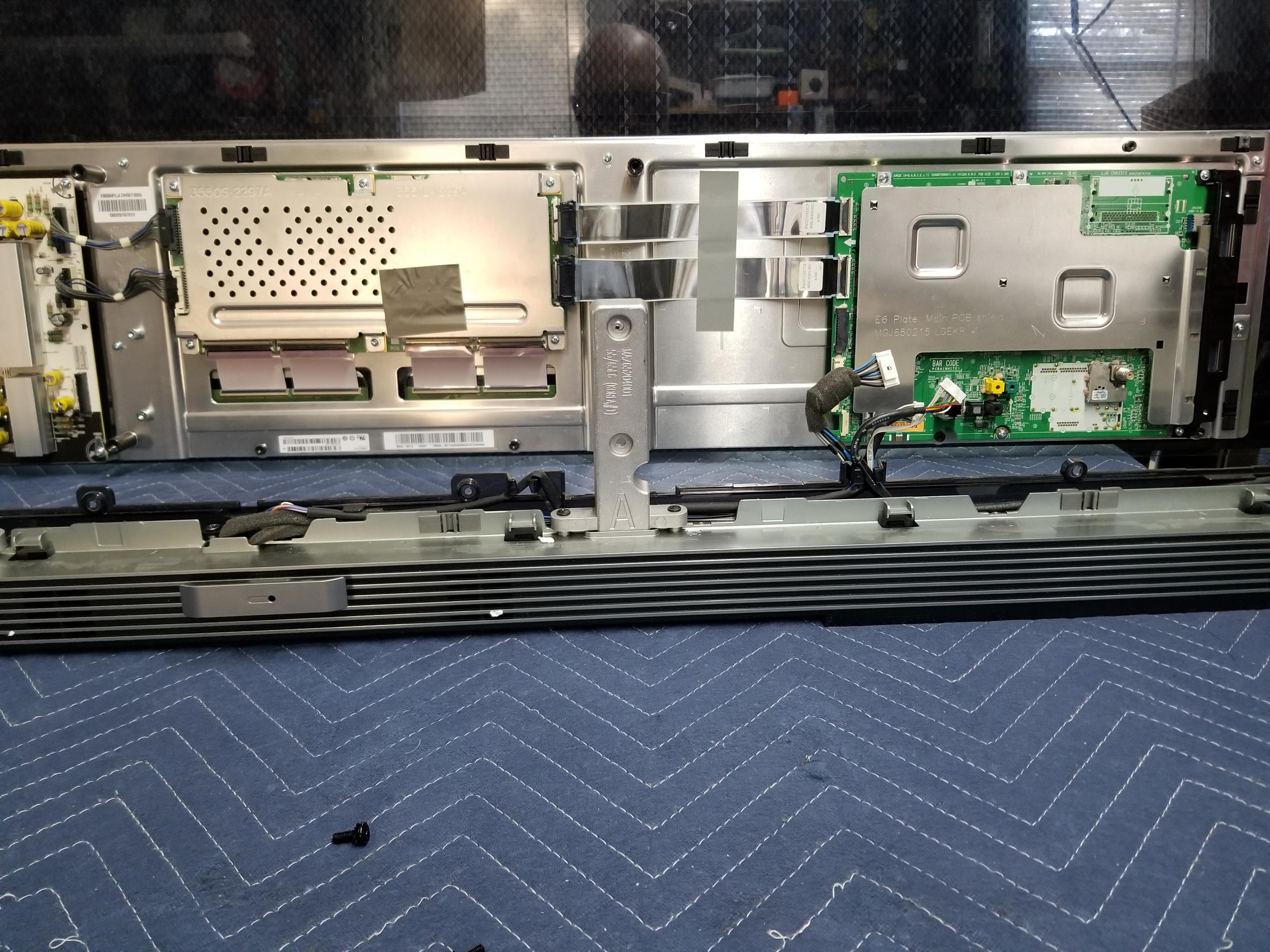

                  Re: Lg oled65e6p-u.buswljr
                  Attached are photos showing sound bar with switches disconnected from main board. Also a closeup of T-Con ribbons attached to panel circuitry.
                    #49
                    ok, thanks..
                    we do have T-CON issue its much like it firmware didn't start or dead,, so put every things back as original and hope we can have set as you got it it turn on.. so we reset the firmware of t-con too..
