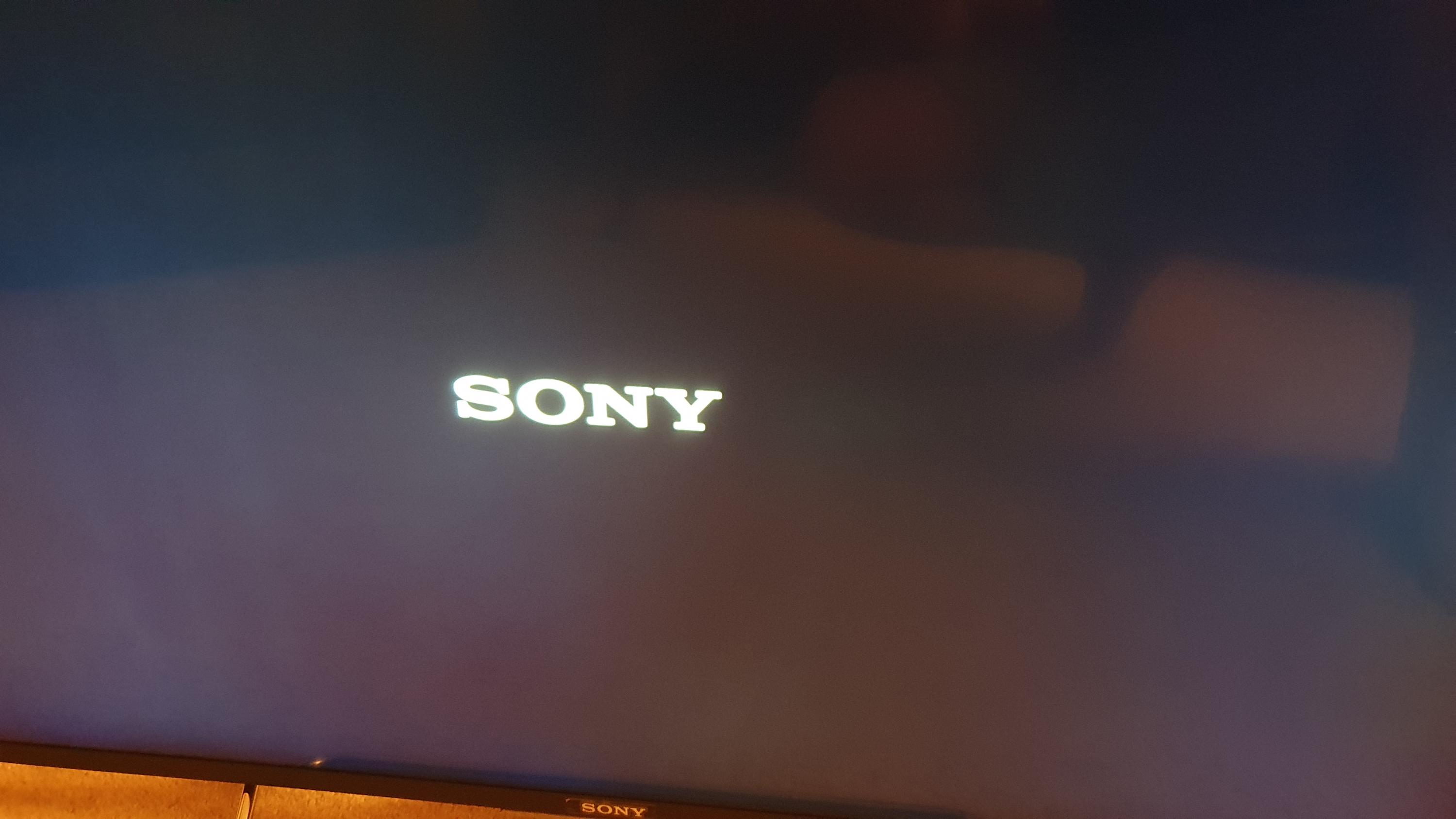

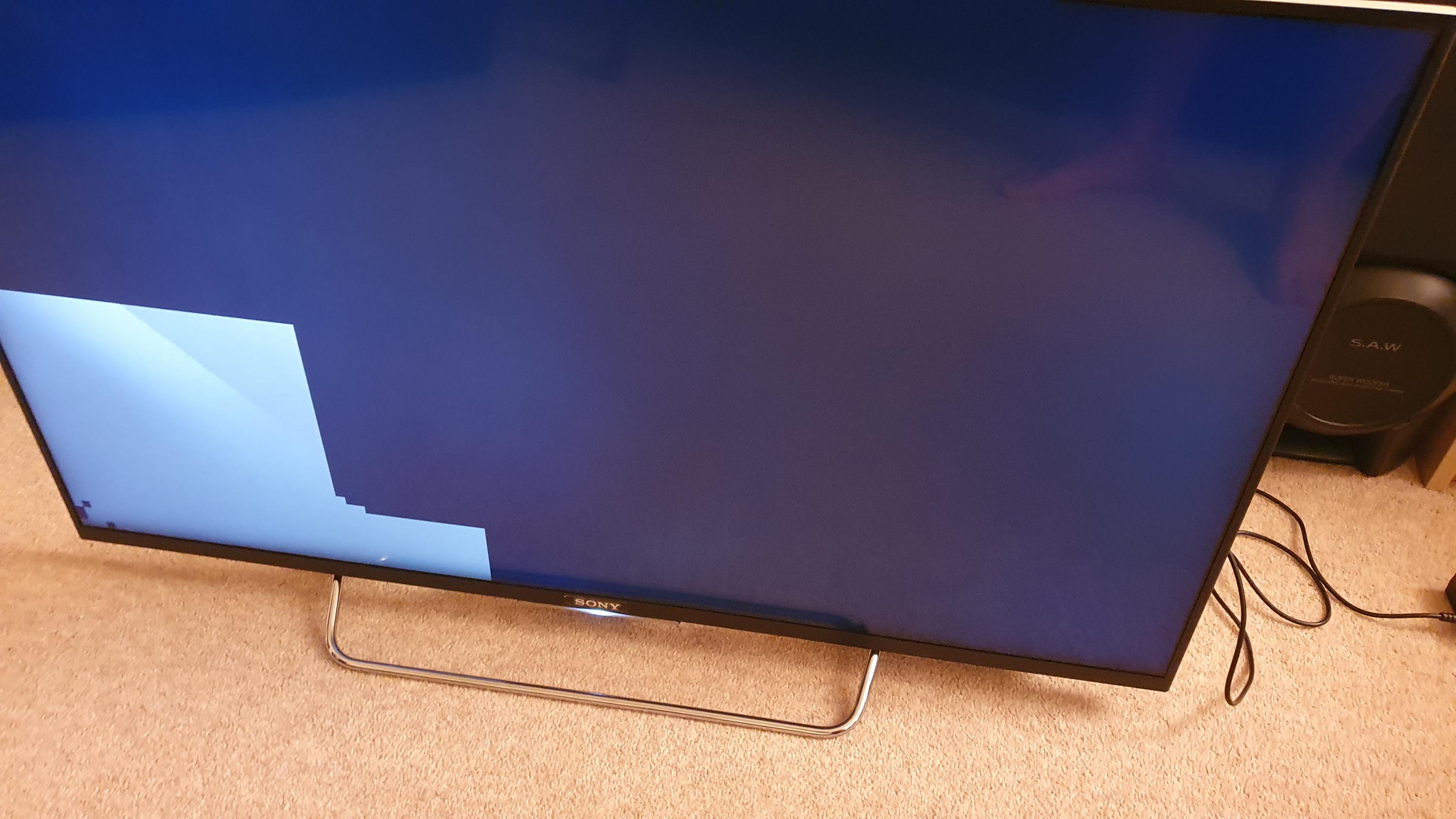

                                    • Dobsuk
                                      • May 2020
                                      • 127
                                      • England
                                      #78
                                      Re: SONY KDL 43w805c does not accept commands
                                      OK, Diah i coocked the board today and i could not see anything at the first try. Then i preformed hard reset. After that i saw the Sony logo twice and now it looks it stucked on the self diagnostic mode:
                                      Is that mean I've got some success or the main board is totaly fu.ked
