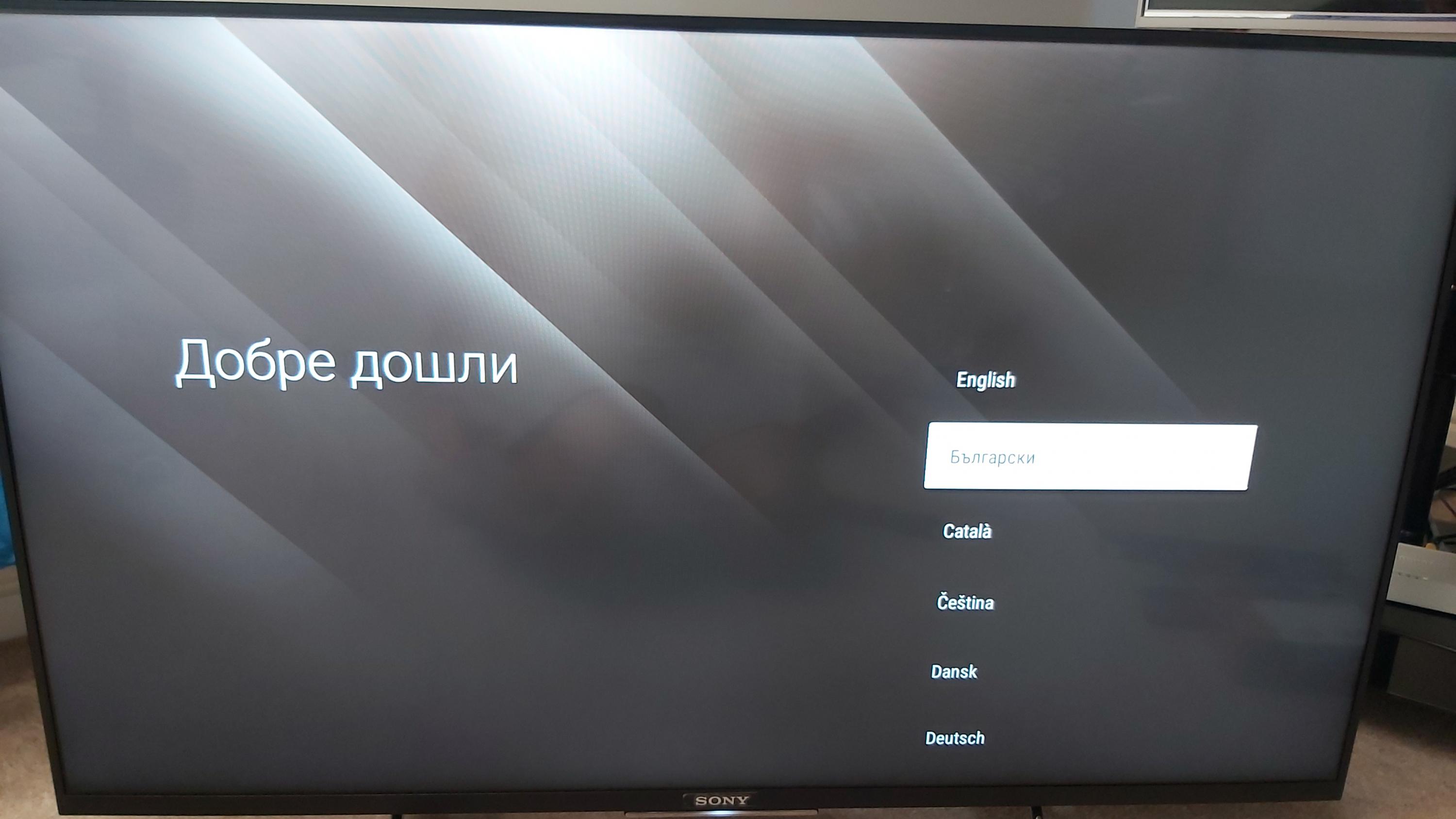

    Hi, guys. This TV stopped to accept commands and it does not matter if i am using my remote control or the buttons on the TV. It is accepting it sometimes but only once or something and then it is stopping again. Only the volume command is working even i cannot see the graphic scale every time. But the volume is working - i can adjust the volume without problems. I reset the TV few times but it is the same. Now it stuck on the Welcome Screen and i cannot move forrward. Do you think that the Main Board could be a problem?

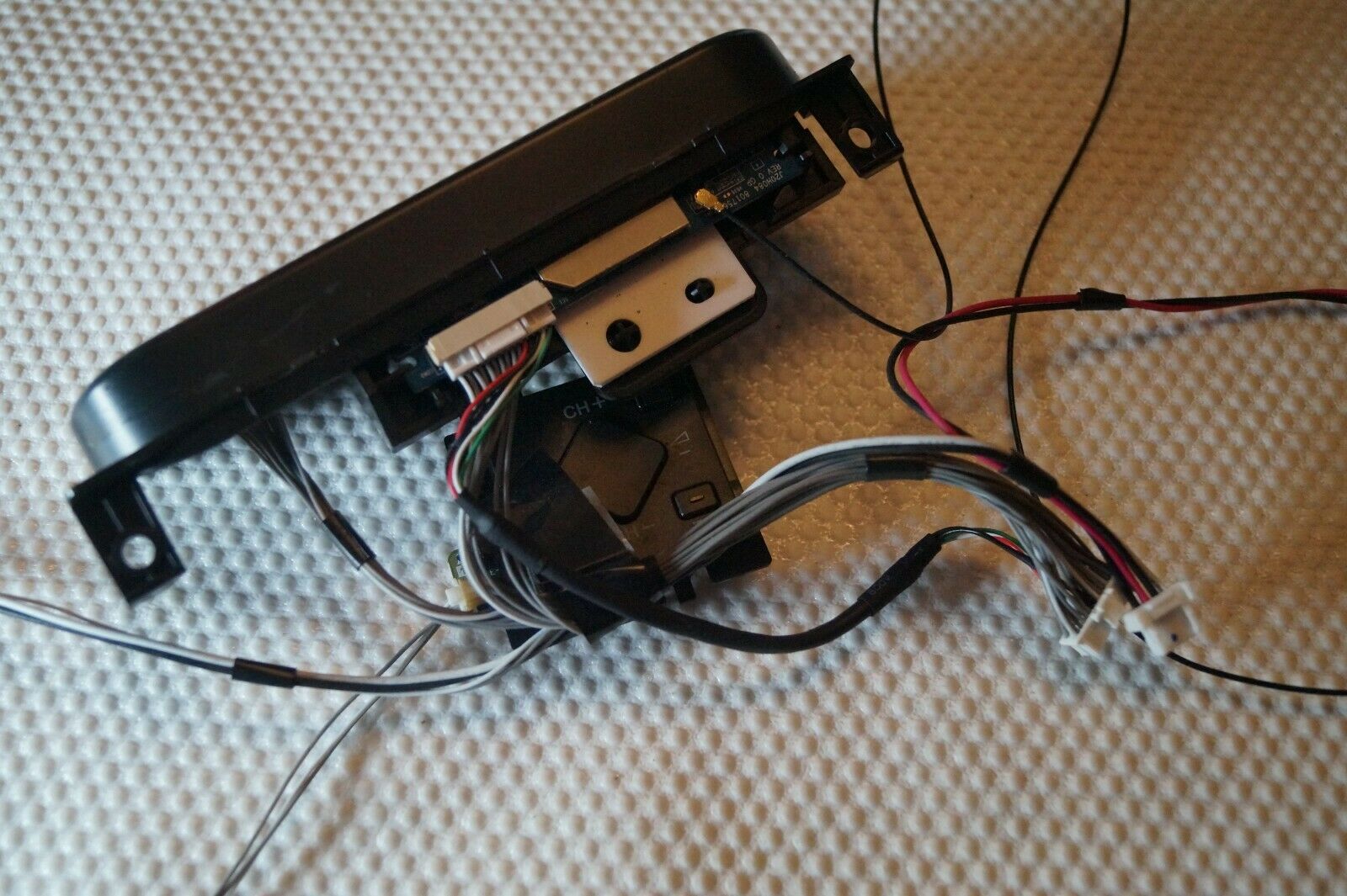

    If you disconnect the wifi connector does that help. I think it's connected to the IR sensor module.?
    IR SENSOR WIFI MODULE SIDE CONTROL BUTTONS FOR 43" SONY BRAVIA KDL-43W805C TV

        Re: SONY KDL 43w805c does not accept commands
        Yeah i tried to disconnect each part one by one but nothing
          its much firmware issue, as its android 5. there are update for years 2019 to this set- you need to try
          1- hard reset from power & volume - then plug it in wall socket..
          2- to by pass the first installation and to to apply update use air mouse with the tv. or any USB 2 mouse.

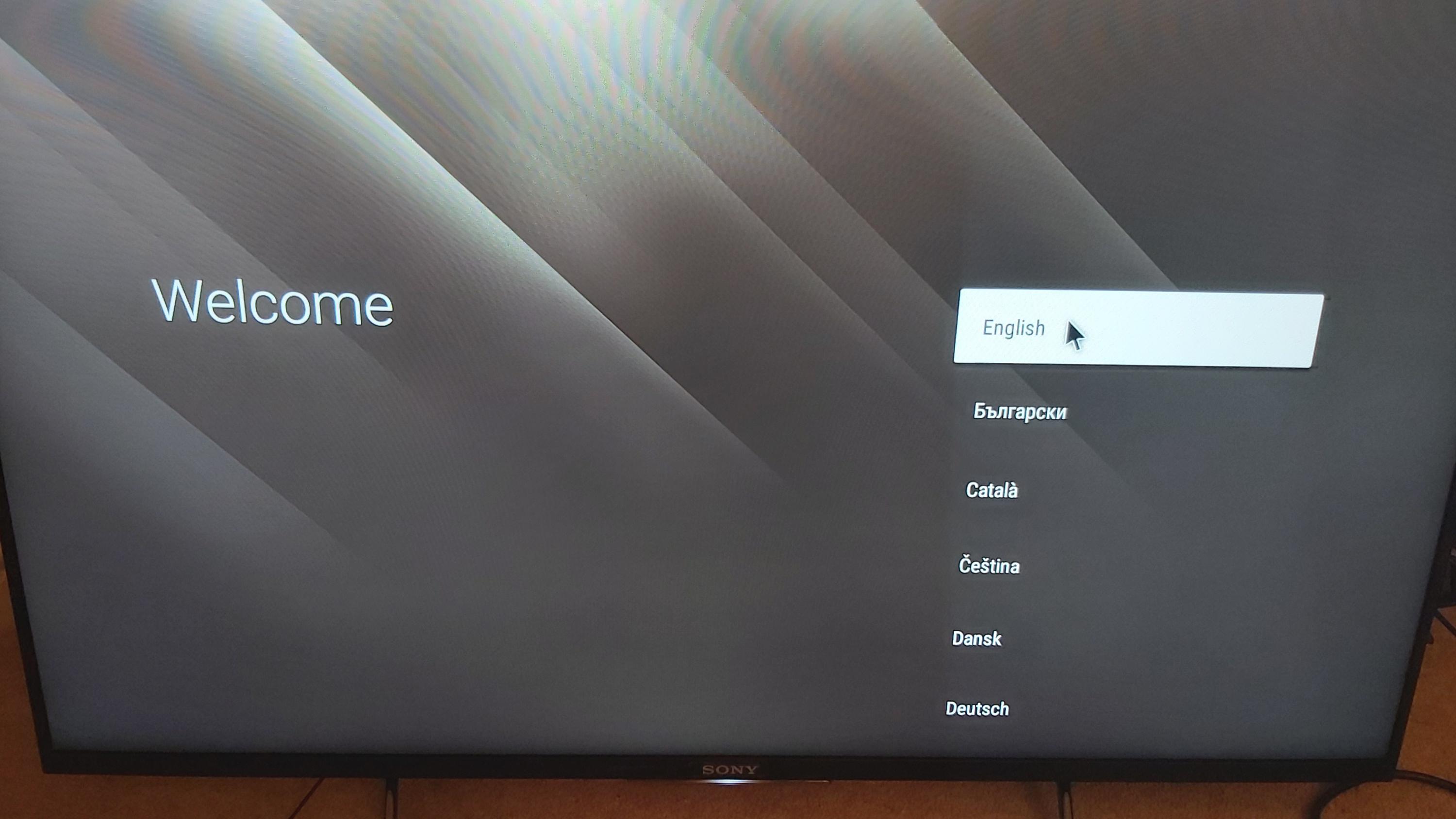

                      Yeah, but the point is it stuck on the welcome screen. So, i cannot use any APK to control it via the network until the tv is not connected to the network. And my problem is not that this volume graphic is missing... The problem is that it does not accept command neither from the remote control nor from the side control panel.
                      Just tried with the mouse now and nothing - i can see the mouse coursor and move it for 2-3 sec and then it is freezing for few sec and so on.... Is there how to reflash the TV with USB stick even it is with the latest firmware already?
                        f you did hard reset as press power and Volume - then plug set in AC and it show for you erase on screen .. then Air mouse will work.
                        put the last update firmware on USB stick not larger than 4GB formatted FAT 32... inset it in USB Port Ver 2. and do the procedure as you doing hard reset. you need to release the power & Volume - only when you see the usb led indicator start blinking. do it many time until you succeed. if this not help need to open the cover and show me the main boards to see which version its.

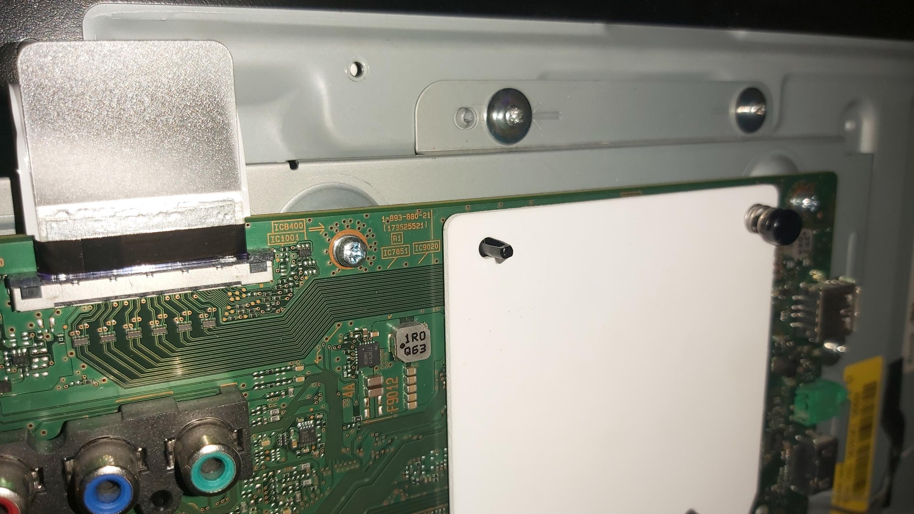

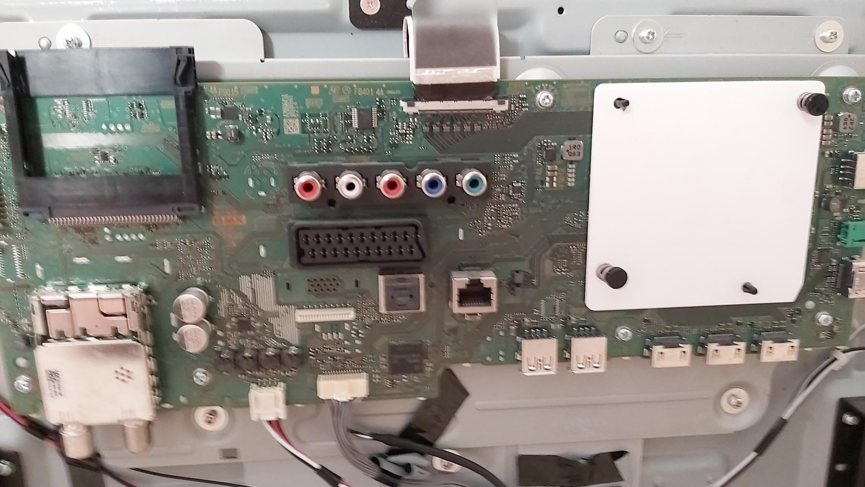

                          YEah it is working but for few seconds only... then it is freezing for few secs and so on.
                          Did that about 10 times but nothing - it is just looping in the boot logo and turn off again and on and off ..... May be it is not possible to reflash it with the same firmware version. Found some procedure for downgrade on Internet but cannot find older firmware for my TV.

                            did you use air mouse??
                                just to be sure you did hard reset correct..
                                1-while the set on plug it out from wall socket
                                2- plug out any cable / antena etc from the set ( keep it solo )
                                3- press on the tv side panel volume - & power and keep press then plug it in wall ac again.. the front LED will change to green... after it change to green release the keys you pressed before.
                                4- leave the set it will reset and it will show you first install but it will reset again and reboot..--- this mean after the set rebooted 2 time and the first install remain on screen the set finished reset.
                                you must use air mouse. because its plug & play with android

                                        Yeah, i found the same but it looks it does not work. And can see the comments under the post, seems nobody has success with that rollback
                                        I tried and using your advice, Diah
                                        It looks i need to looking to buy Main board
