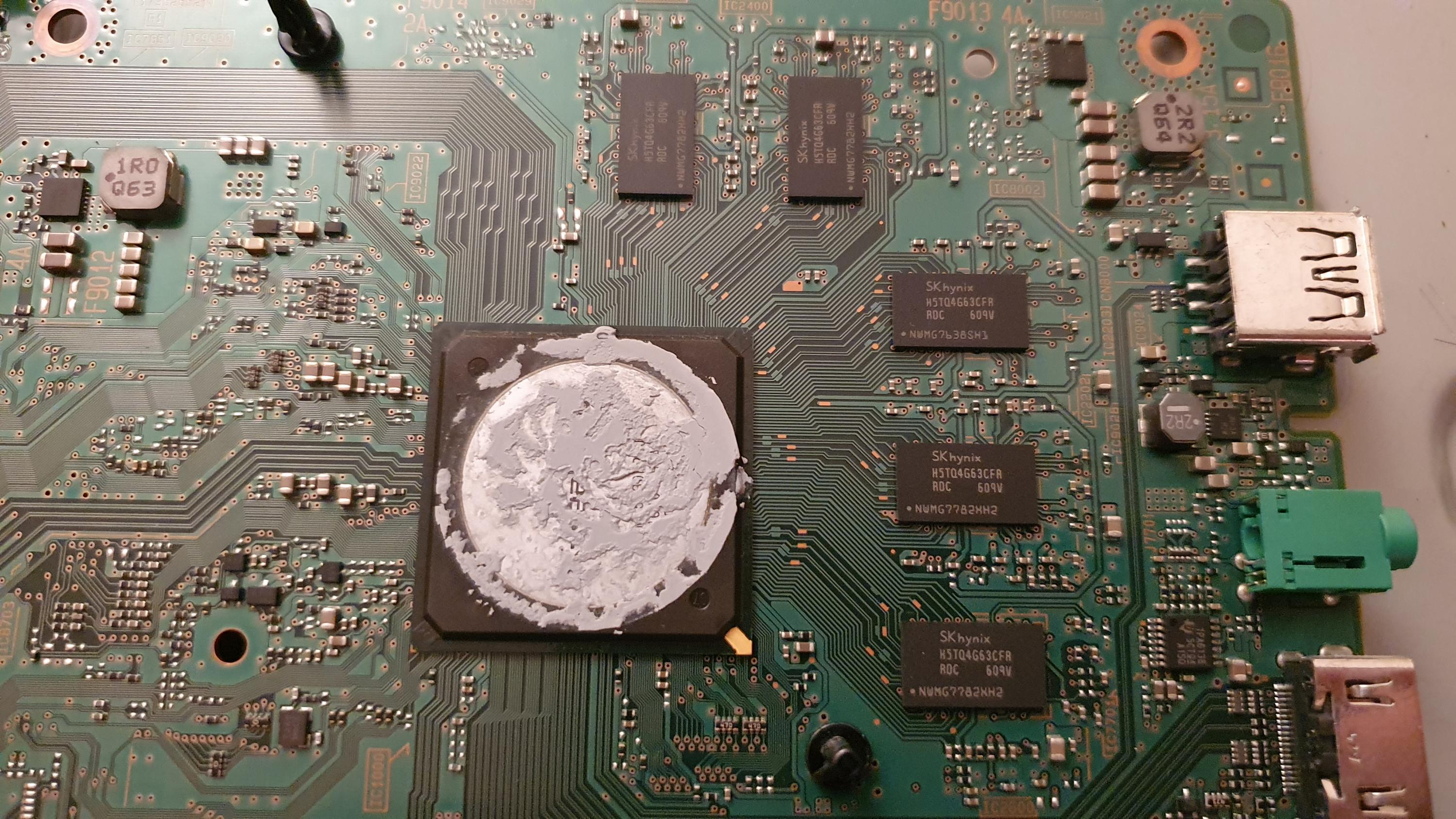

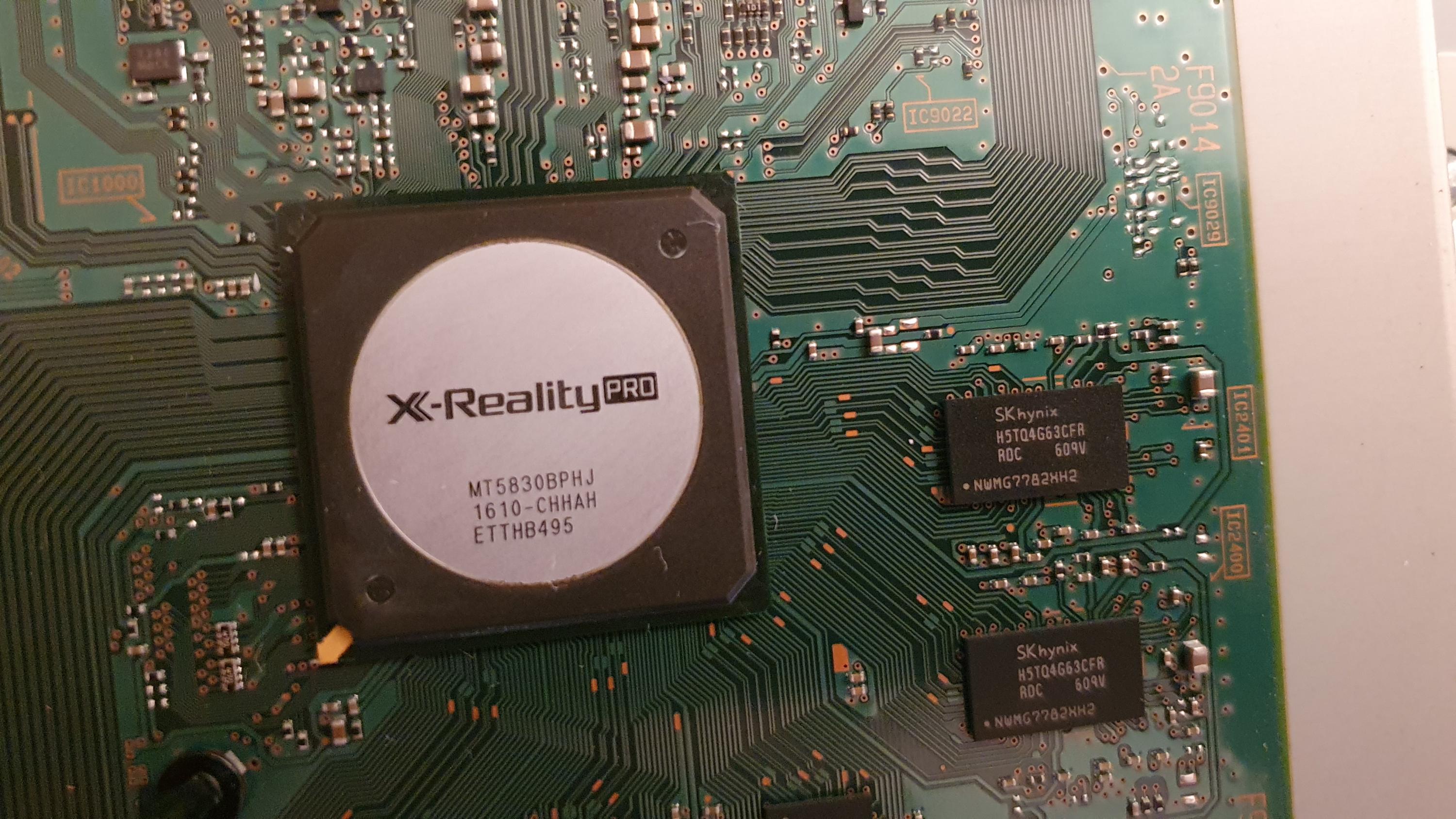

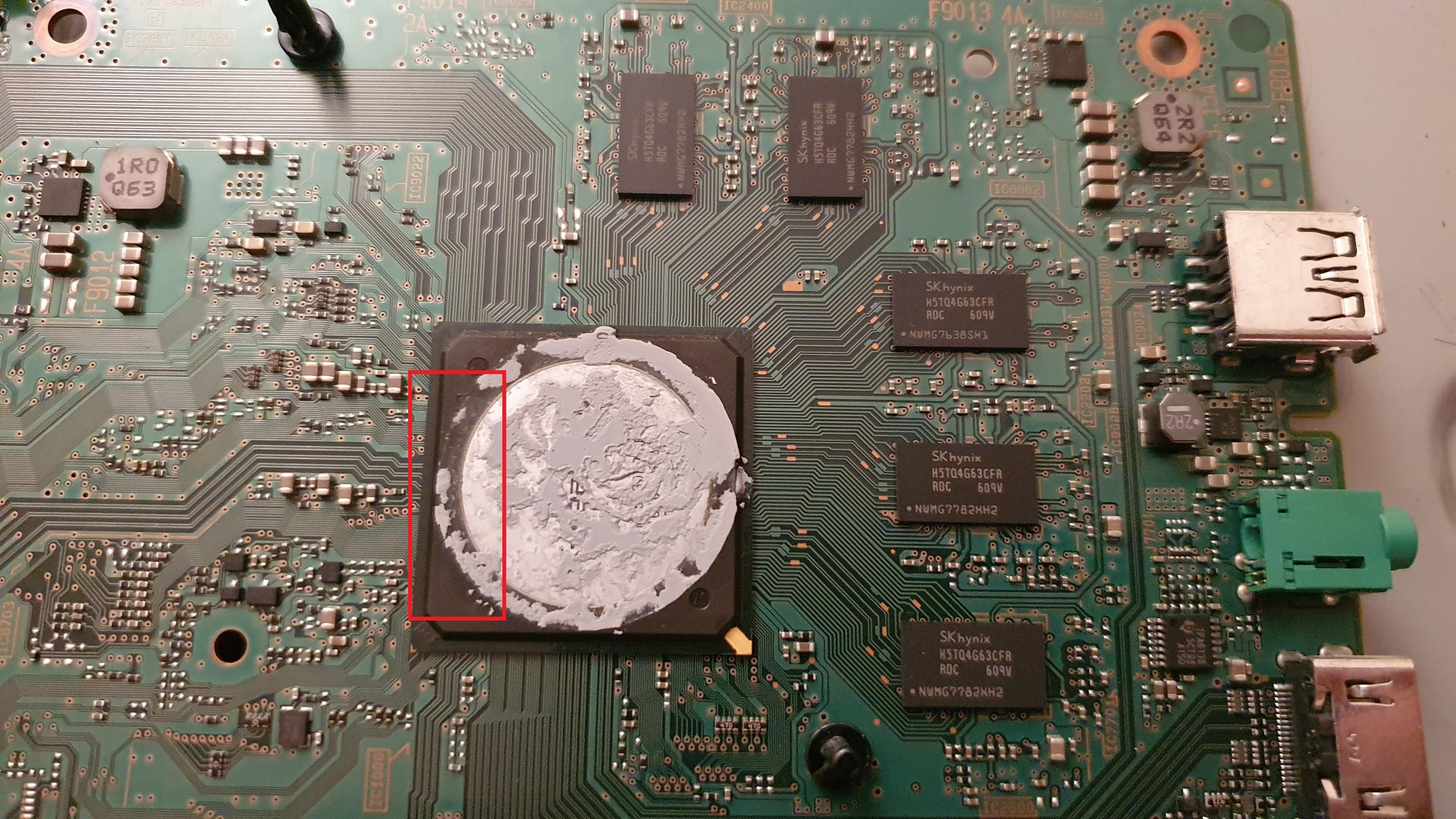

    take out the heat sink of the CPU and show what we have under it

          take out the heat sink... it need heating to repair the BGA ... by removing the heat sink we can tell from which side (PIN ) on ship are responsible

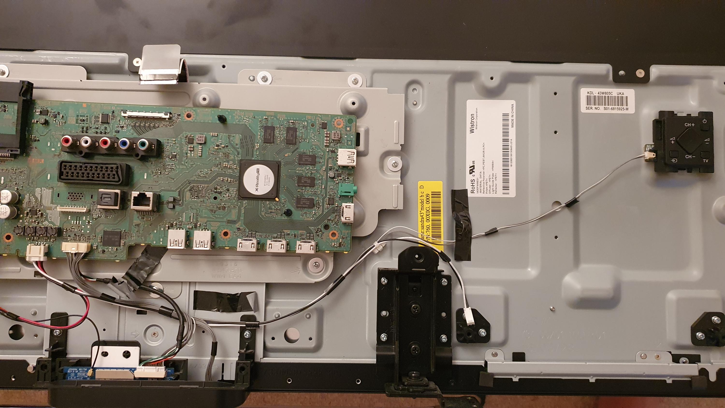

            one things more before we go for heating... your photo https://www.badcaps.net/forum/attach...5&d=1610728654
            the side panel and led indicator IR receiver socket... are they connected with ribbon flat cable to the middle of the mainboards?? if yes... did you inspect under loop the end silver pins of the cable if any short or broken ???? yours issue very strange

              This is it:
                No, they are not with ribbon cables:

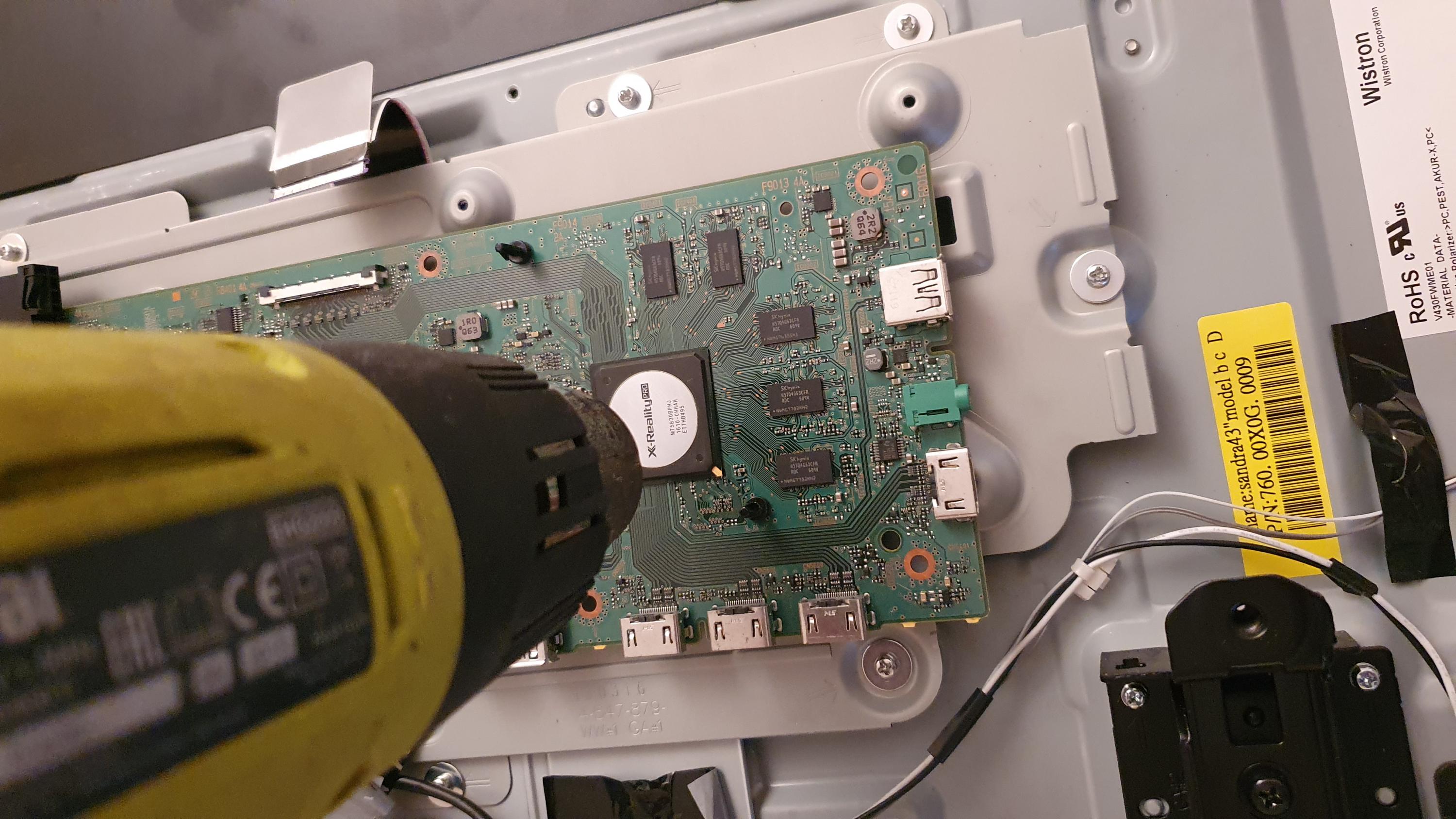

                  ok then heat this chip with hot air gun specially the middle to left side facing the plug which goes to side panel
                  when you heat it try dont move the boards ...leave it cool then put it back

                    I did in #27

                      For how long i need to heat it?

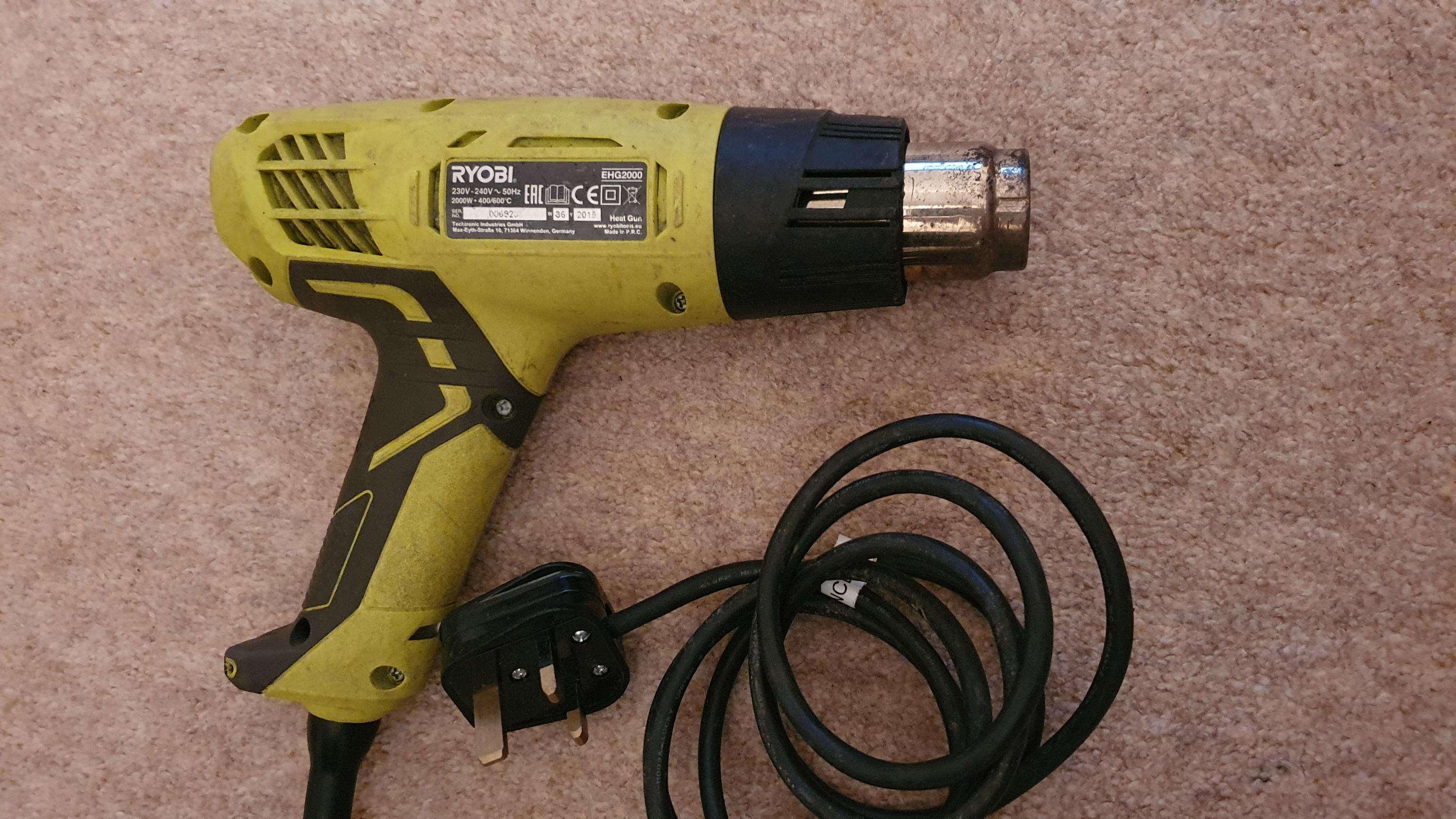

                          Errmm, that is the problem. I do not have proper electronic hot air gun. I've got one bigger and i am not sure if i can use it for that.
                          • Diah
                            • Feb 2013
                            • 6614
                            #33
                            Re: SONY KDL 43w805c does not accept commands
                            dont worry LOL.... do you mean the one used for Pipe sanitary?

                              Haha, no not for pipes I think i can use my one:

                                okay ... but you need first to cover all around the chip for example the glue plaster used by wall or car painting... to avoid the blow hot air fly one SMT parts near to the chip.
                                after that let this gun to the maximum heat ,,,let it run far from the board until it reach the high temperature if it was 350 degree, then face it to the chip area and calculate 6 second .. such 11 , 12, 13, 14, 15, 16 then leave it cool down
                                • Dobsuk
                                  • May 2020
                                  • 127
                                  • England
                                  #36
                                  Done! Now i need to find my thermal paste

                                    try it before you apply the paste

                                          Nope, it is absolutely the same Shall i heat it again?
