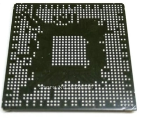

                                  Pictures of board are not clear , but the chip i mentioned is either the B G A type below the optical socket , or it may be under the white ceramic plate covering the CPU .

                                    MT5830BPHJ are the brain of this set it control all function.. include the IR.. if one BGA POINT get OPEN this function will be error.. IR are function and here we have the case. who knows which POINT.. but we still can guess the side of the chip where the OPEN POINT are.
                                    actually if the OP had Air Mouse the procedure will be more easy after he pass first installation then activate the developer Option & USB Debug so we can with adb proof the IR function.

                                      Main CPU could potentially have poor ball connection issue , but it's just not something i have had on this specific model .

                                        OP did many time hard reset.. it mean the NAND being erase and the Firmware again extracted and wrote back to the active partition of NAND. if there corrupted sector at chip for example it will not pass the erase. and if some one think the firmware corrupted , the firmware cashed on protected level. no access to any app or user to change or delete... beside it extracted correct after erase. the only things left the CPU.
