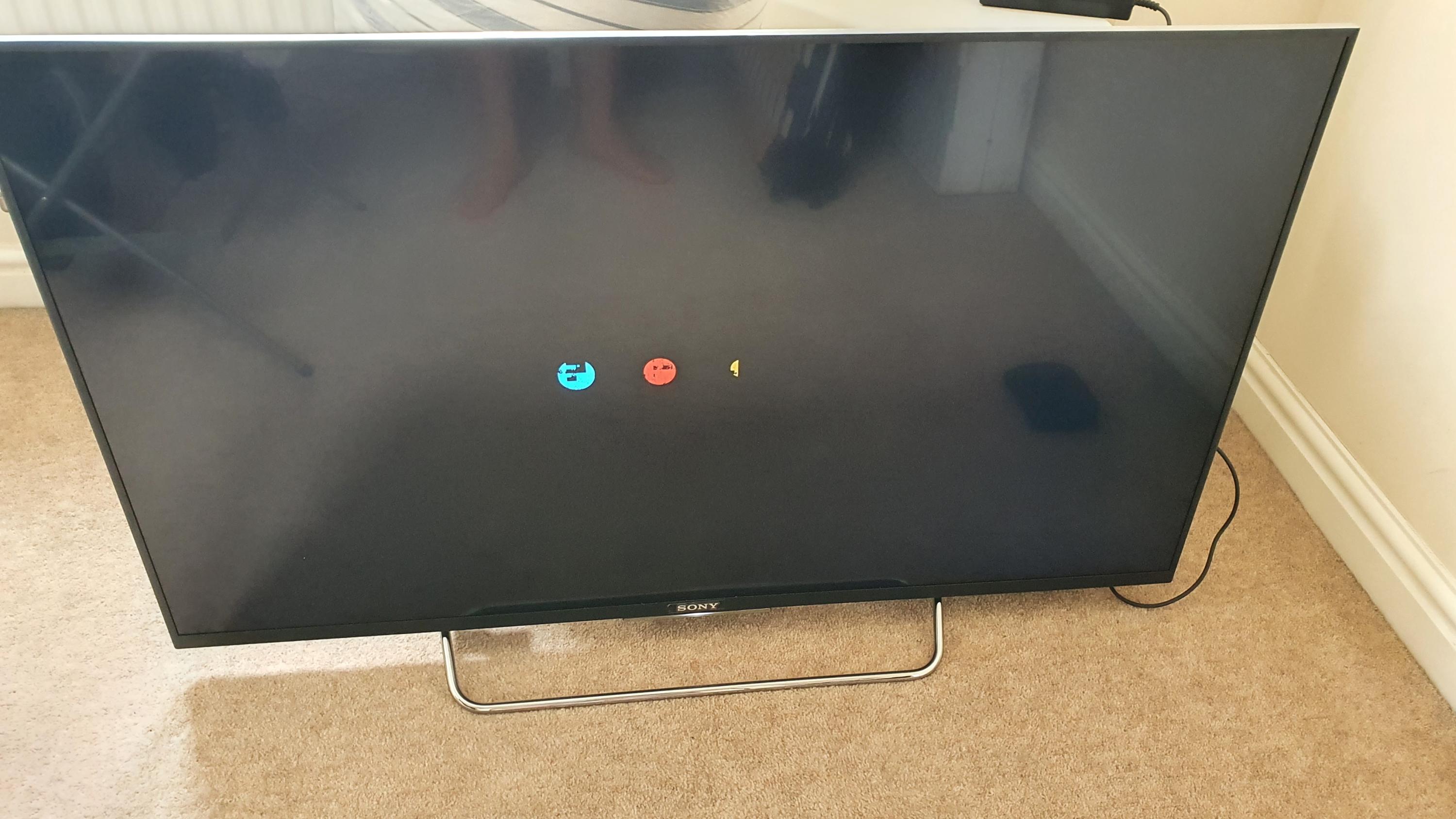

    Nope...neither with the back panel buttons. Only can switch it on with the RC
    now Firmware issue.. try hard reset again... try mouse.. look after the update if you can force it to accepted again

      Re: SONY KDL 43w805c does not accept commands
      But i can hear the sound now from the welcome screen. It means the tv is reset....

                Nothing happen with this. It does not register any error....still looping in that self test menu. I tried to reset it few times with and without the LVDS cable.

                        #91
                        So what is it doing now, looping test patterns?
                        • Dobsuk
                          • May 2020
                          • 127
                          • England
                          #92
                          Yes.... I tried everything and still trying to do.something - restart, reset etc....

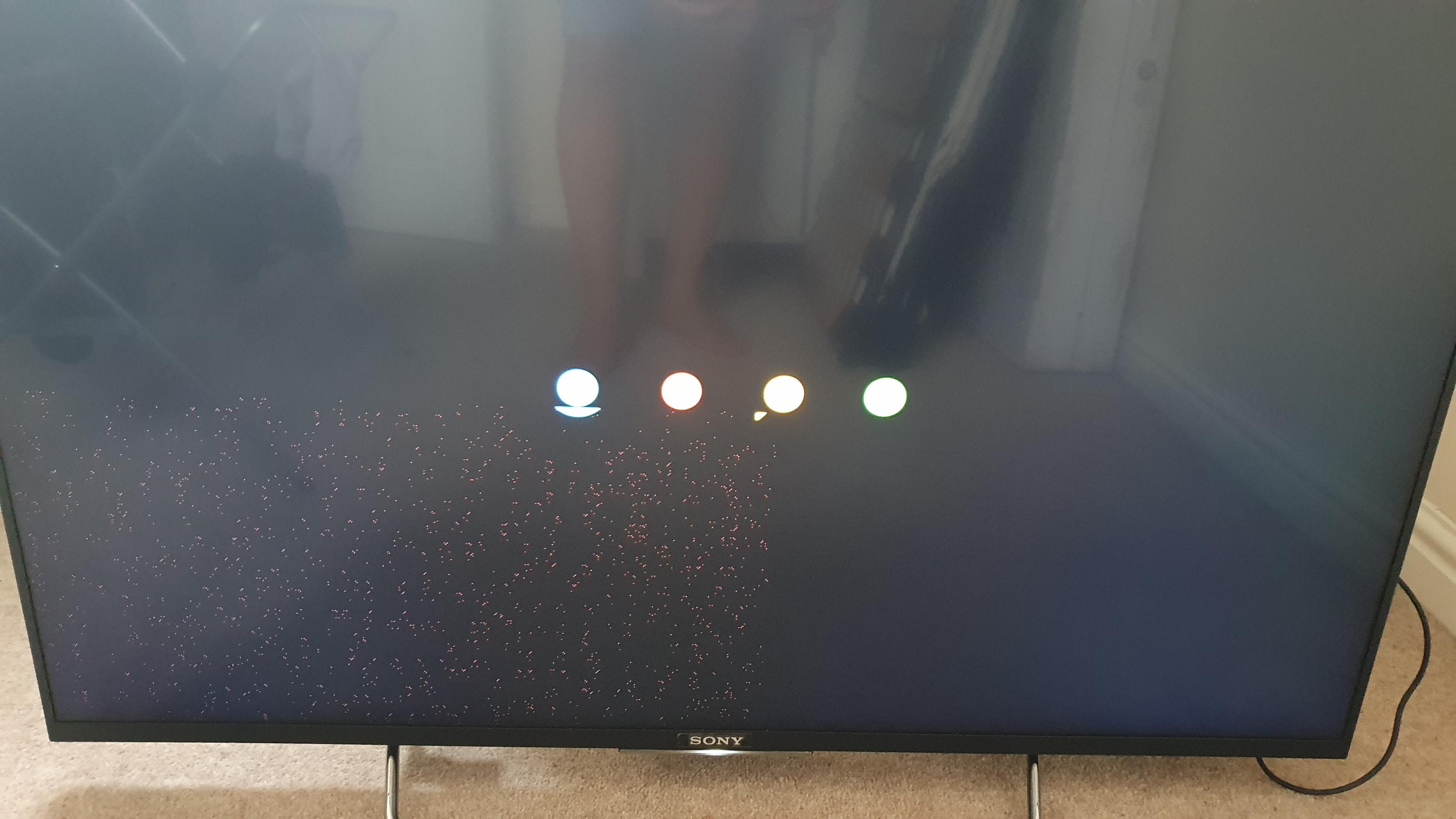

                                        #99
                                        Ok i did check with the ait mouse but could not see any changes pressing all F keys or the others. Restart TV few times but nothing. Then disconnected the TCON cable so to force some errors or something and now the TV stuck on this screen:
                                        And now i do not dare to touch anything.....
