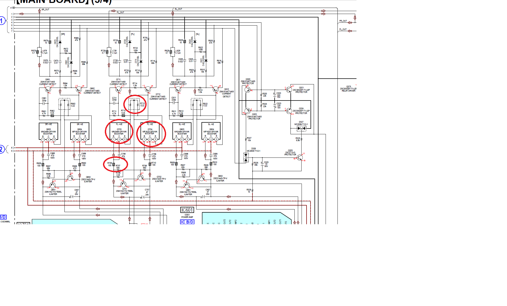

    New to Audio equipment. Received this 7.2 Surround Sound system - had a blown channel and fixed that (0.22 ohm resistor, 2 transistors, and 1 100 ohm replaced)
    All channels now work. However, when I raise the volume with knob or remote, it doesn't work smoothly - you can heard distortion, and some speakers don't seem to work at max or somewhere in between..
    First thought was the actual audio switch - but then Remote volume control shouldn't have this problem, but it does.
    Second thought was the ribbon cable from front display to control board (V-Flex, 29 pin Cable) was pitched in the process and repaired it for testing. Though I can't seem to find a replacement for it anywhere.
    Any thoughts what to look for here?

                              First finding is that the subwoofer channel does not have the distortion - volume adjusts beautifully
                              Actually, all output speakers seem to work well, except the "FRONT A" Left and the headphone plug in the front of the unit (which makes sense, as Channel FL is the one the headphones are pulled from.) FL is the channel that was blown when I got the unit. So I don't know if I got bad parts or if there are more bad components on that channel.
                              Seems (in addition to distortion) as I go from low volume to high the headphones shift to right only and left seems to be shutting off.
                              Again for that channel, I had to replace Q703, Q704, R713, and R709 (see attached)

                                That tells you the problem is somewhere in the PA. Nice thing is that you can compare the left channel to the right channel and go through each amplifying stage. The subwoofer output bypasses the PA stage totally, which indicates there is still a problem of some sort in the PA.
                                • jason123
                                  • Oct 2015
                                  • 1154
                                  Re: Sony STR-DN1030 Distorted audio when Volume adjusted
                                  There are only slight impedance differences between the channels. Only thing i can think of the large transistors i bought on eBay, though listed as new, the leads were tinned. Guess i can replace those again?

                                    One option would be to swap the new parts between the L and R channels.
                                    • jason123
                                      • Oct 2015
                                      • 1154
                                      Thanks.. certainly an option - these boards are so cheaply made though, it's very easy to lift a pad and I'm trying to avoid that if I can.

                                        The only other thing I can think of is that the replacement didn’t have the exact part number. For example: A 2SA1164 has three different versions in which the gain rating is totally different. So a 2SA1164-GR has like three times the gain than a 2SA1164-O.
