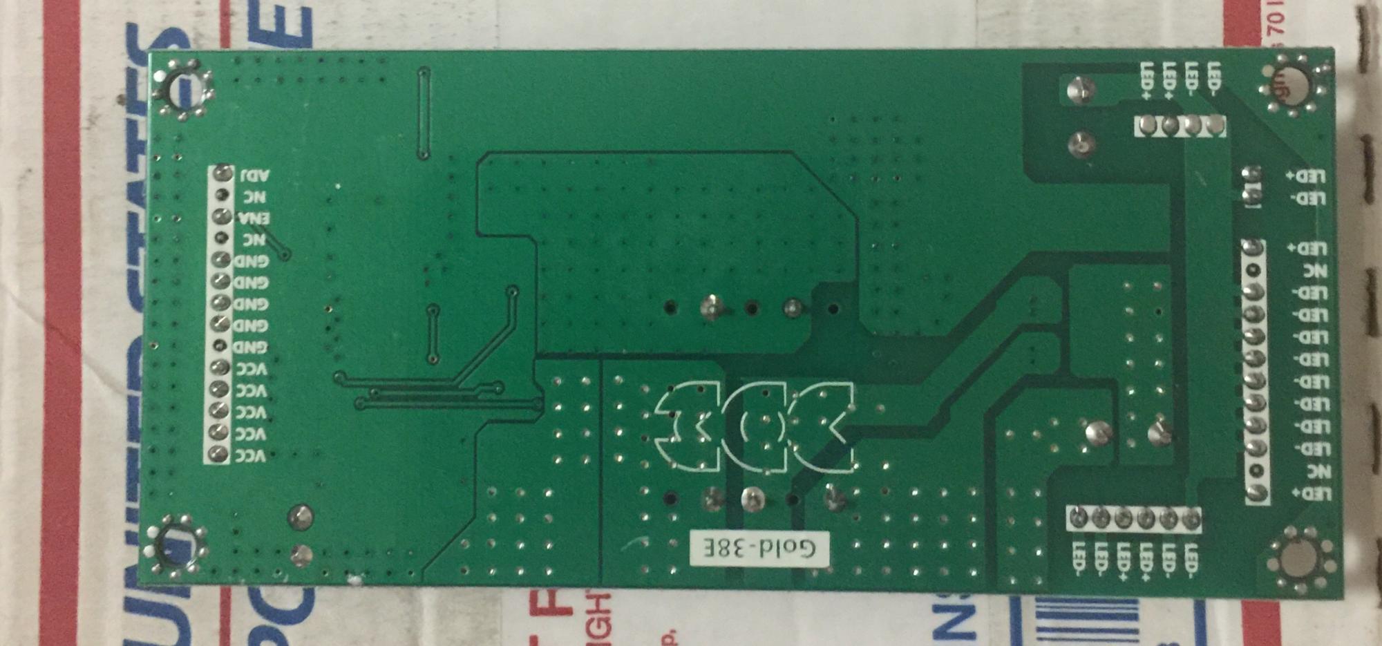

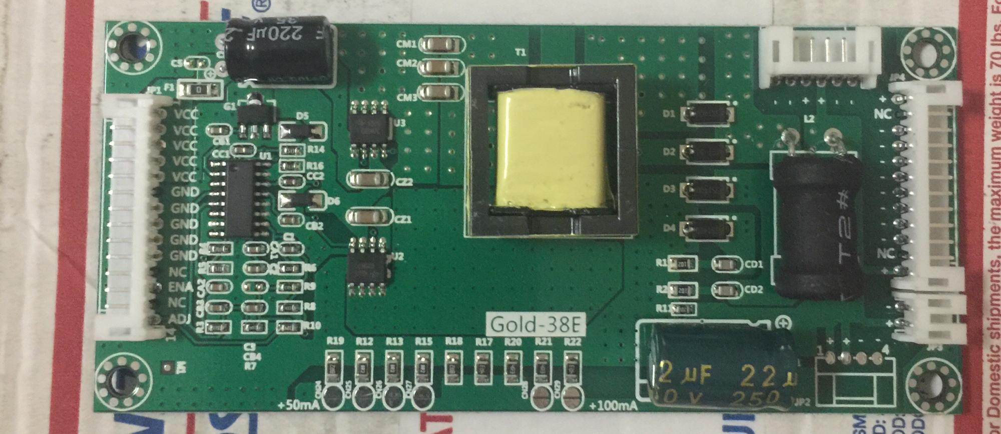

                          My wife gave me this gift... Do you guys think it could work?
                            Re: Sound and picture but no backlight
                            Recovery from this surgery is torture...
                              I can almost walk ok... I'll try to get back on this tv tomorrow. Gonna check the power levels you requested. Btw how about that board my wife gave me hoping it could work? Is it crap?
