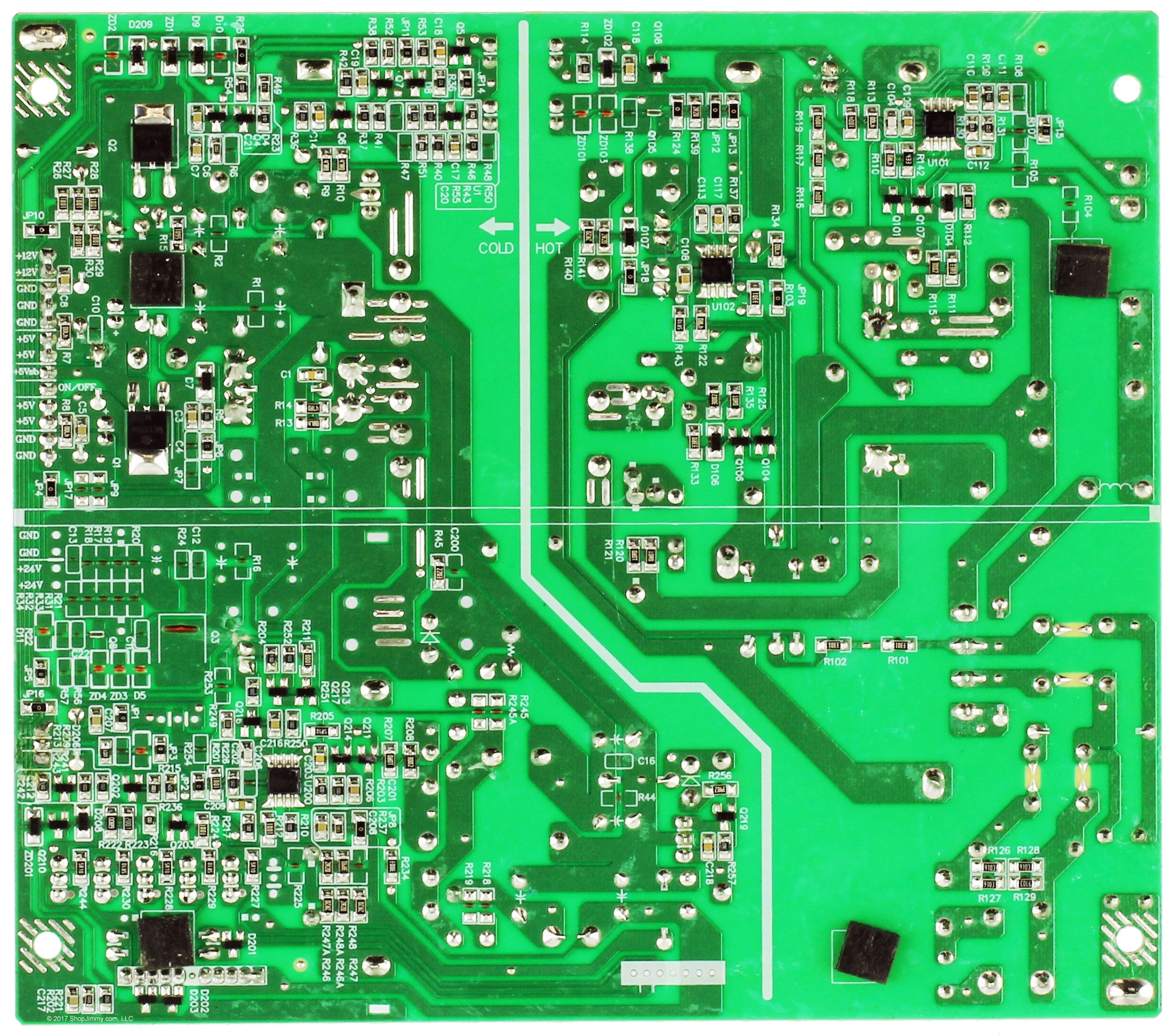

      Post #7 are low res.
      So here are High res pix provided by shopjimmy: RCA RE46HQ1004 (RS126S-3T01) Power Supply for LED46C45RQ.
      Notes: SJ pix shows black bumpers that block out the traces, OP provided the pix in post 358 with bumper removed around the LED connector as I requested.

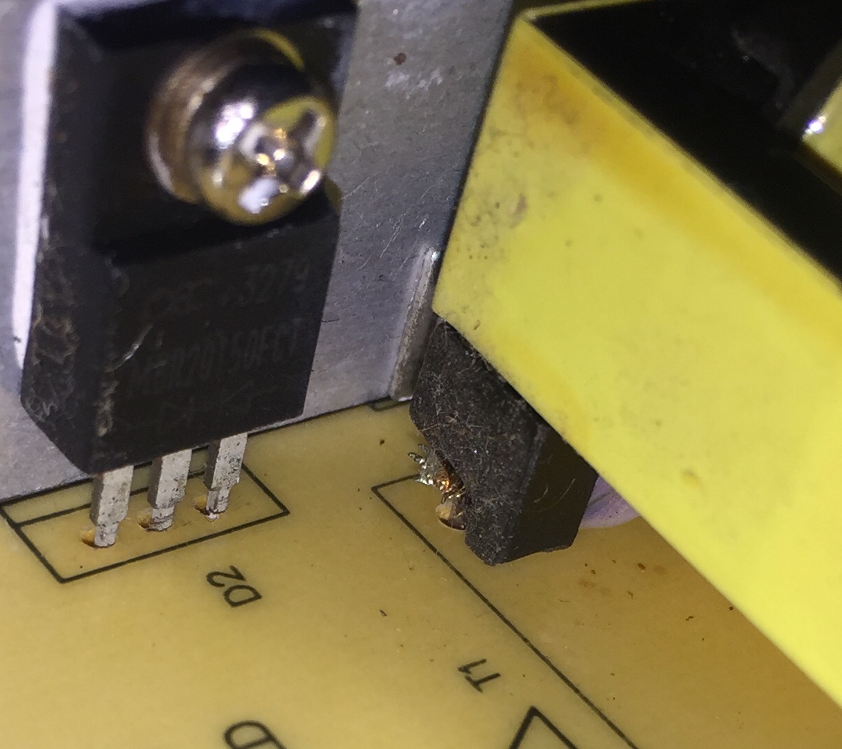

                  I took a chance and replaced EC201 and EC202 with brand new caps and nothing changed. Just in case I wrote down the Part#'s for Q220 is B649A, D6 is BYC10, Q215 is 18n20 and D200 is MBR10200F, D2 is MBR20150F.
                  While looking at D2 I noticed some kind of solder splatter on T1's cold side. Here's the pic. It might be nothing but just want to show you what I saw.

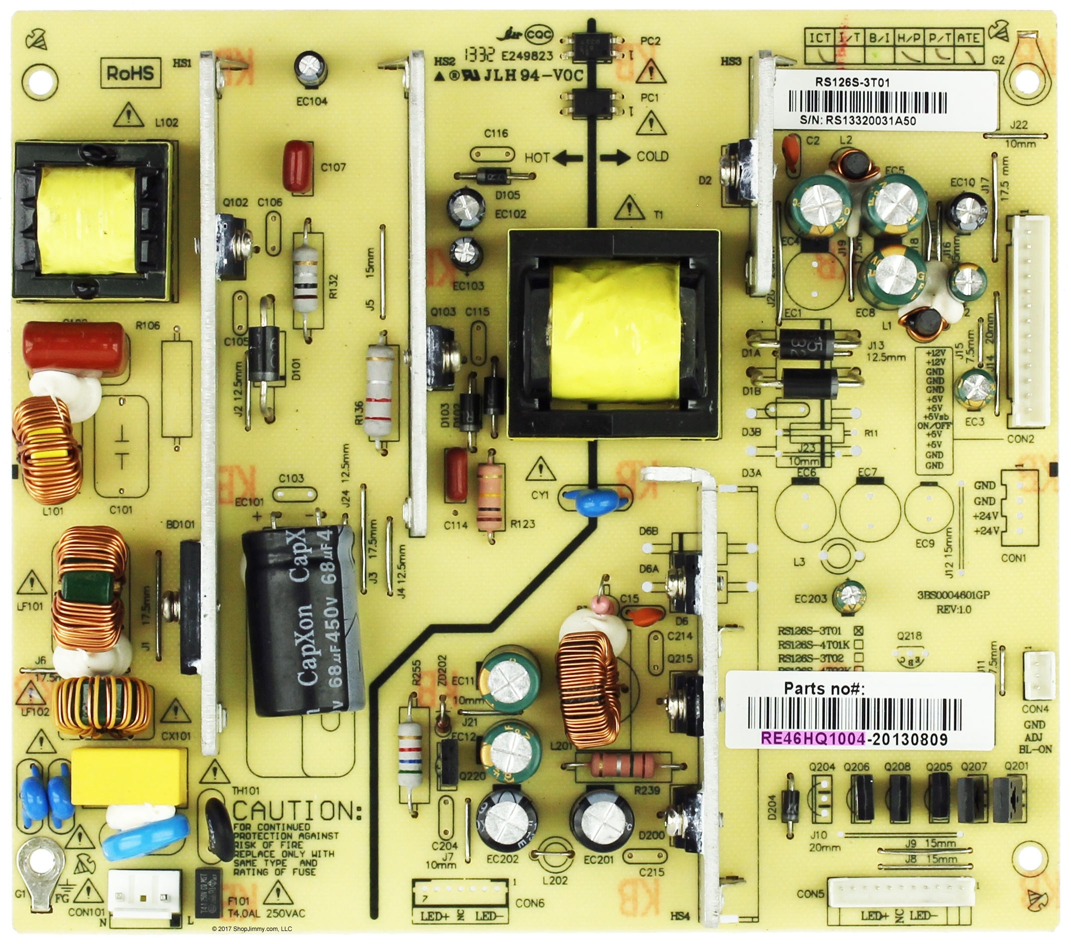

                      Q103, U102, T1 are part of the always on SMPS.
                      D2 is the rectifier for the always on 12V which is then fed to switched MOSFET Q2 to provide switched 12V output at the connector CON2 when PS-ON is present.
                      D1A//D1B are rectifier for the always on 5VSTBY, this 5v is fed to MOSFET Q1 to provide switched 5V output at the connector CON2 when PS-ON is present.
                      D6 is the rectifier for the always on 60V (filtered by EC11, 12) that is fed to the Boost converter (L201, Q215, D200, U200, EC201/202) that will produce about 100VDC when BL-ON is present.
                      L102, Q102, U101, D101 are for the PFC Booster Voltage which is also turns on when PS-ON is present.
                      At this point it looks like the Boost Voltage is not high enough, the LED string with the bypass resistor should have lit up for seconds.
                      So you should remove the D200 and check it in diode mode and in resistance mode in both directions but before doing that I need you to remove that 3-pin connector CON4, then put black probe on the chassis, red probe on any one of the LED + pin, with the TV turned off you should see about 60V, then turn on the TV and see how high the Voltage jumps up to.
