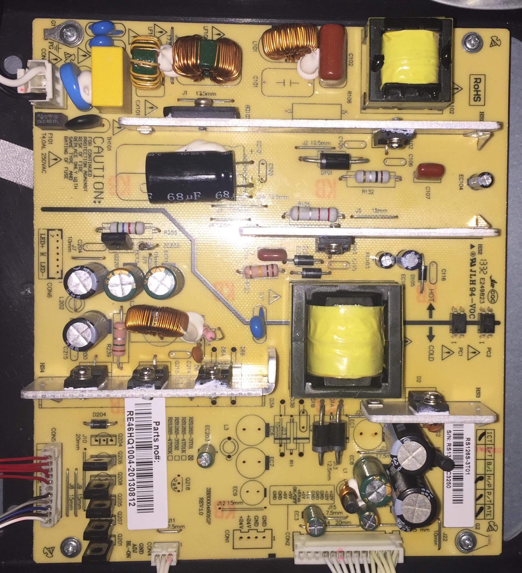

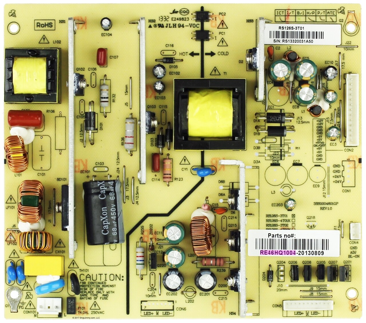

    Can you post well focused pictures of your power supply. What is the power supply part number?
    You have two mosfets and two diodes close to the led connector socket. Have you checked them?

      Re: Sound and picture but no backlight
      Here you go...
        What is the voltage at BL_ON (CON4) and also between the two legs of EC101 (68uF capacitor)when in and then out of standby. What is the voltage printed on that capacitor.

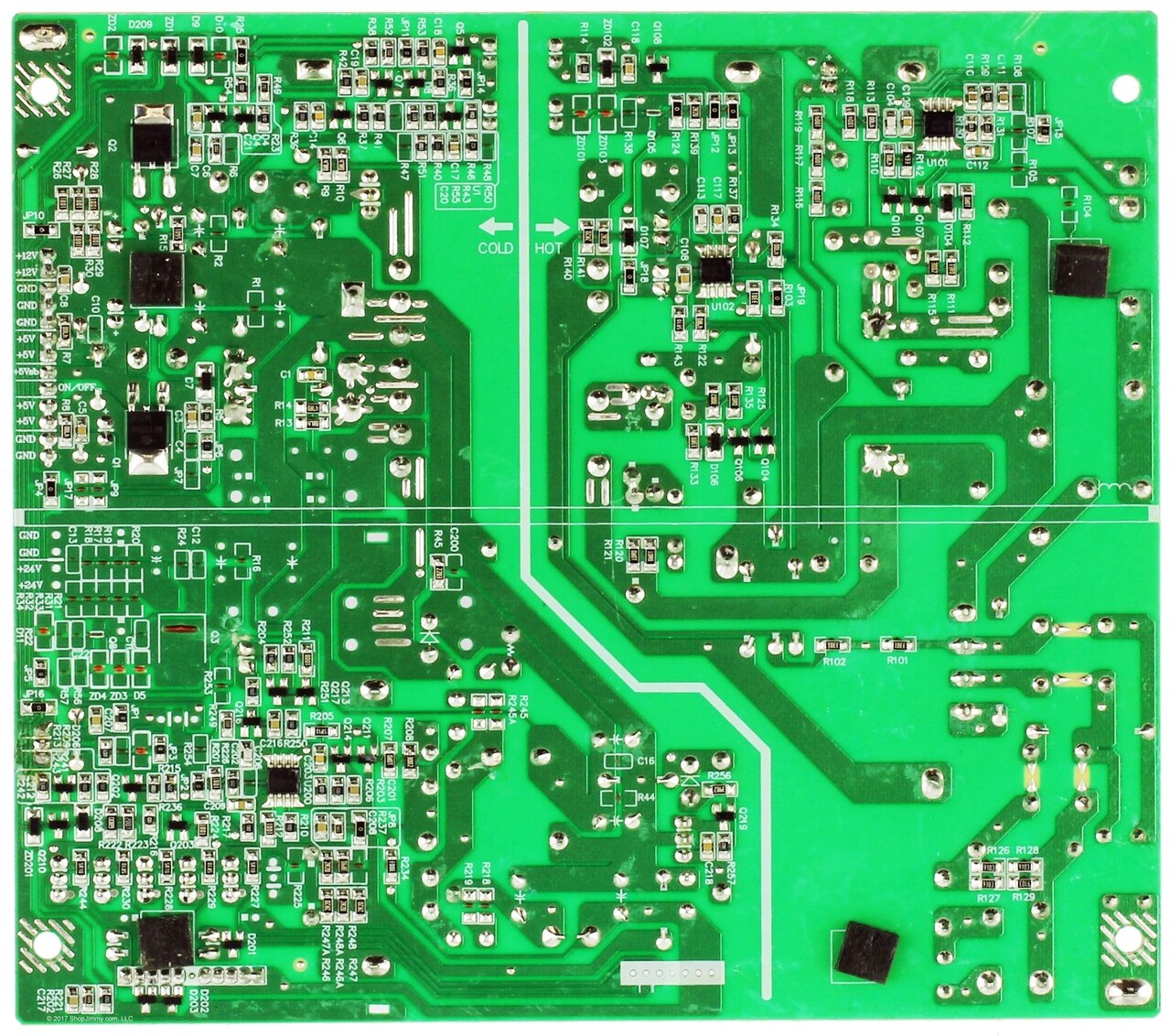

        Can you post a photo of the underside of the power supply.

              Also what is the part number written on U200 on the underside of the board.

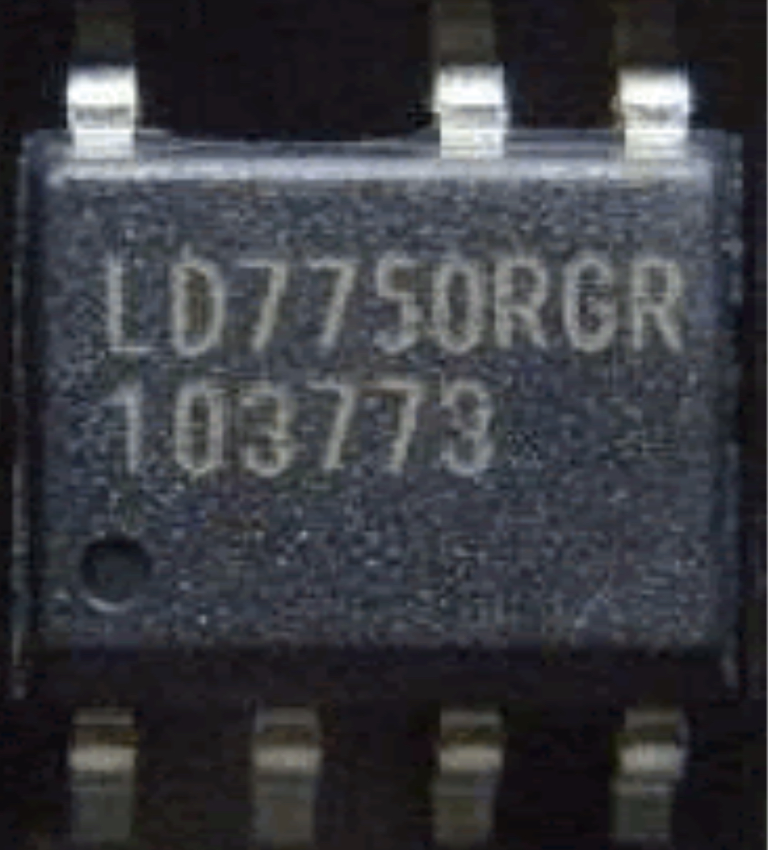

                      Trying to read that chip...
                      • JCdes
                        • Feb 2013
                        • 91
                        Ok LD7750RGR

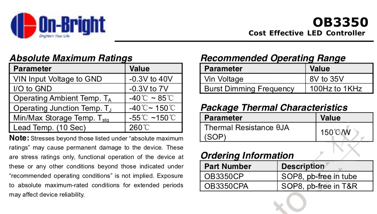

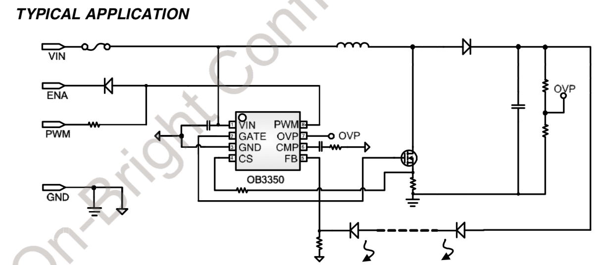

                                    U200 is marked e19359 0B3350CP
                                    • JCdes
                                      • Feb 2013
                                      • 91
                                      That's the led driver...
                                      • JCdes
                                        • Feb 2013
                                        • 91
                                        Here's what I found...
