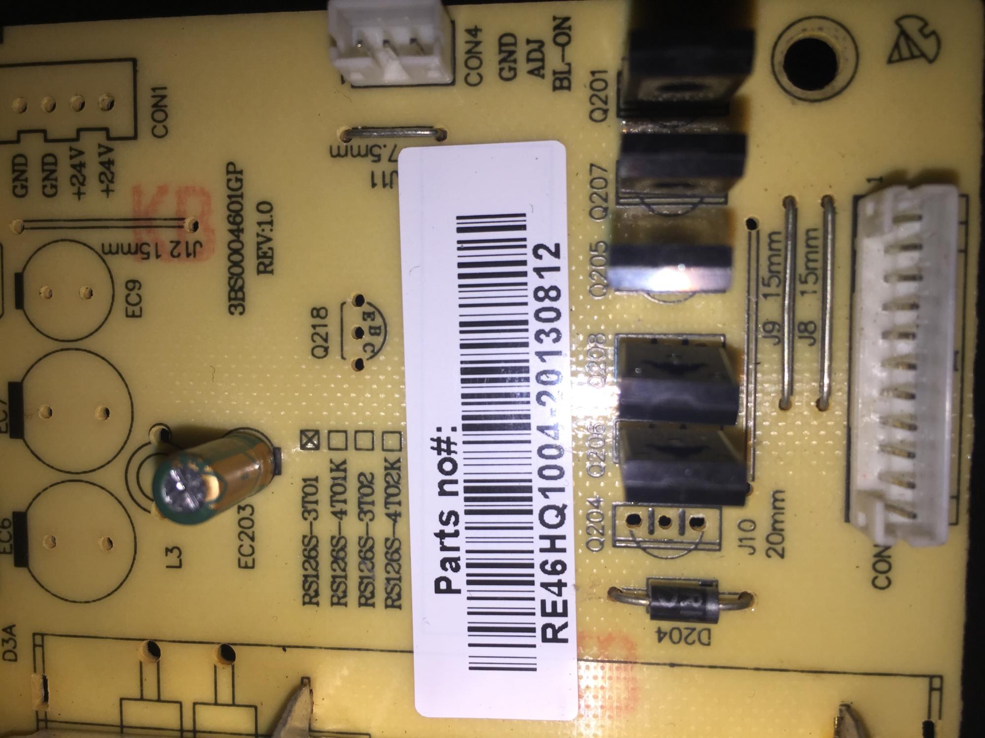

    Top side
      #62
      Re: Sound and picture but no backlight
      There should be printing on the body of Q201.
          D669 I think...
              D669A is the part#
                They look like transistors. Data sheet.
                http://www.datasheetq.com/datasheet-.../Iscsemi/D669A
                  I noticed there's 0v at d204
                    Have you check D204 with your meter set to diode mode?
                    JP8 whicjh is a 0 ohm resistor is on the other side of the board close to this diode. I would check that it hasn't gone open circiut.
                    I would check all the 0 ohm resistor in that area
                            D204 has a bunch of low Ohms (2R20) resistors connected in parallel with it so it will show conduction in both directions.
                              #74
                              BTW, are you getting the 380 ~ 400 VDC PFC Boosted Voltage on main filter cap EC101 ( measured between the two legs) when TV is turned on?
                              What are the Voltage rating of the caps EC11/12/201/202?

                                    #77
                                    Originally posted by JCdes View Post
                                    For ec101 I'm getting 376v, ec11 and 12 are 100uf 100v... 201 and 202 are 47uf 160v.
                                    OK, the PFC Boost Voltage is working.
                                    Next, meter set to 20Vdc, all connectors in place, black probe on the chassis, red probe on 1 of 3 pins of Q201 at a time then turn the TV on while watching the meter to see how high it goes up to then turn off the TV then repeat the same test on the other 2 pin of Q201.
                                    BTW, look at the spec sheet, post #67, of the Transistor so you can see which pin is Base and Emitter, middle pin is Collector (Connected to the Cathode of the LED string). Emitter is connected to resistor R244 (5R10), the other end of the resistor is then connected to circuit ground via D204//with resistors (R246/A, 247/A, 248/A) to complete the current path for the LED string, as you can see, the Cathode of the LED strings are not connected directly to circuit ground so if the transistors are not turned on then the LED strings will not light up.
                                      I get 0 on pin 1, 0 on pin 2 and .64 on pin 3. Nothing changes when I turn it on. I can check the wattage on the resistors I got tomorrow.
                                        #79
                                        0.64V on pin 3 (Base) is on border line of Bias Voltage to run it on since the Emitter is connected to the Diode to ground.
                                        Can you put the 100 Ohms resistor to the middle (Collector) pin of Q201 or on the LED connector pin that goes to the middle pin of Q201, the other end of the resistor will be connected to the circuit ground (chassis), you should see the one of the LED string try to come on, just watch out for the resistor may be over heated but it is just for testing only. Do not leave the TV on for too long.
                                          #80
                                          I can do that tomorrow. I got all the tools and goodies in my hobby shack outside the house. I'll do it and report back tomorrow. I really appreciate all the help. Resistor to center leg and to chassis right?
