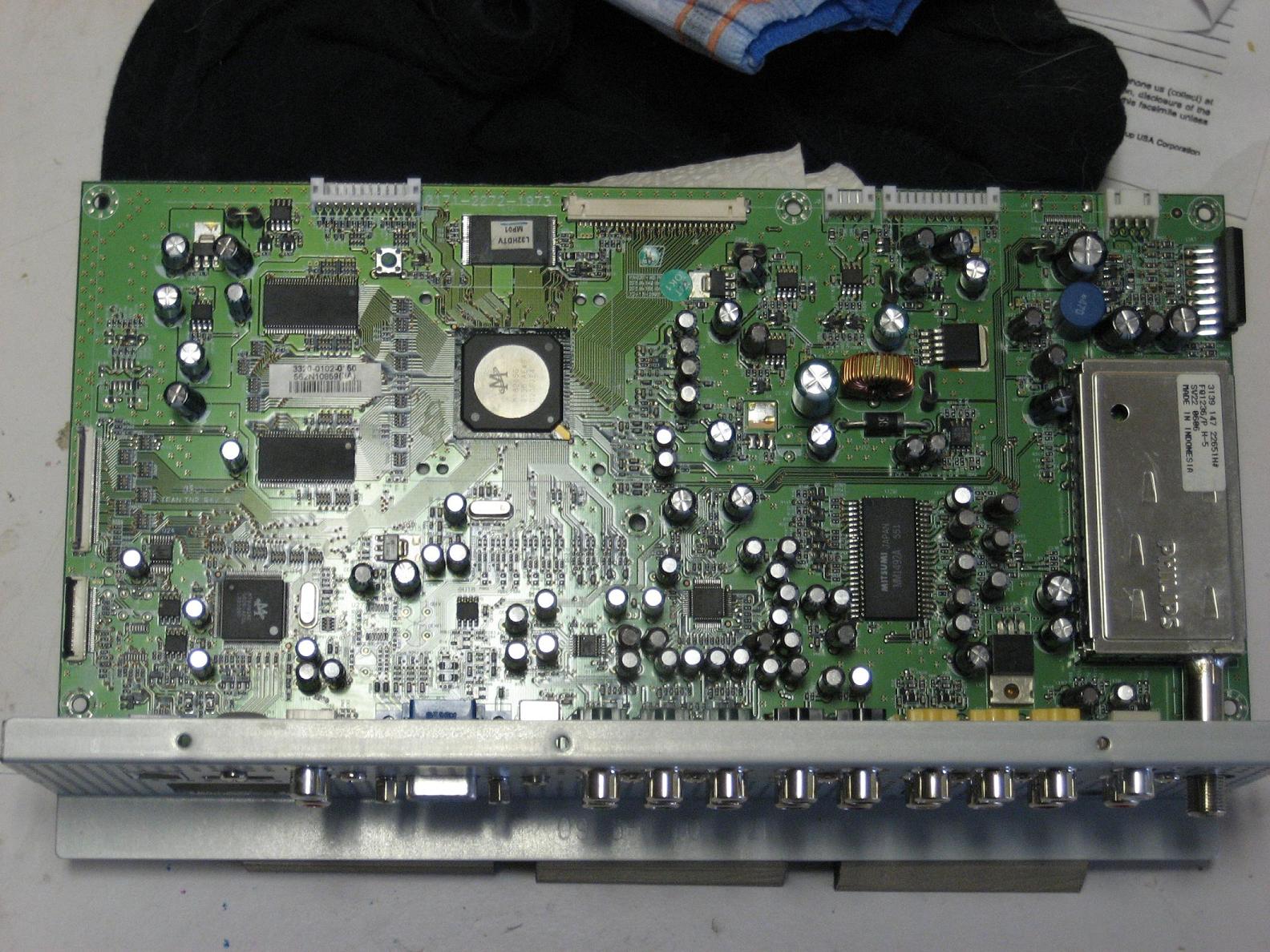

    I plugged it in and the amber standbye light came on and that's as far as it'll go. TV does not respond to any button pushes.
    Power supply is in good shape. Only the 5v line is available during standbye, but I tested the 19v and 12v lines by tricking the power supply into turning on fully and everything tested fine... atleast without any load.
    Started probing around elsewhere and determined that there was no sense voltage going out to the power button (or any other button). So of course the TV isn't going to be able to turn on.
    Suspected there was a problem with the main board. Made sure it was properly receiving 5v from the power supply. Noticed there was a 3.3v regulator there and that checked out as well.

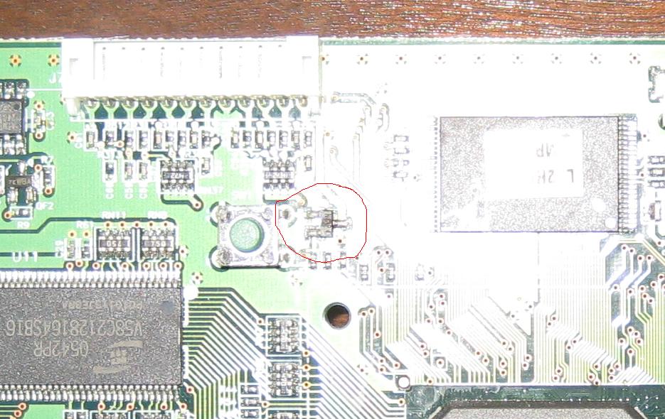

    I was going to start downloading datasheets and probing around more but decided I might as well take some pictures and upload them here incase anyone had any insight. As I was taking the pictures I noticed an abnormality on one of the tiny smd components. It has a small bump in the middle...
    Having trouble getting my digital camera to take good enough pictures but hopefully somebody can see well enough from them... I tried using the flash onetime on the closeup shot and it actually made the bump much easier to see (component circled in red)
    The suspected bad component is U26... and it happens to be near the connector that goes out to the board with the power button on it. It's hard to read the part number partly because its so small but also because the bump is right where one of the letters should be. It's really hard to say but I think the part number is NTP4 or N1P4 or something similar.
    I'll see if I can get better pictures but in the mean time I've attached the ones Ive taken so far.

      Did you carefully clean it? Could be flux glop sitting atop the transistor. Did you ohm it?
      Usually NPN or PNP and it is general purpose because this is not high speed stuff because this is on this circuit for the function input (buttons).

          It appears the component is damaged... It does not appear to be flux.
          Did some searching around and apparently its a common problem for this component to be defective in these sets. I found a post on fixya where a guy suggests removing u26 and replacing it with a diode. Doesn't seem like the best solution, but I tried it to see if it would fix the problem.
          And sure enough it did. I installed a diode across (what I believe to be) collector and emitter. He says to install it across pins 2 and 3.
          So yea. TV is working great now.

                Re: Vizio L32 HDTV10A - Wont turn on
                Got the parts and service manual for this TV off the net.
                U26 is listed as a ASM809 which is a 3 pin Microcontroller Power Supply Supervisor. Its function is to keep the microcontroller in a reset state for a brief time during powerup, down and brownouts in order to avoid any errors during those time.
                My U26 is faulty and is holding the microprocessor in reset. By installing the diode across pins 2 and 3, I am forcing the reset pin high and allowing the microprocessor to start (albiet without the safety of the brief time delay during powerup).
