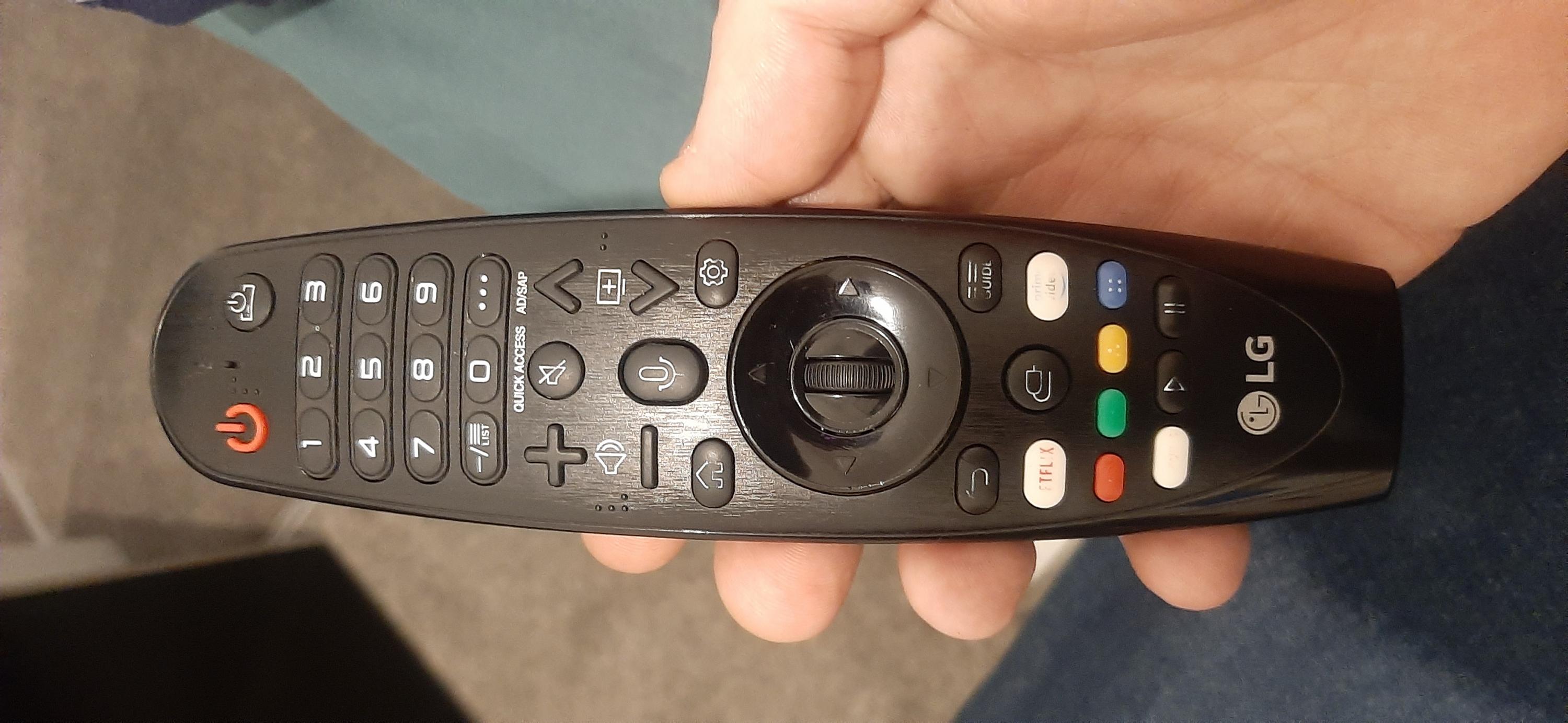

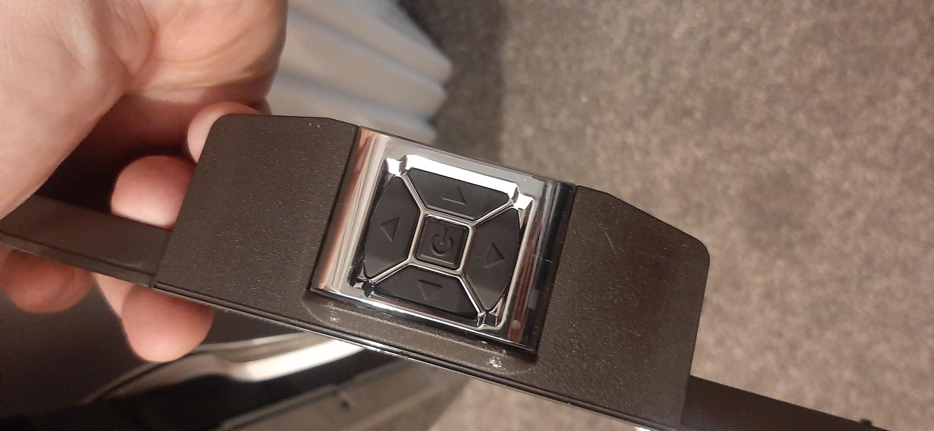

    Hi all how do I get into the service menu on this tv using this remote I've tried a few ways but can not get in

    Re: LG service menu on a 55uh770v
    LG had 2 kind of service engineering menu & one command for reset... all cant be access from your normal RC- need service RC or there on android apk can be used with any mobile set had build in IR

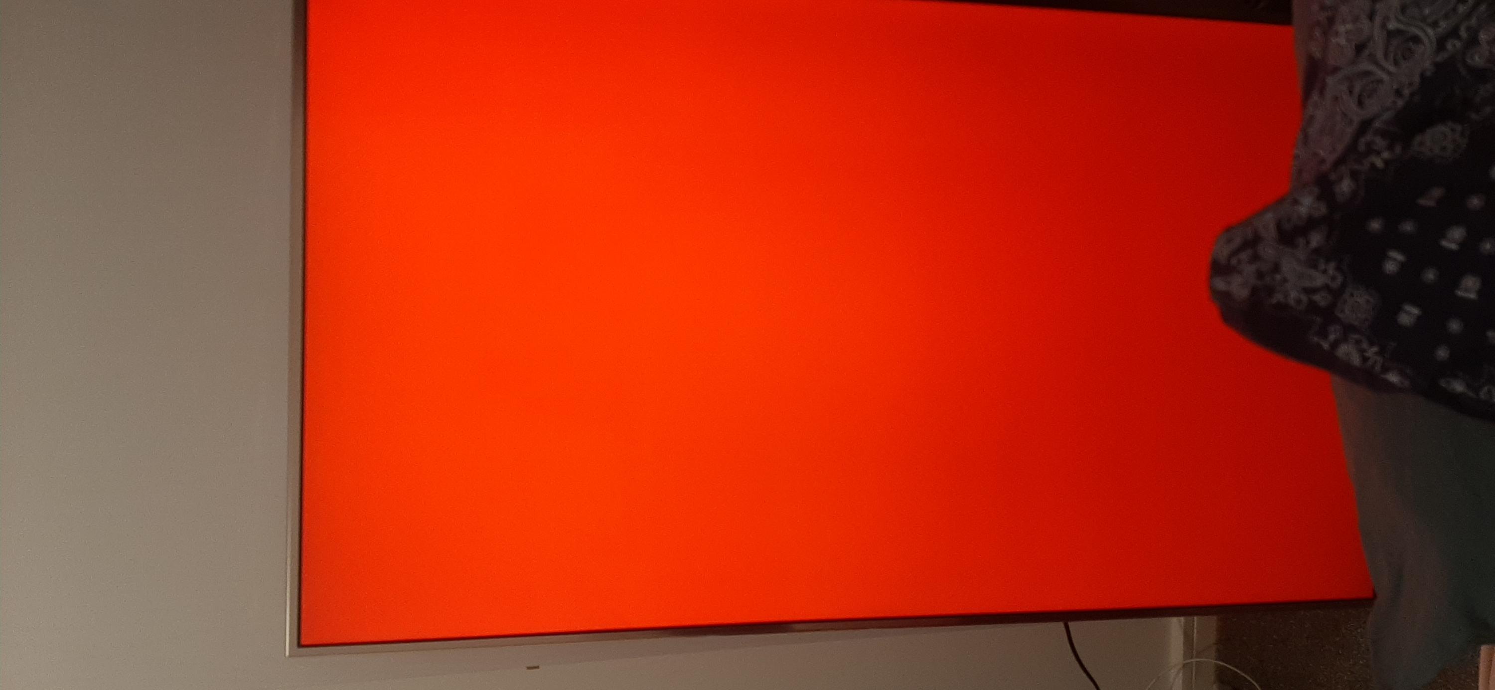

      Screens flashing want to completely re boot it
        Think its Eprom error

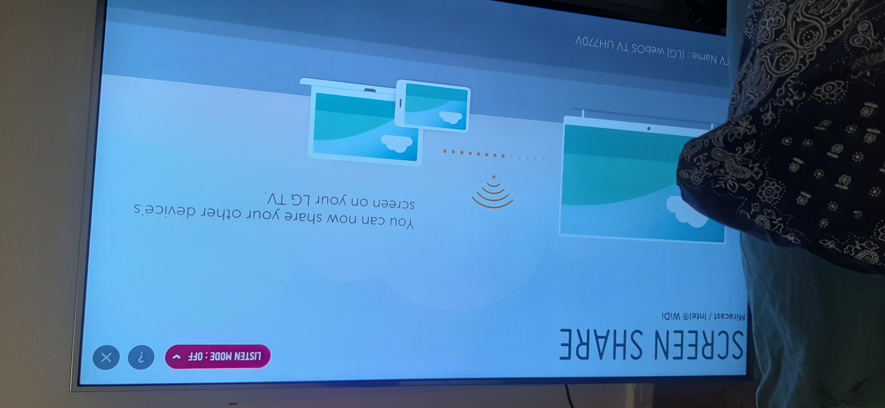

          As per this pic
            could be & could be other reason such LED BL..
            to reset eeprom and whole set to factory state need to send command IN_STOP following with code 0,4,1,3 we post over here many time apk for android or diy one on pc with .wave files
