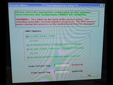

I need how to open this Dell service menu option in dell latitude e6420
  • sohail5307
    • Jul 2015
    • 35
    • india
    I need to open service menu of Dell laptops like image in attachment
    Ignore my English

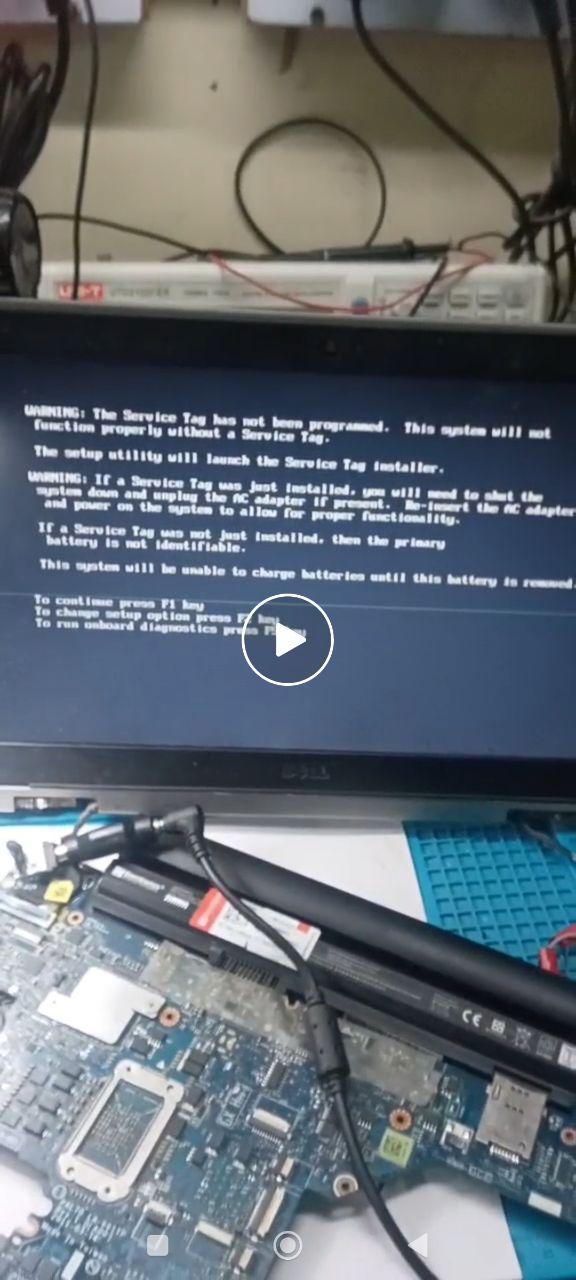

    I want beacause i flashed mec5055 using rt809h now it's does not have service tag, but when I install service using F2 in bios setup after save service tag and press disable manufacturing mode using alt+f then battery chagring is permanently disabled. I want to resolve this problem

      Battery id is entered into boot block of the MEC and this is known only to Dell. Battery charging will be disabled in normal mode. For now only possibility is to use MEC from donor board. The boot block is protected from read, so you can not use working MEC to copy it.
