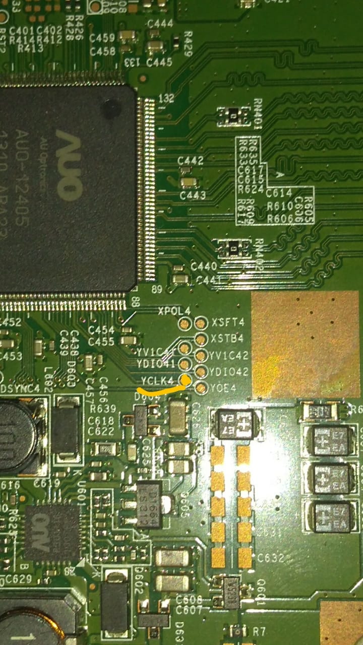

    Re: SONY 65" 4K - Horizontal Line on top
    Originally posted by Davi.p
    I have found a video where horiz. sparse lines, but intermittent, can be solved via signals masking..
    This is what we are trying tô do my friend!

                #67
                Which is the problem? I saw back that you found the correct pins to block..

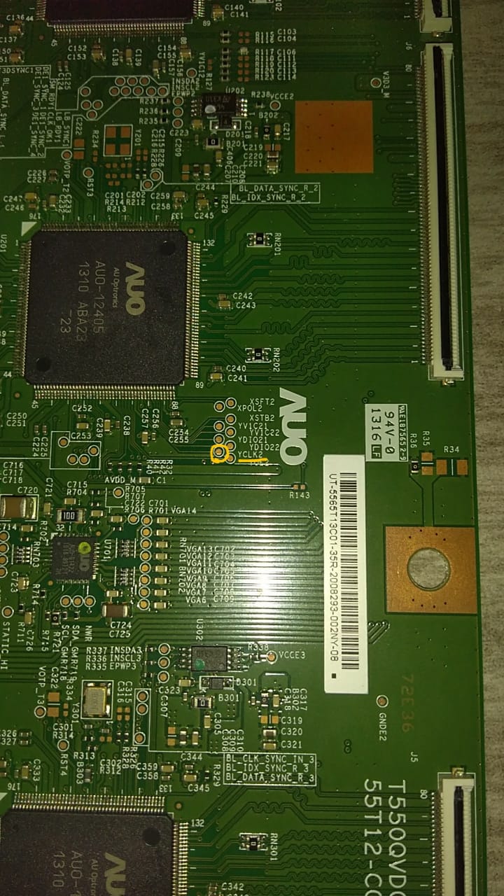

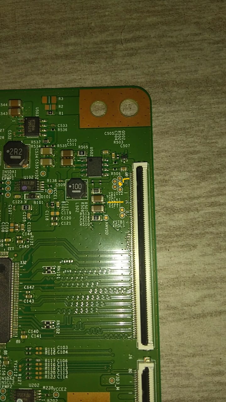

                  #68
                  Originally posted by 280zx
                  I watch the video, but not sure which ribbon contact to tape off. As for the t-con board I still have the old one.
                  is the 4th pin, on each cable
                  right side, 4th pin right to left, on both conectors
                  Left side 4th pin left to righ on both conectors , but you will need to test wich side to block testing one at the time

                        #71
                        clock signals 1 to 4
                        • 280zx
                          • May 2020
                          • 43
                          • US
                          #72
                          So if I understand correctly each ribbon has its own clock signal?
                          • pazoline
                            • Dec 2020
                            • 26
                            • Brasil
                            #73
                            yes , each side each conector, always in the 4th pin
