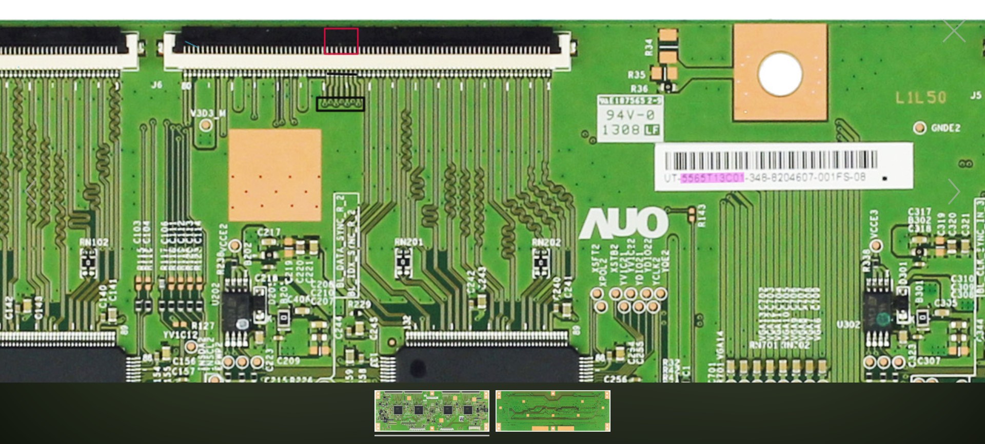

      Re: SONY 65" 4K - Horizontal Line on top
      Originally posted by 280zx
      I will, thanks for the advise. Hoping that someone know which pins to block of on the ribbons once I get them. Myself and pazoline would highly appreciate it.
      i am looking for the datasheet of the t-con board , we canot destroy our ribon cables again, they are really fragile , if somebody just could help us analyzing the tcon ! would be of great help!

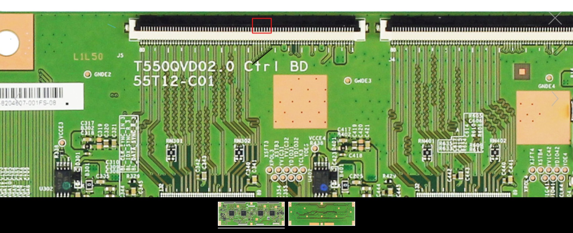

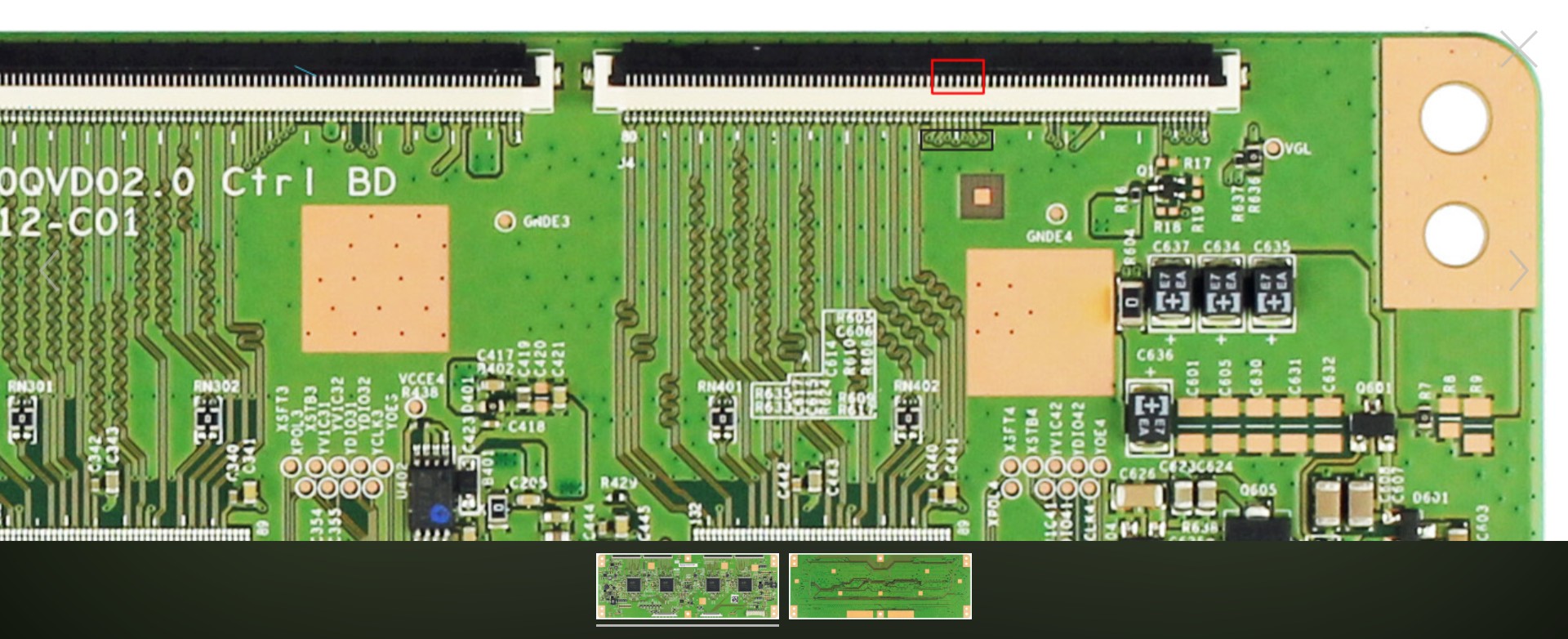

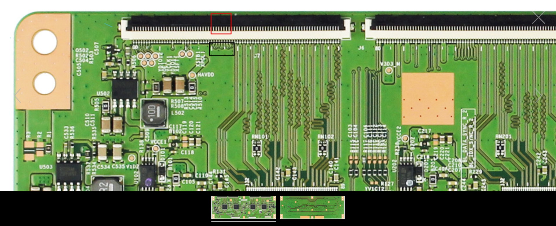

              #46
              I freking find it! god dam clock signals ,
              i will send you the pictures by the back of the board, and the front marked

                  here we go , i wil be 100% sure when i test it on sunday with my multimeter, i can only open the tv on sundays, cant wait!
                      Tomorrow , i will do the following , i will use the damaged flat cables to test the isolation techinique , seeing the pictures of your tv , that is exactly same as mine , i came to conclusion that the problem can be by passed isolating the clock signals on the conector apointed on the image that i atached on this post
                                  Finally got the ribbon cables, but won't be able to get to the TV until maybe next week.
                                  i open the tv on yesterday , sad news, my cables didint work , but i have GOOD NEWS, i have found now 100% sure the clock signals, i am posting a video on youtube the as soon as i can today

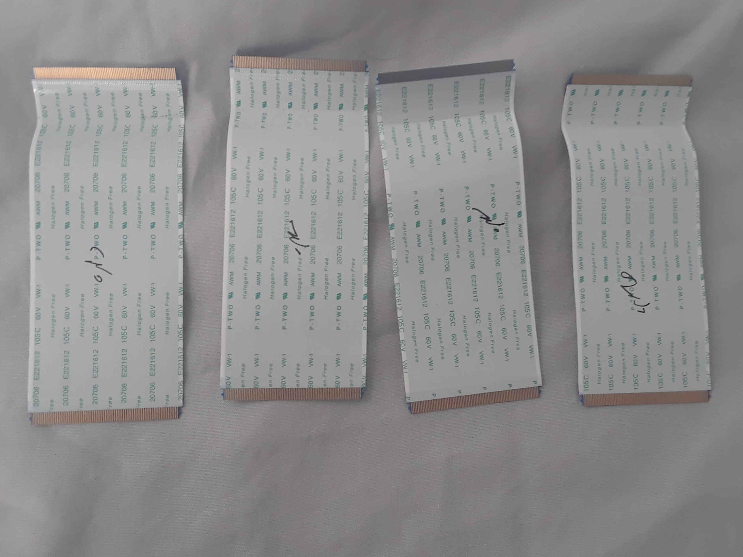

                                        #59
                                        pazoline here is a picture of the new ribbons I received. Here is the link to where I purchased them.
                                        https://www.tvpartshome.com/product/...ribbon-cables/
