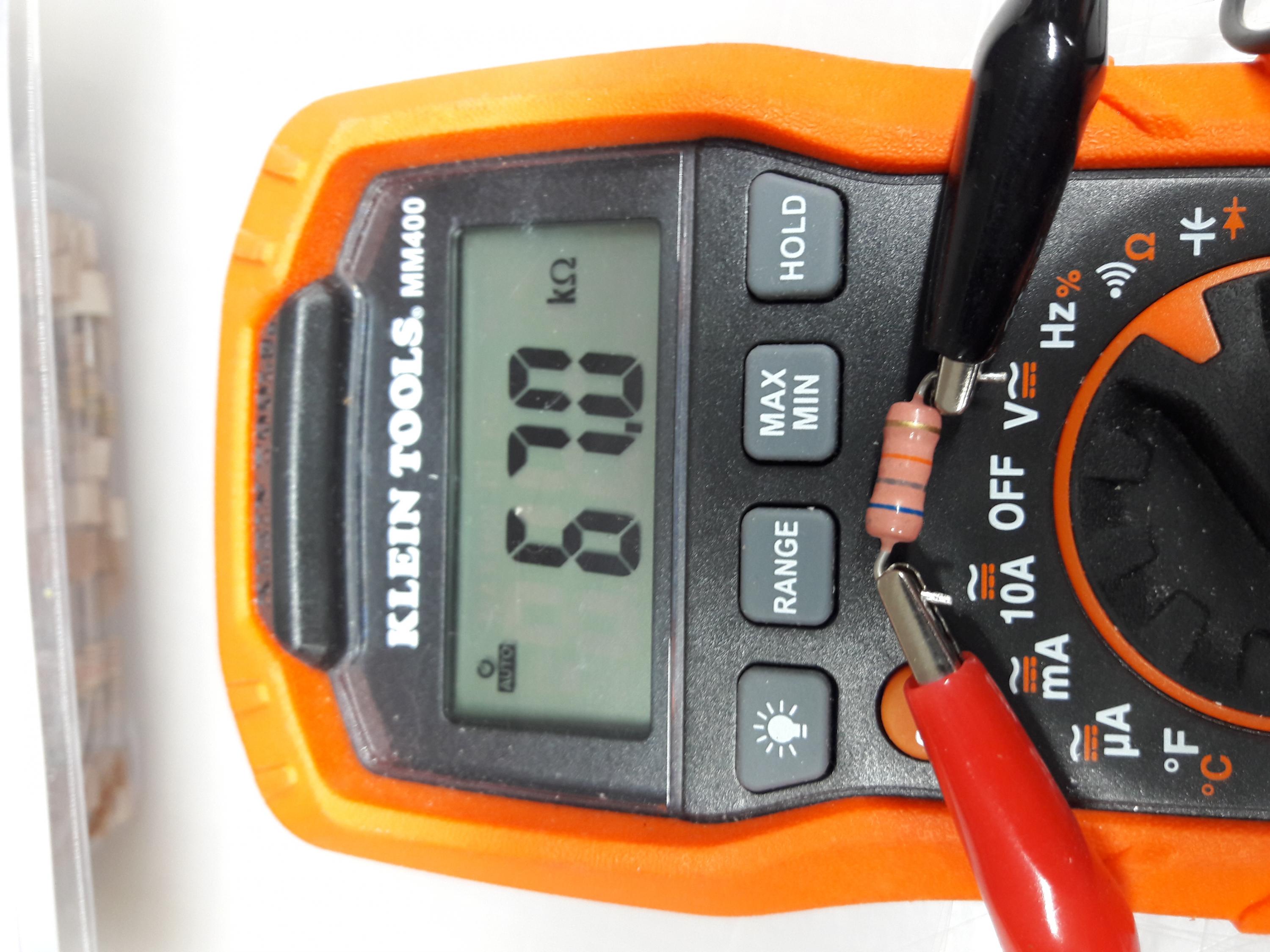

          I have a feeling that standby power supply was working but may be measurement error in the beginning.
          Here is what R12 reads and the resistor so you can check value. I think its good if I am calculating right.
            #45
            Re: VIZIO D60-F3 Wont Power ON, No Standby, No Picture, No Sound
            Sorry, I gave you the wrong designator for the Source pin resistor, it is way under the heatsink, it is R13 which is connected between Source pin of the MOSFET and HOT side circuit ground.
            That R12 snubber resistor is fine.

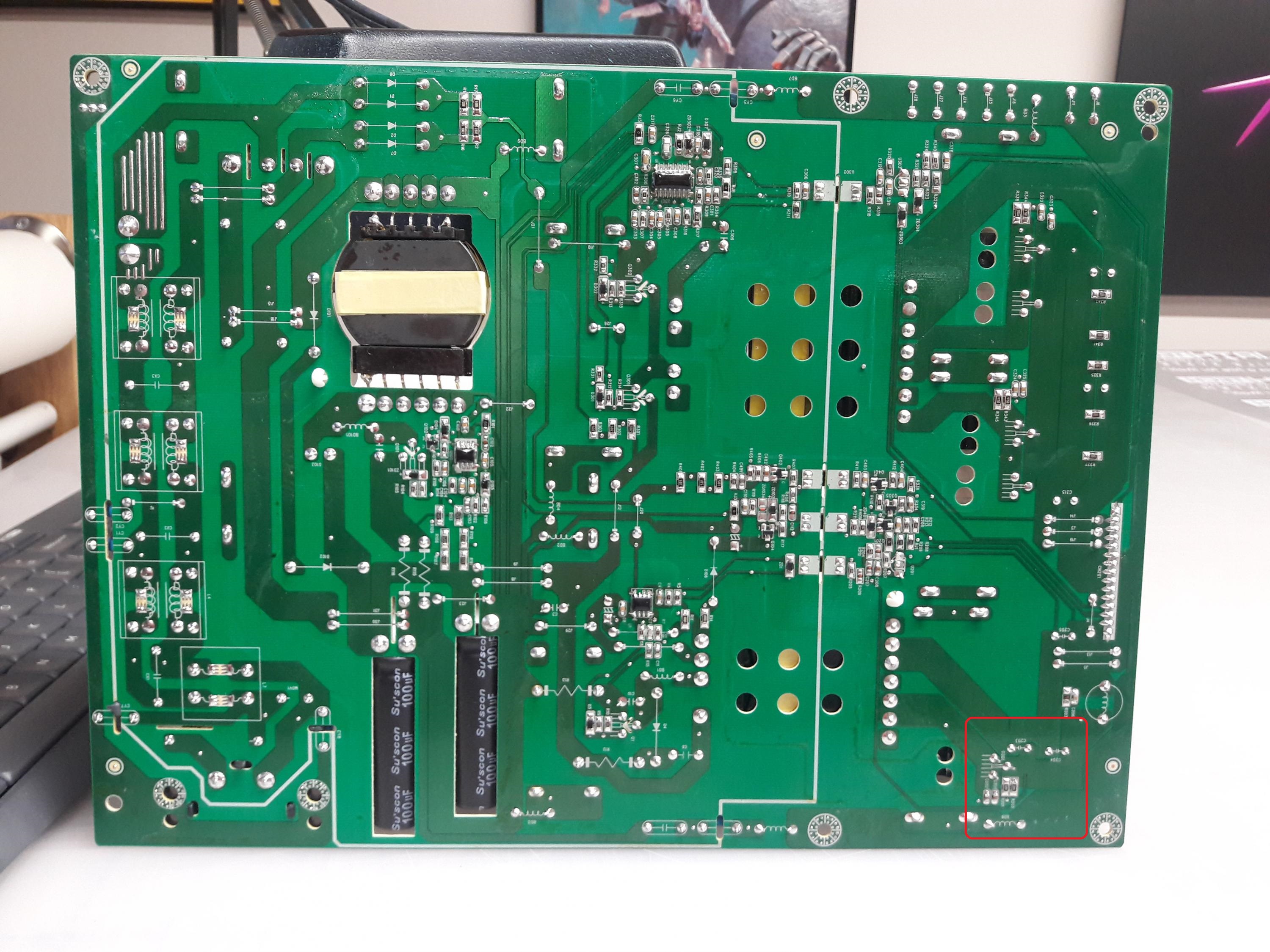

                    #49
                    Have you checked the components in the red box
