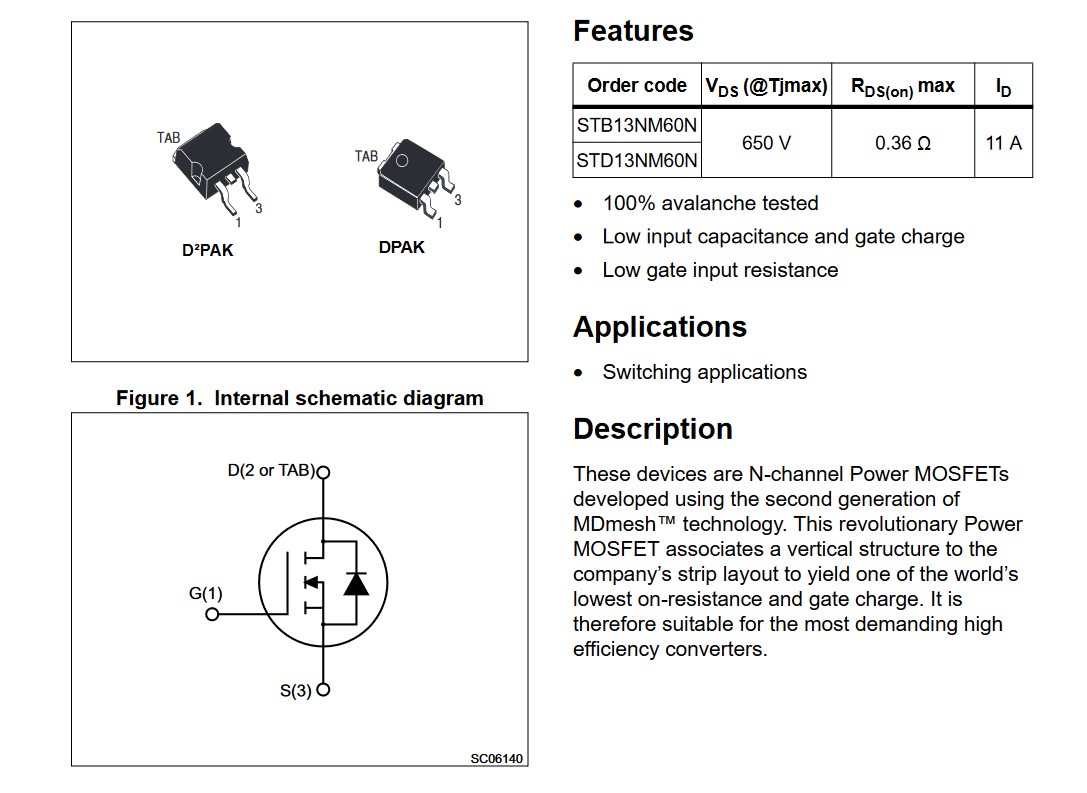

                After checking with multimeter the Q7301 and Q7302 are not showing the right values between surce and drain ...
                But a question,what is their mark,i can't see it on them,and on the shematic there is no value for Q7301 or Q7302 (the PDF doc)
                STB13NM60N - maybe ????

                  Use a magnifier and shine a light on them at an angle to see if you can read what is written on them.

                    Tryed,but last numbers/letters are missing ...
                    Just se the 13NMxx0N the xx is missing

                      They could be STB13NM60N as you suggested earlier

                        Thx all for help ...
                        The parts came on friday,today I put them on the power board,and the tv works ...
                        again thx all ...
