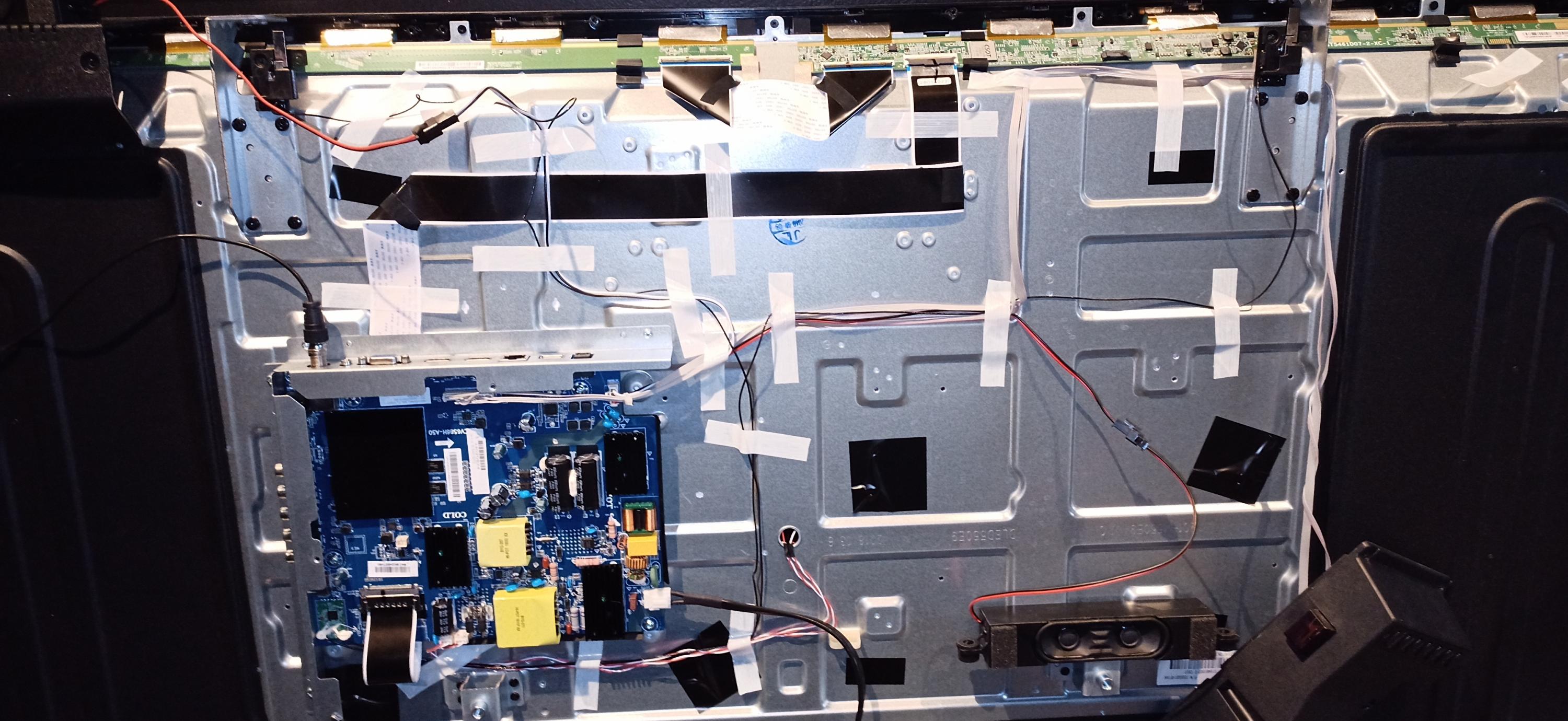

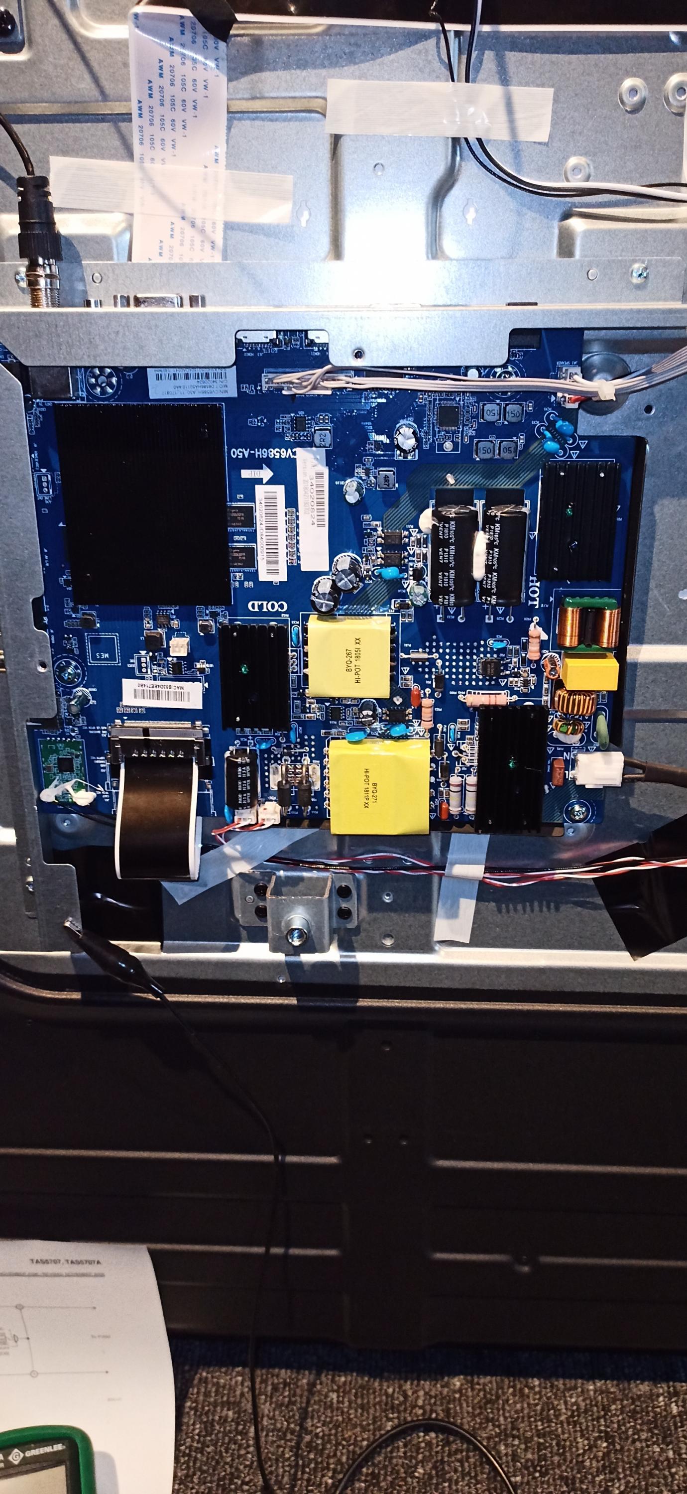

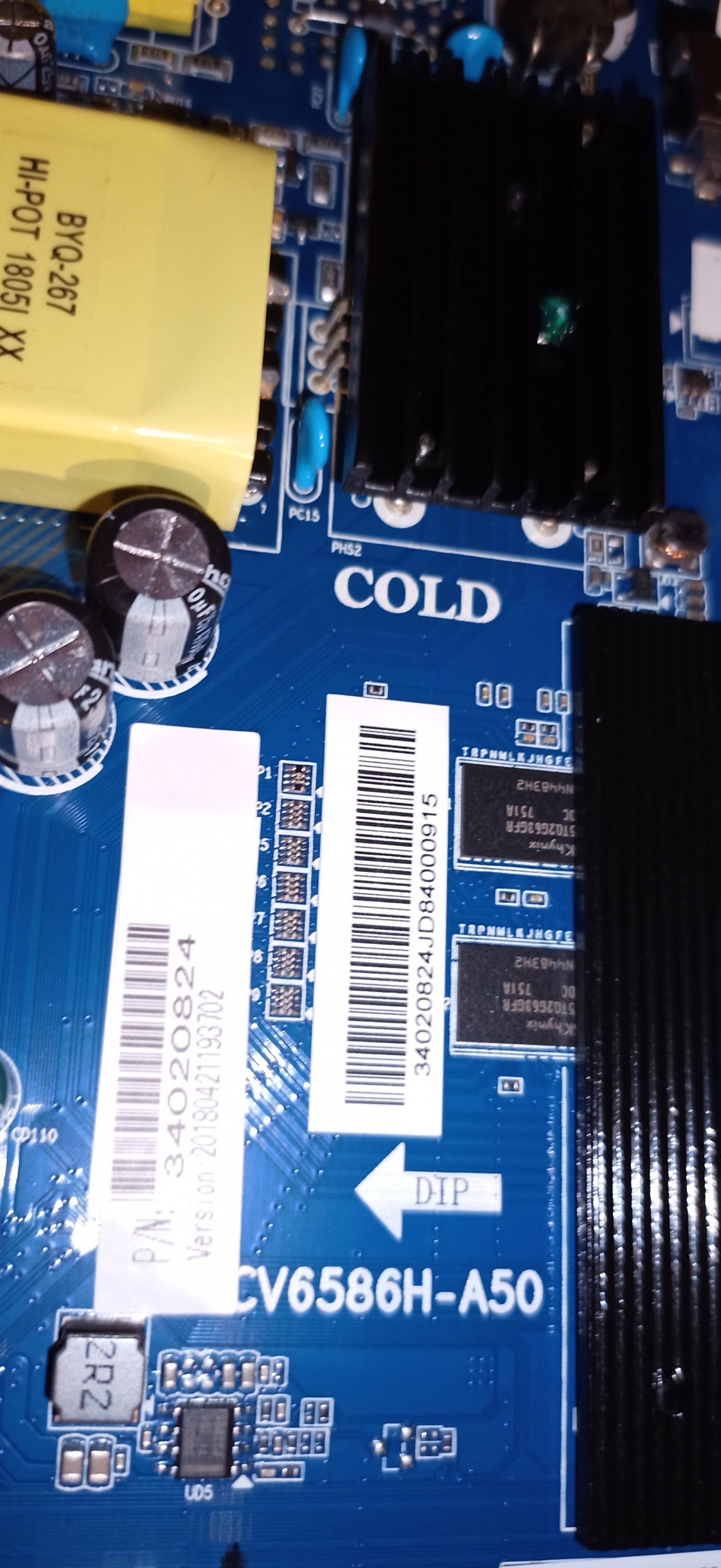

    I think this set comes in many flavours from the usual suspects, RCA, Proscan, other house brands etc. Main/Power board is CV6586H-A50 P/N 34020824.

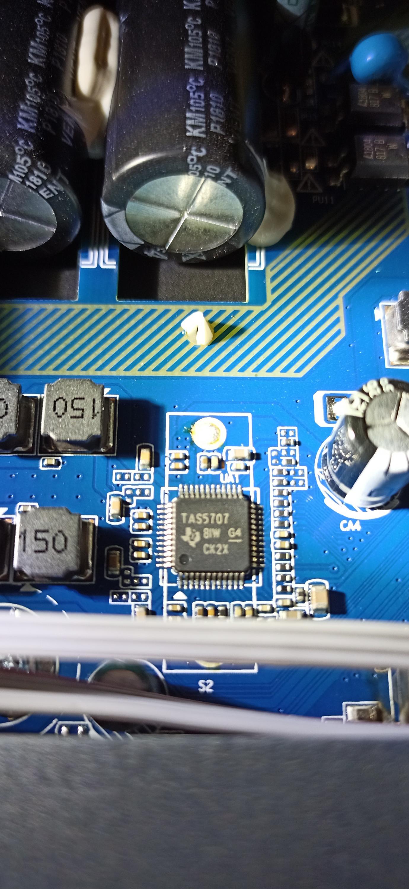

    The set has no audio from the speakers but if I plug in a pair of headphones to the audio out jack I do hear sound fine. Sound is produced by the Texas Instruments TAS5707 class D amplifier ic. I measure 3.3v and 12v at the voltage input pins of the chip.
    Does anyone have experience with these chips ? Would this be a somewhat common ocurrence remedied by replacing the ic ?
    Pics in following post.

    Some pics...

          The speakers didn't accidentally get set to external? Sometimes a reflow of that sound IC will work.

              Re: Westinghouse WD55UDR101 No Audio from Speakers
              This tv quit altogether just after mounting it to the wall. Of course.
              A replacement main board from an RCA tv brought it back to life and fixed the no audio problem as well.
