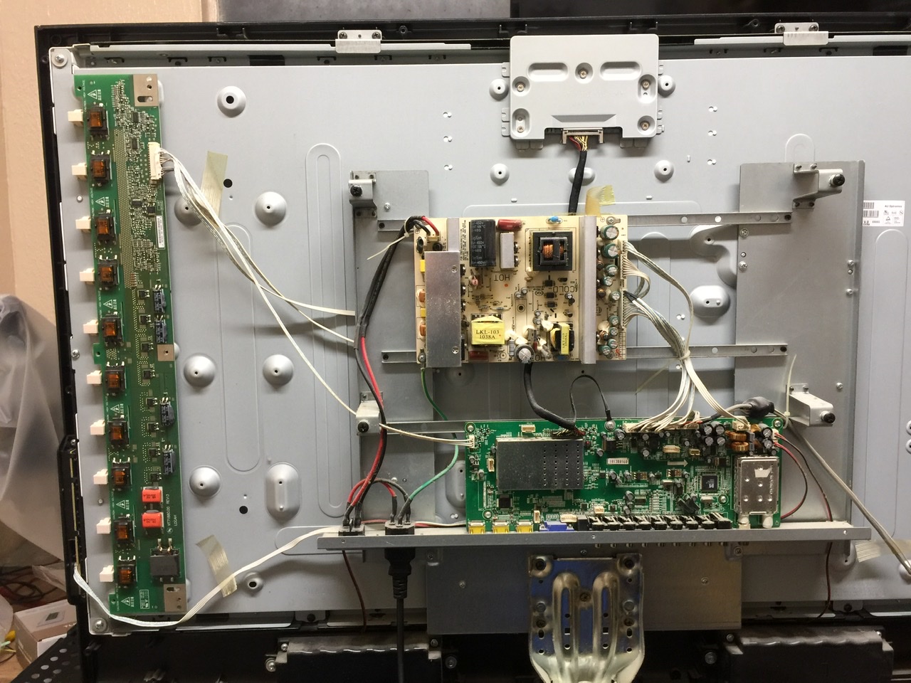

    I have this apex ld4088, the backlights will run for about 60 seconds and shut down, when they are working there is a slight buzz from inverter board. Power board is out putting the proper voltage. Standby 5v and the 24v to back light inverter board. 24v still present at plug on inverter when back lights quit. Thanks Michael
  • dick_barton
    • Aug 2015
    • 6642
    • Wales
    Re: Apex LD 4088 backlight shut down

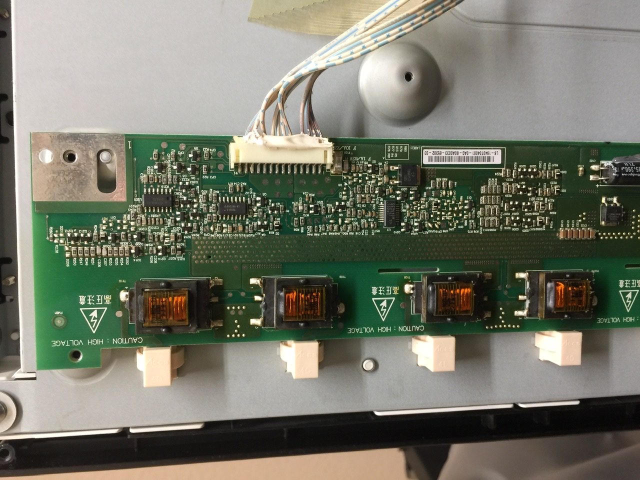

    One of the lamps or transformers on the inverter board may be failing. You need to look very carefully when the backlights are on to see if you have a dimmer line across the screen where a tube may be failing.
    Do you still have an image on the screen when backlights fail if you shine a light on the screen and look carefully.

        The set uses fluorescent tubes not leds and run at >1KVolts via the transformers on the inverter board
          https://www.badcaps.net/forum/attach...3&d=1601342388
          Are the Inverter board mounting screws missing?
          Inspect the Inverter transformers as suggested, also unplug the inverter board from the socket and inspect the inverter board fingers and the sockets.

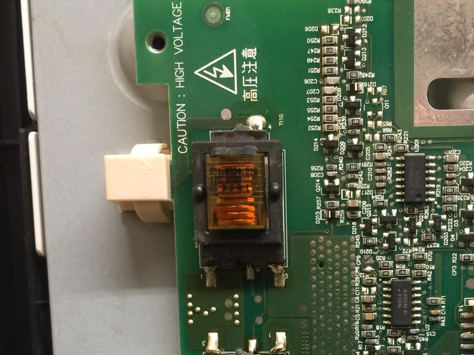

                  Can you check the winding resistance of each of the inverter transformers and compare them to each other.
                  You said the set powers up briefly so are you able to see if there is a lighter band across the screen where one of the tubes may be failing?
                          There appears to be 4 solder points on each transformer.
                          If you label them 1 to 4 then test
                          Transformer 1
                          Pin 1 - 2
                          Pin 1 -3
                          Pin 1 - 4
                          then
                          Pin 2 - 3
                          Pin 2 - 4
                          then
                          Pin 3 - 4
                          Transformer 2
                          And note the resistance carefully for each test and for each transformer 1 to 10.
                          It would also be worth looking on the underside of the board to see if there is any sign of overheating. Board tends to brown.
