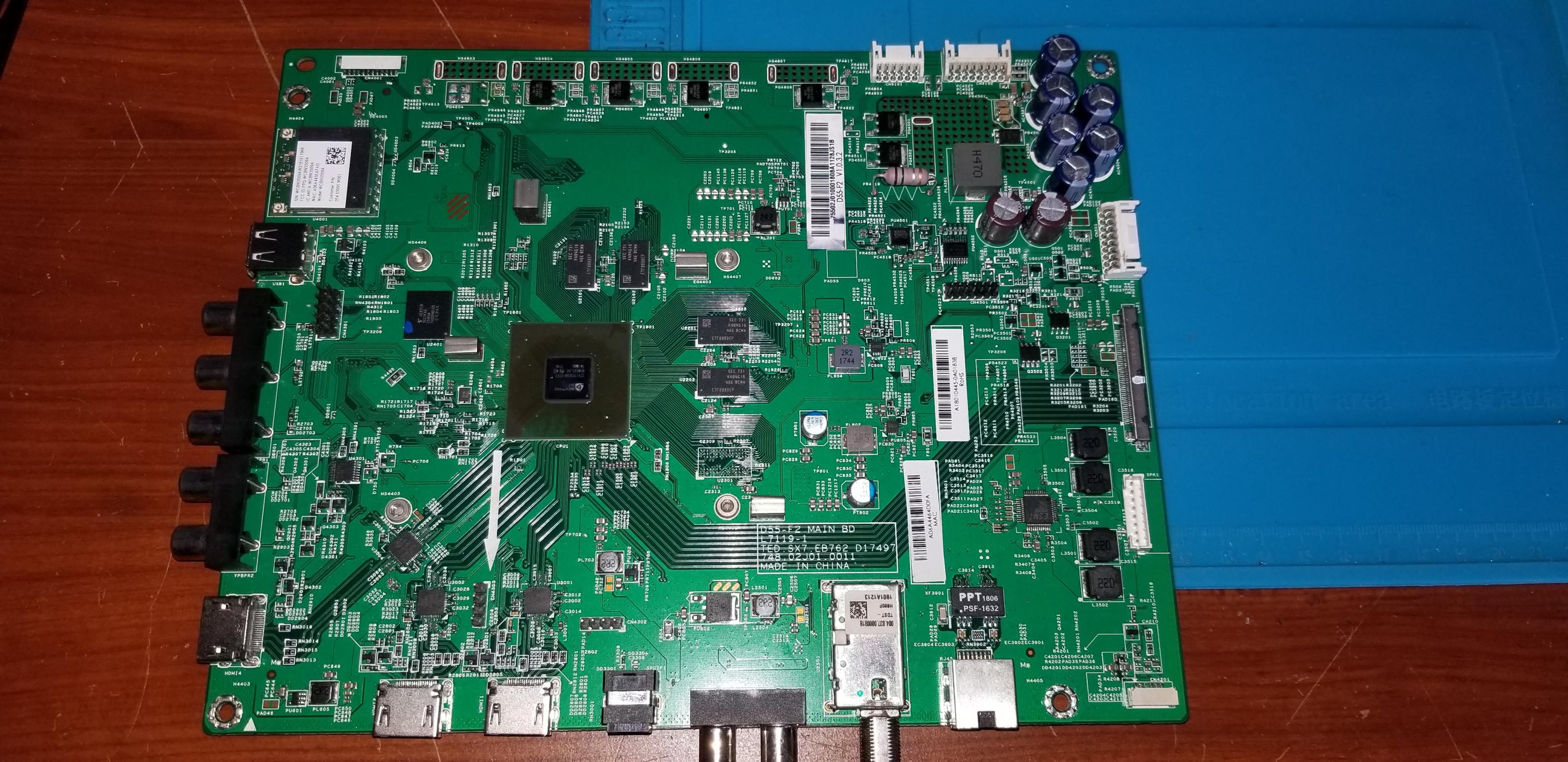

    Vizio D55-f2 backlight/power supply 20v/24v rail output high 26v
    no backlight on set.
    the 20v rail fuse on the mainboard was blown. i replaced and backlight and tv worked for about a day before flickering and out again
    input on mainboard for led should be 20v to fuse but is reading 26v at input and <3v output.
    power supply output should be 20v/24v from connector and output is reading >25.6-26v
    any suggestions?

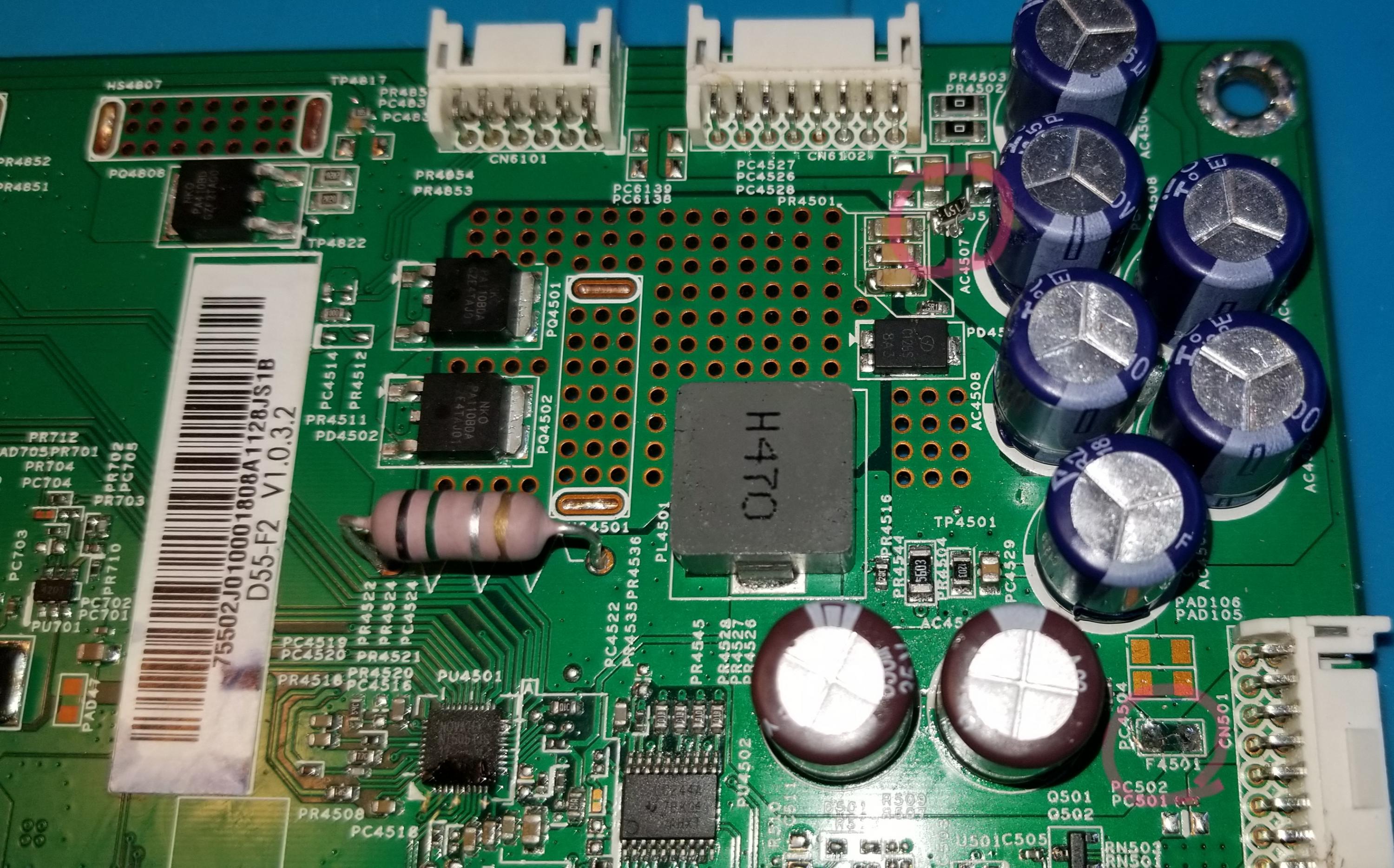

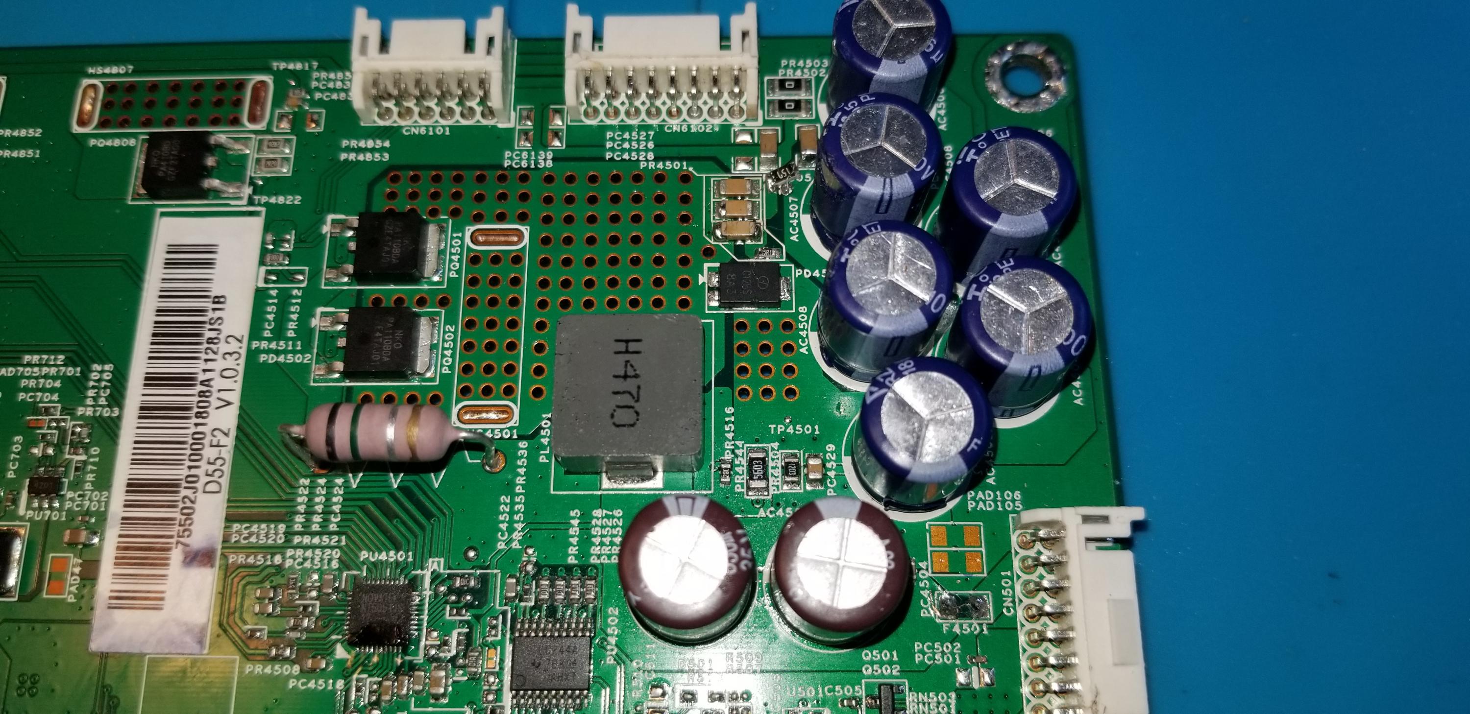

                Re: Vizio D55-f2 backlight/power supply 20v/24v rail output high 26v
                please excuse the hackjob of the 15ohm resistor and wire for a fuse i could not find another 5R1 resistor.
                when i plug in the connector cn6101 upside down with positive on neg side etc there is backlight and display is working however half does look brighter.
                cn6101 is where polarity is reversed

                  i also removed mosfet pq4804 because i am getting inconsistent reading than other mosfets and pq4807 reading slightliy lower resistance as well
                      https://www.badcaps.net/forum/attach...9&d=1601919019
                      Is that Brown Green Silver Gold resistor you installed? That is 0.15 Ohms.
                      That is current sensing resistor connected to the Source pin of the MOSFET's PQ4501, 4502 so you cannot just put in any value resistor it's place.
                      Was the 5R1 resistor bad? What are the color band of the resistor?
                      Where is the wire for the fuse?
                        top circled smd is the resitor i replaced. there is another 5r1 smd slightly lower.
                        the circle on right is where i put a jumper wire for the smd fuse. difficult to see it is a tiny piece of wire
                          The 5R1 resistor close by is part of the RC snubber network for the Diode PD45??.
                          I cannot see how you can have a SMD resistor and SMD fuse on just two solder pads, you are not making any senses to me.

                            there is no smd fuse i just soldered a jumper wire
                            • Nonya333
                              • Aug 2018
                              • 19
                              and replaced a 5r1 that was bad with the bigger 5ohm smd

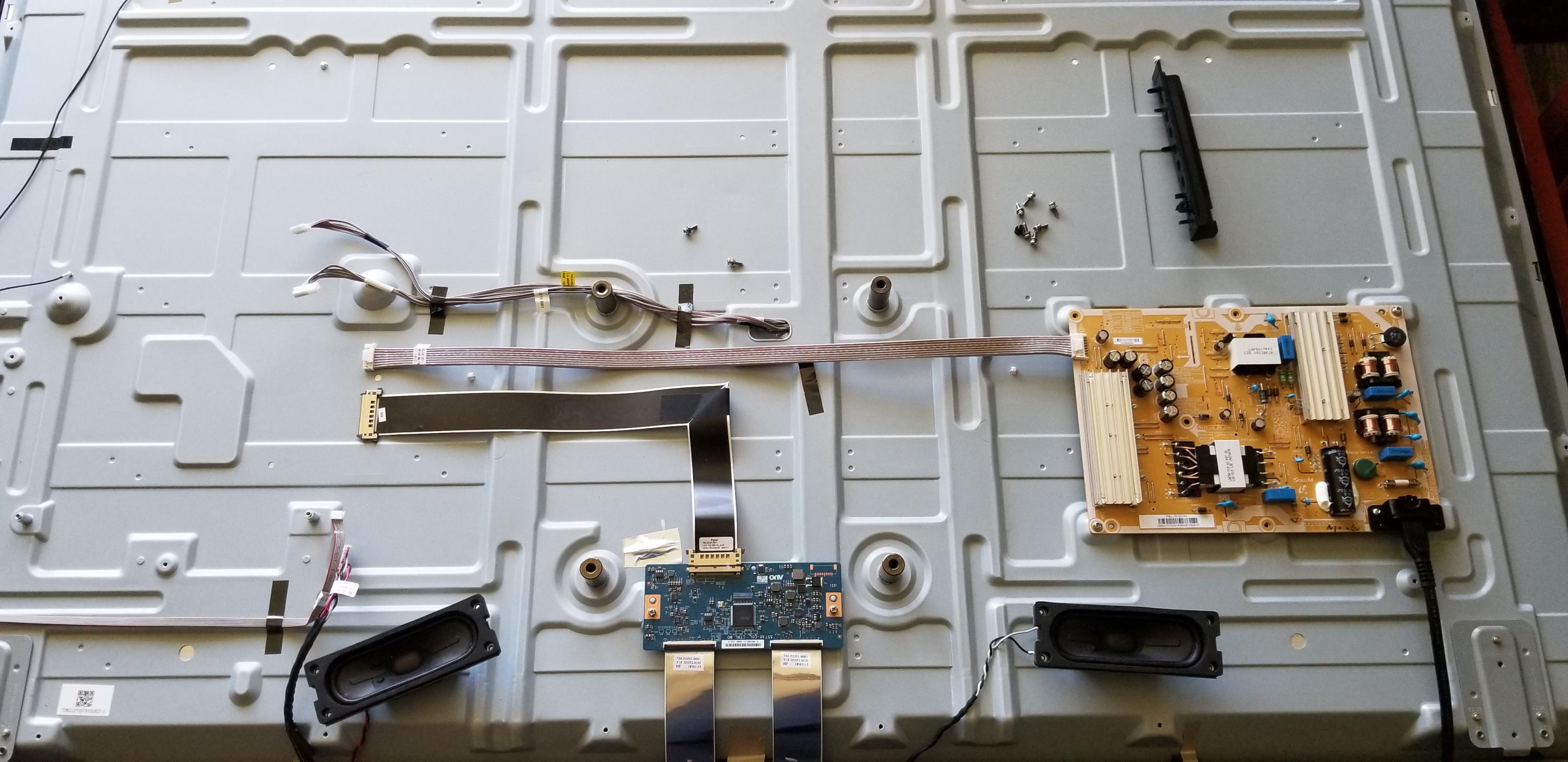

                                    4) Need to see the pictures of the whole backside the TV showing how all the boards and the backlight LED's are connected together.

                                      the fuse was blown prior to me touching anything. it was a white smd with the letter "Y". i also could not find info on that.
                                      i found a bigger package smd fuse rated at 2a and replaced that. the set worked for approximately 5-10 hours and then fuse blew again
                                      the 5r1 resistor was showing up as a capacitor on my cheap esr meter and showing higher resistance i believe. i still have it i will have to double check
