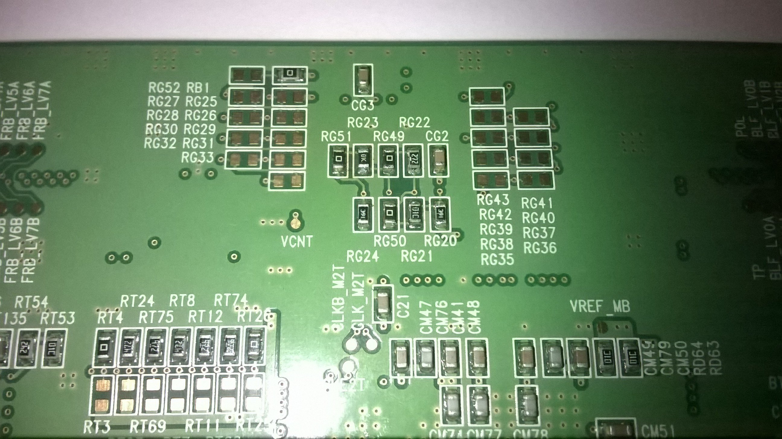

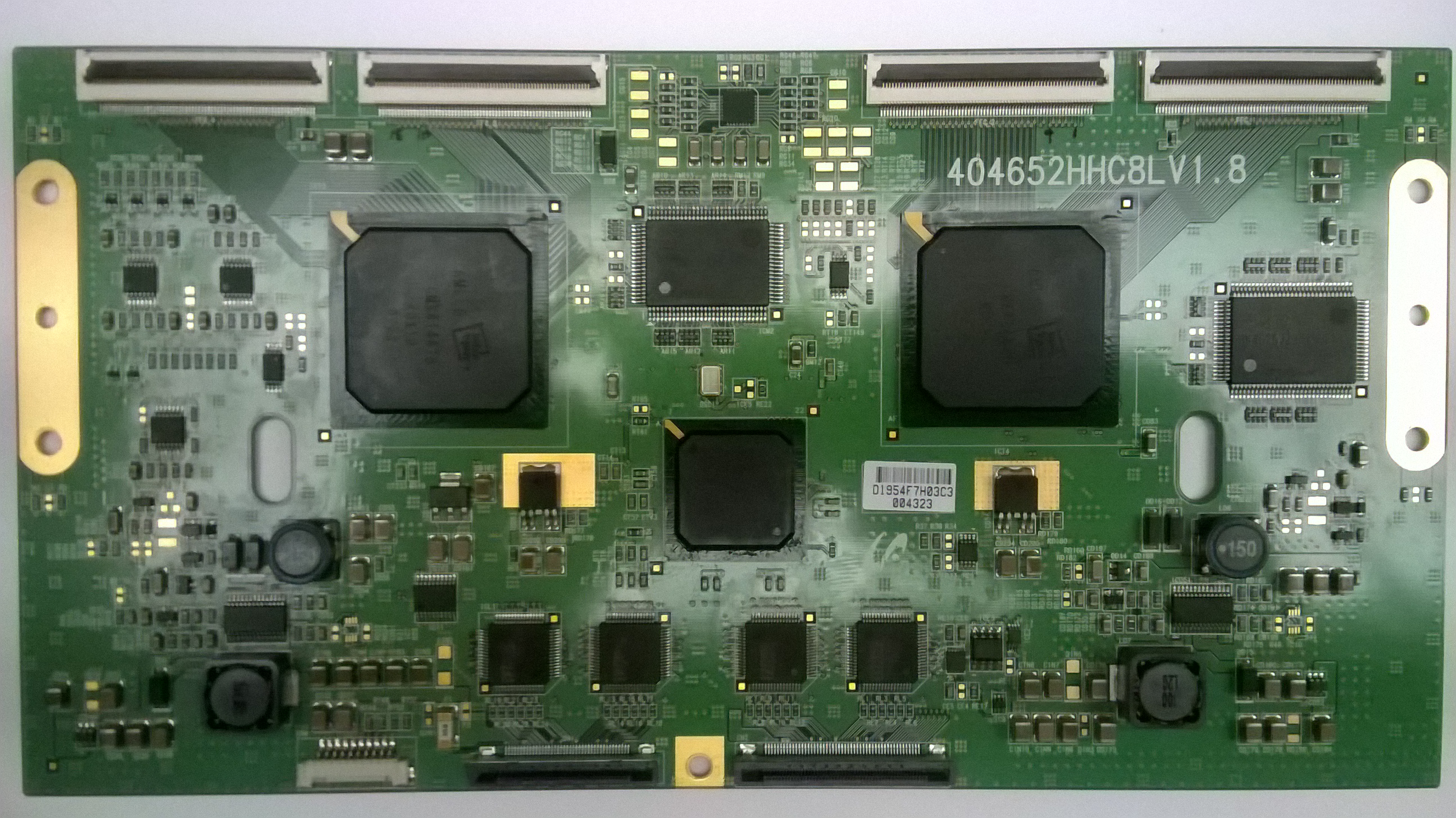

    I just want to share the fix of my Sony KDL-46XBR4. It had an intermittent milky white image, typical of a bad chroma chip. The T-CON board model is 404652HHC8LV1.8 from Samsung.

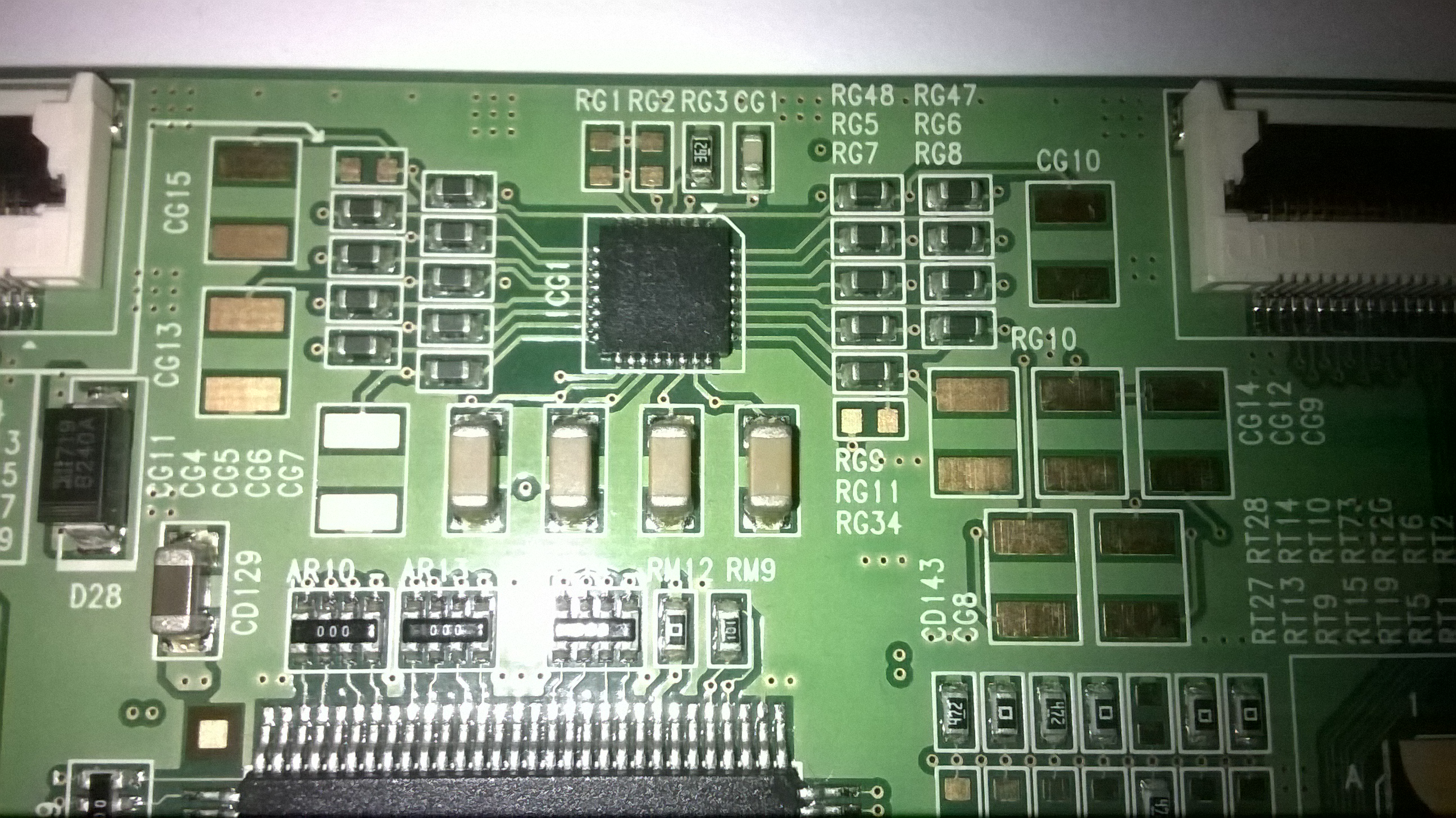

    The chroma chip on the T-CON board is an ISL24005. This is a programmable one (through an I2C interface), but it has 4 input references (VREFL_L, VREFL_H, VREFU_L and VREFU_H).
    Thanks to the designers of this T-CON board, all the tests points for VGMA1-VGMA18 are on the BACK side of the board. I had to measure the VGMA voltages on the front side at the vias going to the surface mount connectors.
    As expected, the VGMA voltages were off while the problem happened. I traced down the problem to the 4 input reference voltages. They were easily measured at the top of the 4 capacitors (CG4-CG7) just below the chroma chip (ICG1). The 4 reference voltages were produced by a series of resistors on the bottom side of the board. Here are the measured voltages through the series resistors :
    GND
    RG24 (390 ohm) : 0.19 volt good, 0.01 volt bad (measured at CG7)
    RG51 (0 ohm)
    RG23 (10k ohm) : 6.14 volt good, 15.18 volt bad (measured at CG6)
    RG 49 (0 ohm)
    RG22 (2.7k ohm) : 10.23 volt good, 15.24 volt bad (measured at CG5)
    RG50 (0 ohm)
    RG21 (10k ohm) : 15.12 volt good, 15.31 volt bad (measured at CG4)
    RG20 (390 ohm)
    16v input
    It turned out that the 10k ohm resistor (marked 01C in EIA-96 notation) at position RG23 was intermittently open. Later on I also found the 2.7k resistor at position RG22 with an intermittent problem. Replaced the two resistors and the TV set works like a new, with vivid colors.

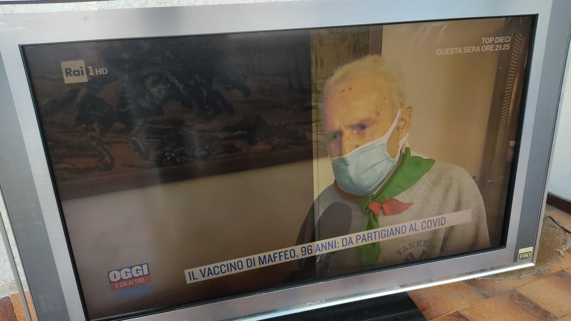

      I have a Sony kdl-52x3500 with the same tcon, and the tv-set has a weird issue: the right half of the image is brighter than the left side (see picture).
      I measured the same points on the tcon and these are the voltages:
      • Cg7: 0,252v
      • Cg6: 6,73v
      • Cg5: 8,47v
      • Cg4: 14,97v
      Where can I measure the 16v input?
      Btw, I tried to measure the resistances on the back of the tcon board and the 10kΩ measured kinda 6,7kΩ but onboard, not desoldered, and the 390Ω more or less 384~Ω, still not desoldered: should I try them off board?
      I almost forgot: where did you get the correct values for this tcon? Do you have a schematic diagram?

          Hi Ranmamez,
          Your 16v input is good since the other voltages are present. Your problem is definitely not the same as mine. There's only one chroma chip and a problem about it would affect the entire screen.
          The answer for your second question about the correct values is that I have measured them myself. The problem was intermittent, so I had the chance of measuring them when the display was good, and compare them when the problem occurred.
          The answer to your third question about the schematic diagram is that I don't have it. In fact, there is a very limited amount of T-CON board diagrams available. Often I make my way by looking at the spec sheet of the various chips present on the board. Often you will find a typical application diagram for that chip. And sometimes it helps since the developer of that board used the same design as the one in the chip's documentation.
          In a few cases, you can find documentation about the LCD panel itself. Often the T-CON board comes with the LCD panel from the manufacturer. So you can find some information about the inputs and outputs of the T-CON board. AUO is an example of a manufacturer that sometimes provide this information.
          There's a guide that lists common defects on T-CON boards. Google for "Collection of T-CON board repairing information by Kent Liew".
          But there's a good news. Half of the display is ok. So you have a known good reference of the voltages going to the LCD panel on the good side. Take voltages measurements and compare both sides.
          But there's also the possibility that the problem lies on the connections to the LCD panel's bottom board (or top board, depending on the T-CON board location). Re-seat all the ribbon connectors. If it doesn't help the LCD panel may have a tab bonding issue. Be careful and apply pressure on the flex cables going from the bottom/top board to the LCD panel. You may have to carefully remove the LCD panel metal frame to apply pressure to the flex cables going to the glass panel.
          Good luck.
