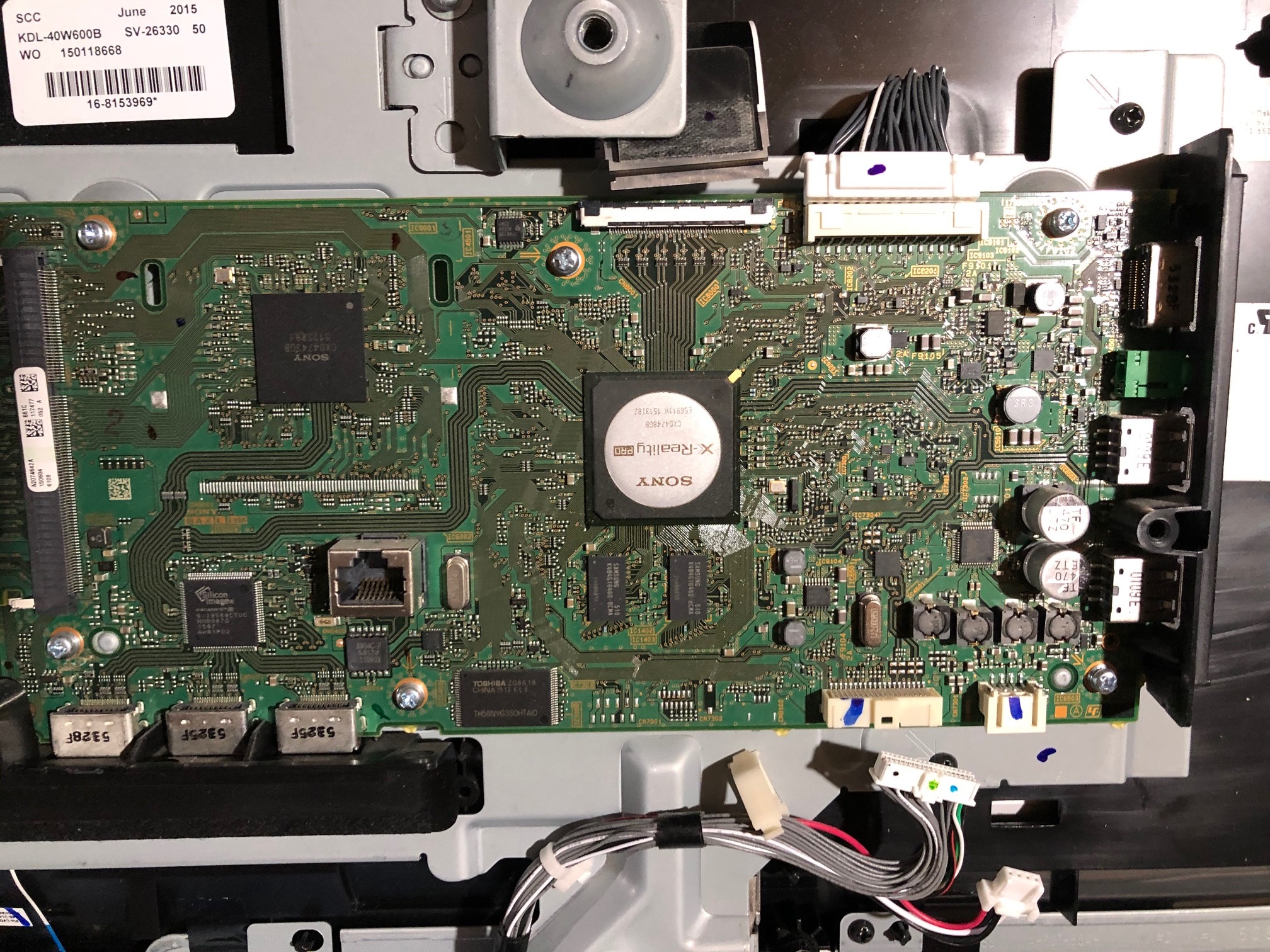

    The replacement LD board appears to be working. After install I got two blinks fault code and the TV responded to remote input. It would not power on or turn on backlights though.

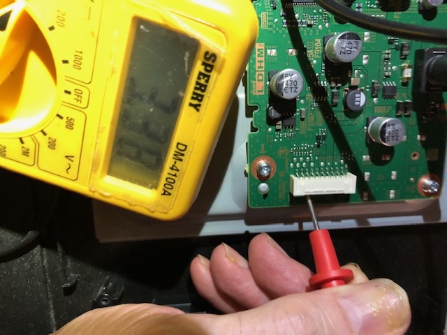

    While checking fuses on the original main board (BAXL bd), I shorted pins at CN9101. Now F9101 looks open and the TV lost the blink code, so back to dead set.
    Questions for the forum:

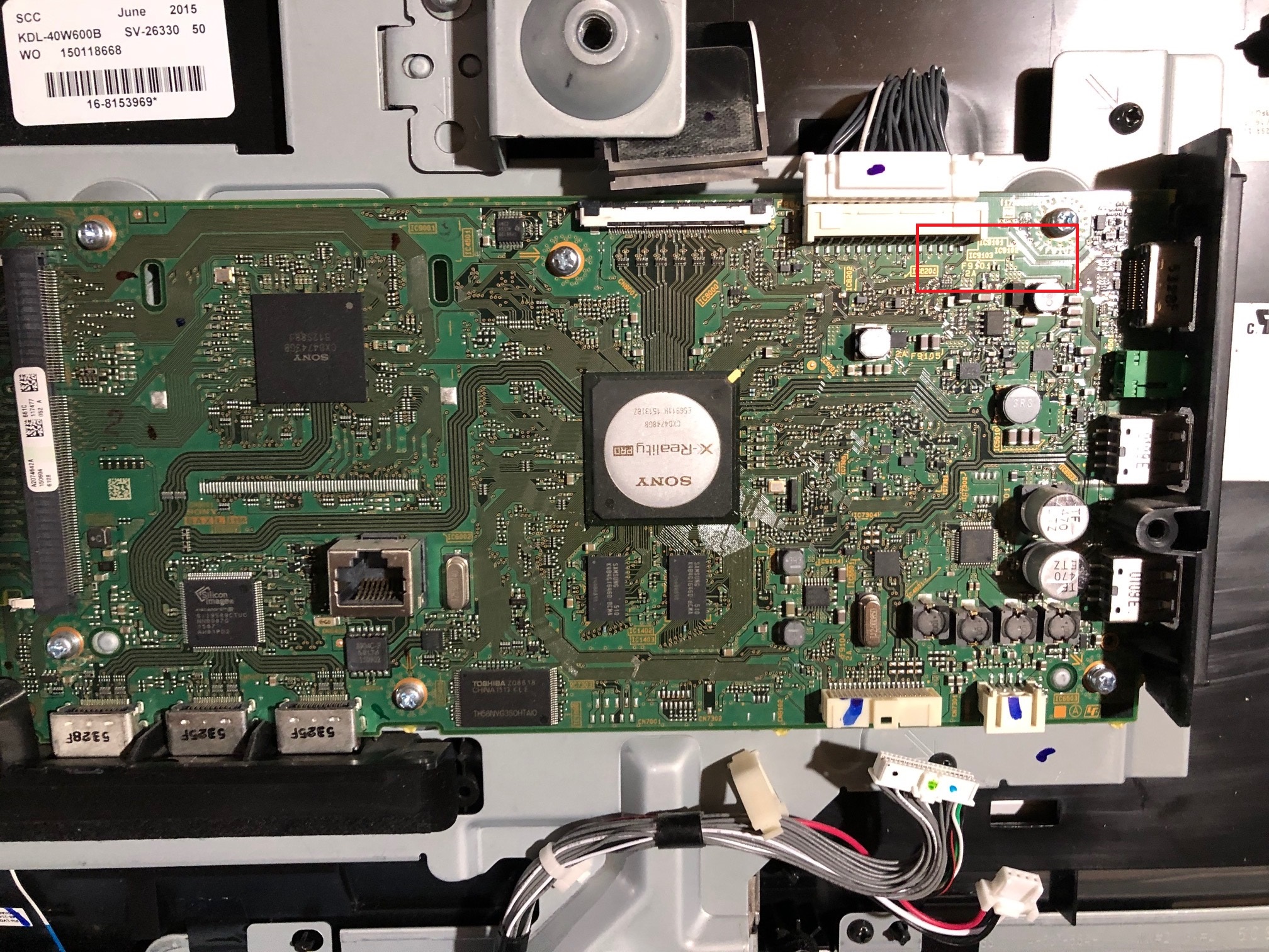

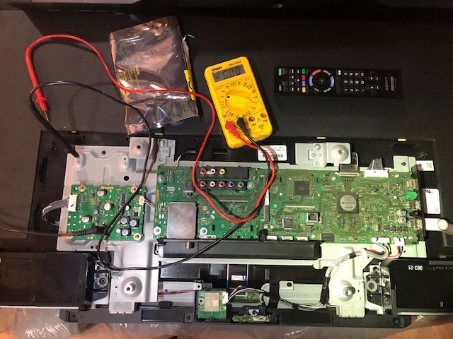

    1. Could anyone confirm my probe is actually on F9101 in the third photo? Hard to tell with two smaller but identical components closer to the fuse legend.

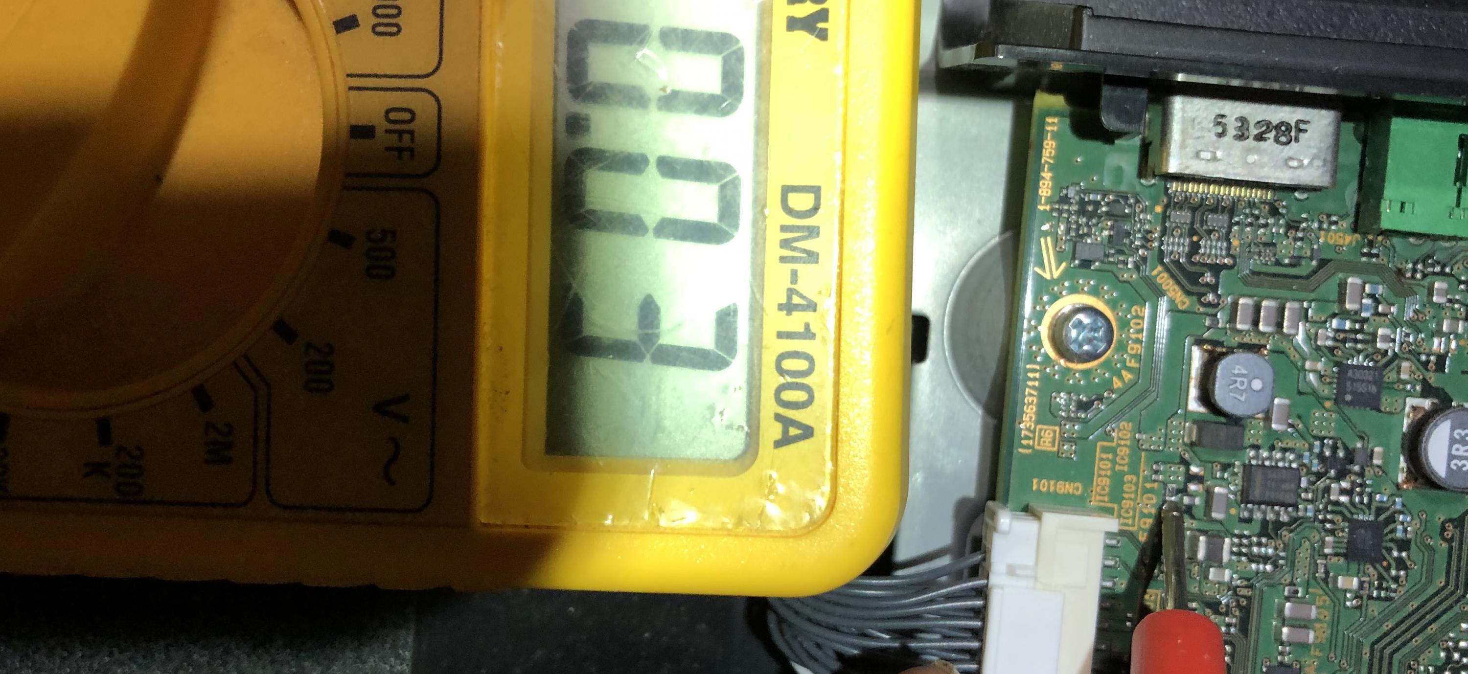

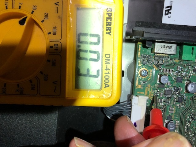

    2. Standby 3.3V is showing present at CN1001 pin 6 on the power board (LD) and at the corresponding pin at the main (BAXL), per my last photo. No fuses have 3.3V though. Can someone suggest a test point for it on the main and the tiny IR receiver board?
    3. While the two-blink code was on, I attempted a firmware update and a hard reset, but got no response from the TV. I did confirm the remote operates another Sony TV. Any suggestions?

      Your photo's are too small to really see the point where your meter is connected.
      • steves7839
        • Nov 2014
        • 200
        Re: Another KDL-40W600B
        Here is a bigger photo of the fuse I asked about above. See the red outline.
          Pictures are too blur and low res for me to zoom in to see the fuse.
          • steves7839
            • Nov 2014
            • 200

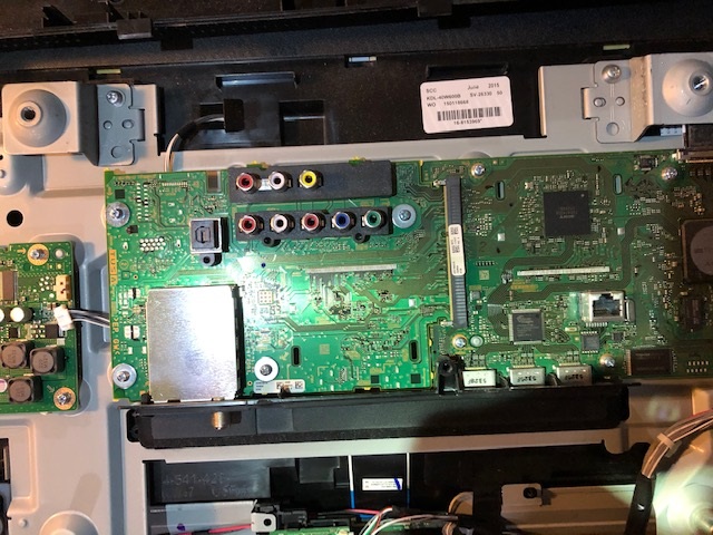

            Here are some more photos.
            • Davi.p
              Hobbist Tech
              • Sep 2009
              • 4327
              • Italy - Milan
              Yes that is.the fuse... you have the service manual so check the correspondence of the fault and the blinking, 6 are the backlight, but 2 i don't remember, maybe again backlight.

                Progress, finally. I replaced the BAXL “main” board. Manual says you must update firmware after board replacement. For a day it just flashed red/green. Finally I used the remote sequence disp-5-Vol--power and got a brief input signal screen, then a 6-blink code. Read somewhere about how to force an update. Power disconnected, insert usb, connect power while holding chassis power button. Now it displays rotating arrows indicating update in progress. Leaving it to do it’s thing until tomorrow.
