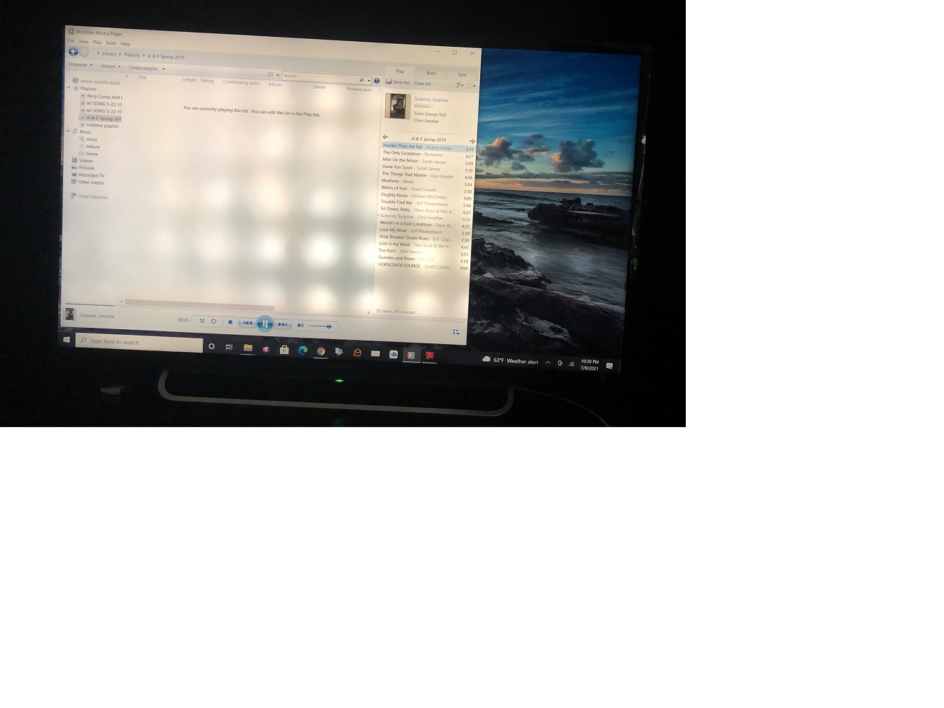

                  Now that I've started using the TV, it's apparent the LED's are visible through the picture. I have reduced brightness, white and black levels, contrast, etc to zero without getting rid of the bright spots. I also reset display settings to factory levels. They are dimmer behind darker pictures and stand out clearly behind white.
                  I did remove all LED strips for testing during the troubleshooting process, and all tested good with a strip tester. I believe I marked all diffuser sheets for correct reinstallation.
                  Are the brights consistent with a diffuser in the wrong order? Have I overlooked any settings that could cause this?
                  The photo is the set showing my PC screen thru an HDMI cable. All inputs display the bright spots though.

                    Seems that the shim pins of plastic are not been reseated, so the foils falls onto leds..

                      FYI- I have tested many led strips that all the led's will light up but if there is one weak one in the chain it will still trip a backlight error or emit a quick flash once its hooked back up to the power supply or led driver. Once I get the new led kit in the Tv it works fine. So even if they all light up don't be fooled, just replace all the strips or bars. You'll be glad you did.
