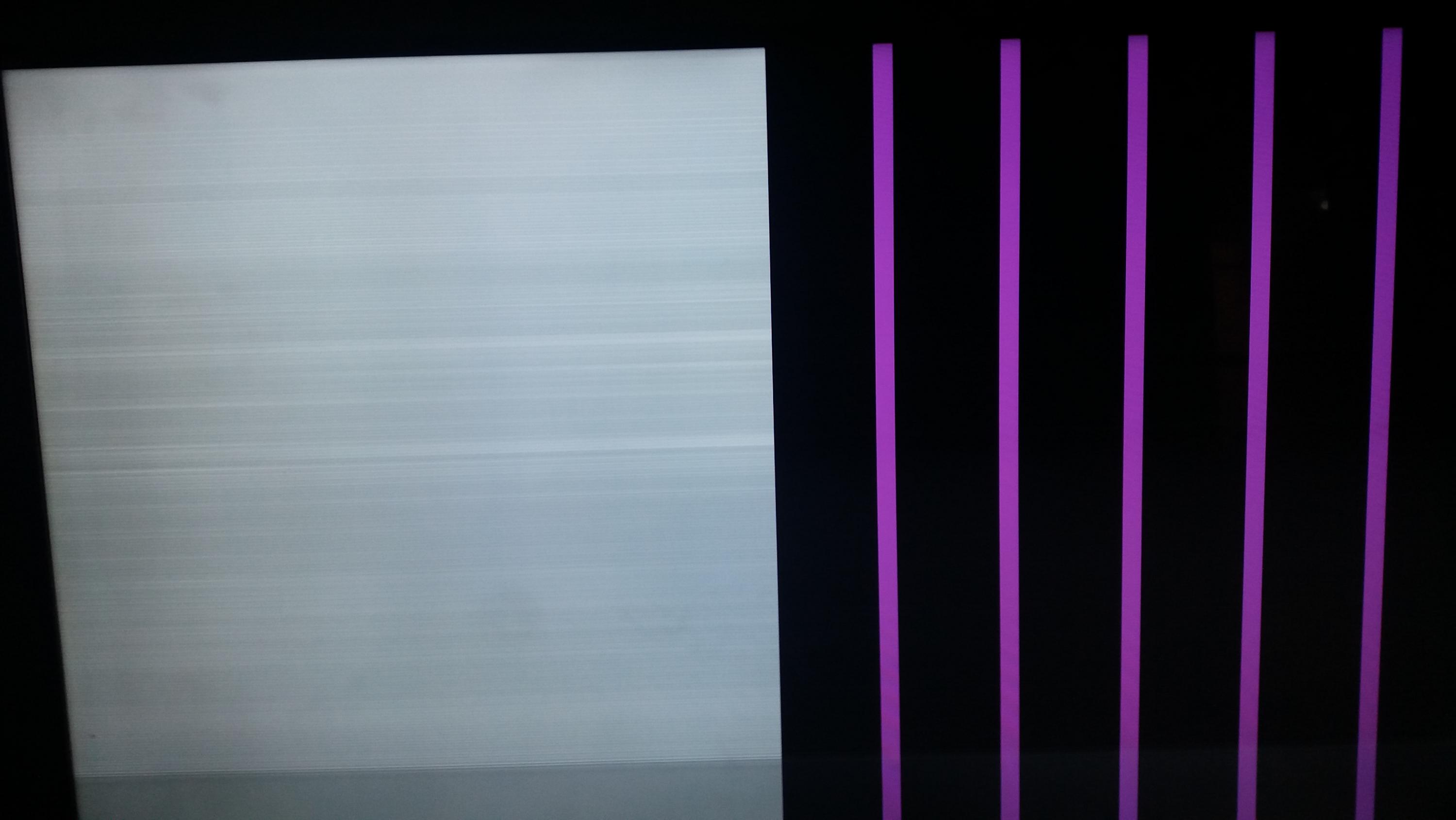

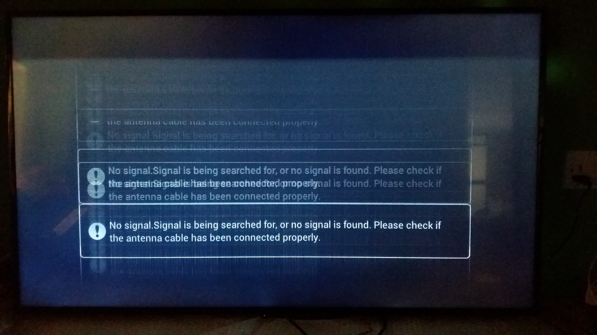

    I have a philips 49PUT6101/12 CHASSIS TPL16.1E with double image problem as attached, any one knows regarding this problem?
    Any help will appreciated

    show us photo of the menu OSD while the set display external video signal via AV or scart.
      Re: Philips DOUBLE IMAGE FAULT
      LCD panel Gate tab bond issue, tape off method may work.

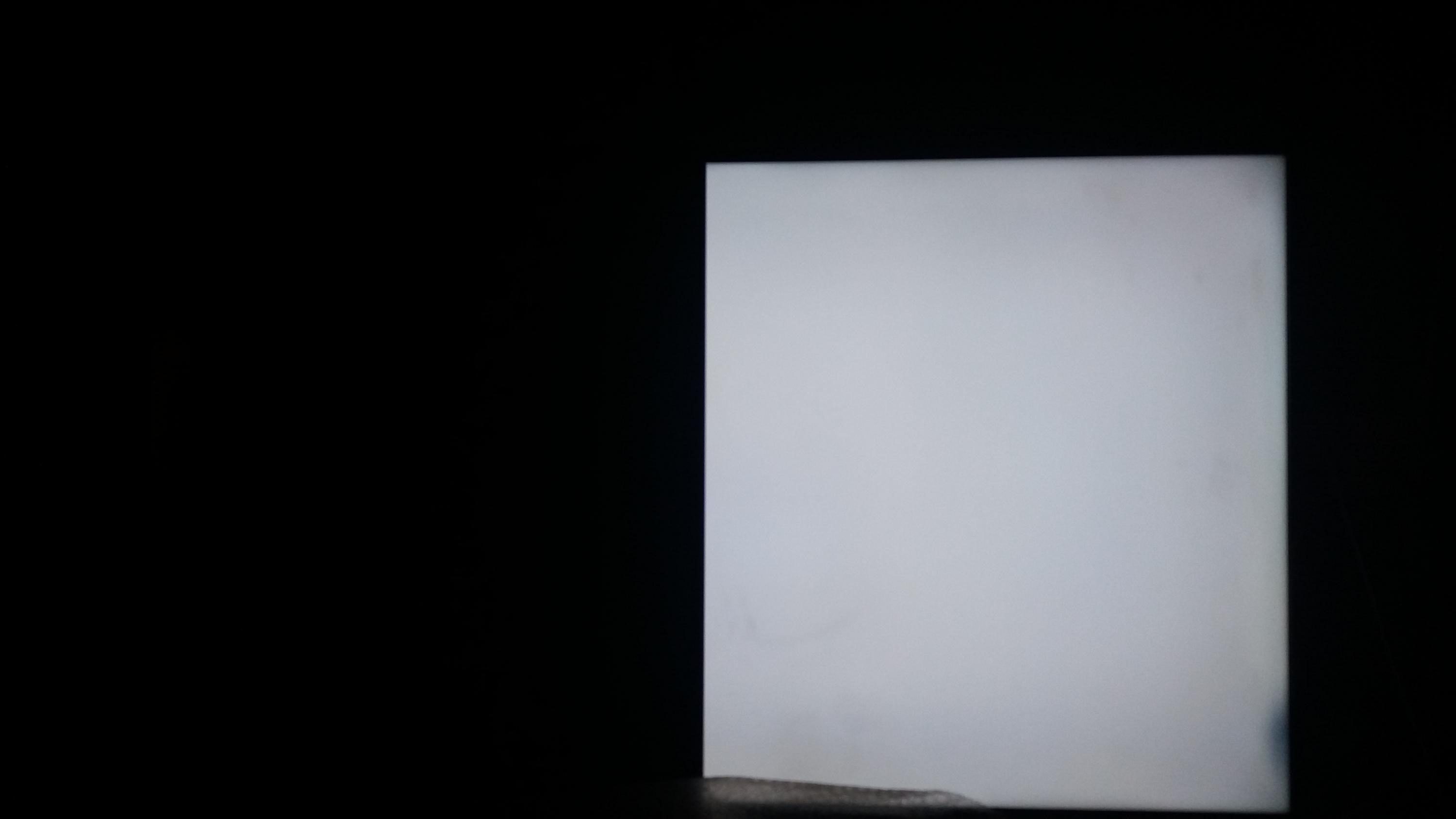

        a video taken what exactly is the problem ,signal from external decoder through HDMI and it's alternating 4 sec ok and 4 sec with double image problem
        I hope it a bit clear

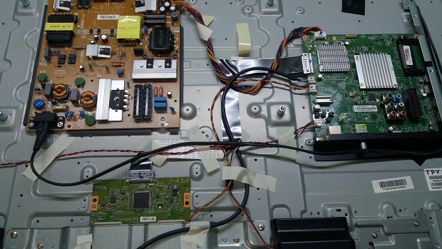

            I Cleaned the lvds cable from both sides and switch on again but with no hope, I also clean the the two flat cable from tcon to panel to LCD, attached will find two photos one with left flat cable removed and result in half pure white display, then I put back and i removed the right one and results is with half picture and with grey lines

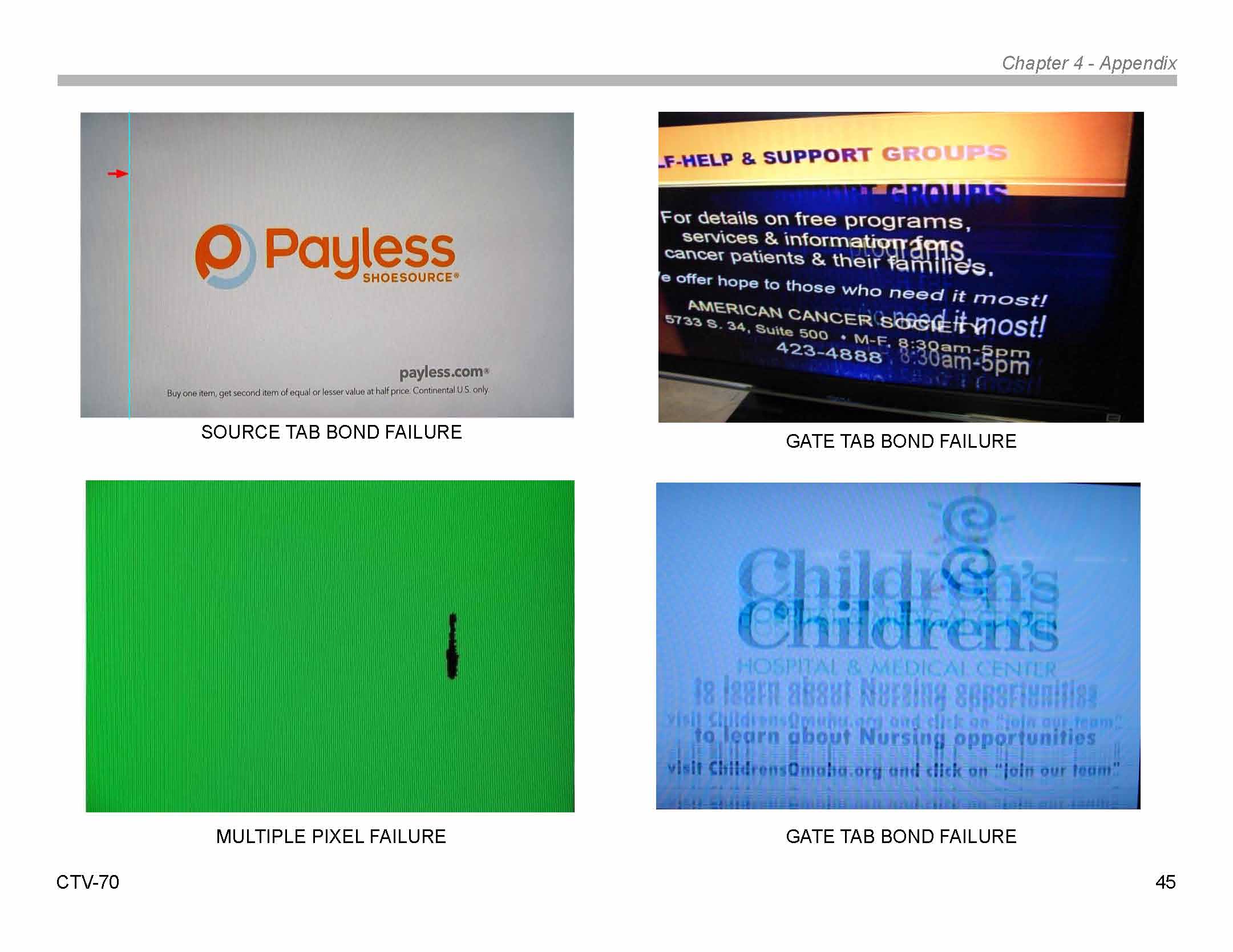

              its tab bond issue ... hope u can fix it by working round apply pressure on the effected side

                So do you still get the same double images as shown in your post #1 when everything are connected back to normal?

                  YES still the same and i checked the tab cables it it seems fine ,i suspecting the TCONBOARD

                    It is the Gate tab bonding as shown in post #3. Try taped off methods.
                    For examples:
                    https://www.youtube.com/watch?v=j7vl7-vZEL8
                    https://www.youtube.com/watch?v=9eT5-3L_BLU
                    You can try T-CON if you like.

                      yes but if you check post 3 the video attached the display is alternating from 4 sec ok to 4 sec to grey horizontal lines,so that why I not suspect with the tab bonding
