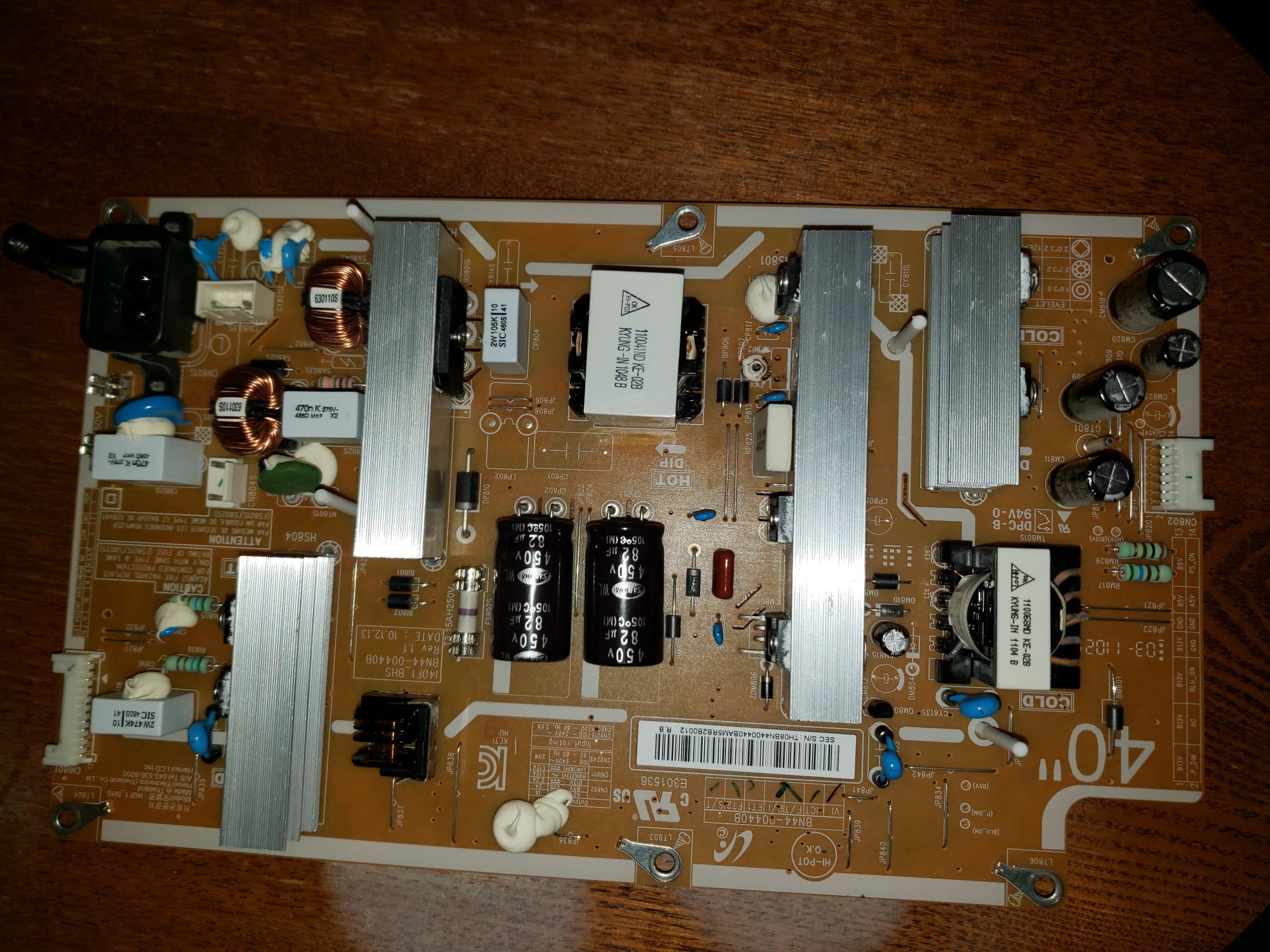

    Trying to repair this bn44-00440b board for my Samsung TV.
    The TV was in use when it died, just clicked off.
    No indication of power at all.
    I found that the fuse at FS801S had blown.
    The fuse was replaced, and immediately blew when the TV was turned back on.
    It was suggested that there was a short to ground somewhere on the board.
    Using the continuity mode on my multi meter I tested from a grounding screw to many points on the board.
    I did not find a short.
    I could not find a schematic for this board, and looking at other posts on here no one else has either.
    Since I'm really using this repair to learn more about PCB repair I decided to bypass the fuse.

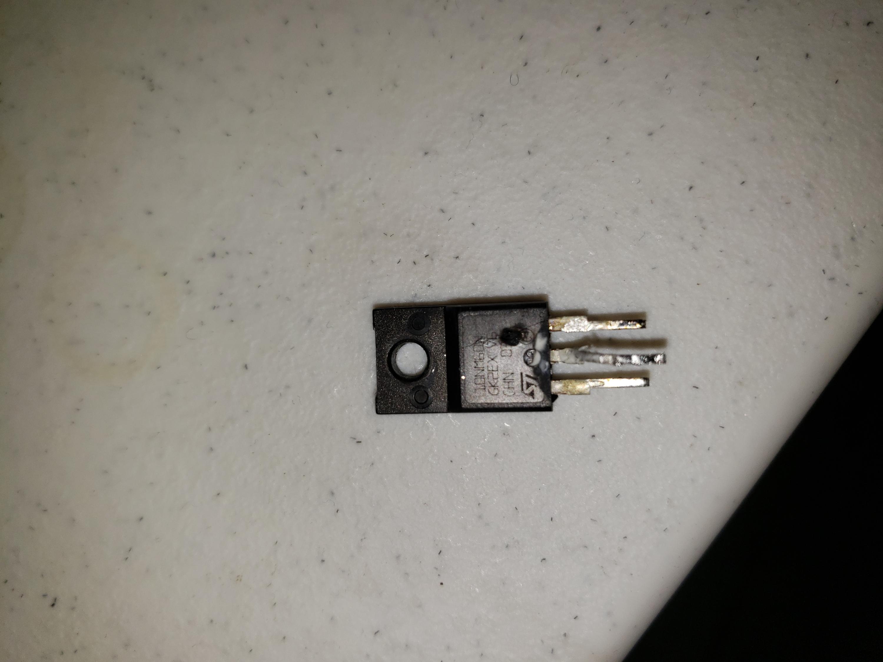

    The MOSFET at QP802 did not survive that experiment.
    I removed that component, and checked for a short to ground, again I can't find one.
    Just looking for some advice.
    I would just replace the MOSFET, and try again, but I'm concerned I'd just end up cooking something else.

    If the fuse is blowing, you should be able to measure a short (may be very low resistance) on the other side of the fuse to ground. You can use hot ground as well which is the negative side of the big caps. You may be able to measure a short on that FET. There should be some videos on youtube on testing FETs. Again low resistance would indicate it is shorted and failed. It doesn't have to be zero ohms. Dust between high voltage pins can also ignite which is why some boards fill the space with silicone or glue.

        The FET did fail, it's the component in one of the pictures. Nice little hole in it.

          I advise you to call an electronics technician for repair. You have too little knowledge to repair. There are too many burned components related to PWM and PFC circuits. In addition, the working voltage is very dangerous (400V).

              A real electronics technician, if he has found the burnt fuse, does not replace it and checks if it has been fixed. A real electronics technician checks WHY HE BURNED. Possibly you have burns: rectifier bridge, mosfet, integrated controller, resistors, diodes, optocoupler, possible mosfet, controller on the PFC circuit and related components, etc.

                        "Using the continuity mode on my multi meter I tested from a grounding screw to many points on the board.
                        Just for learning and FYI when testing testing the circuits.
                        The cold side circuit ground is usually connected to the ground screws/board mounting screw.
                        The Hot side circuit ground is not connected to chassis, the ground ref for hot side circuit will be the negative leg of the main filter cap.
                        BTW, using continuity mode, most meter will beep when testing continuity up to 100 Ohms, which does not mean dead short circuit, need to look at the Ohm reading too.
